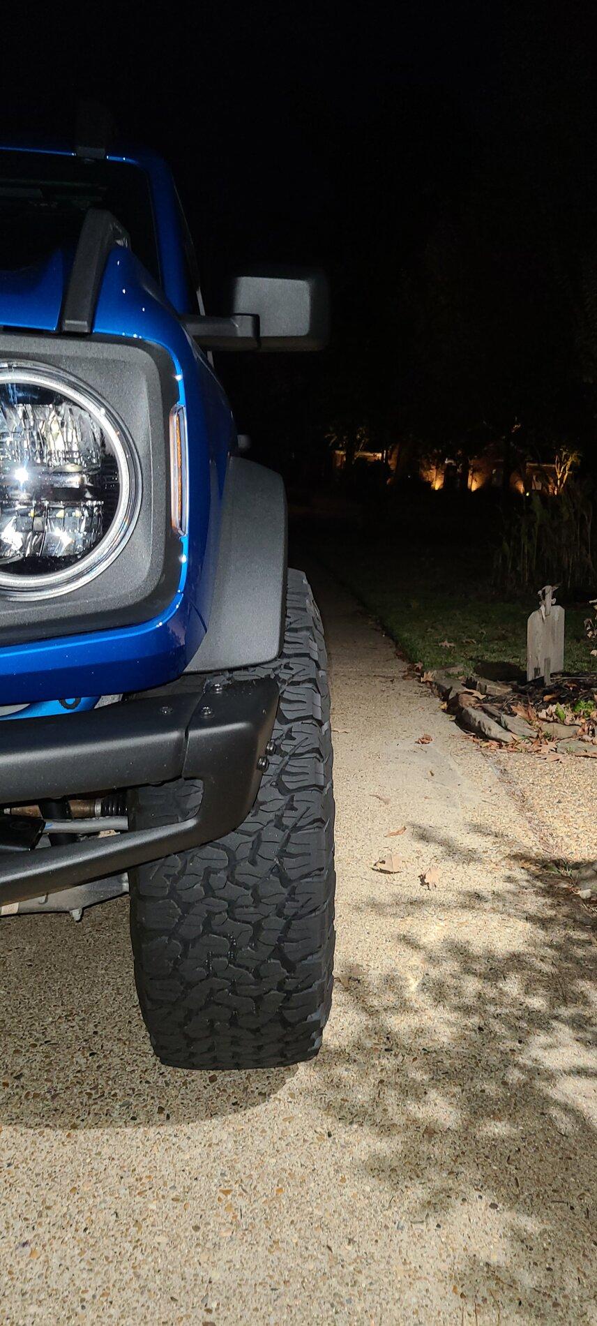

Ford Bronco Show us your installed wheel / tire upgrades here! (Pics) 20211110_121707
Ford Bronco Show us your installed wheel / tire upgrades here! (Pics) 20211112_191627
American Racing AR172 Baja wheels, 17x8, 0 offset. Tires are BFG KO2s in 295/70R17. Had to remove crash bars as they rubbed a good bit when turning in reverse.
