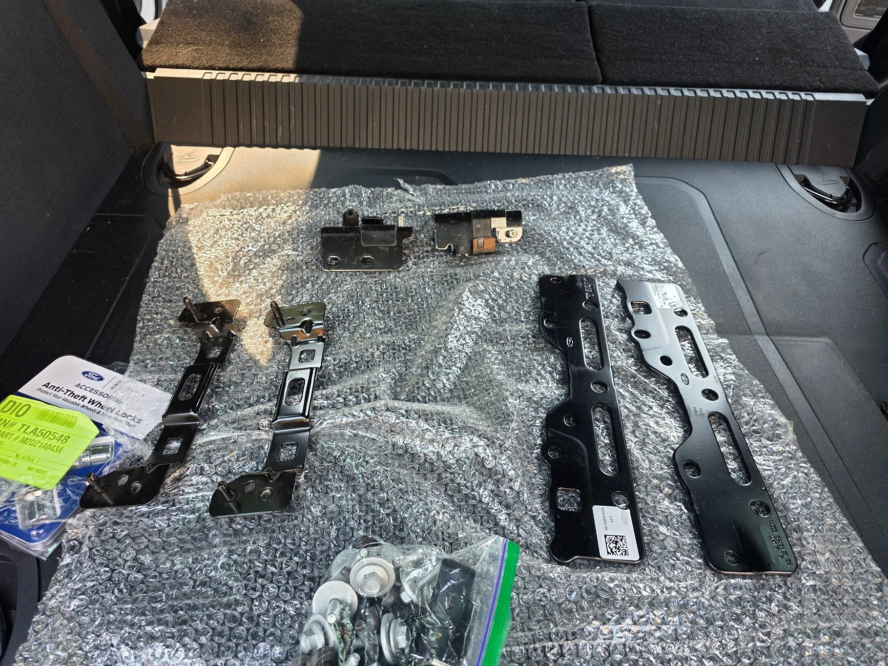

I purchased a second hand soft top which didn't come with instructions. I looked all over the Internet for pdf instructions but I couldn't find any. The only thing you find on YouTube when you search "soft top installation instructions" is how to open and close a soft top, I wouldn't consider that instructions for installation.
Anyway here's a picture of the six brackets I have. And a baggie with 10 black bolts and 10 silver bolts. I hope that's everything that I need.

On the right side of your photo, those are the plates that the roof panels latch to so they go on top of the roll bar above the doors. The small brackets in the top middle are the brackets that the soft top latches to mid span. To help you figure it out, when your front panel is folded back to the first position, that’s where you’ll find the placement for those brackets on top. The medium size brackets on the left of the photo are the main mounting plates for the soft top. They go behind the removable plastic panels in the cargo area. Once mounted, you’ll drop in the soft top and use 6 bolts to mount the tops frame to those plates. Inside the baggie, you should have 2 smaller brackets that mount at the top left/right side of the tailgate. That’s where the rear window brackets latch into place when the top is in place.

The silver bolts are for mounting the brackets behind the plastic panels and for mounting the top to those brackets. I had to trim my plastic covers once the soft top was installed so that they would fit back into place. So be ready for that. All the black bolts are used to mount all the exposed brackets that you see when the top is folded back.
