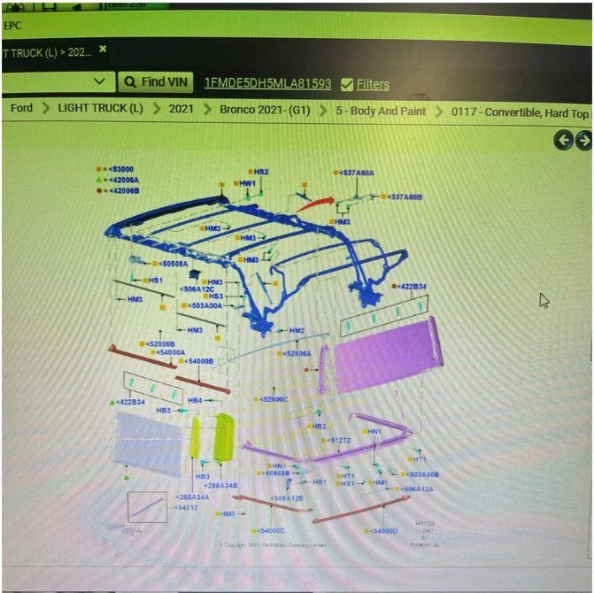

I called Gary Yeomans Ford, thank you! I was told you (or someone else they had done this for) actually had a soft top from an existing bronco? This is important because Ford doesn't sell the complete soft top, you have to order it in parts. See picture that my dealer sent me. I guess I am going to need to try and buy and existing soft top from a Bronco owner??
Yeah I was able to find a guy on this site that sold me the soft top. There's a few people that had a factory soft top and bought a best top.
Search the market place on here and you may be able to find one in your area.
Make sure they include the latches in the rear and middle, and the bracket.
