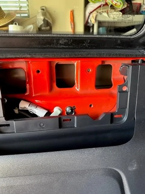

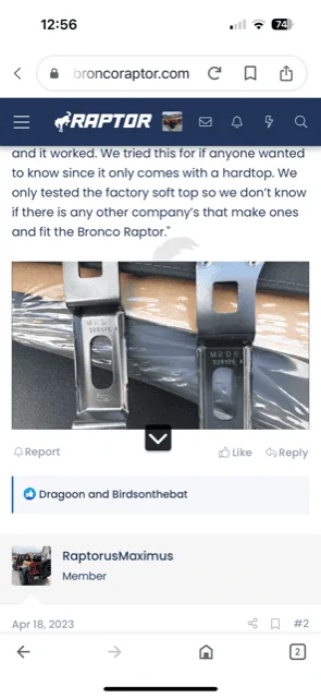

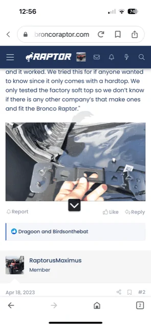

I got set of brackets from a guy on the forum, but the one set of brackets he sent i don't need, I need the cargo hold brackets that the actual soft top bolts onto(see pics) as well as the plastic trim pieces...
Anyone know the exact Ford Part number to order?

qty 2
Panel ReinforcedM2DZ-7829452-A
qty 1
Panel TrimM2DZ-7831288-BA
qty 1
Panel TrimM2DZ-7831288-AA
These are the ones I ordered and waiting on still.

So the M2DZ-7829452-A is the bracket for rear cargo area that actually holds the whole soft top onto Bronco? So i need two....

yes the other parts is the left and right panel cover
