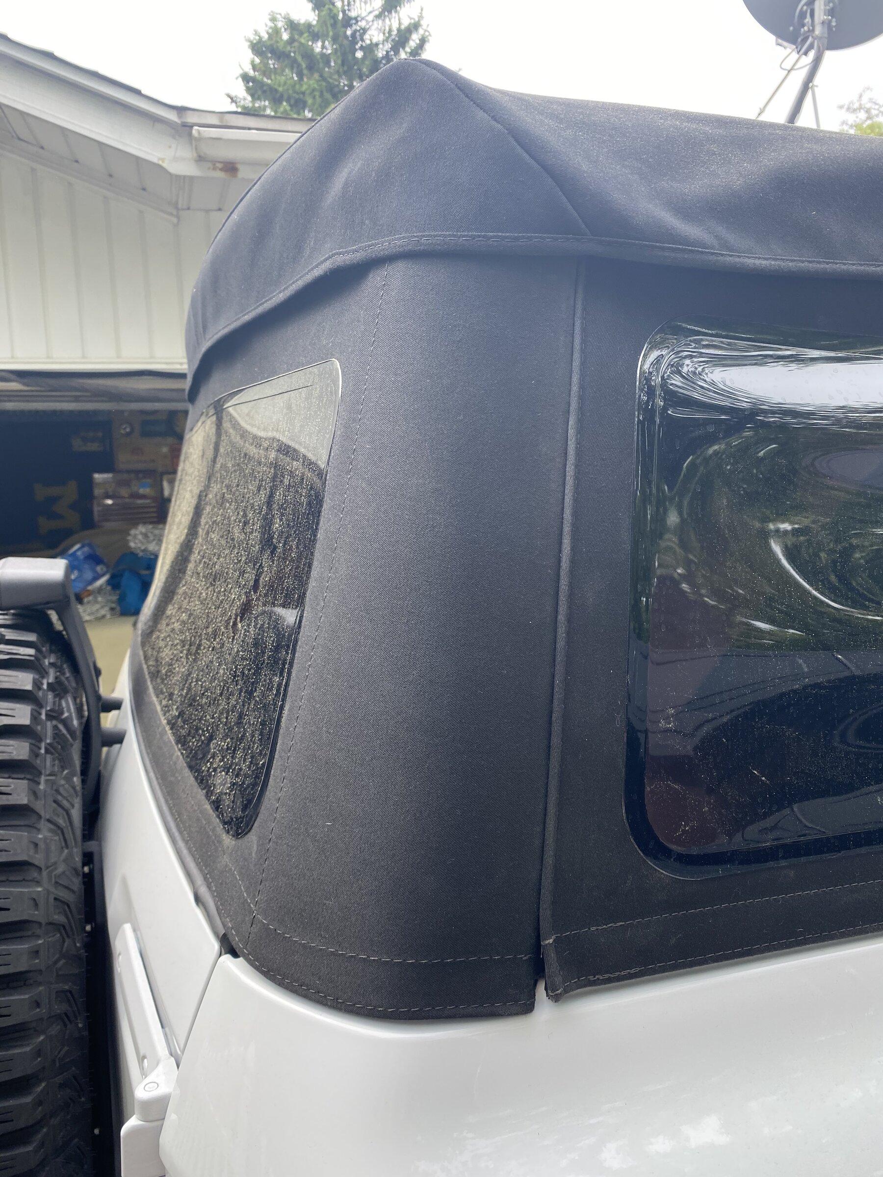

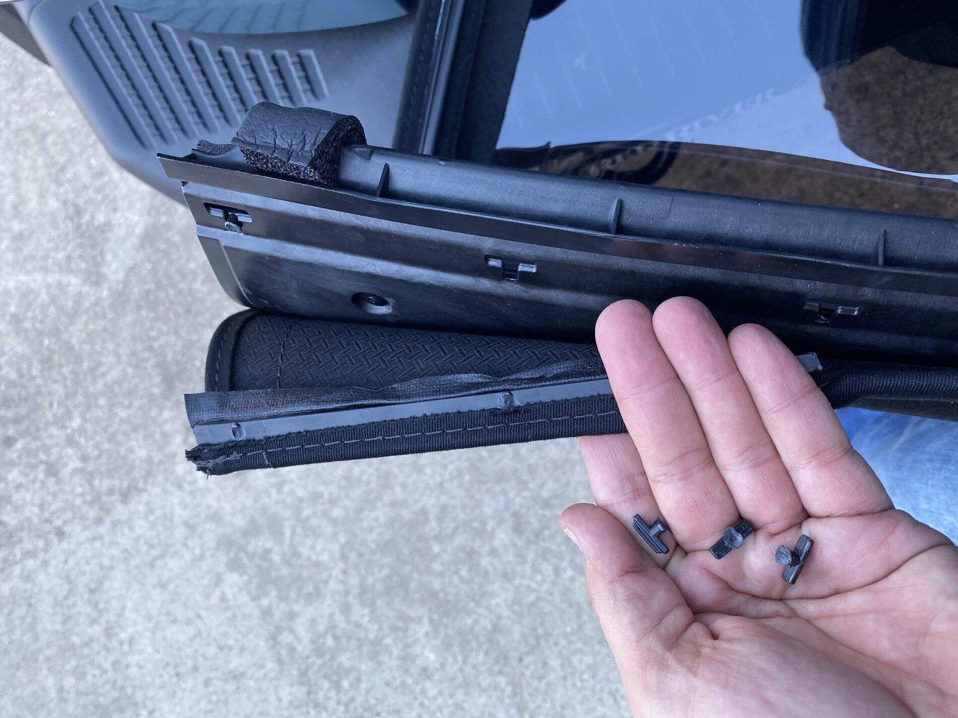

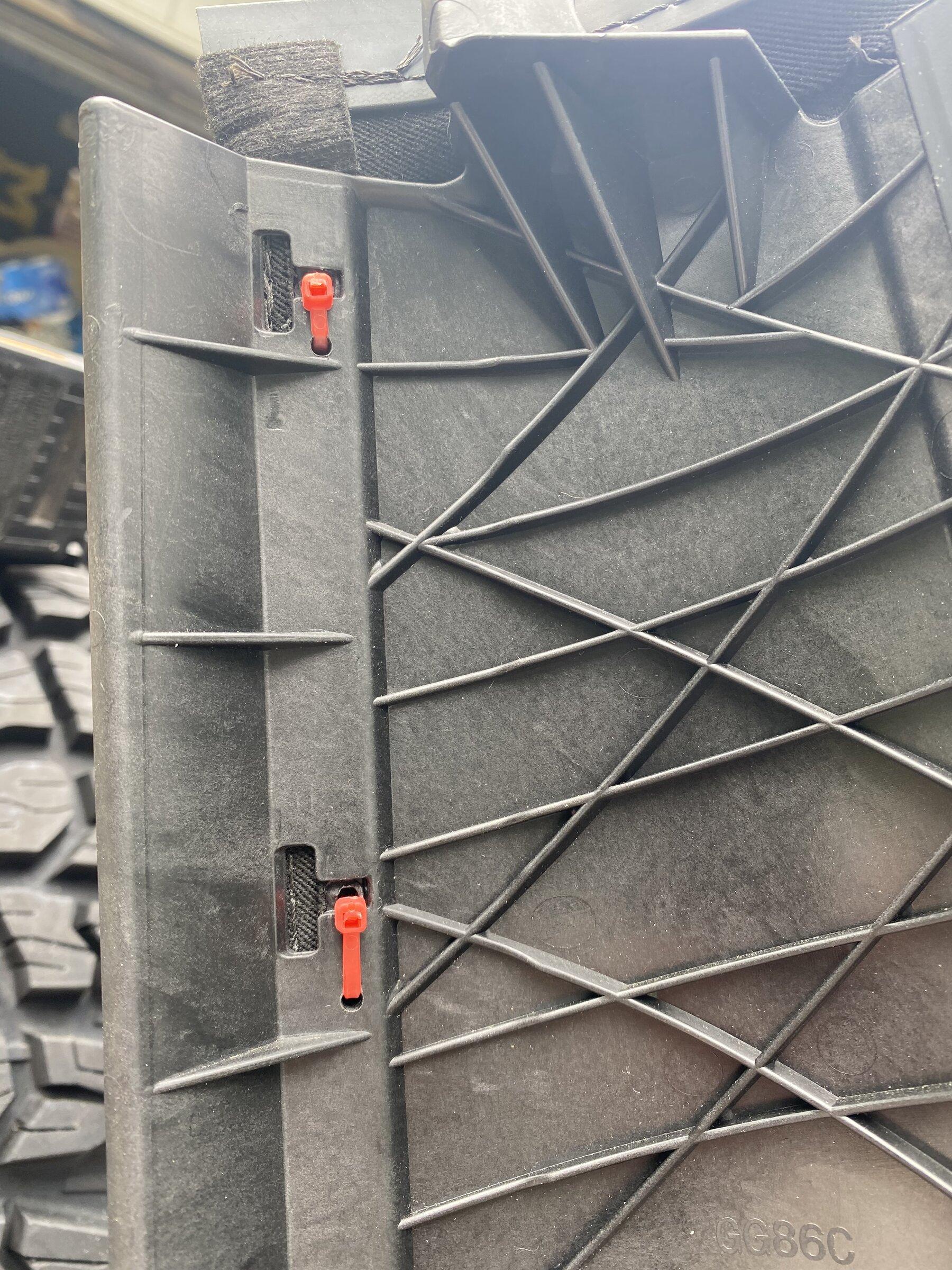

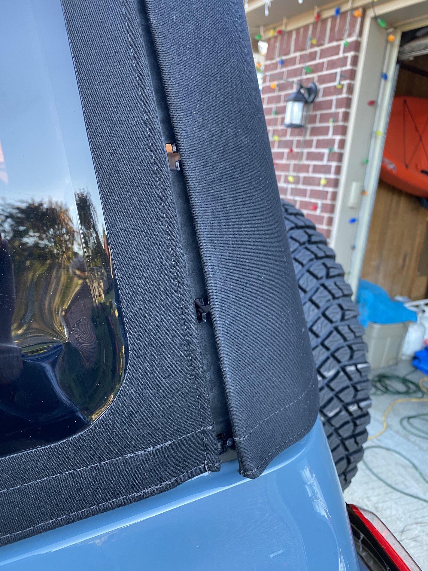

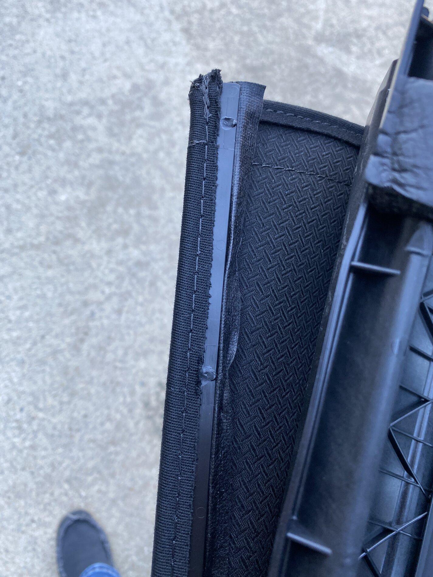

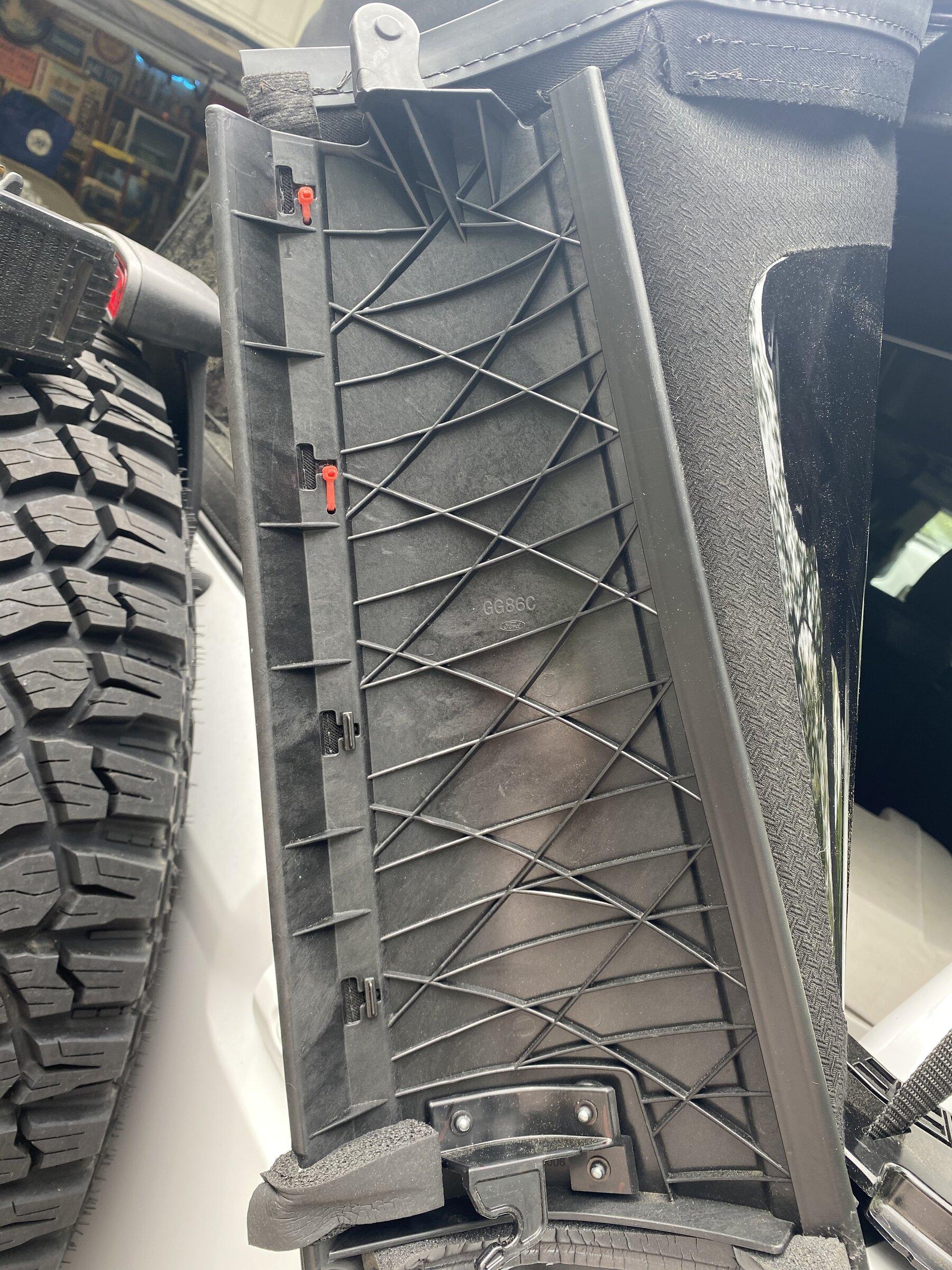

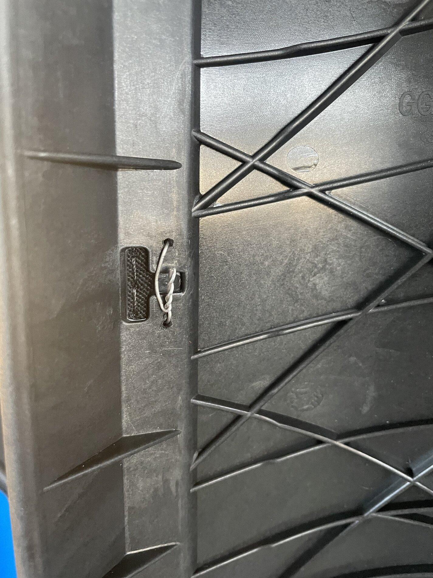

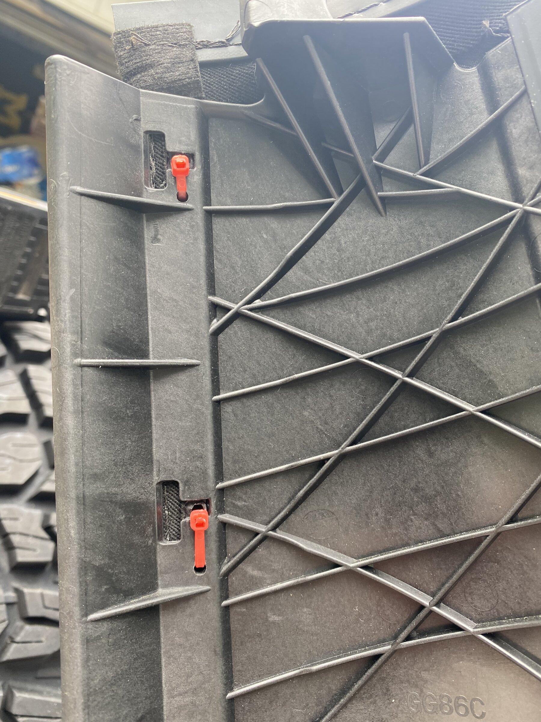

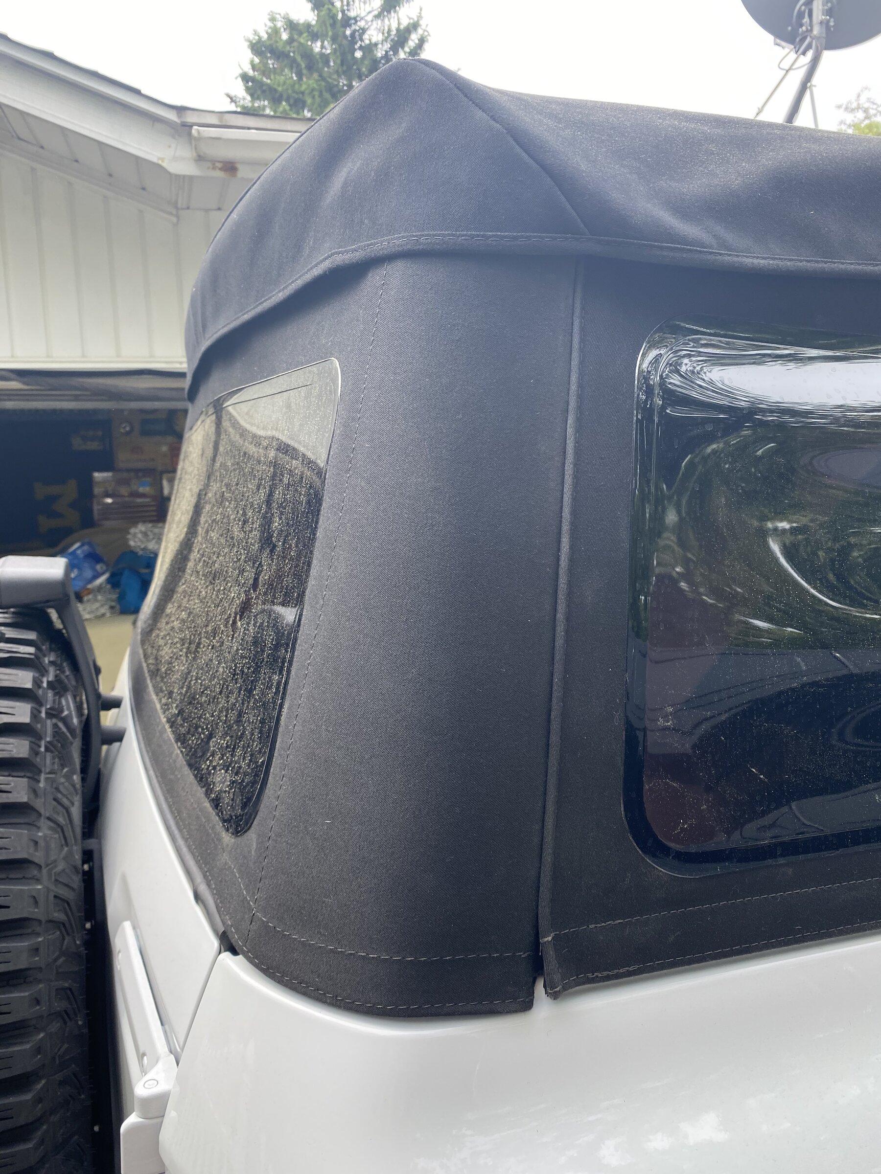

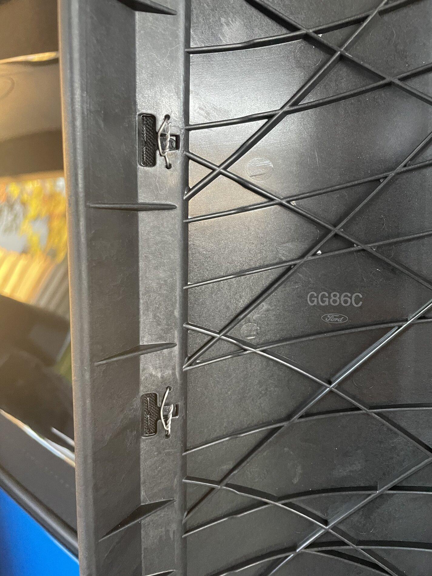

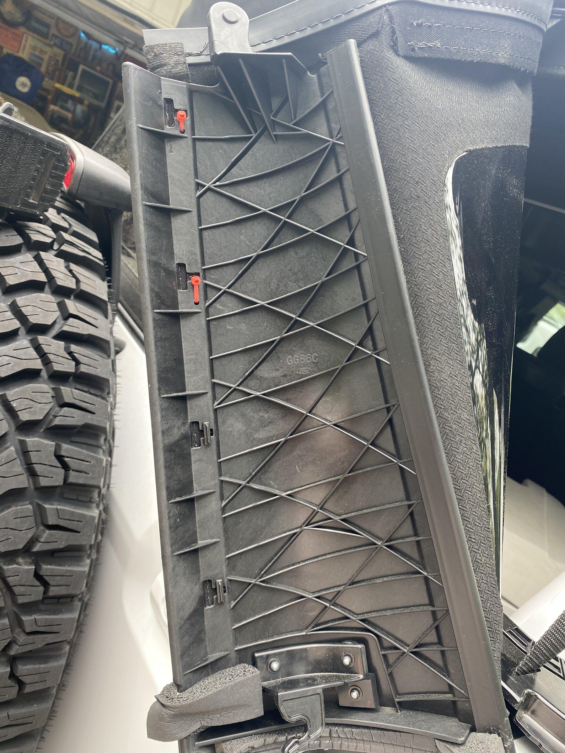

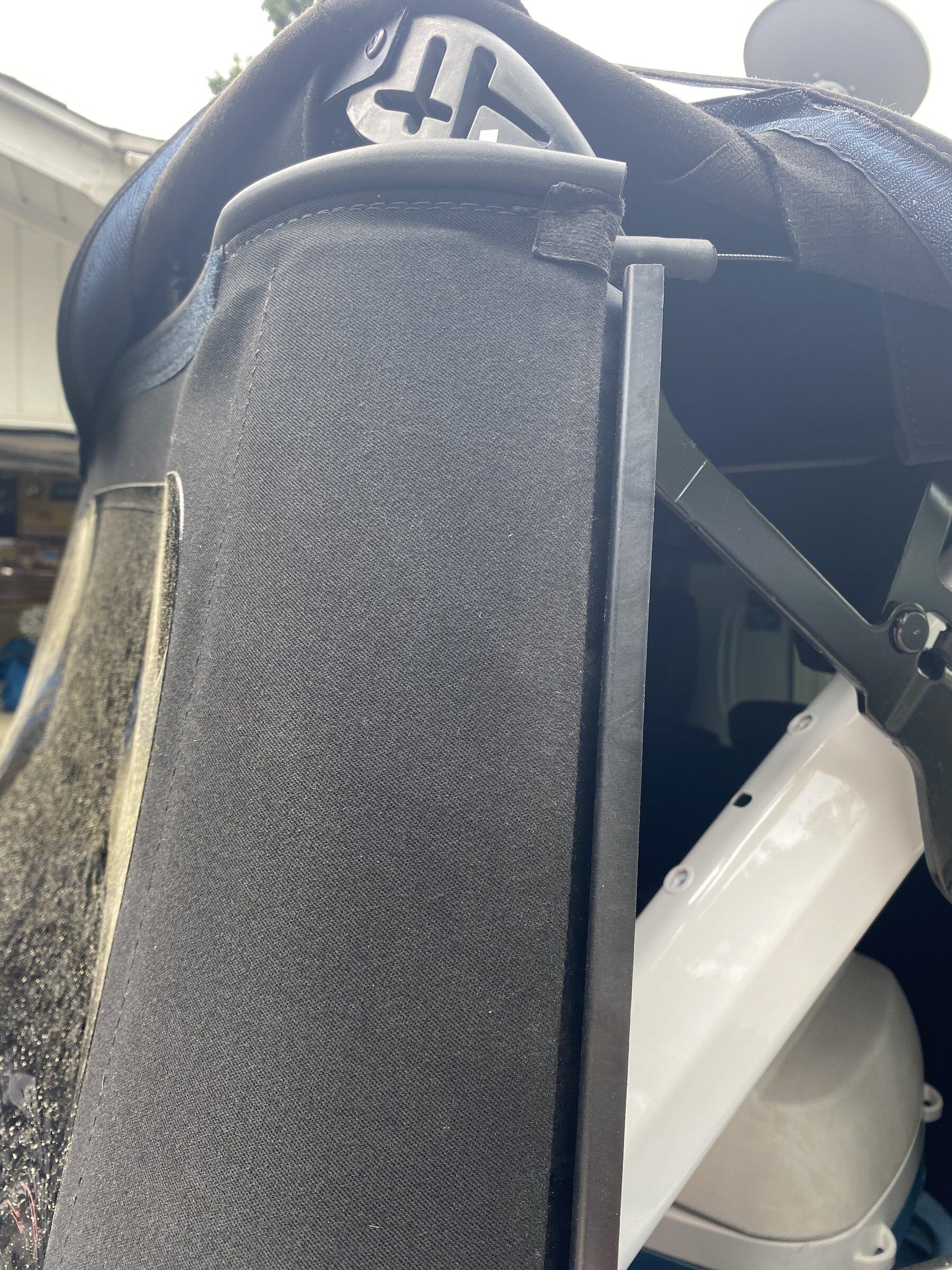

I did the same thing, was stunned by how little effort it took to snap 2. I repaired them with nylon zip ties. Drill a 1/8” hole through the former stem of the broken tab, slowly and carefully so you only penetrate the plastic backing and not the outer fabric. Drill a second hole 3/8” - 1/2” below also through the plastic backing. Carefully feed the zip tie in 1 hole and out the other. Once all offending locations have zip ties installed, tighten till secure.i did the same to 3 tabs (2 on one side, 1 on the other). It looks like the rear will not seat correctly now right?
