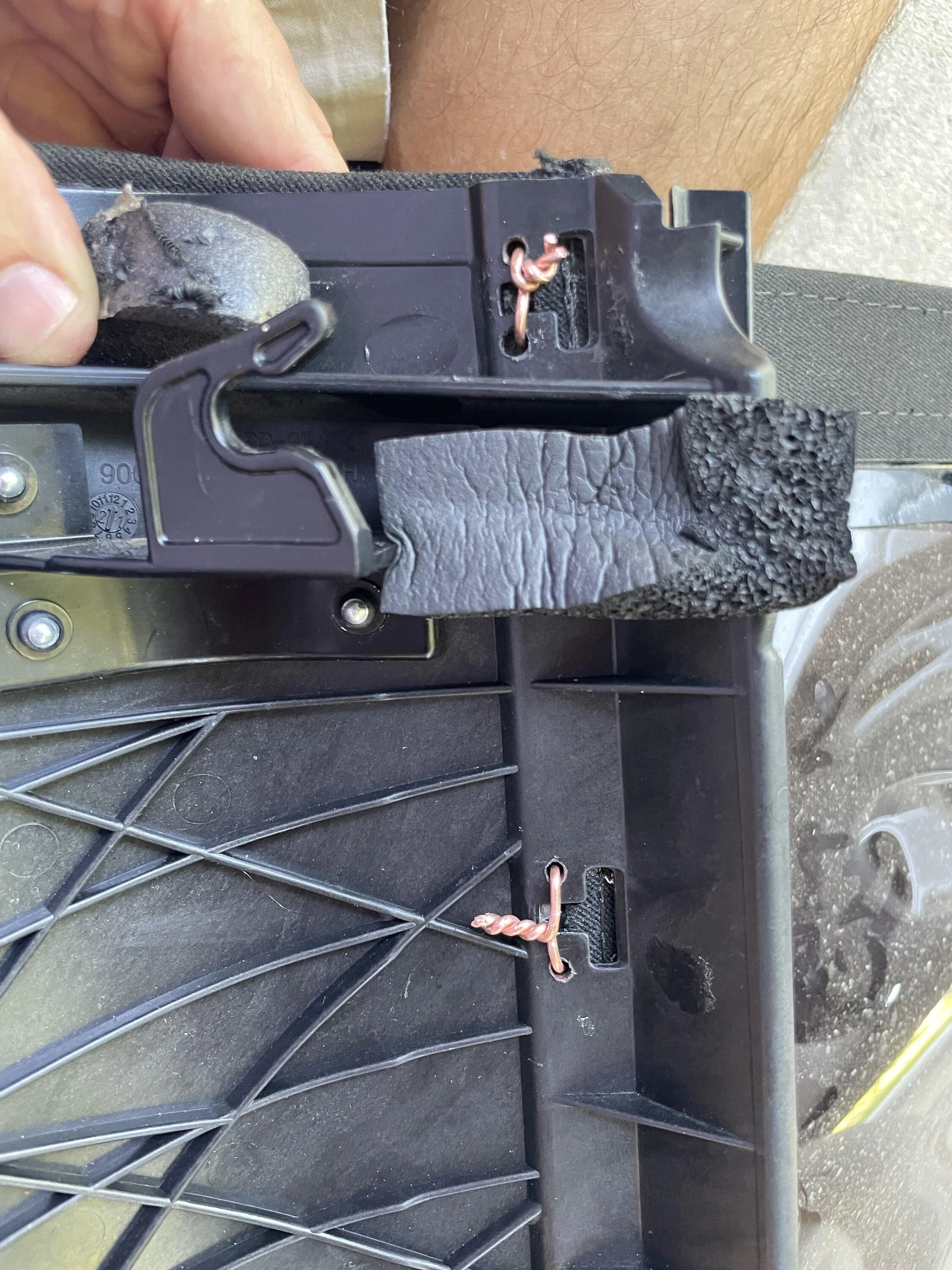

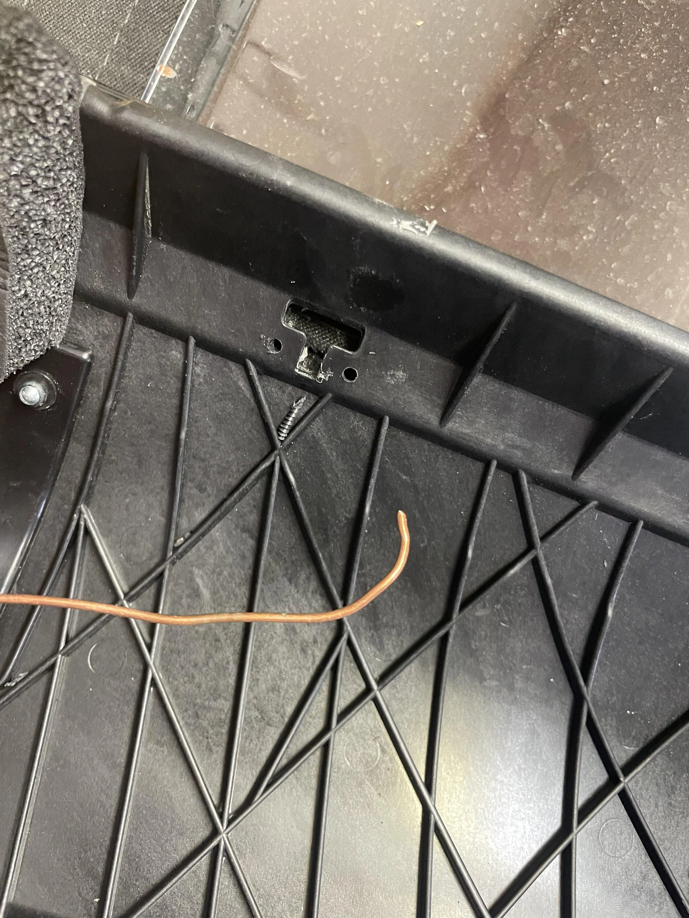

Ok, about 1 minute after I posted this I got my first wire threaded. Here are some pics.
Ford Bronco Soft top broken tabs 963EC067-32A6-4891-BCA7-401AB0C251D1
Ford Bronco Soft top broken tabs 10C34BE3-D675-402A-9FFE-1D667E2AA16D
I broke the bottom two as you can see. It was real tight getting my hand up under the fabric to do the innermost tab. That one took about 35 minutes of trying before I finally got it threaded. What really helped me was sticking a wire in the second hole so I could feel where the hole was and thus position the real wire to try to hit the drilled hole.

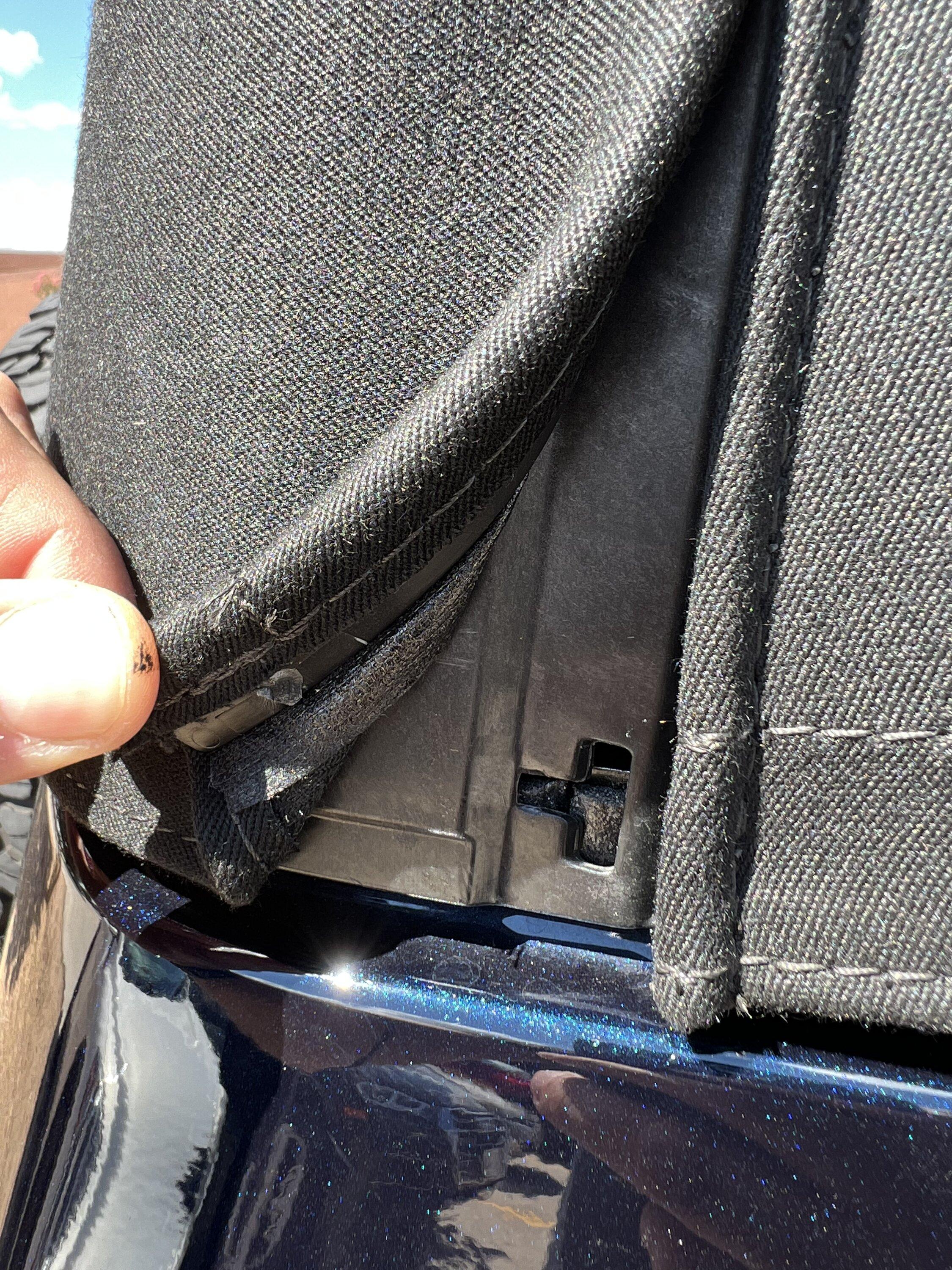

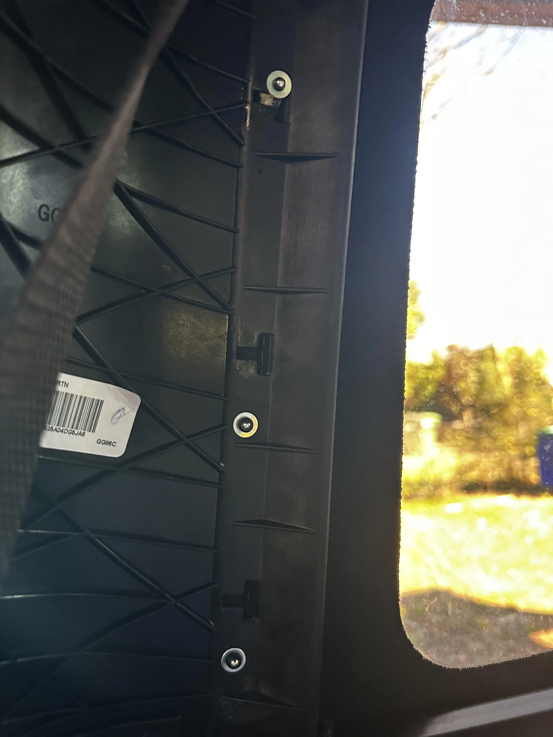

Mine’s broken. Texted pics to my dealer and waiting for response.
