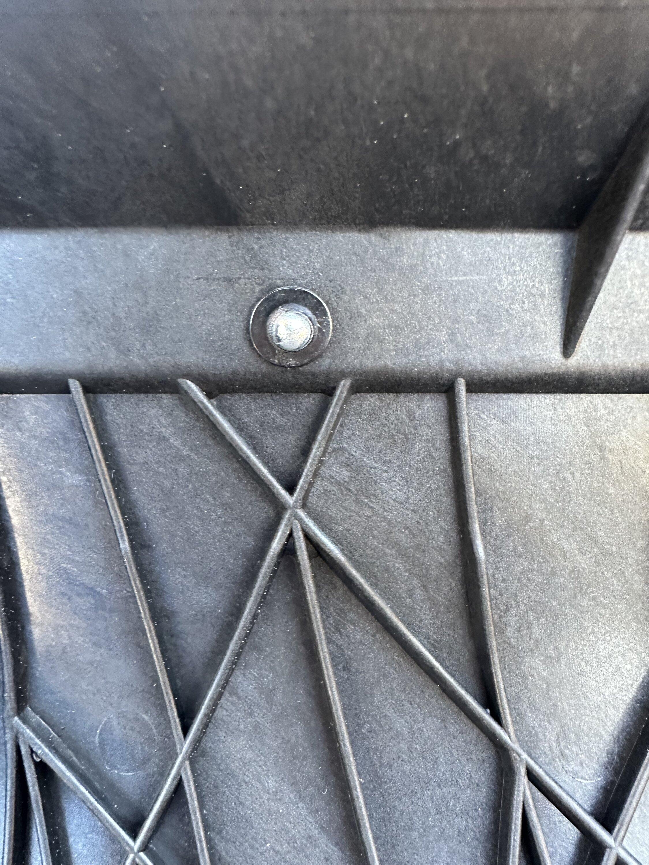

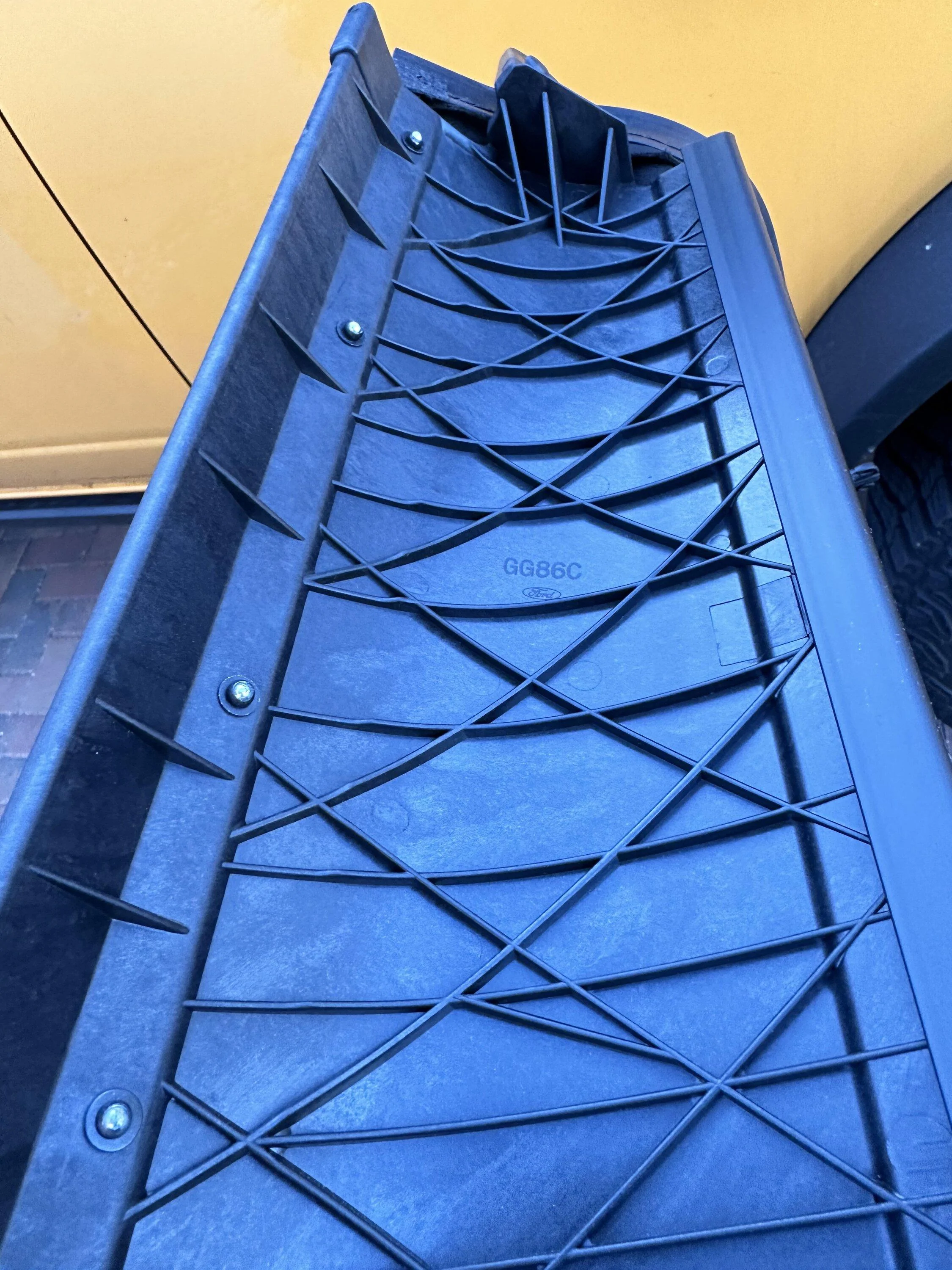

If anyone else has had the Ford dealership put in the rivets can they send pictures today? If mine is wrong I would like to take it back to the dealer today before traveling tomorrow.
So we just picked our bronco up today from getting several tsb’s done. The tabs/rivets being one. Ours looks exactly like yours, and I know this can’t be right. In a few months to a year, that protrusion is going to wear right through the top. I hope more people can post pics of their rivet fix to show this is wrong. Besides yours, the others I’ve seen are much smoother, so don’t appear like they’d rub through like ours will. Please post update if they fix yours.

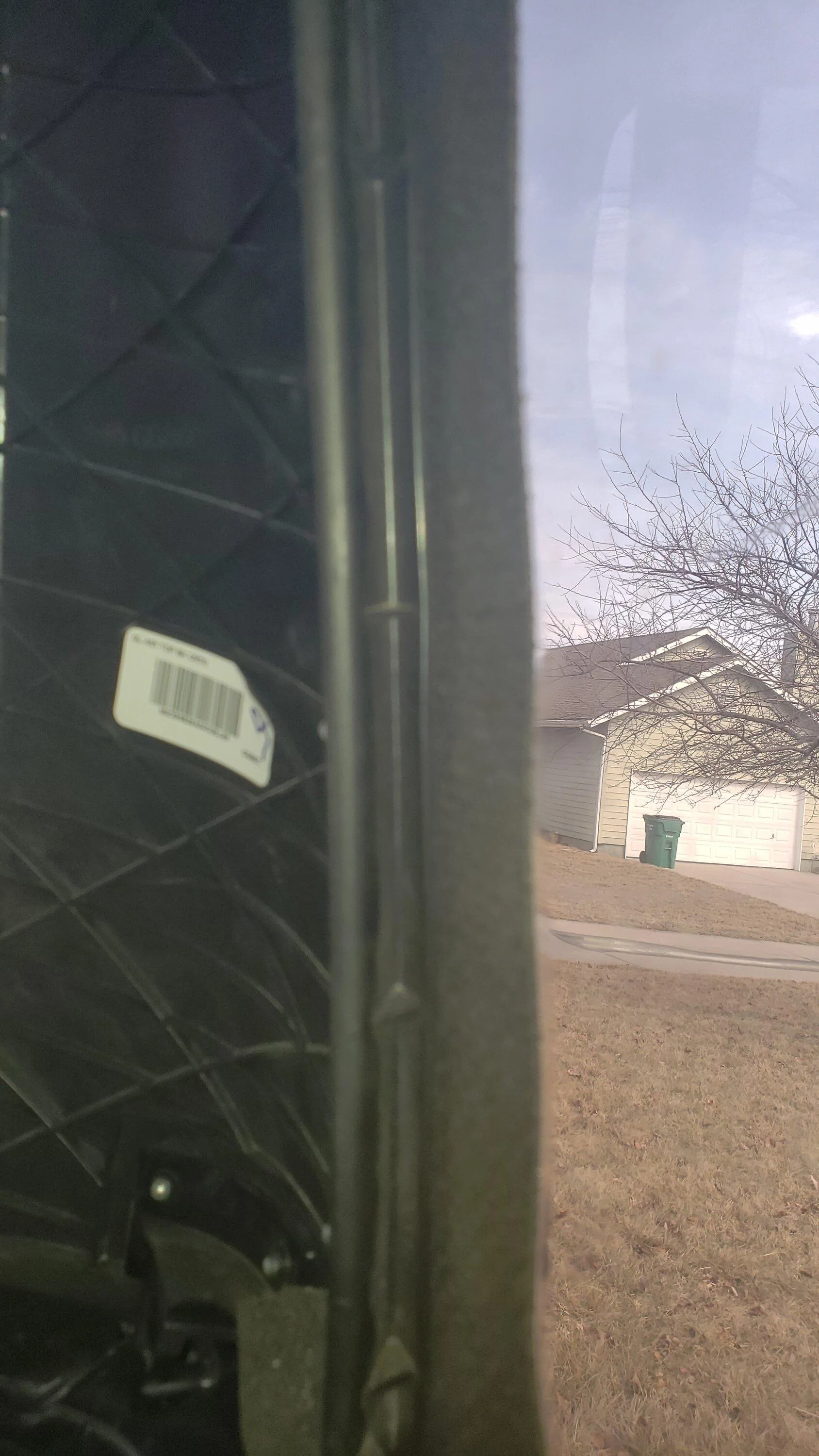

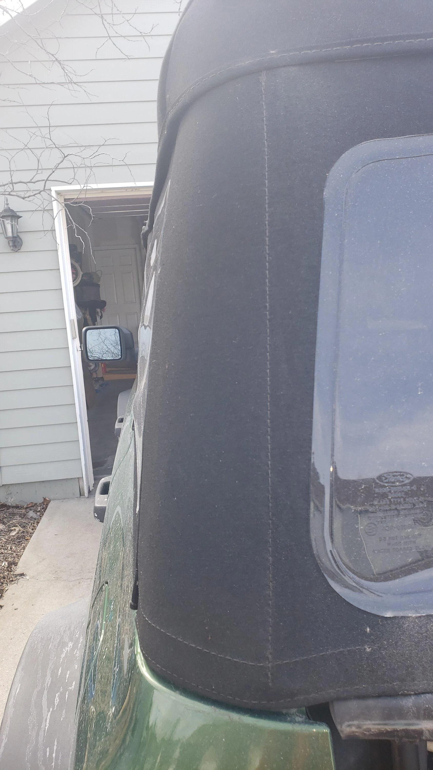

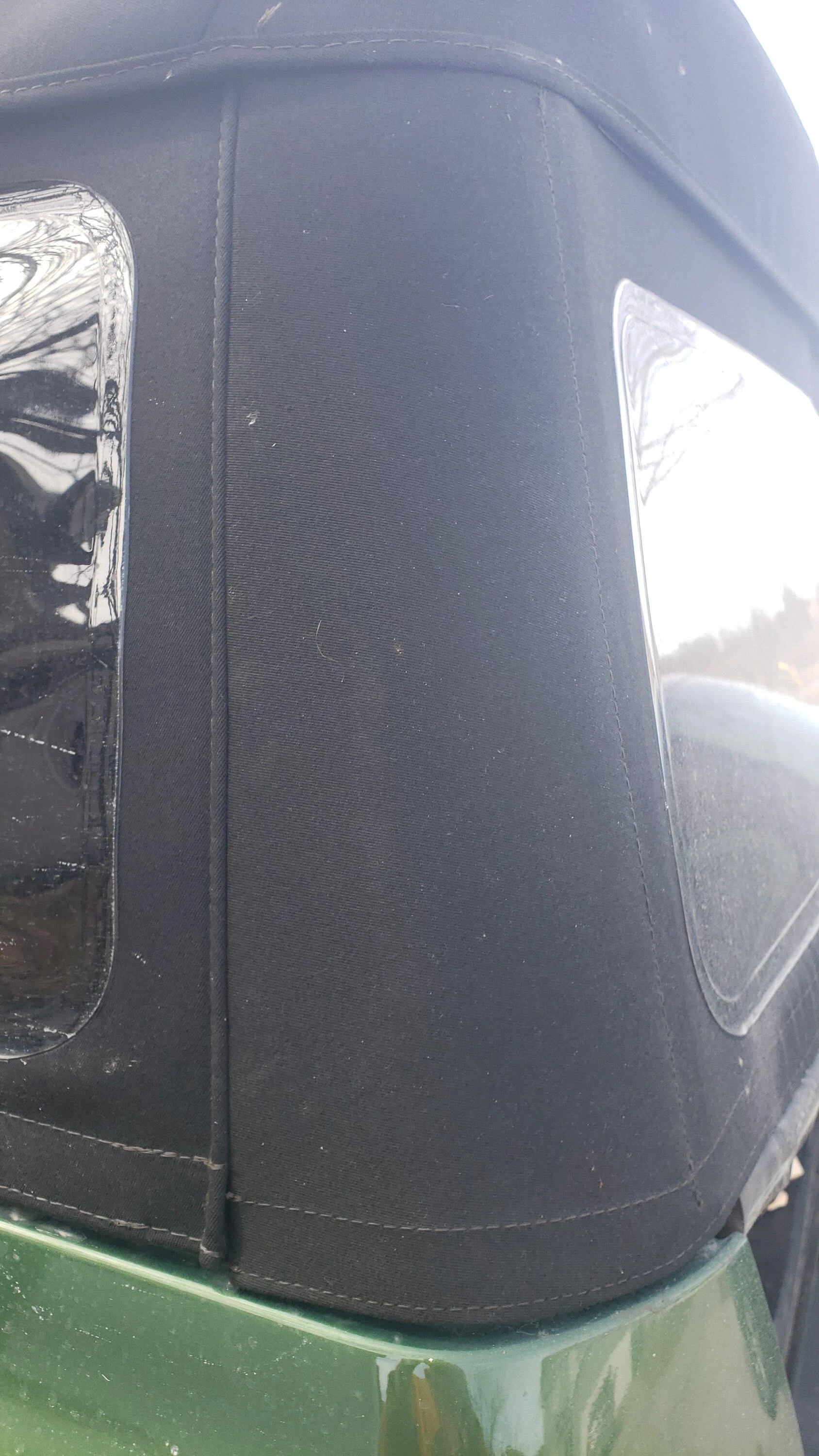

Sorry it took so long, and please ignore the messy rig!
But here are my photos
Ford Bronco Soft top broken tabs 20230218_125917
Ford Bronco Soft top broken tabs 20230218_125904
Ford Bronco Soft top broken tabs 20230218_125858
Ford Bronco Soft top broken tabs 20230218_125849

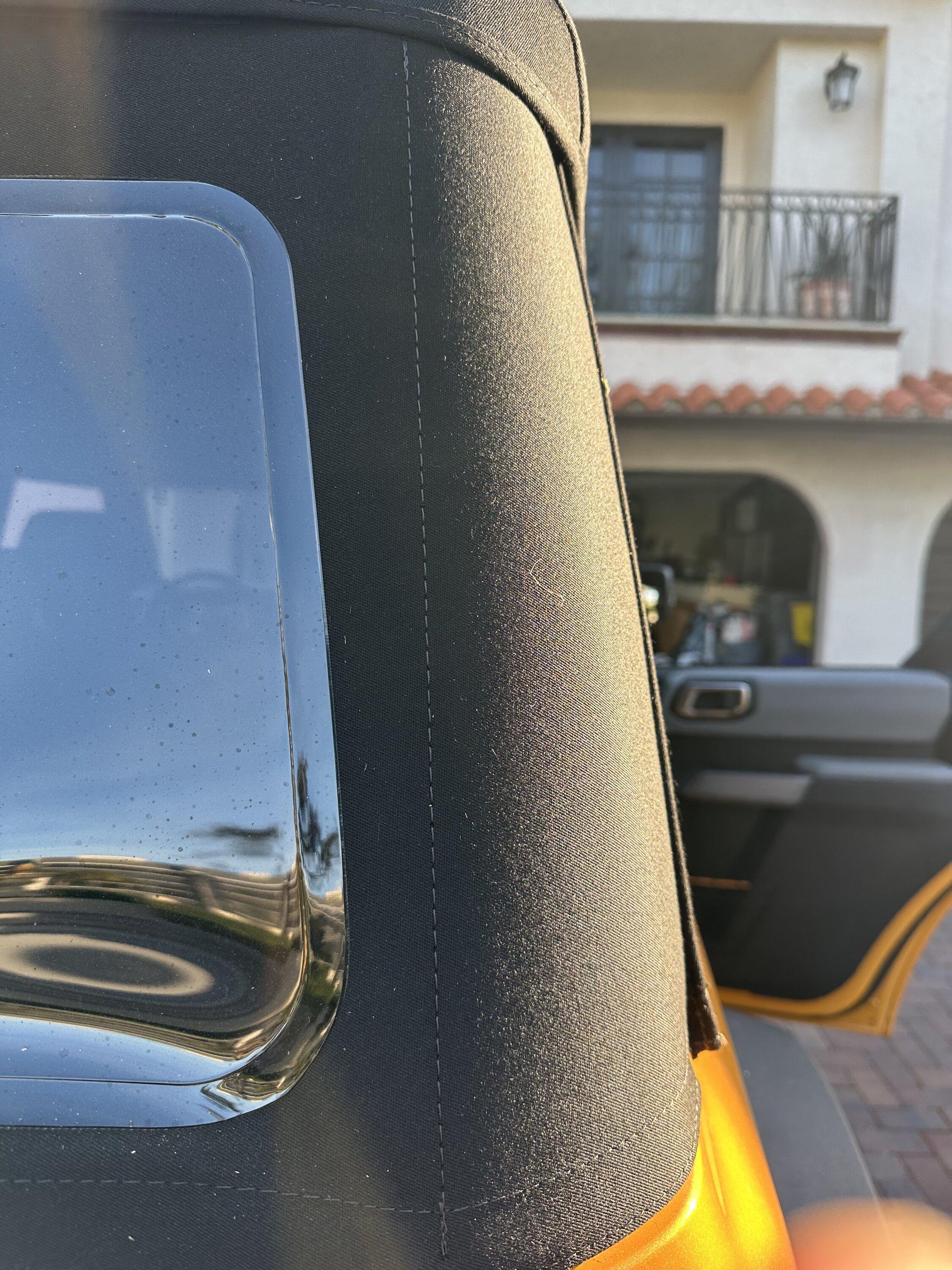

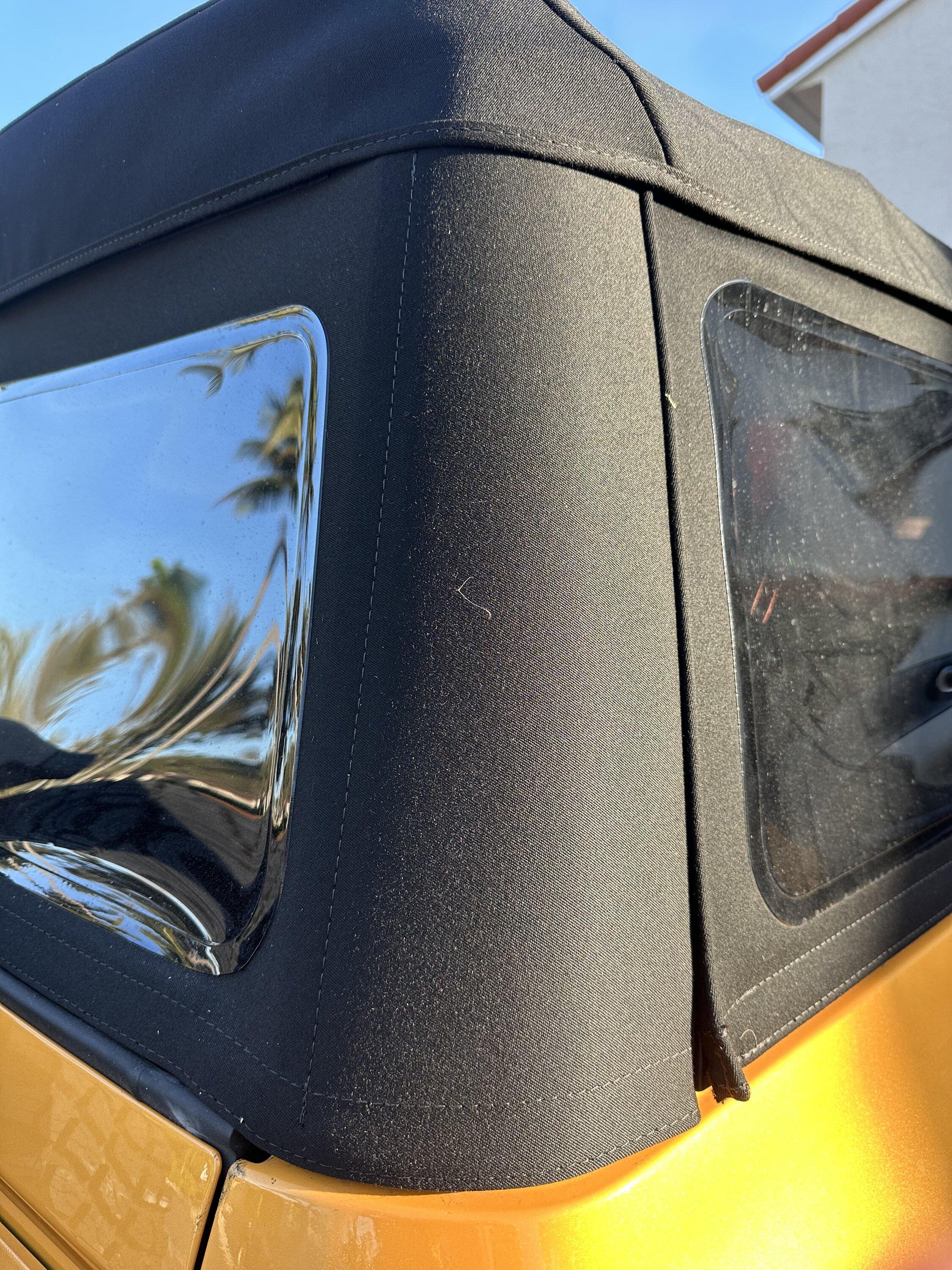

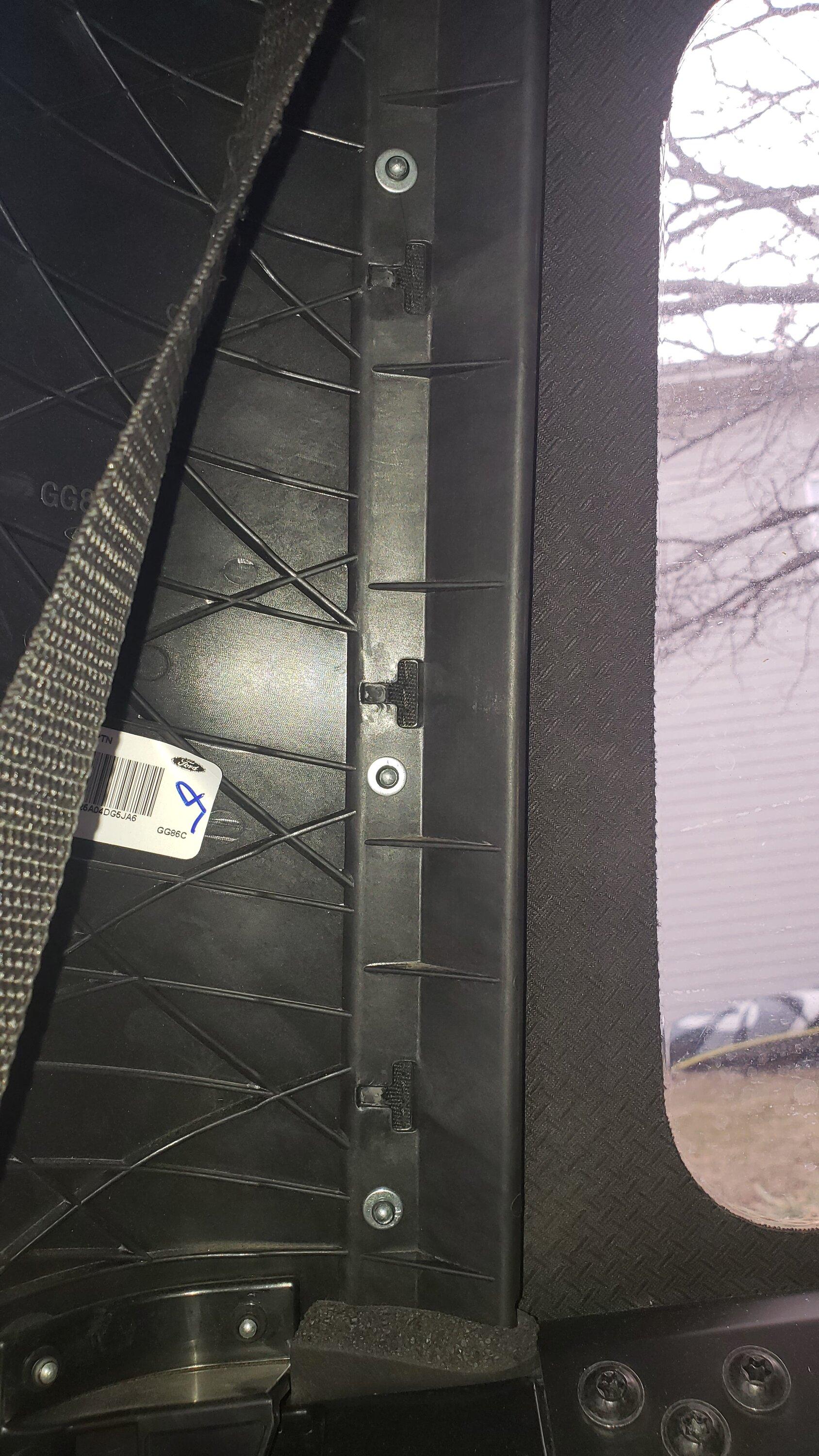

Ok just got mine back from Mulinax Ford Palm Beach and the second trip got the latest update from Ford. See pictures but this is way better look than the previous fix. Thanks to them for staying on Ford to get a better resolution.
Ford Bronco Soft top broken tabs IMG_1133
Ford Bronco Soft top broken tabs IMG_1132
Ford Bronco Soft top broken tabs IMG_1131
Ford Bronco Soft top broken tabs IMG_1130
