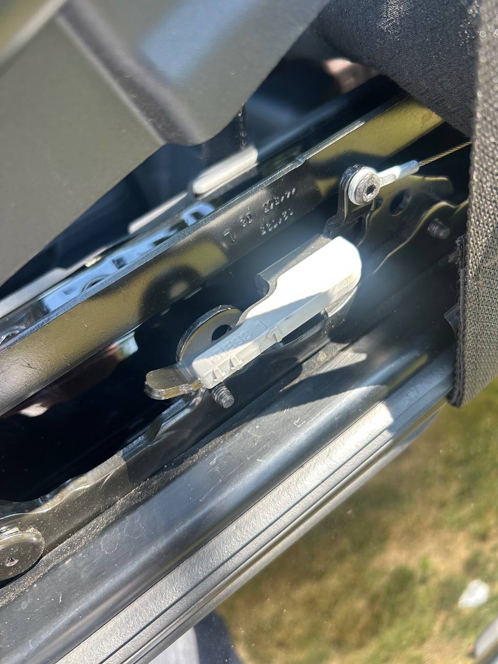

I put my soft top on new 2025 bronco and I thought I had all of the necessary latches but the latch for the soft top behind the driver seat is missing. Does anyone know if you can get this part?
See pic, this has nothing to latch into.

Hey Chris, you need a bracket for each side. The driver side has the only lever, but they both need to be latched down when in place.
M2DZ-78515A53-B and M2DZ-78515A52-B, ~$35/ea from Ford direct. Keep in mind these parts don't come with the securing bolts, just the bracket itself.
