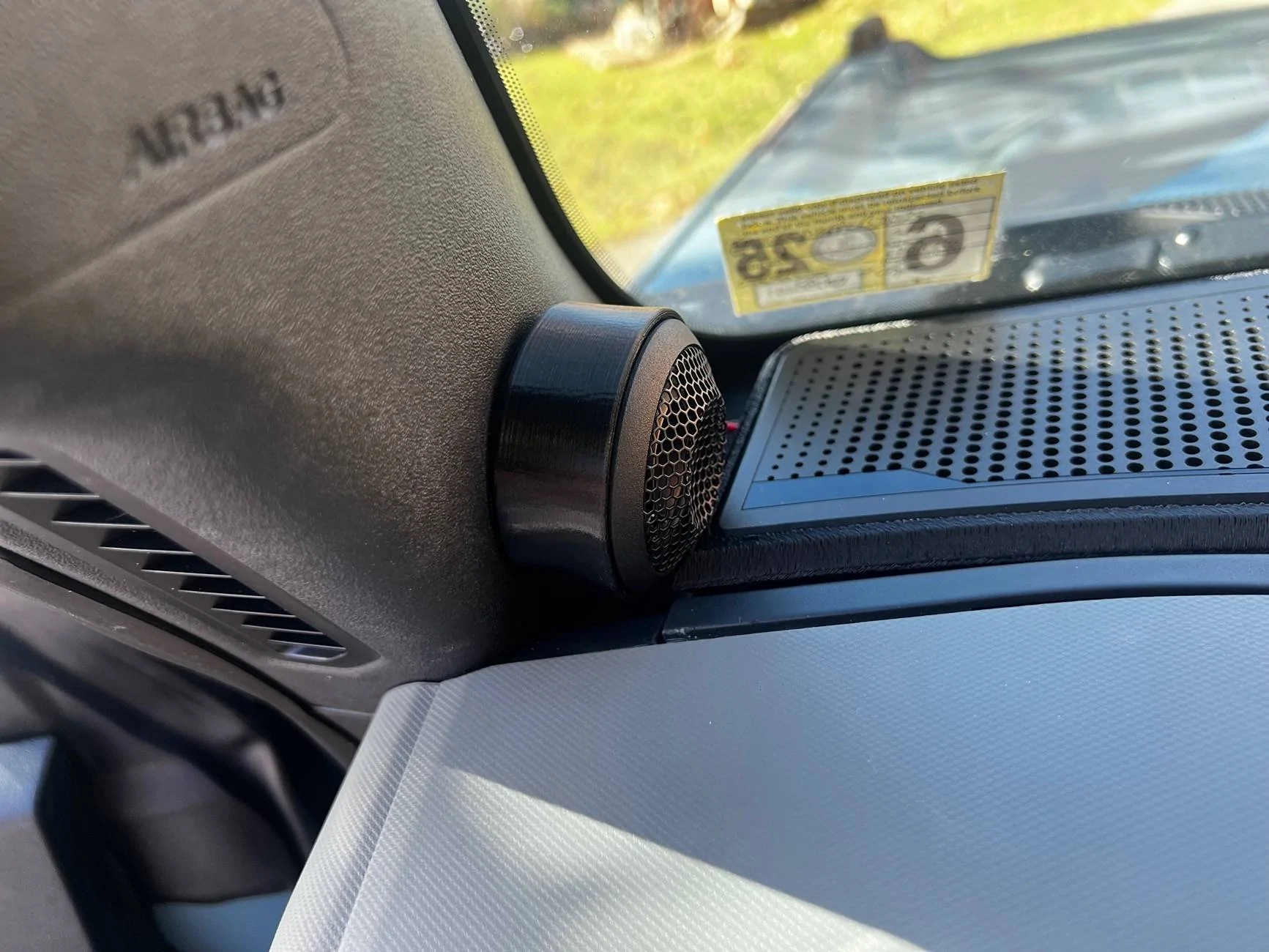

Have you seen these before? Only fits a single driver up to 3.5 inches, so should work for most tweeters.
https://customspeakerpods.com/store...er-a-pillar-21-23-ford-bronco-speaker-pods-2/
So I ended up finally getting the mti 2 way dash adapters and installed them. My tweeters ended up being absolutely terrible off axis ( focal frak) so I had my buddy print me some type adapter to off to the side of dash area and it sounds way better. It honestly looks pretty decent for now. I’ll keep an out for other setup ideas but as of now there just isn’t much out there.
In reference to a tweeter, off-axis generally means that the tweeter is mounted on the a-pillar, and pointed directly at the opposing tweeter. Mounted on-axis, the tweeters would be aimed at the driver.
What are you powering the drivers with, and are the drivers active or passive?
Musway m6 DSP. So 70 watts active crossed at hpf @ 3000 linkwys 24db
That's definitely an issue with tuning, or lack thereof, not the tweeter reflecting off the windshield. Who tuned the system, and with what?
Reflecting off the windshield can cause cancellations in certain frequency ranges, but not across an entire frequency range. For instance, with a midrange driver, it might cause a 4dB cancellation (null, dip) at 1,600Hz.
Normally, distance between the speaker and the windshield, and the angle of the windshield are variables, but the Bronco's windshield is borderline vertical compared to most vehicles.
If you intend to keep the tweeter as-is, you probably want them closer to ear level, and about 15 degrees off-axis for the smoothest response.
Tweeters and midrange drivers in the dash is not ideal, but that's what we have to work with, and can sound amazing with a good tune.
