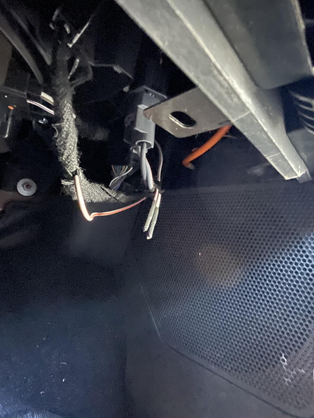

Hi,
I just looked under the foot well in front of the passenger front seat. I took a pic of the floor speaker. I see a pair of electrical wires poking out. Any idea what these are? I'd like to tie them down with a ziptie, etc - but don't want to ruin anything. Or should they even be there - should they be connected to something? I haven't done any speaker work or any mods in that area, this is as-is from the factory:

Those are Aux switch wires.

Look like Aux switch wires to me

Those are pre-wired into the engine compartment by where the aux wires are. They are not connected to anything.

got it - aux switch wires. Thank you!
