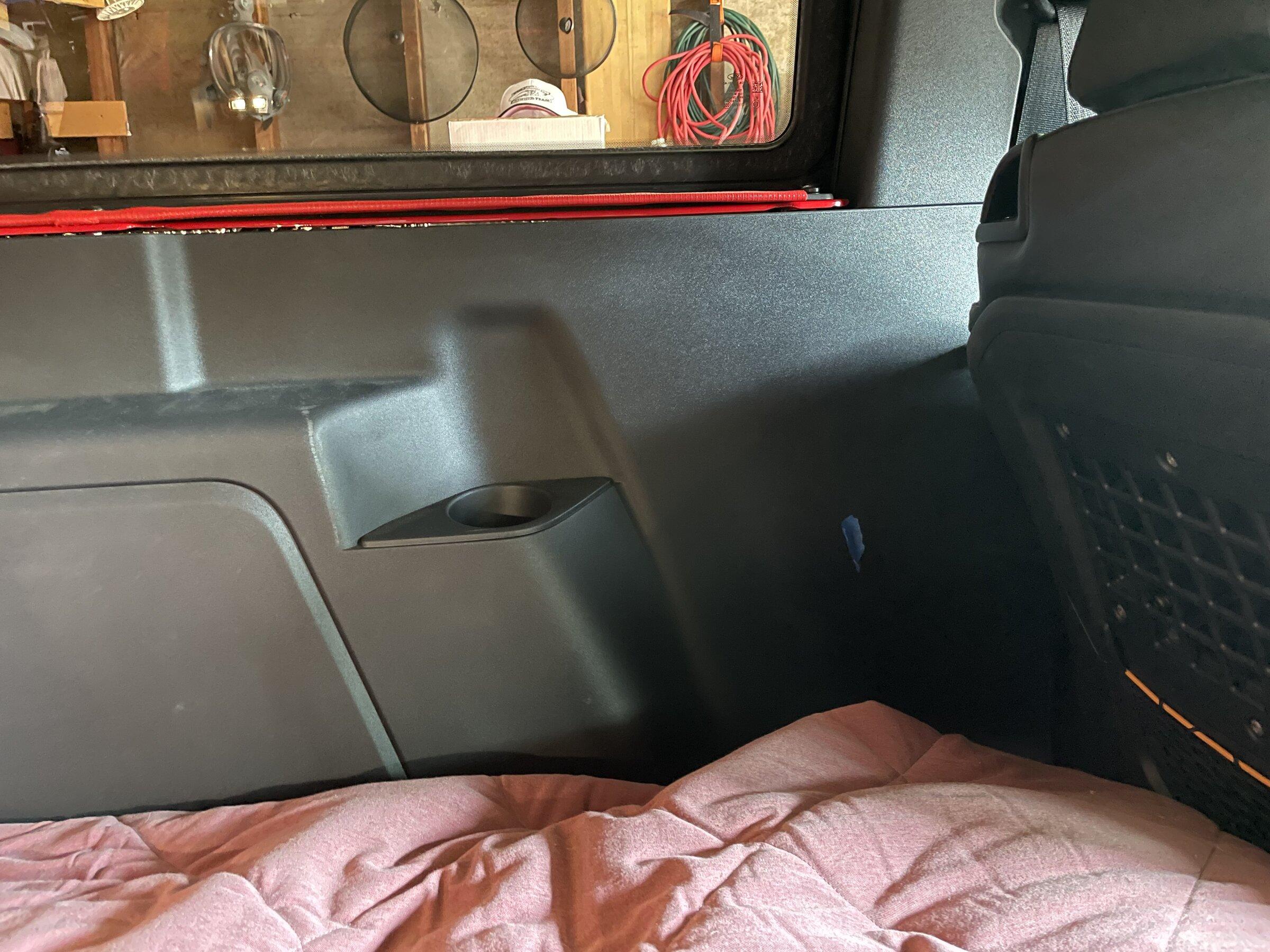

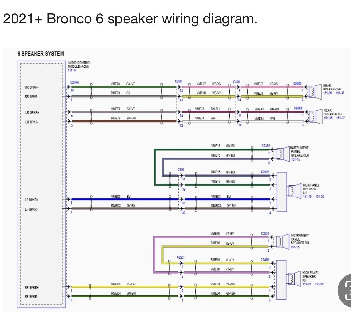

Okay, for the rear pods the wire ends in the passenger pod. That wire runs over to the driver rear pod along the upper roll bar under the plastic. Then forward to the middle roll bar, then down behind the driver seat. There is a big harness you may be able to tap into. It’s pretty much where the little price of blue tape is.

I didn’t read every reply, but both rear speaker wires run under driver side door sill. I have my amp under driver seat, quick and easy splice.
