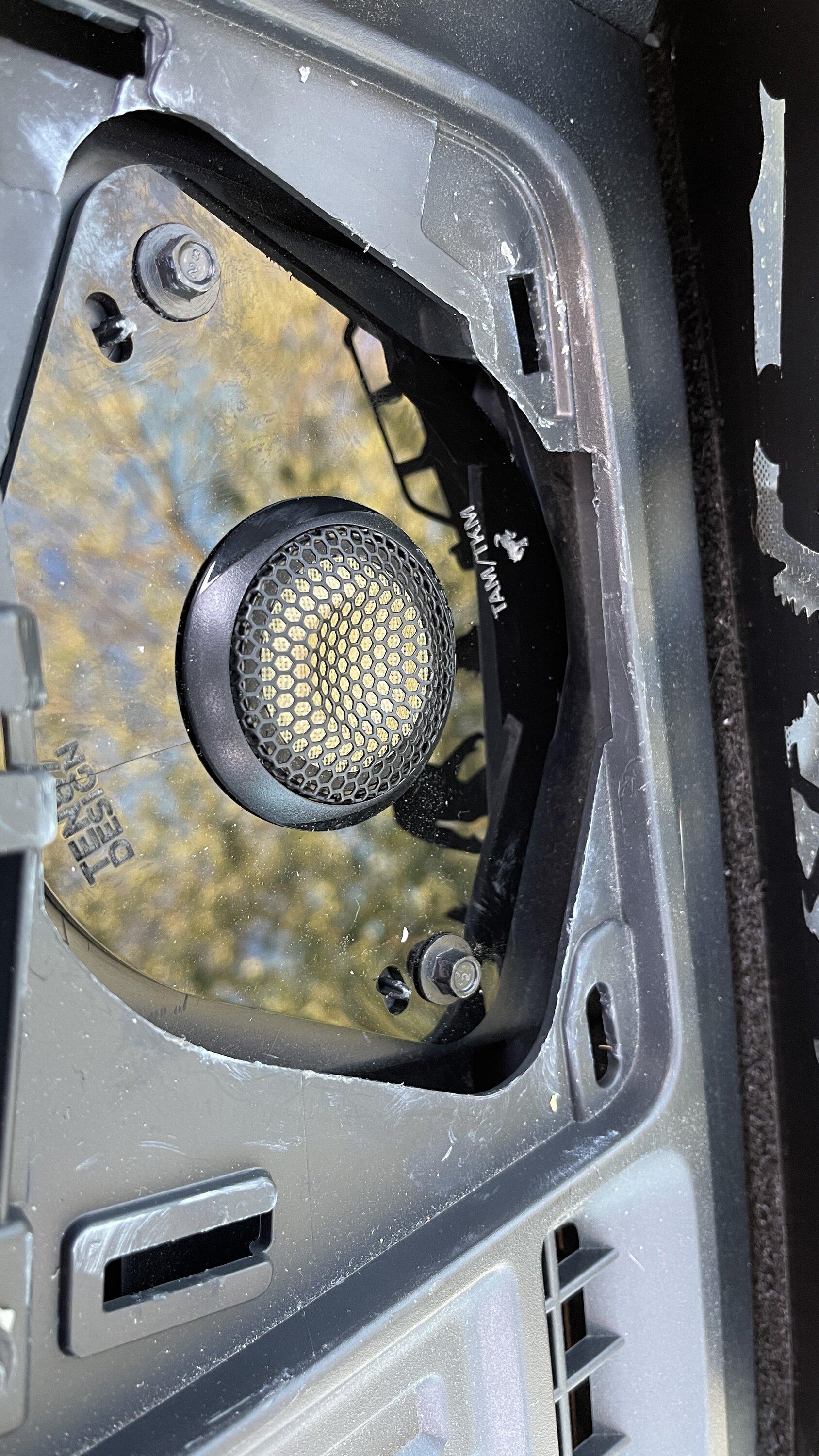

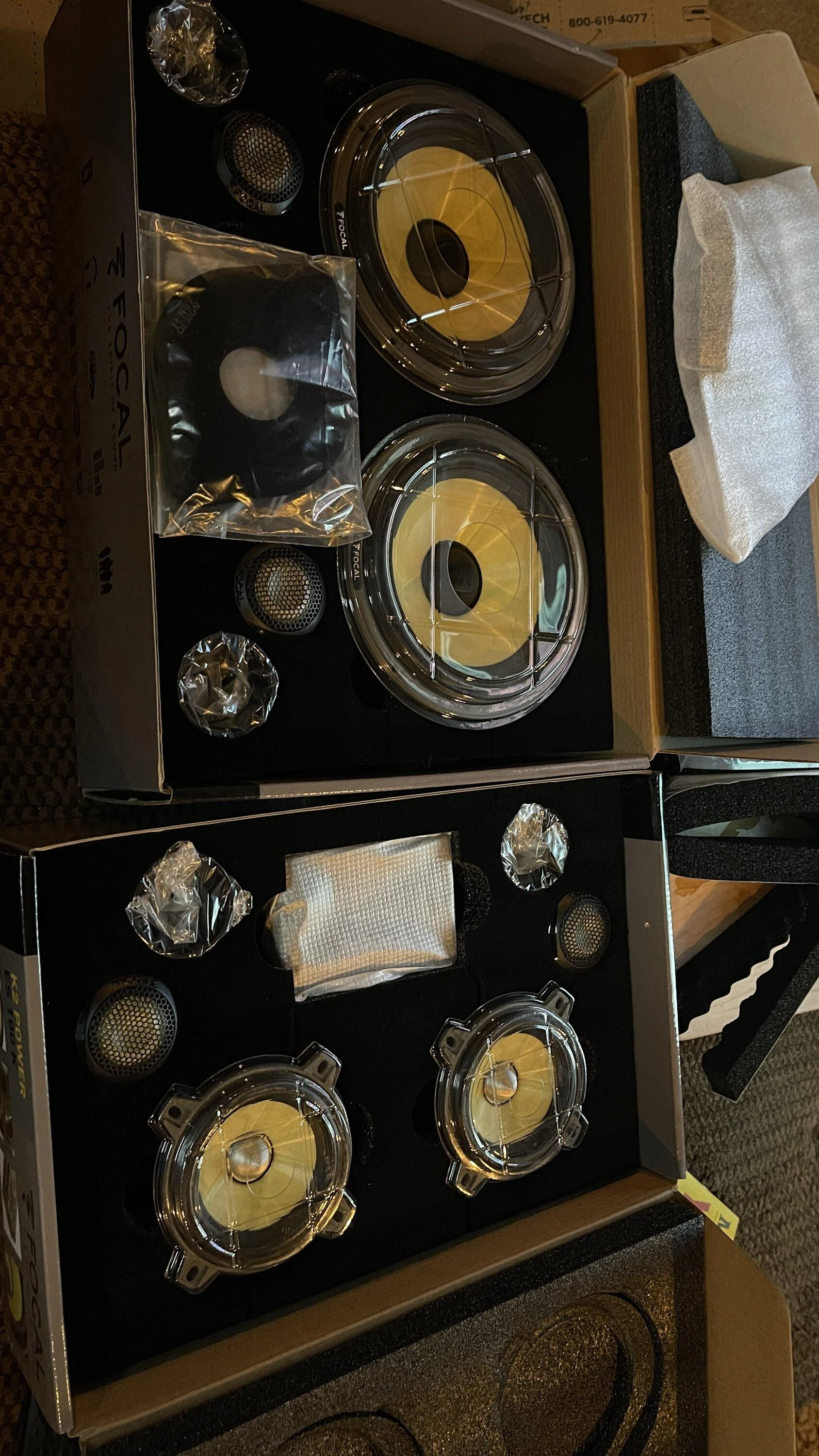

Rather than get new pods, I had Focal K2 4" components installed by having a hole drilled in the pod for the tweeter.
Ford Bronco Replacement rear speaker pods to house 5.25” speakers? F217D80C-0C2B-48A2-AE5C-6F5B0C48CEAC

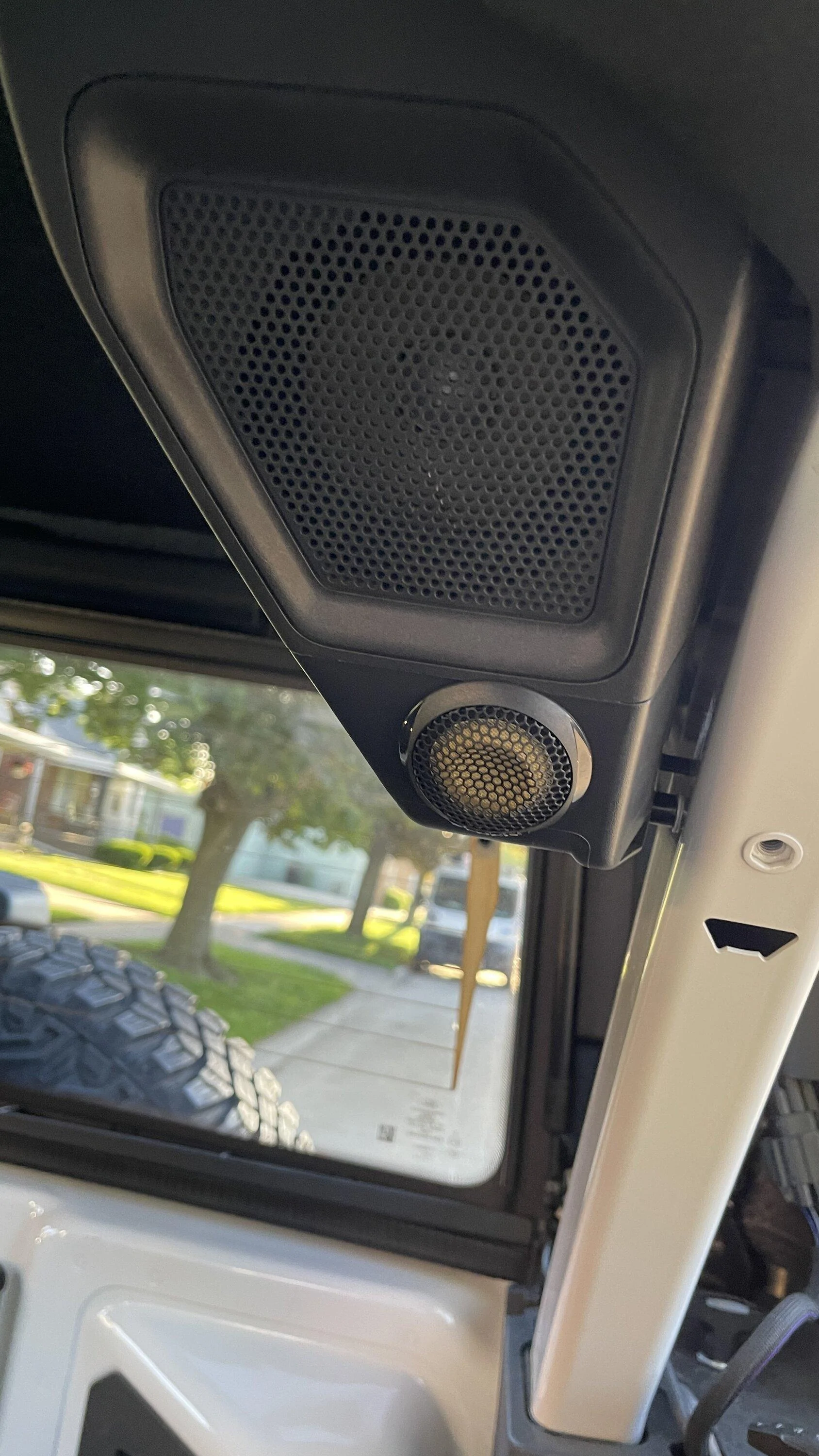

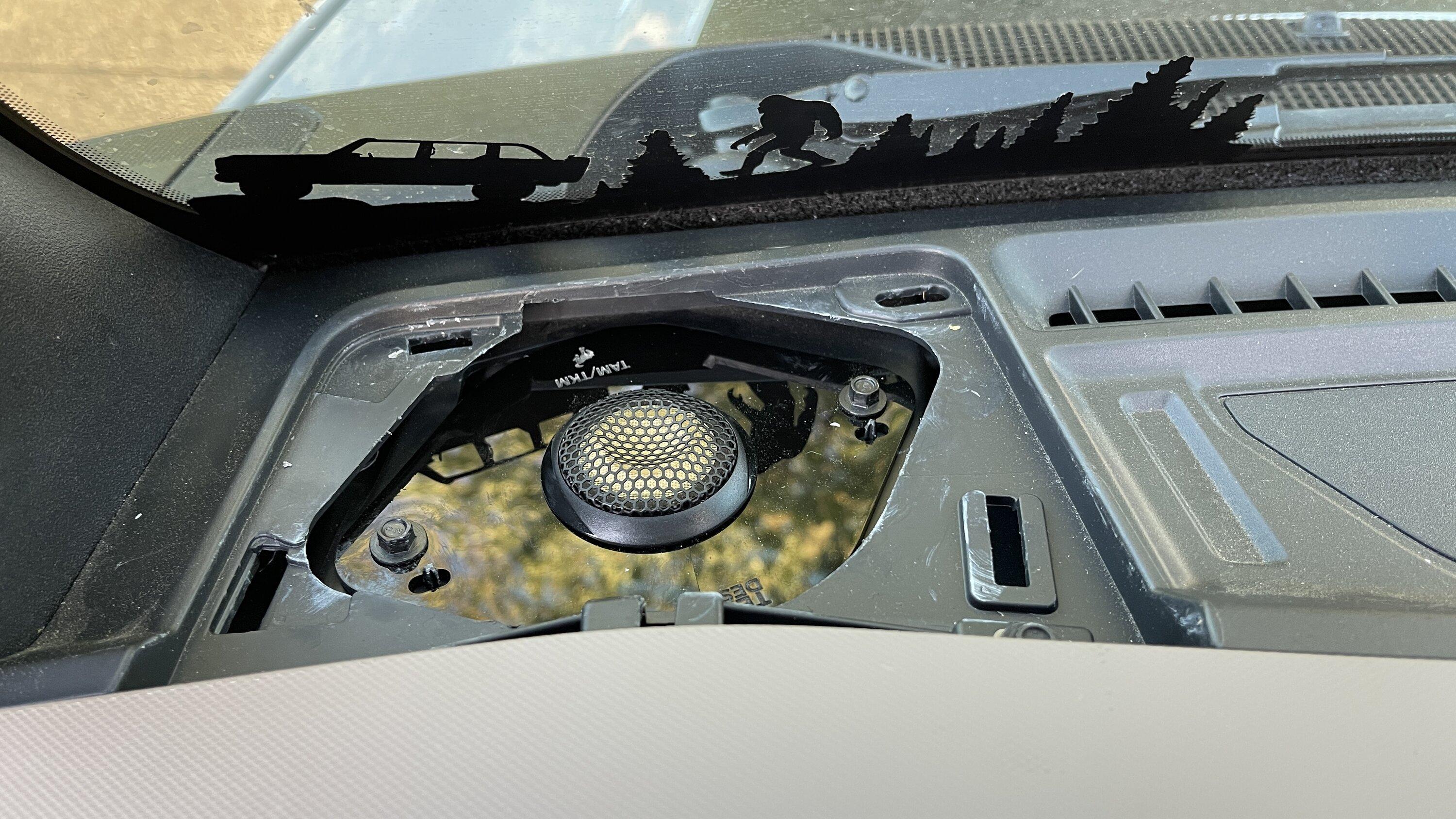

I also had a 6-1/2" component set installed up from and replaced the dash speakers with the tweeters.

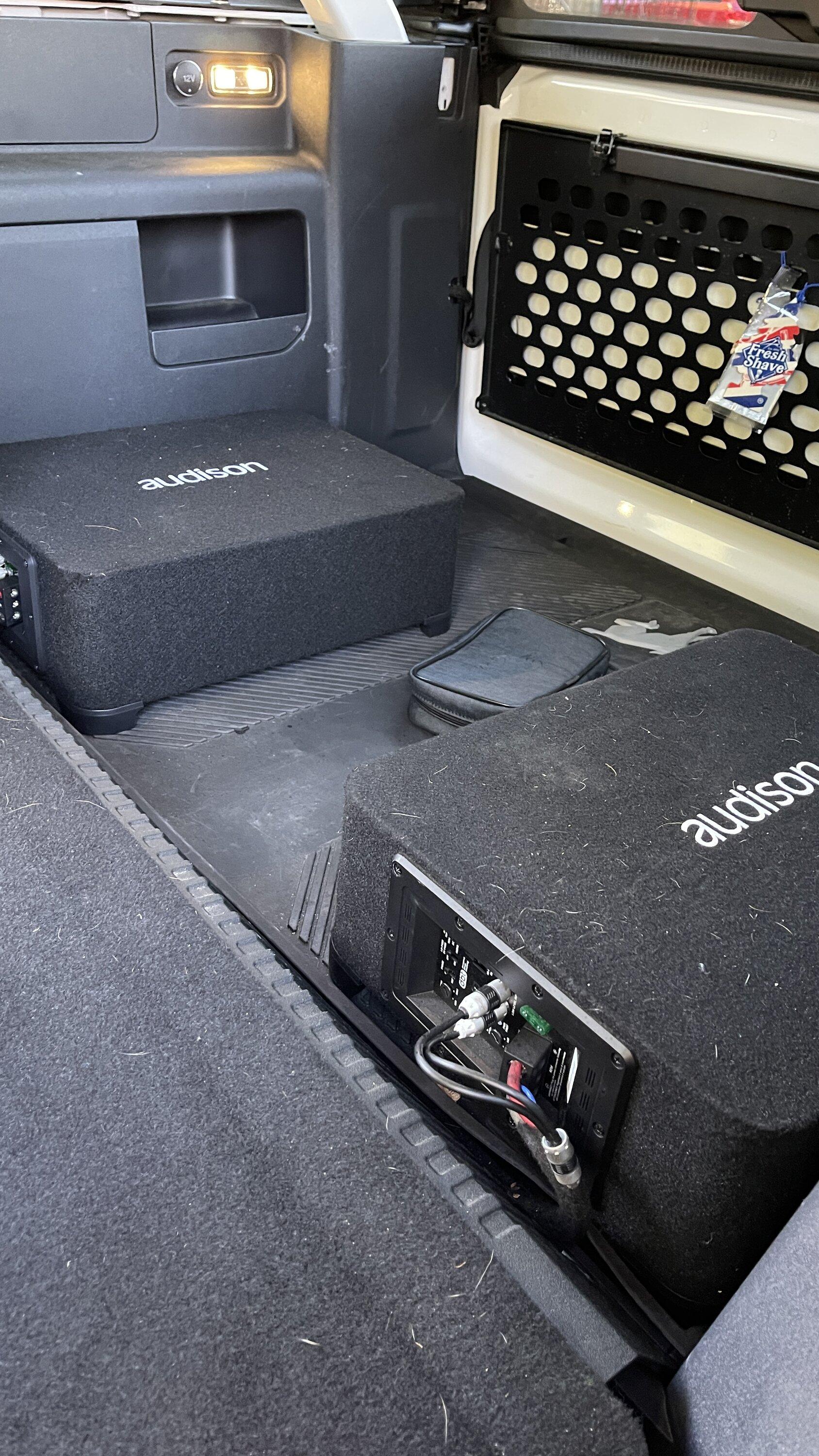

Nice components! What subwoofer did you use? Focal is very high quality but the tweeters can be overly 'bright' if not adjusted properly.

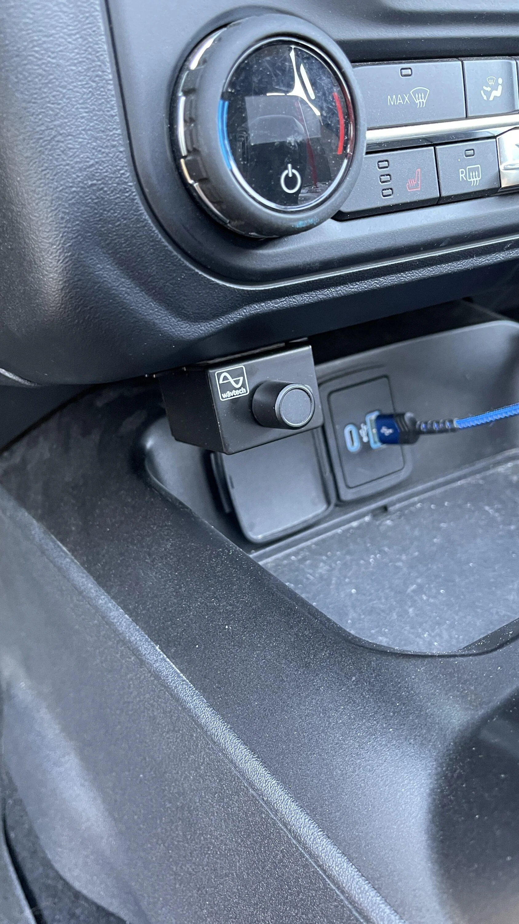

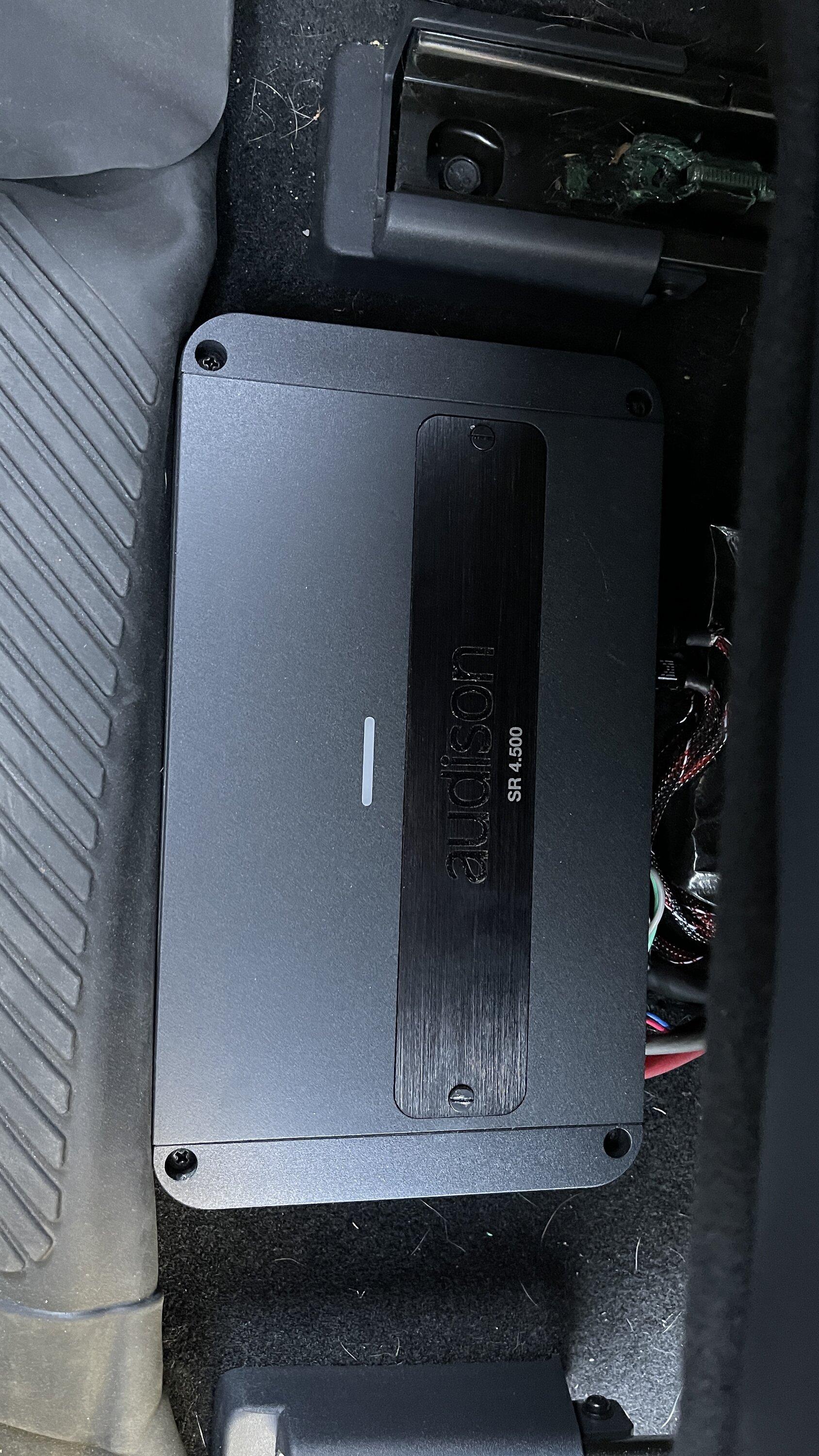

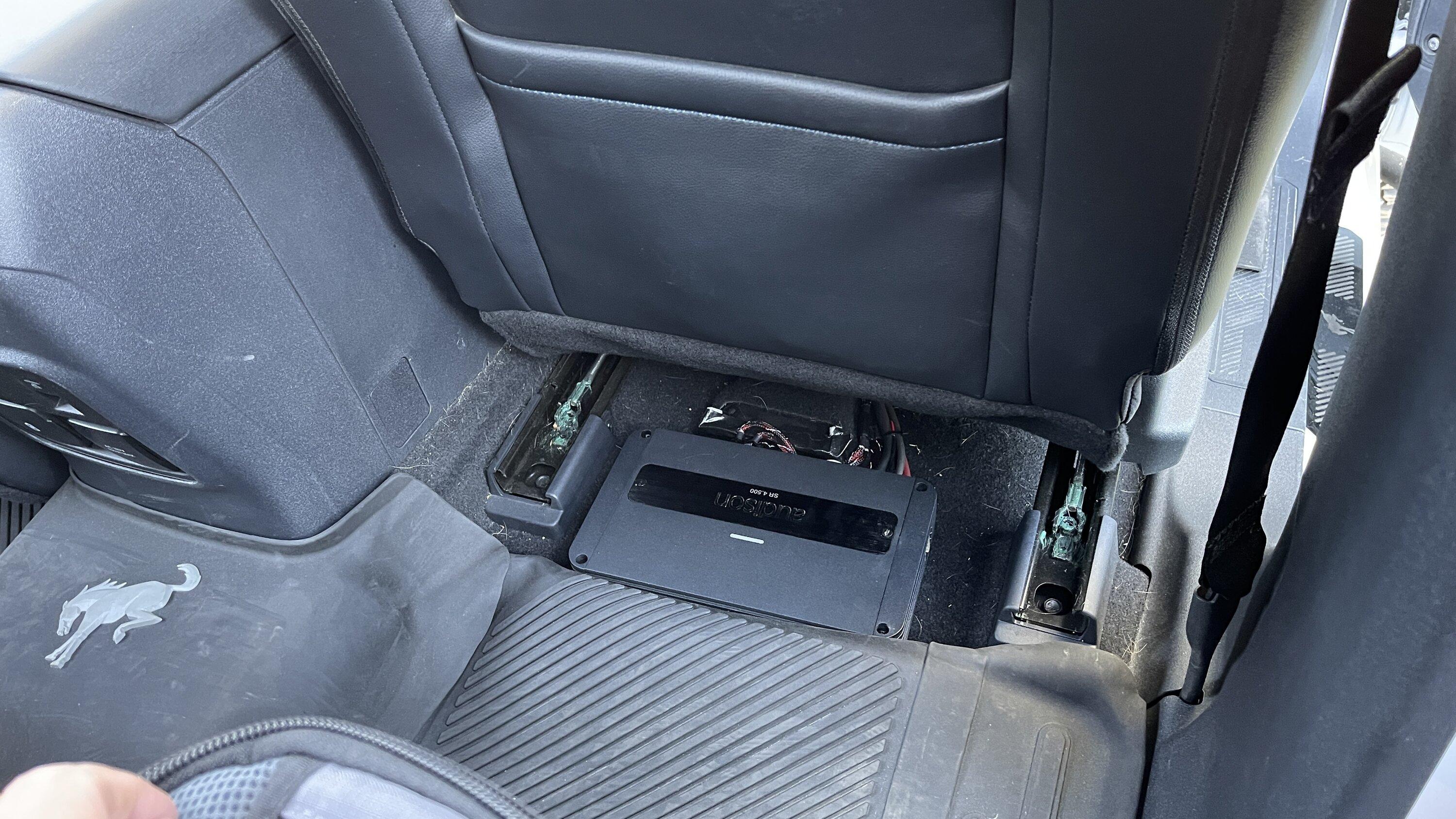

I have two (2) Audison loaded powered 10" subwoofers and a Audison 4-channel amp all tied into a Link6 6 channel line output converter and processor. The Link6 has a subwoofer volume control so I can control the base.
This is my 2nd round as my first setup wasn't as loud with my roof off. With this setup, you can hear the radio loud and clear with the roof off at 70mph plus!

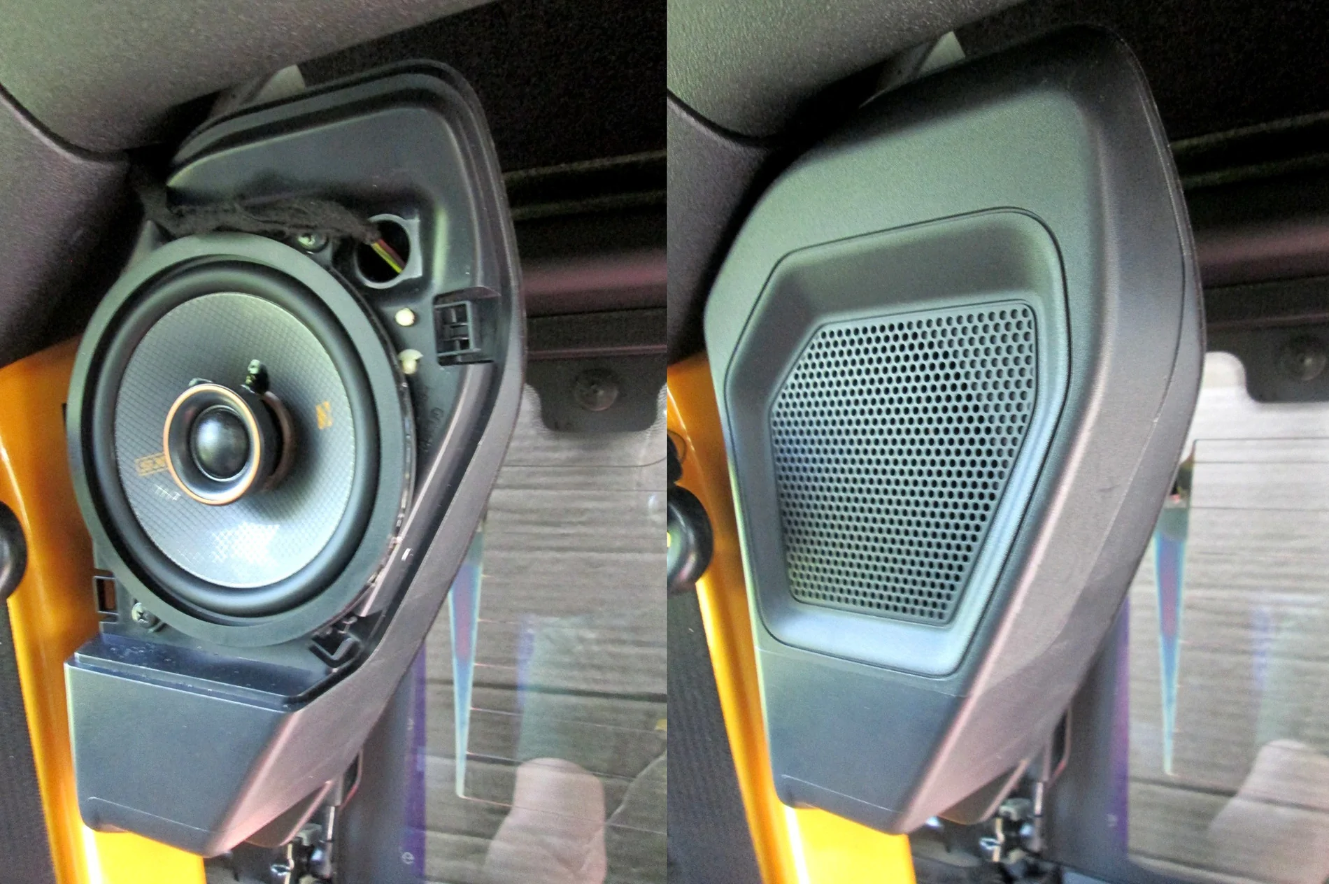

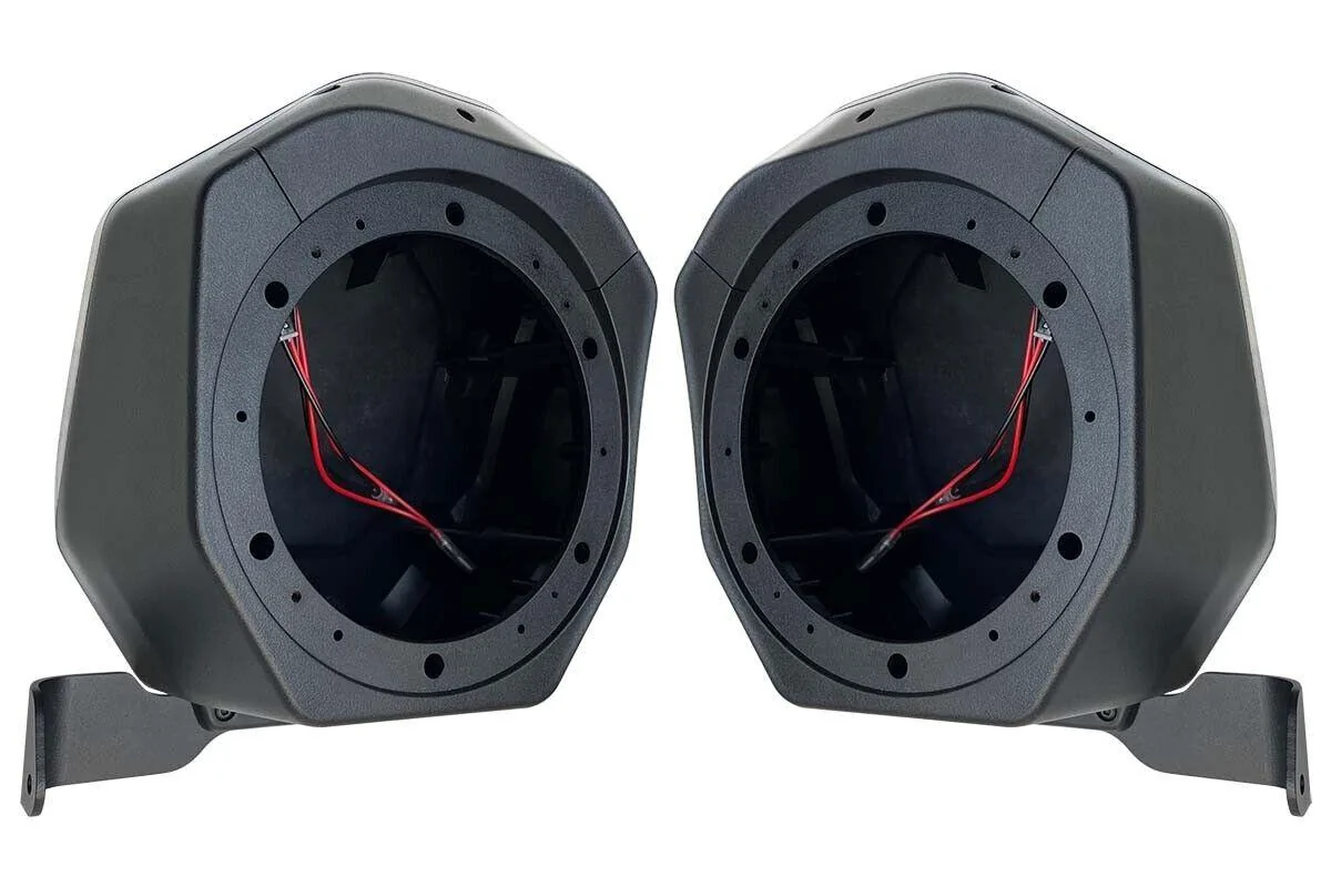

I'm looking to replace my rear pods as well but my main concern is size. Any recommendations on the the smallest pods I can get to replace the stock ones? Preferablly just plug and play.

I'd love a 6 1/2 or even a 6x9 set of rear pods. The Focal 6x9s in the doors of my Jeep actually produce a lot of bass and with the ForScan update delivering full range to the rears it may be just enough to alleviate my belief that a sub is needed.

Where did u install the crossovers? Did u replace the rear pod speaker wires? If so, then how did u do it?
