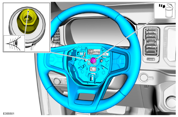

@flip is this a direct replacement? Disconnect the battery, transfer airbag, switches, and trim ring over? Is there a special tool or will a standard puller work?
I have 62,000 ford pass points burning a hole in my app and this might just be worth spending them on.
Have not done one but we've sold a couple and none have been returned. Should be GTG.
Steering Wheel
Removal
NOTE:
Removal steps in this procedure may contain installation details.
NOTE: Make sure the steering wheel and the road wheels are in the straight ahead position.
NOTE: Heated steering wheel shown, others similar.
  1. Remove the driver airbag.
    Refer to: Driver Airbag (501-20B Supplemental Restraint System, Removal and Installation).

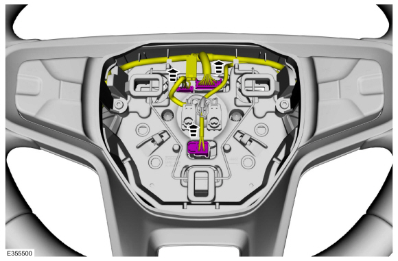

  1. Disconnect the steering wheel electrical connector(s).
Ford Bronco {thread} {filename}
  1. NOTE: Make sure the tick-mark on the end of the steering column shaft is on the top position.
    Remove and discard the steering wheel bolt and remove the steering wheel.
    Torque: 46 lb.ft (62.5 Nm)

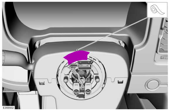

  1. Tape the clockspring rotor to the outer housing to keep it from rotating.
Installation
  1. To install, reverse the removal procedure.

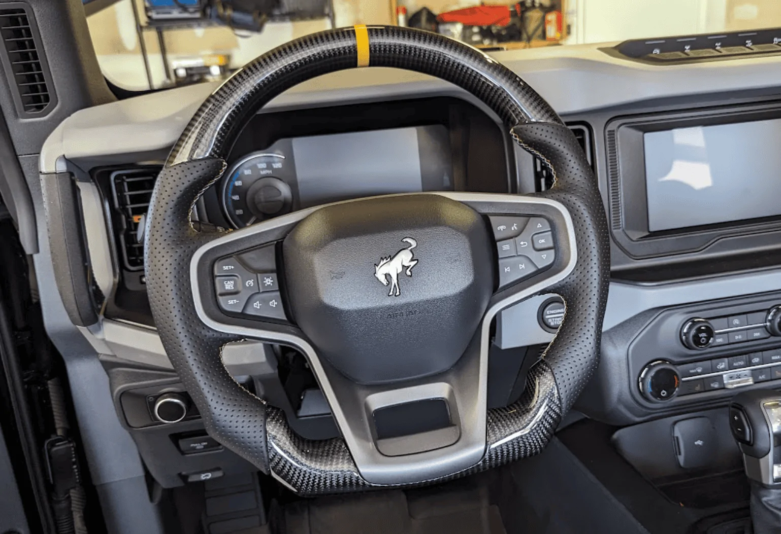

i HATED the feel of the stock wheel, so i did what i've done in my last 6 cars, gone custom. easier to keep clean, looks amazing, feels amazing. it came with a CF trim piece, but i always use the stock one. makes it look almost factory

cool steering wheel. who did the work and what did that cost?

  2. Disconnect the steering wheel electrical connector(s).

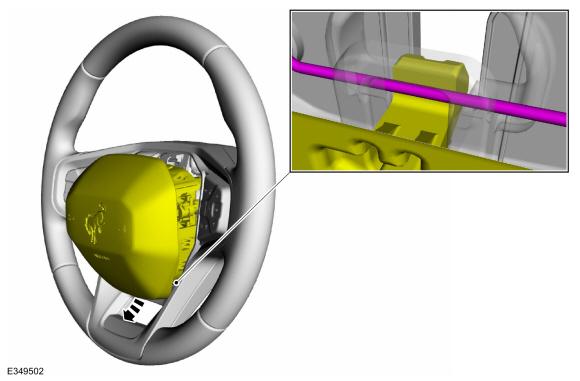

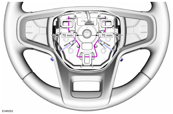

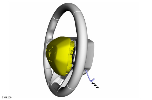

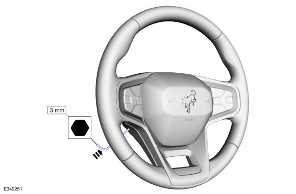

Driver Airbag
Removal
  1. Ford Bronco {thread} {filename}
    WARNING: The following procedure prescribes critical repair steps required for correct restraint system operation during a crash. Follow all notes and steps carefully. Failure to follow step instructions may result in incorrect operation of the restraint system and increases the risk of serious personal injury or death in a crash.
    Refer to: Pyrotechnic Device Health and Safety Precautions (100-00 General Information, Description and Operation).
  1. Depower the SRS .
    Refer to: Supplemental Restraint System (SRS) Depowering (501-20B Supplemental Restraint System, General Procedures).
  1. NOTE: To prevent binding, both of the driver airbag retainers should be released at the same time.
    On both sides.
    At the side of the steering wheel cover, locate the hole and insert a 3 mm (0.125 inch) hex key.
  1. NOTE: The driver airbag has been removed for clarity.
    Contact the hex key to the spring clip.

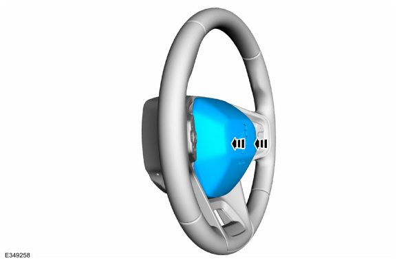

  1. On both sides, at the same time.
    Push in on the steering wheel spring clip to release the driver airbag retainer.
  1. Position the driver airbag down and release it from the steering wheel spring clip.

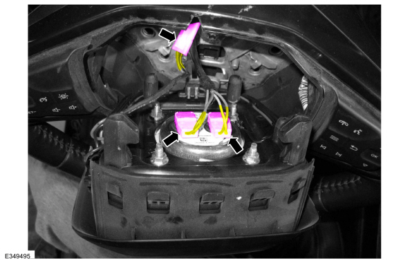

  1. Disconnect the electrical connectors and remove the driver airbag.
Installation
  1. Connect the driver airbag electrical connectors.
  1. Align the driver airbag to the steering wheel and push in, engaging the driver airbag retainers to the spring clips.
  1. Repower the SRS
    Refer to: Supplemental Restraint System (SRS) Repowering (501-20B Supplemental Restraint System, General Procedures).
i got this one from carbontastic, was $1500, no core required. they got a bunch of options, type of carbon and the finish, what material you want and where for the leather areas, stitching colors, 12 o'clock strip color and design, etc...
a few weeks after i placed my order, i saw that archetype racing started selling carbon wheels too, for about half what i paid, but core exchange needed. only a few options for customization though, but hard to argue with the price difference.
Where’d you buy that from?
it is beautiful but too rich for my blood.

  1. Repower the SRS

  3. NOTE: To prevent binding, both of the driver airbag retainers should be released at the same time.
    On both sides.

  1. Repower the SRS
