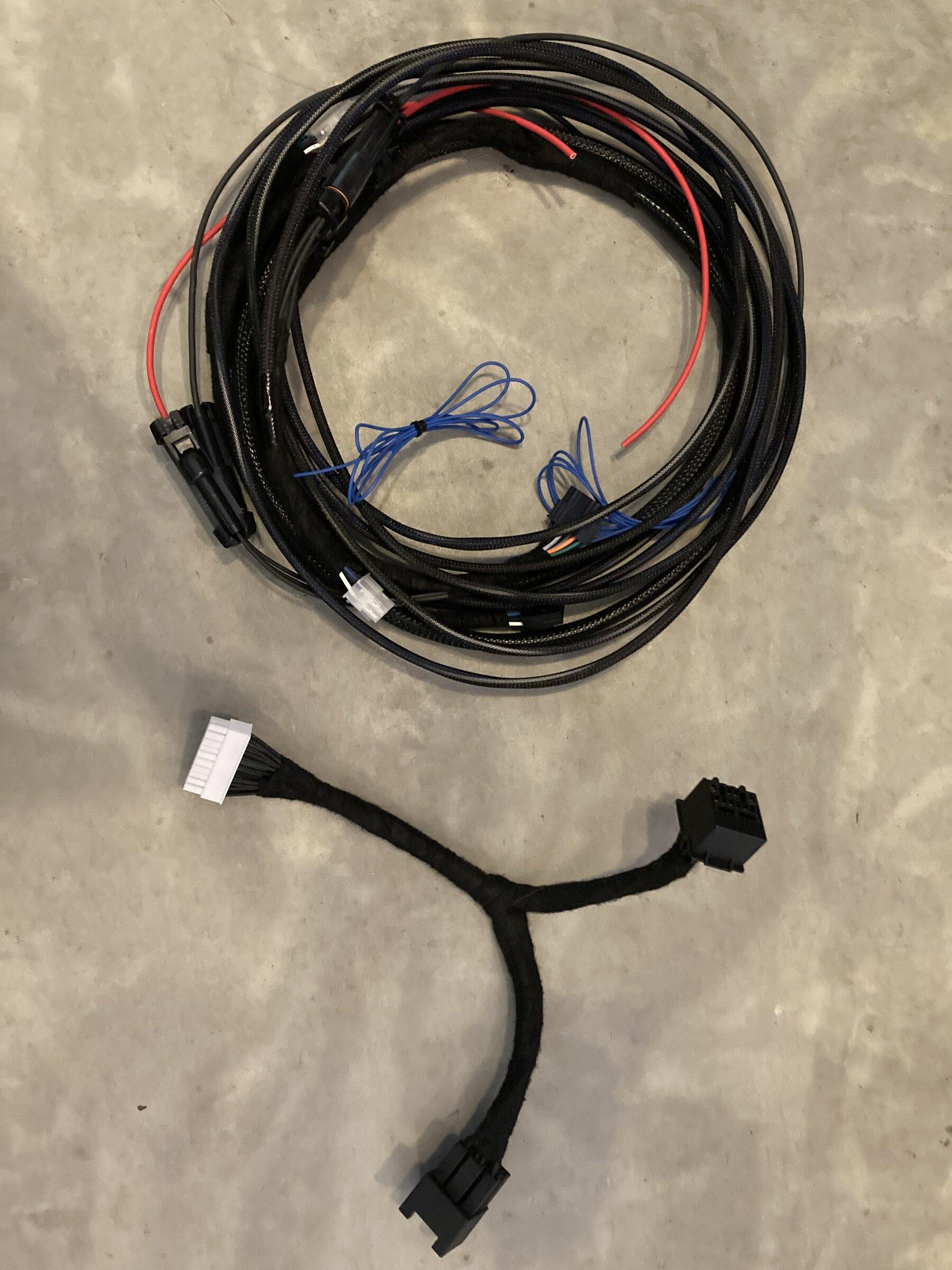

I know there are already several threads for stereo wiring harnesses and where to get them, but I wanted to add another option I hadn’t seen on the forum.
I ordered a wiring harness from:
https://hoelwiring.com/
I was able to chat with them on their site and have a harness made for a Kicker Key 200.4 and Kicker 8” Hideaway sub. This is now listed on their site along with several other options. It arrived today, and looks to be good quality. It should allow me to plug right into the amp and sub, and only run power and ground to be set up.

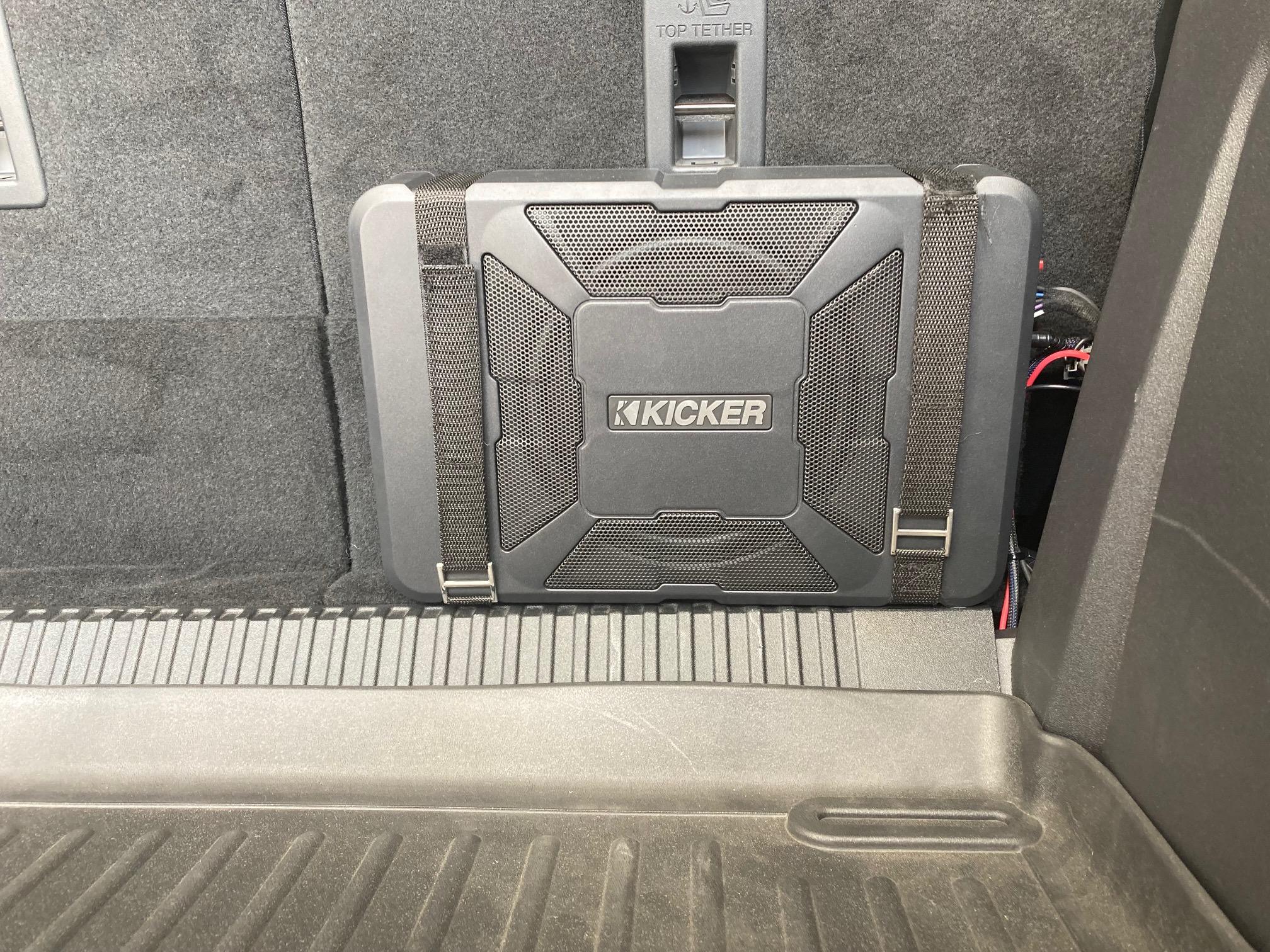

Which length kit did you get? I’m confused by the options, since the Kicker amp comes with its own power cabling.
I got this: https://hoelwiring.com/products/copy-of-ford-bronco-combo-key200-4-amp-hs8-10-subwoofer-harness
I got it with the 6' Kicker Key harness length (attached the amp under the steering column), the sub harness is 20', and 12" power and ground wires. I then ran my own power and ground wires and attached to the 12" pigtails. You could use the power and ground wires that come with the amp, or what I did was run them using some wire I already had and left the factory harness intact in the off chance I needed it down the road. I think the options for 6' & 20' power and ground wires are there if someone wants to order wire with the harness and not use what comes with the amp.
I do like that power and ground wires that's included in this harness have quick disconnects. I mounted the sub to the back of the back seat with the Velcro straps that come with the sub. If I'm going to a place where I'm concerned the sub would be stolen, it only take 15 seconds to unstrap the Velcro, unplug the harness, power and ground. Then I can just take the sub out.
