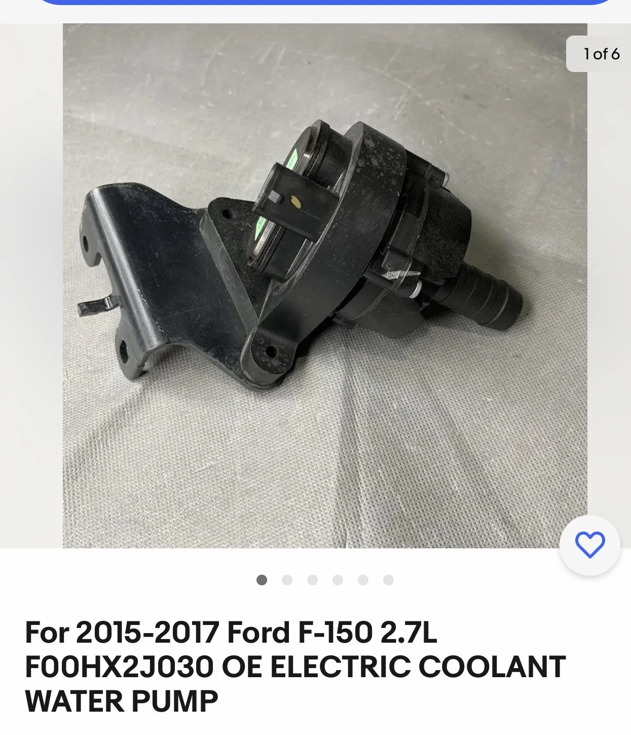

Normal operation, whine noise is probably the louvers rotating to the open position if you have a v6 it’s the electric coolant pump that pumps coolant through the turbo to help with cooling after shut down 😎

Wow - really - it has an electric coolant pump? I am guessing that is in addition to a standard mechanical pump too.(?)
Does yours making a beeeeeeeeeping sound, like:
beeeeeeep beeeeeeeeeeeeep beeeeeeeeeep
silence for a minute...
Like that?

Yeah usually it’s more constant
Like that?
It looks like this, it’s on the front of the motor up top. Usually it’ll run for 30 -60 seconds depends on how hot it is out side. The is just a secondary pump not your main water pump. Back in the day we had turbo timers now they have fancy pumps to do all the work lol.
