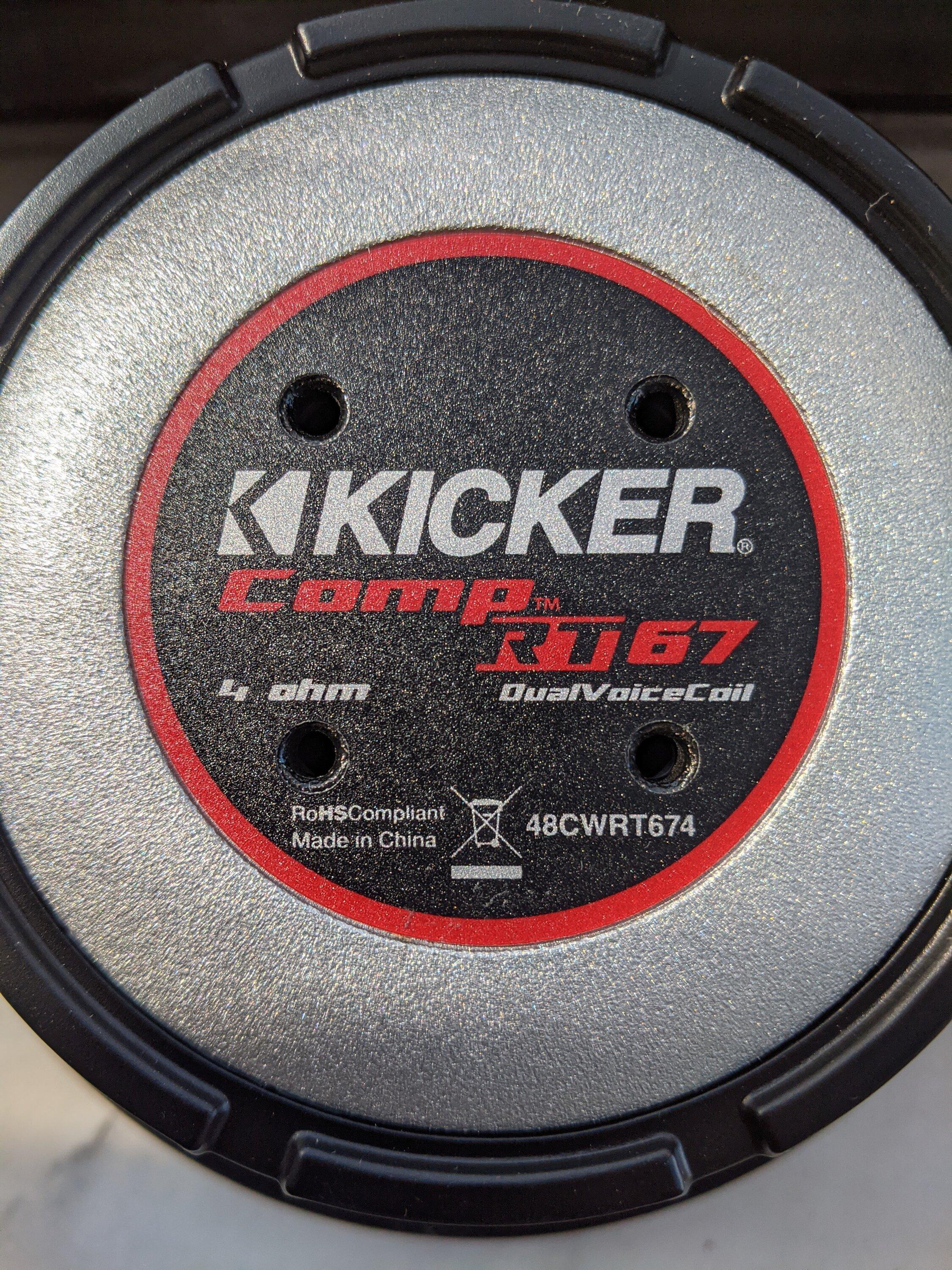

The kicker has two model numbers one ending in a 2 the other a 4. 2 & 4 ohm respectively. I ordered the 2 from Amazon. My came without a 2 or 4 on the box. I took a quick look at the instructions and it said it can be used as a 2 or 4 ohm. Not sure the details as it arrived late last night, it it look like it is how you wire it determines the 2 vs 4.
Yeah, no. While the way speakers and their driving amp(s) are wired can and do have a role in the way the circuit operates from the amp's standpoint it isn't the same thing as whether a speaker is (as designed/built by the MF) a 2 or 4 Ohm (or 8 or 1, etc.) speaker.
This is a picture of the Kicker 48CWRT674, Kicker's 6.75" 4 Ohm subwoofer. Note that both the full model number (with the "4" suffix) AND the "4 ohm" rating are displayed on the sub.
