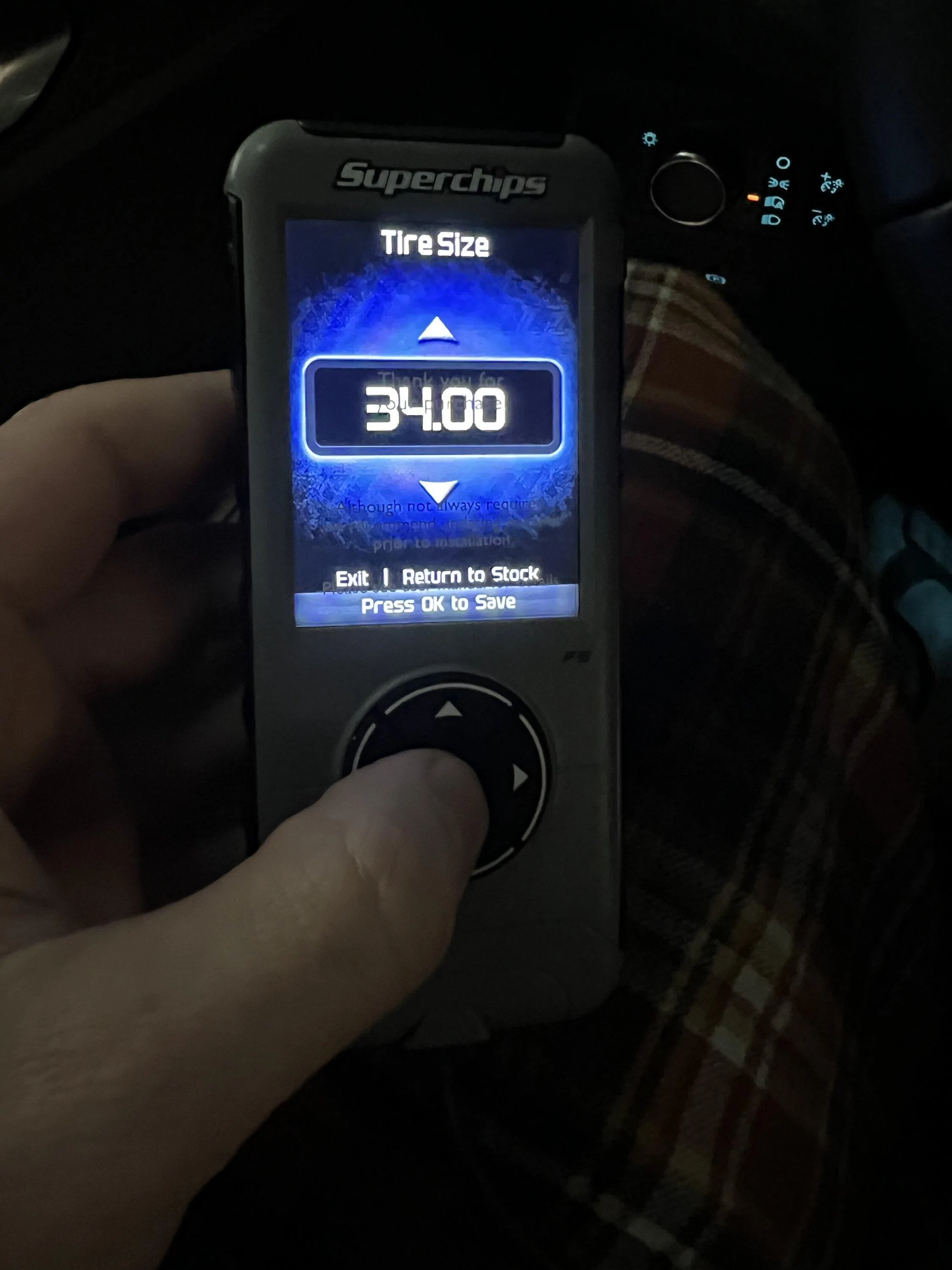

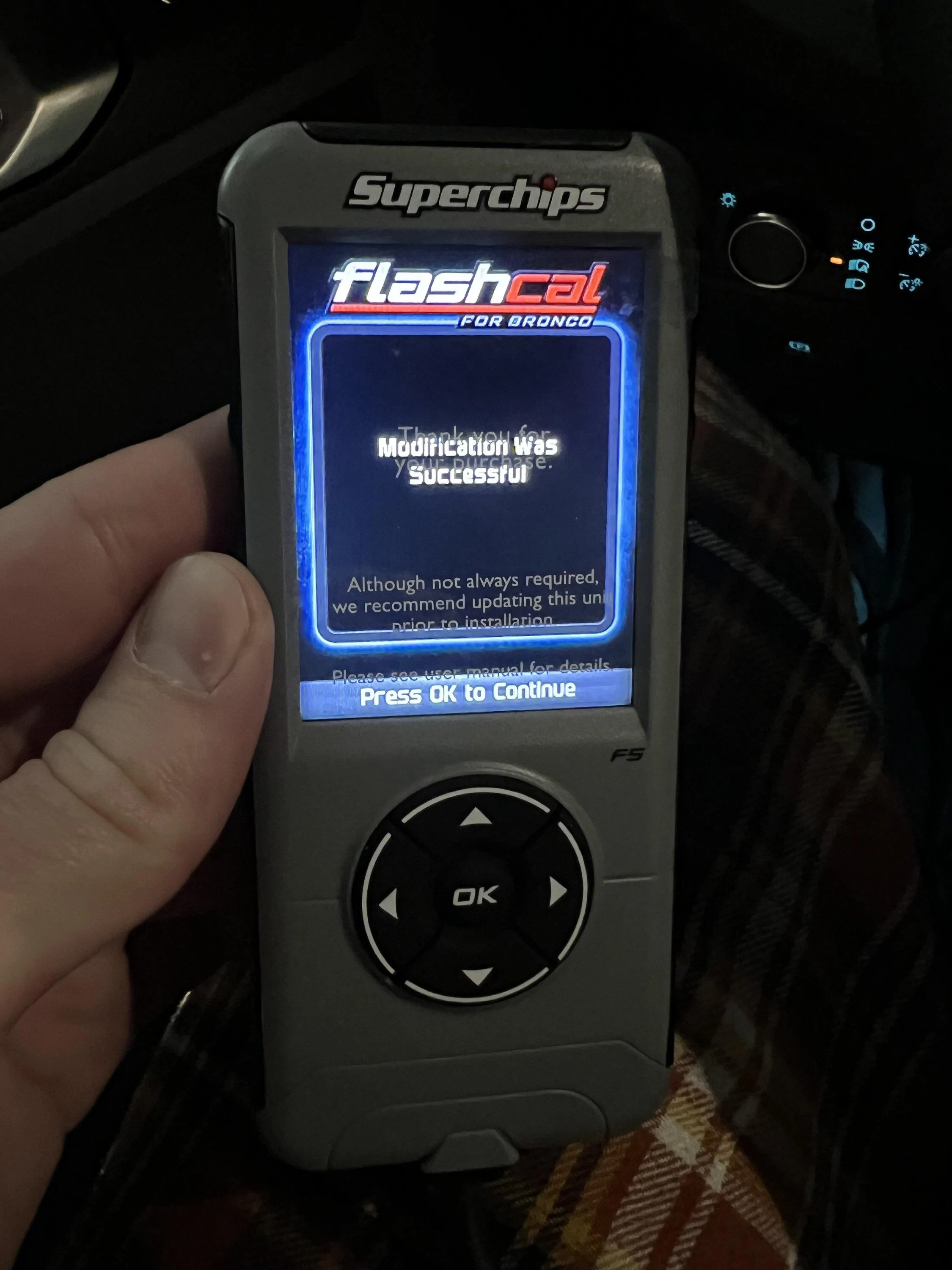

So I got mine and tried it out. I tried the tire recalibration to (34) and at first it gave me the service 4x4 error (my heart sank into my stomach). I think that’s my bad as I thought I needed to unplug the unit from the OBD port so I did that as I thought I read to try and unplug it after each change but I realized I didn't go through the full cycle...
Then I moved on from that and tried other options, it seems I got the auto start/stop disabled and the double honk gone successfully as per the module. Will test those out tomorrow.
Then I tried again for the tires.
It automatically cleared the DTCs!
I did the process again and it said successful.
But when I go back to the tires option, it defaults to the size 32.
Does that mean it’s set at the stock 32 size or that’s just what the Flashcal will show and I’m actually good and all set at 34?
My Flashcal did the same thing on the tire size ie. reverted back to OE size. The only thing that I could make work with the Flashcal was disable double honk. Guess I will have to wait on an a software update from Holley.....

So the auto start-stop disable worked, the double honk removal worked, set TPMS for front & rear down a few PSI, and...I checked my speed via waze and the speedo is just 1mph off! So seems it worked as far as the tire calibration? Maybe it just always defaults to show you 32.00 as the starting point?
