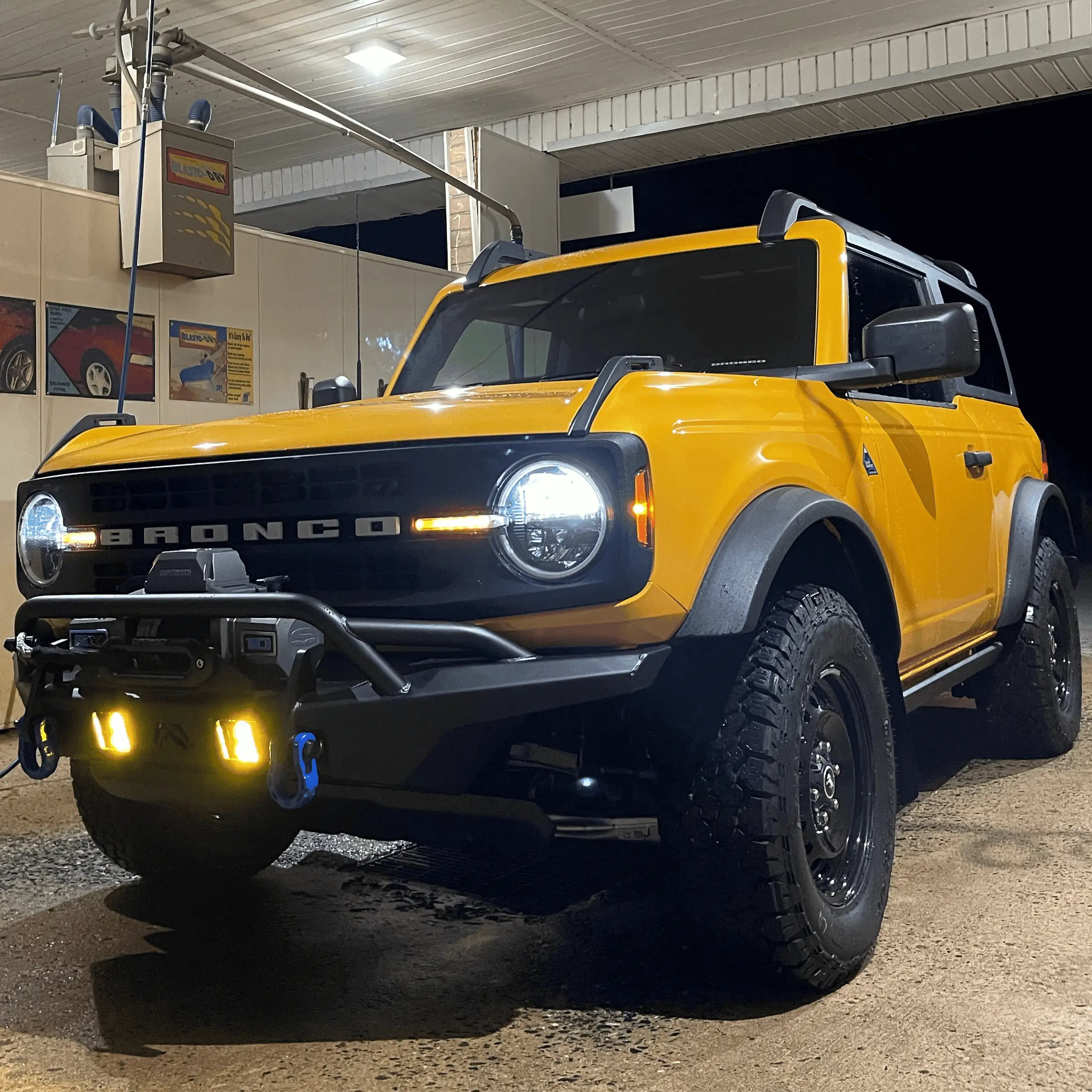

Just curious of you input on the setup I am going to do.
I have added a fabfours stubby and winch, effectively putting an extra ~125lb over the front axle. Dropped the front end almost 1/2"
I have some 4 door black diamond takeoffs coilvovers/springs. There is a difference of 180lbs between the 2 door and 4 door so that should theoretically accommodate the new weight difference since the springs rates are different.
I have a 1" level kit and looks like I could do just 1/2" instead. not really sure which one I should do here honestly.
Let me know your thoughts on this.

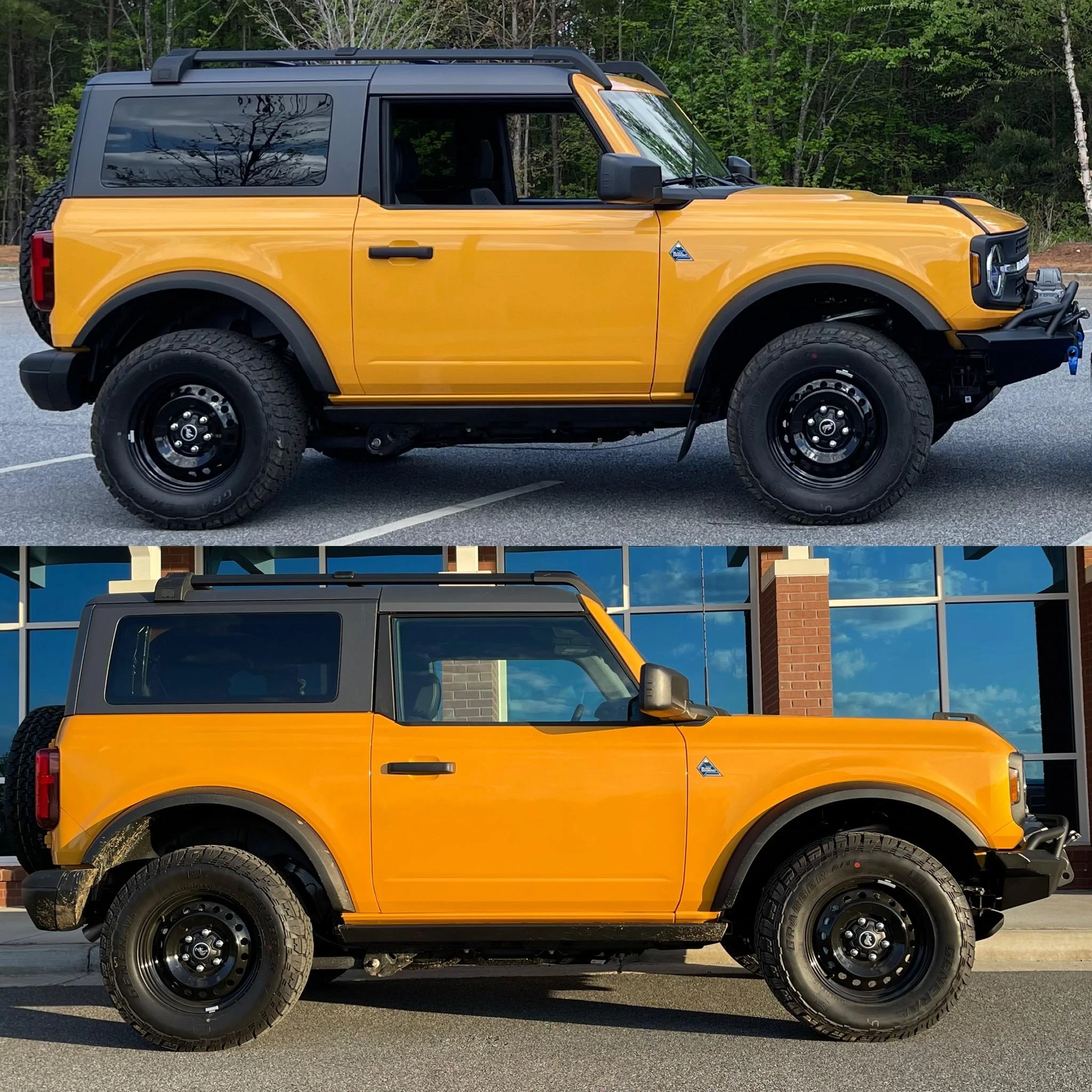

Installed 4 door black Diamond suspension along with part of Rough Country 1” level kit. The kit comes in 3 pieces so I effectively only added 2/3” and the other 1/3came from the new 4 door springs.
Stock height: just under 37”
With Bumper: Just under 36.5”
With 4 door suspension and level: Just under 37.3” (may still drop in a few days)
Overall driving dynamics improved, less dive on braking but still there. I think I’m going to try and find some V6 take offs instead. But this is a step in the right direction for getting stock height and driving characteristics back after adding the bumper. Front axle curb weight difference between the 2 and 4 door black Diamond manuals is 182lbs.
Some options I may try if I can get part numbers is. V6 black Diamond 2 door (same weight as 4 door manual black Diamond almost) or go all the way up to V6 4 door. I don’t know but it’s possible the V6 broncos may get significantly higher spring rates than the 4 cylinders, but who knows.
After/before photo

The stance/ride height looks good. Just a little heavier spring rate and you should be dialed in.
