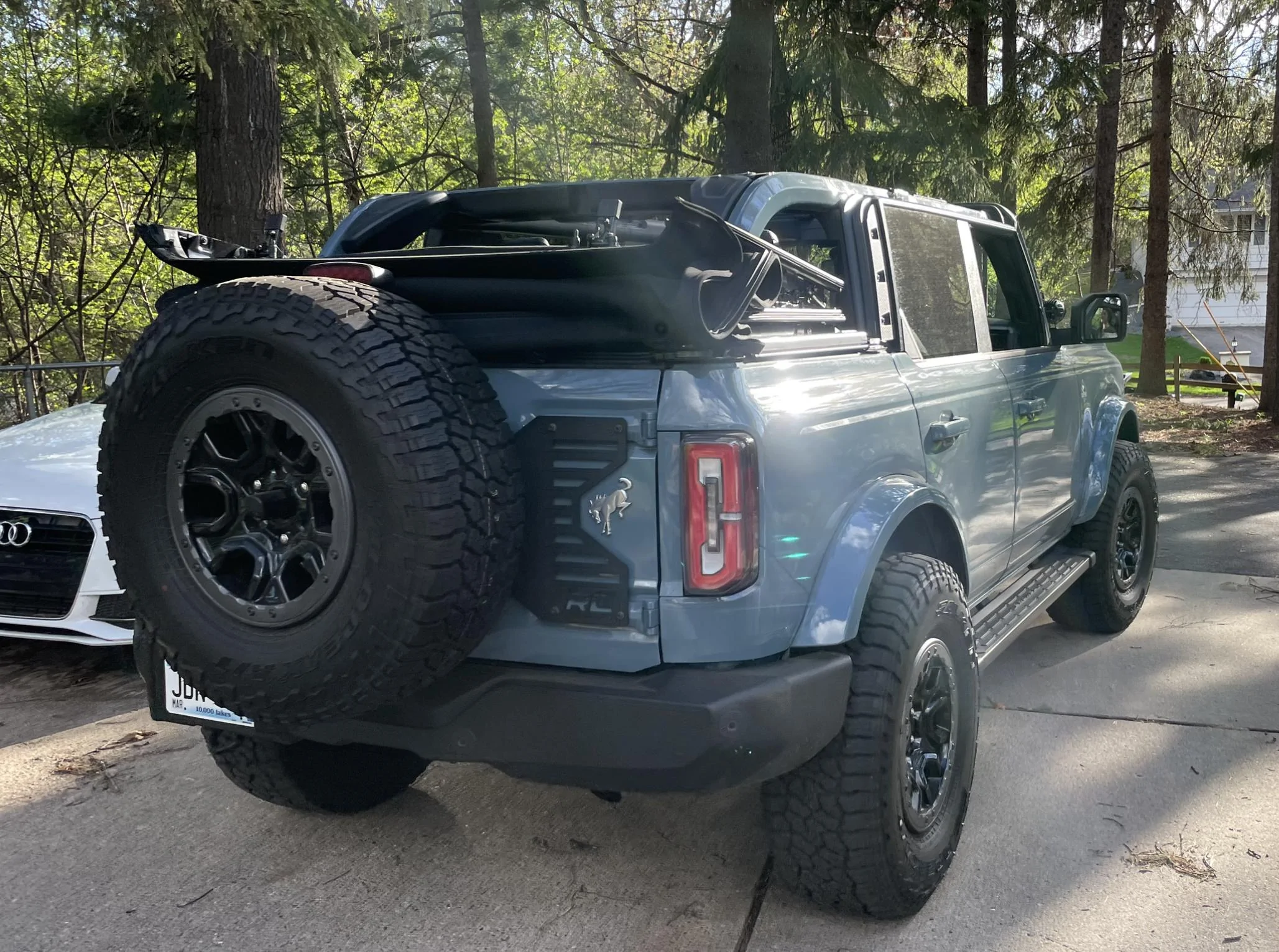

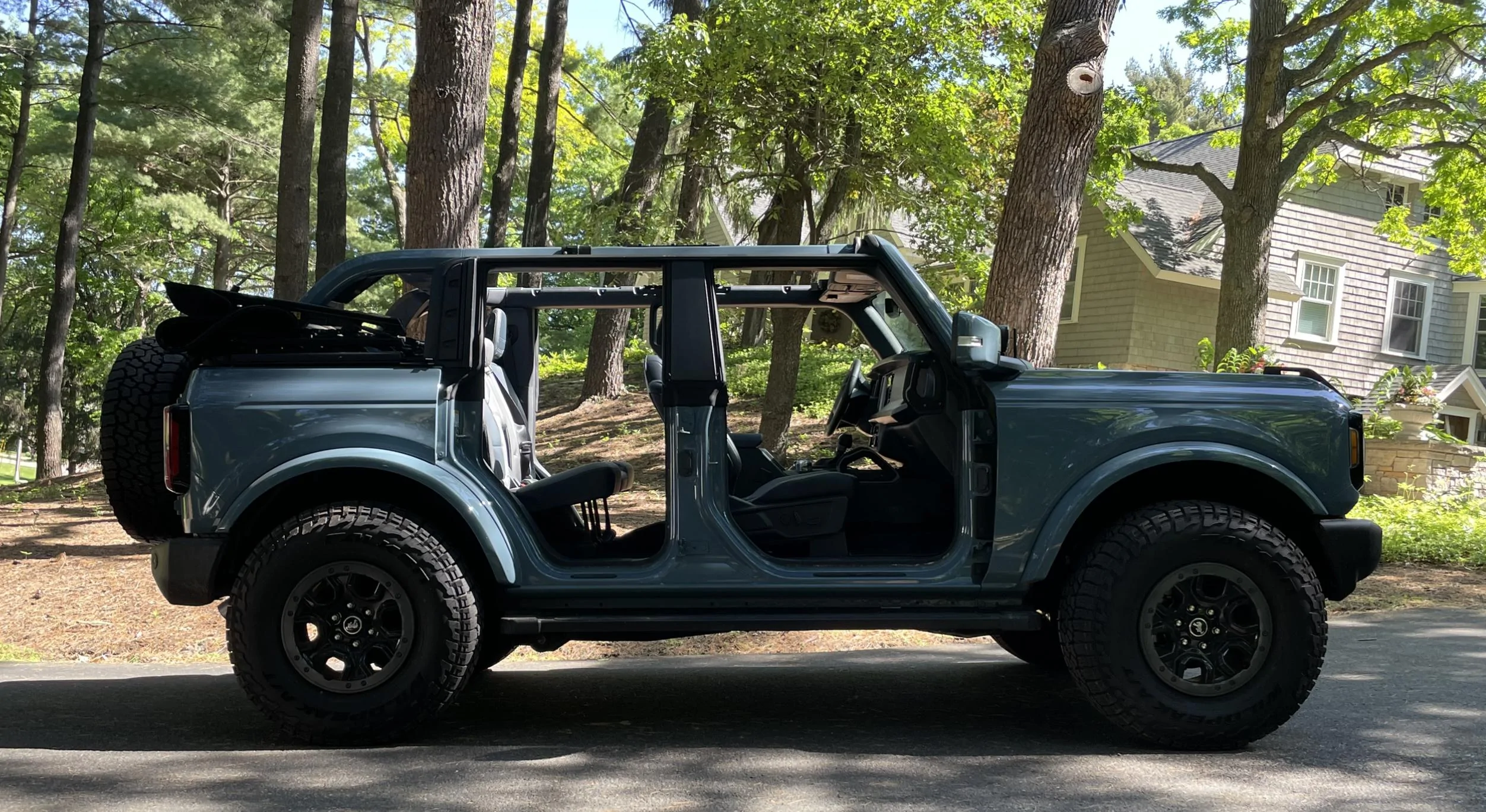

FWIW, I have a non-Sasquatch OBX with Sasquatch wheels I bought locally and 315/70R17 Wildpeaks with a 1.25” leveling kit on the fronts($630 with install and alignment). I’m super happy with the look. Zero rubbing with the crash bars removed. My off roading is moderate at most with much of logging/fire roads and driving across snow packed frozen lakes for a couple months each winter. Our favorite bars/restaurants are much easier and faster to get to by going across the ice rather than by road. It’s also more fun ripping through fresh snow at 60+mph. :)
Ford Bronco Lift kit vs. Level kit 7B5AB7AE-6627-4904-97B8-C1F98F9967CD
Ford Bronco Lift kit vs. Level kit E9133927-AD2D-4D2C-BE9F-4C3F1959E1B3

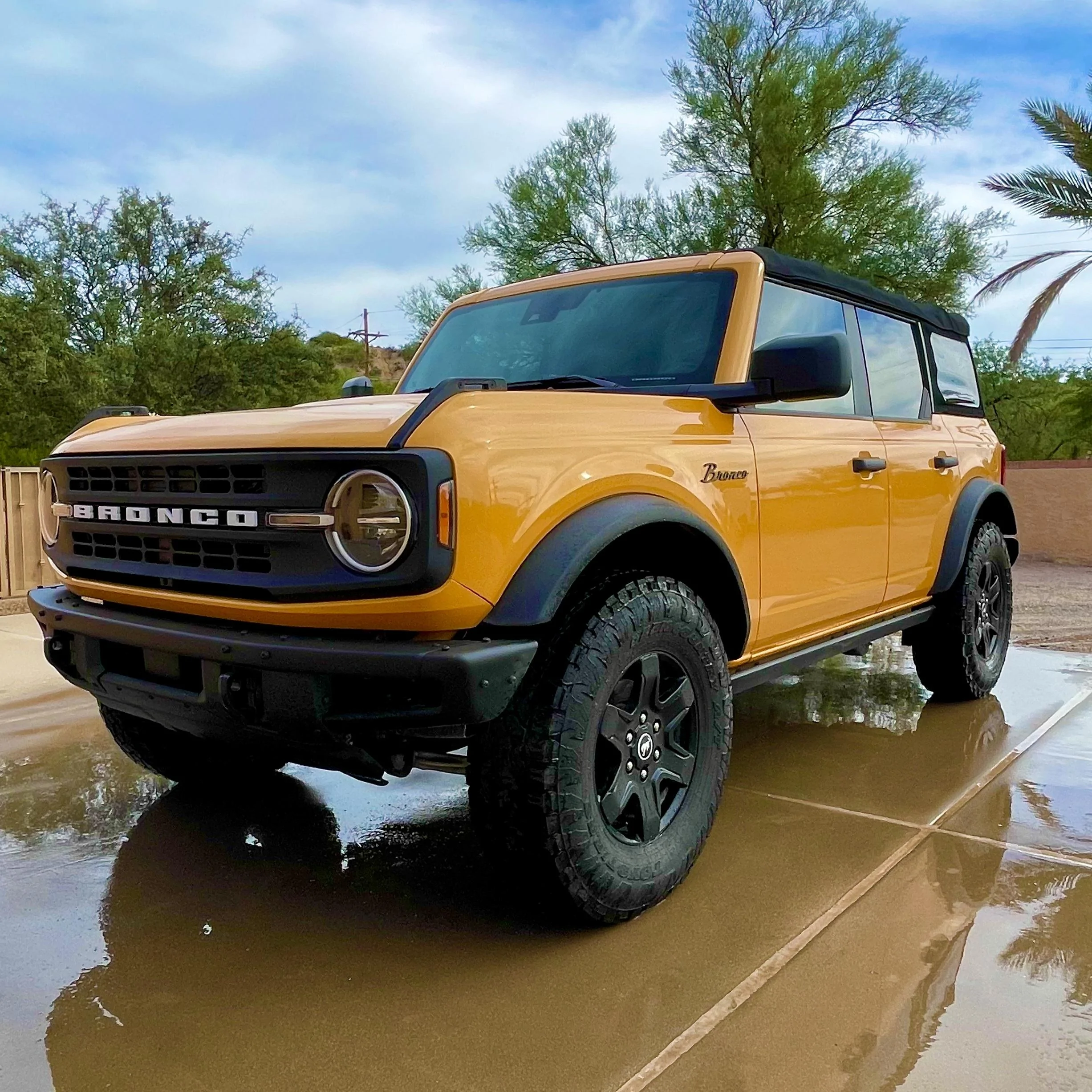

If you go a little wider and get 285/70-18’s, they are identical in size to my 285/75-17’s. Our wheels are both 7.5” wide with +55 offset, so your stance will look just like mine without any lift at all, and crash bars still in place…
Ford Bronco Lift kit vs. Level kit E88E8618-4B9A-4FF7-94D3-3E91CB754005
It sits about an inch higher overall than stock, no rubbing, and no poke. It’s a tiny bit nose-low, but with these taller tires it actually isn’t as noticeable.
If you do want a widerish stance (and some poke), you’ll have to go with less offset and wider tires, like the Sas wheels posted above. You’ll probably have to remove the crash bars for that…
