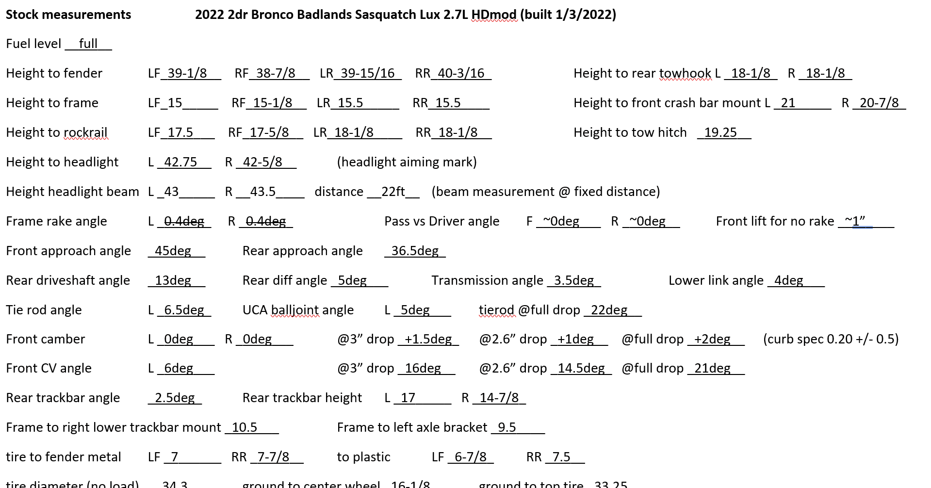

Curious if anyone am an show their 1” level on Sasquatch and if someone can show their 2” level on Sasquatch? Trying to decide on which is the better option for level but avoiding the front being higher…Carolina Squat
The rake varies between Broncos. There's about 1" of stock rake on 2dr sas 2.7L. Also note that springs will settle over time and front/rear settling may not match.
If you buy the $60 RC 1" level kit, there are 3 shims that can be installed individually so you can dial in the height you want. Other kits have only 2 shims, so that limits your options.
upper shim 1 & 2 - 0.185" (~1/4" lift each)​
lower shim 3 - 0.26" (~3/8" lift)​
Ford Bronco 1” vs 2" level kit for Sasquatch 1645393185536
That’s awesome information. Where did you locate so I can find measurements for 4dr OBX Sas 2.3L?
I did the measurements myself as a baseline for a personal project (they are approximate).
