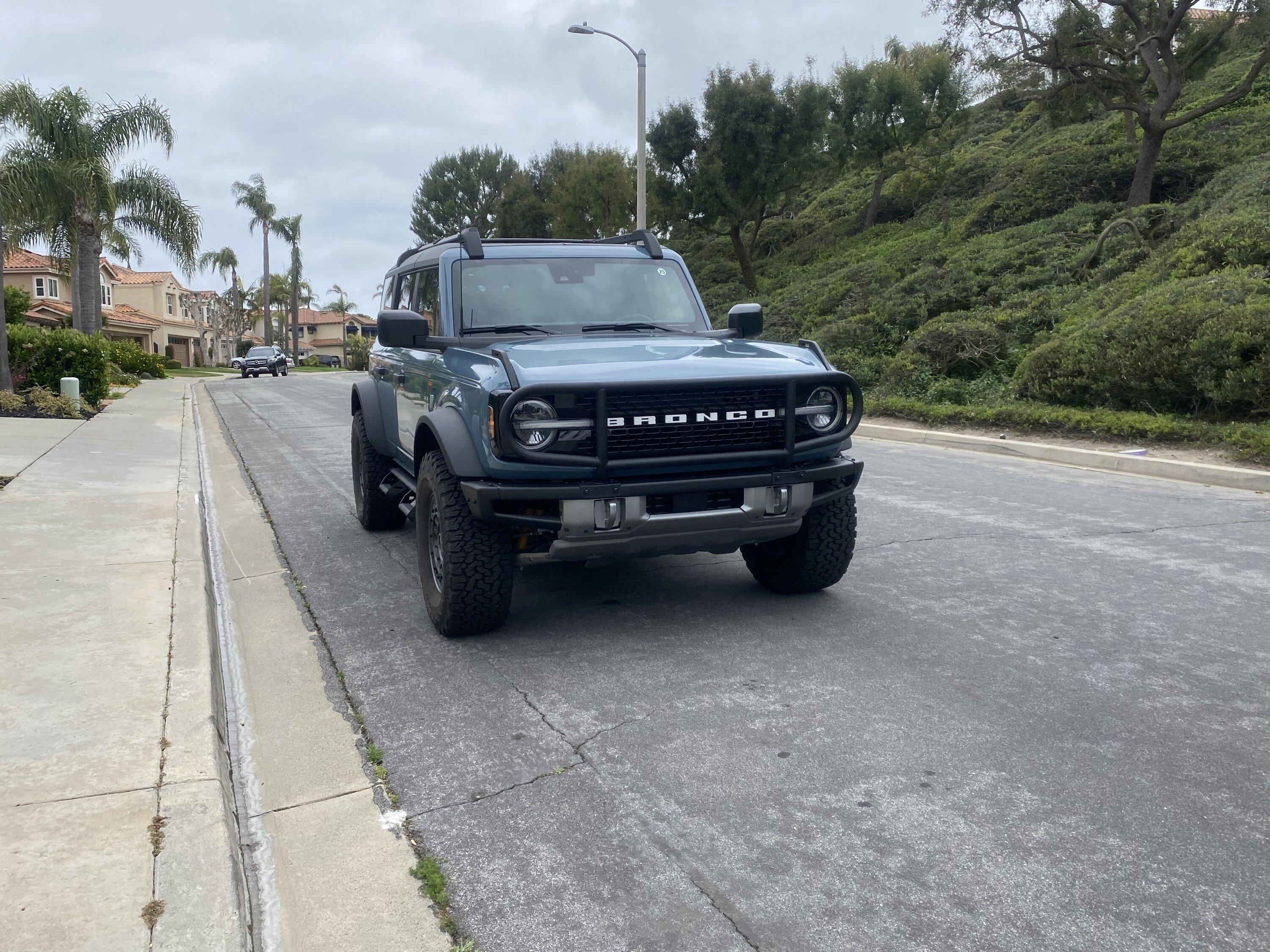

We swapped grills this morning. My base badlands grill has to be slightly modified using a deemed to create a bigger opening for the camera. Other than that it was a straight swap.

Wildtrack grill on badlands

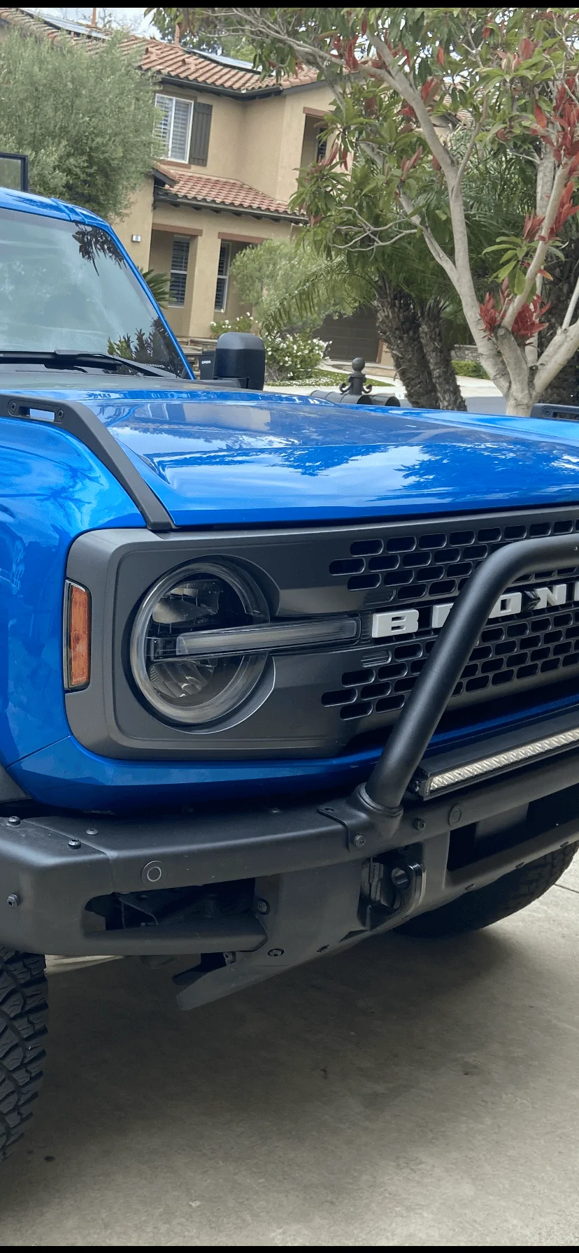

I swapped a Base grill onto my Badlands.
There is a small plastic bar in the center of the Base grill that needs to be removed (5 seconds with a Dremel) it's in the way of the camera mount. Once it's gone, camera bracket bolts right up to the Base grill - all the screw and bolt holes are already there.
