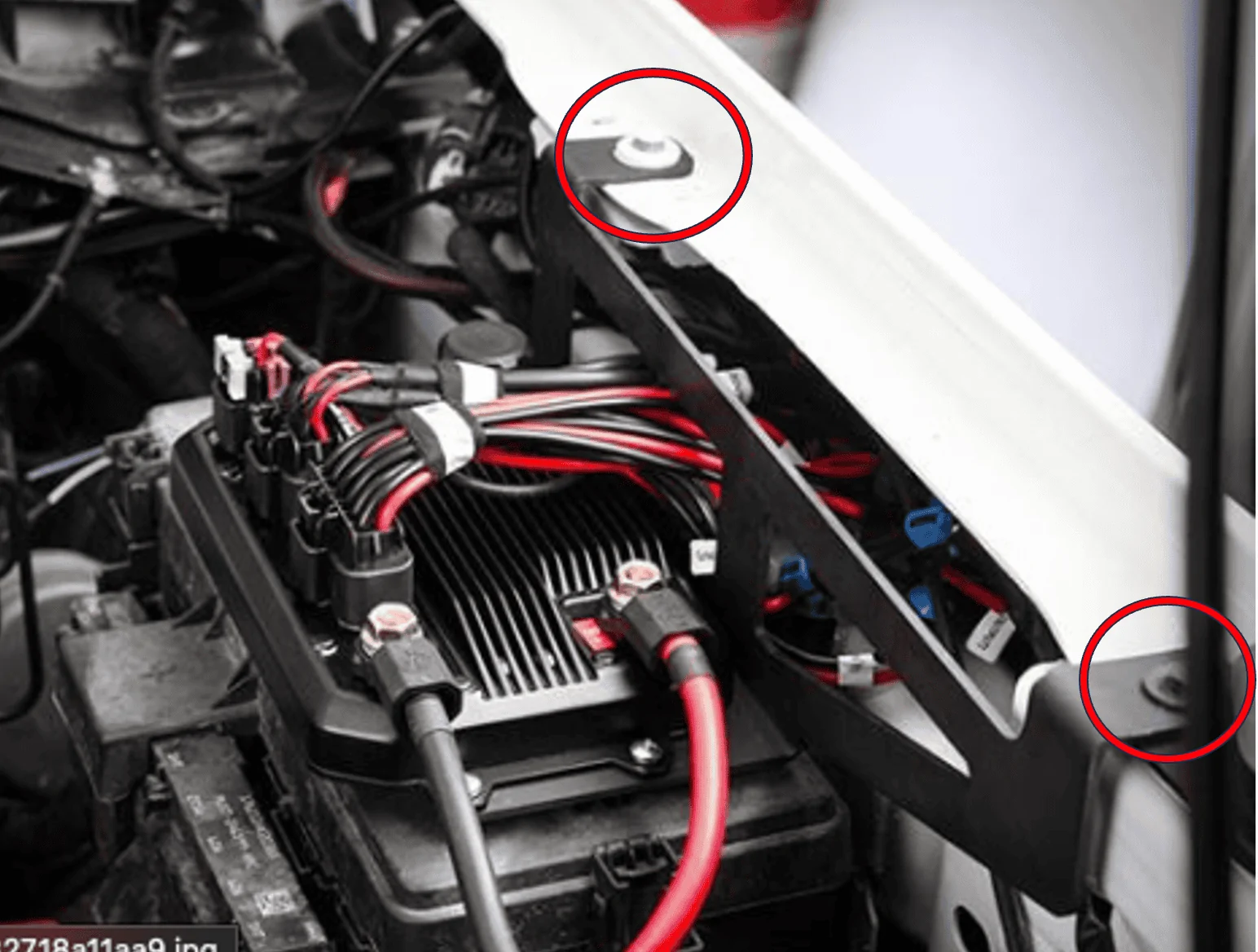

I think the question was pertaining to accessing the vehicle fuse box with the brain mounted to the top of it.
Yes good catch, Thank you! @KABQ
@Cardboardbronco So yes you will have to remove the 2 brain plate screws to access the fuse box as shown in the image below. From there you will have full access to the fuse box. The kit will remain intact and once finished with the fuse box you screw the two bolts back in and you are set.
Ford Bronco SwitchWorks Alpha12 Digital Smart Switcher Screenshot 2023-12-13 at 8.43.36 AM
Please let us know if you have any other questions, Thank you!
