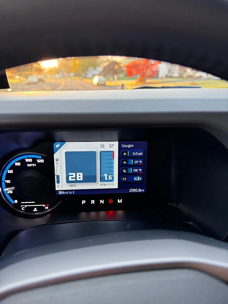

I will see 15.1V on that gauge sometimes so I don't think that's your issue. I'd start with fully charging your battery and checking for the latest version of Sync.

Just went to get some gas any my voltage wasn't bouncing around as much, but peaked at 16.2!
If that voltage reading is accurate, that's wicked high---high enough to potentially do some damage.
We've found the voltage on our Gauge display reads approx. .3 - .4v high vs. a Fluke voltmeter.

2023 2.7 with 2500 miles. Drive it daily. This morning this popped up 10 minutes into my morning drive
My voltage was constantly bouncing between 15.6 and 14.9v
When the bar filled up the sync unit shut off and I continued driving just fine. I held down the power and skip ahead buttons and the system popped right back on without even going through the standard startup animation
Any idea what it could be?
