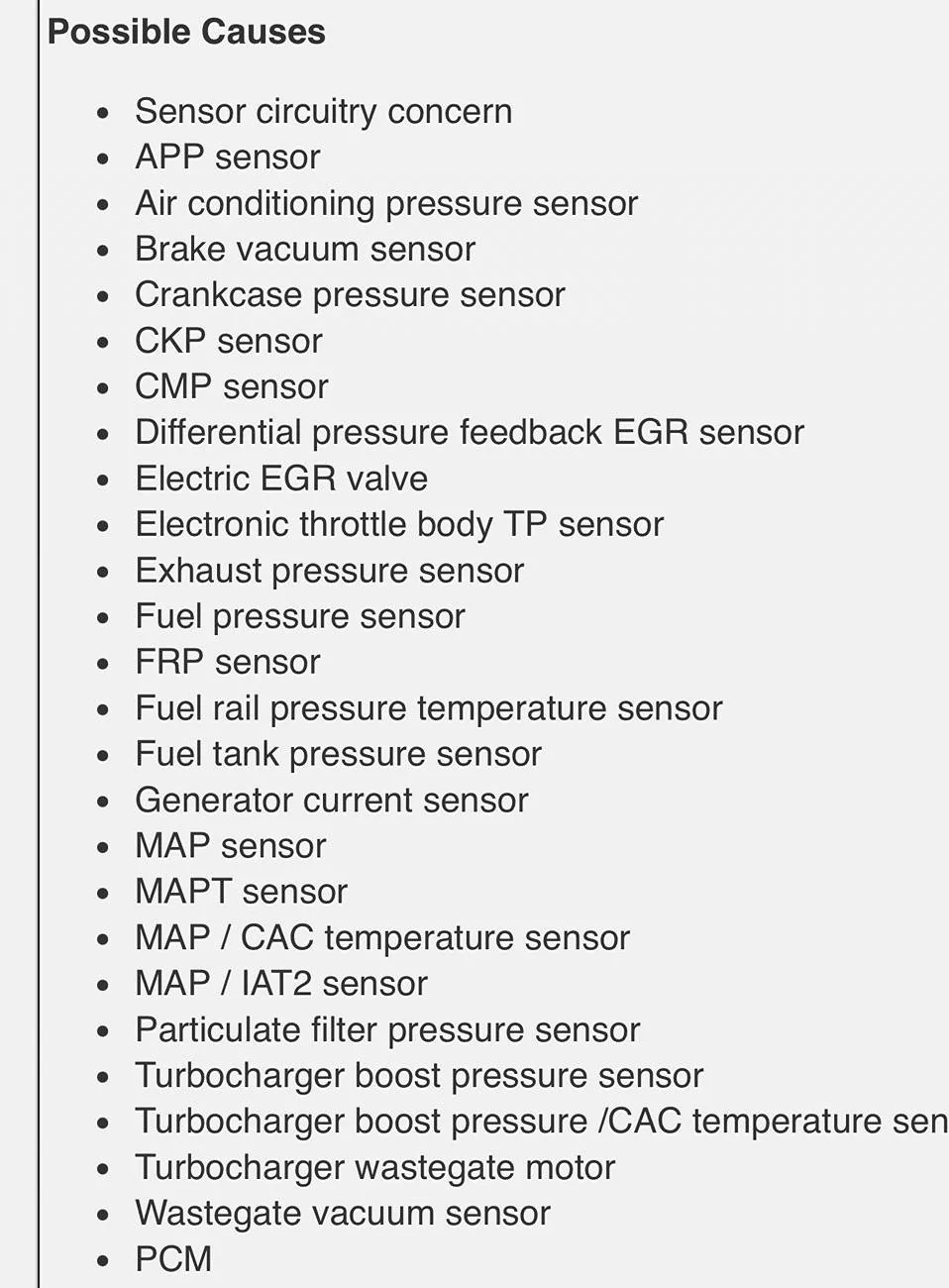

P06A6 is VREF issue.
This has nothing to do with the battery.
You either have a shorted sensor or a wiring issue.
There are a ton of different things that can take down the VREF, so unless you see something obvious, you’re most likely going to need to wait for a dealership to correctly diagnose it.
so if any of those go bad you will get the symptom listed above????....to complicated for a vehicle to be used in rough terrain
