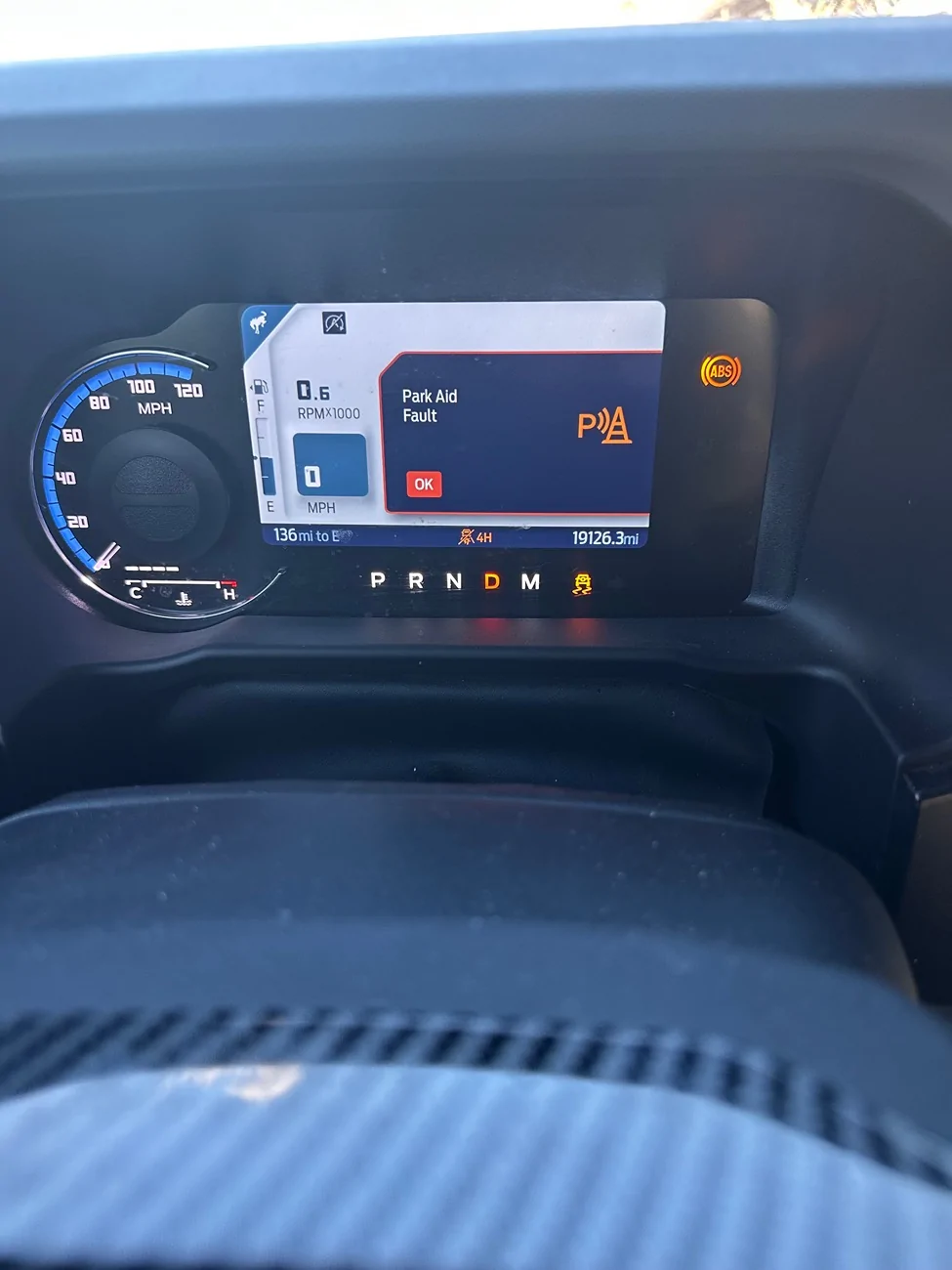

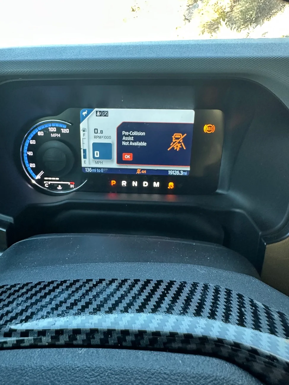

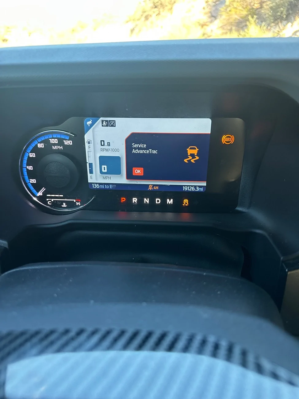

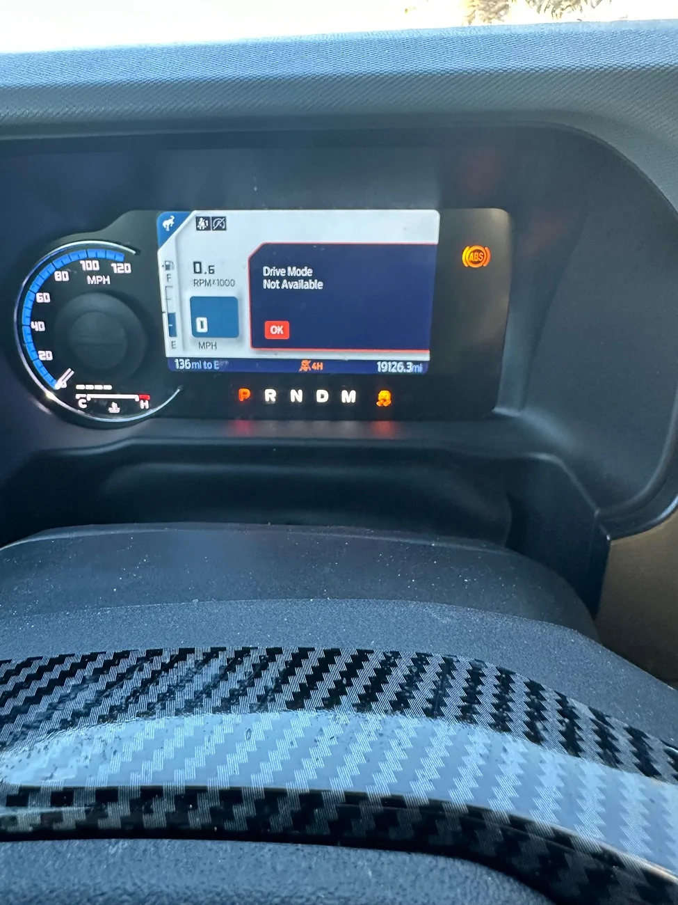

I was wheeling in Baja mode and 20 min into the trail the mode just disappeared - got several errors:
1)Drive mode not available
2)Service Advance Trac
3)Pre Collision not available
4)Park Aid Fault
Tried turning off engine a few times for a reset with no luck
Turned around to head back to road and just like that, everything came back and seemed normal after about 10 min - was able to shift in and out of goat modes as normal
Anyone have a clue ??
I did have Ford performance computer upgrade a while back when I went to 37s and Bronco was in shop for a winch install very recently - they may have looked at the computer at last visit since my speedometer was a few miles off
Any thoughts appreciated

I had something nearly identical happen to me late one night. Took it in for service and they found a tar ball on the the wheel sensor rear passenger side. By the time I brought it in Tuesday (it was Saturday night) all the messages were gone but they looked at it anyway.
