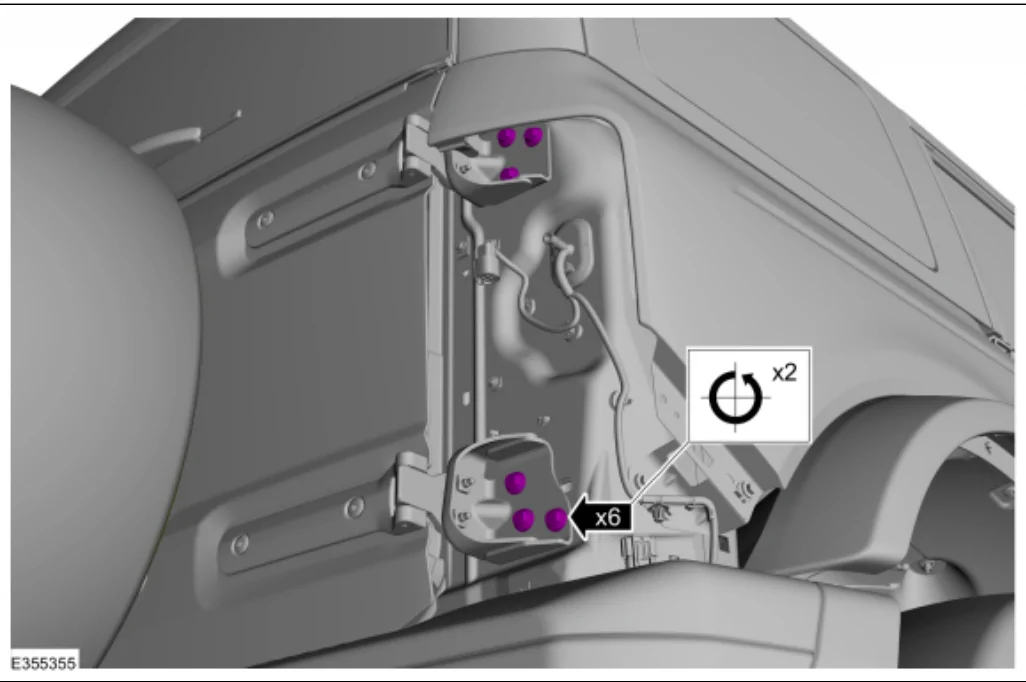

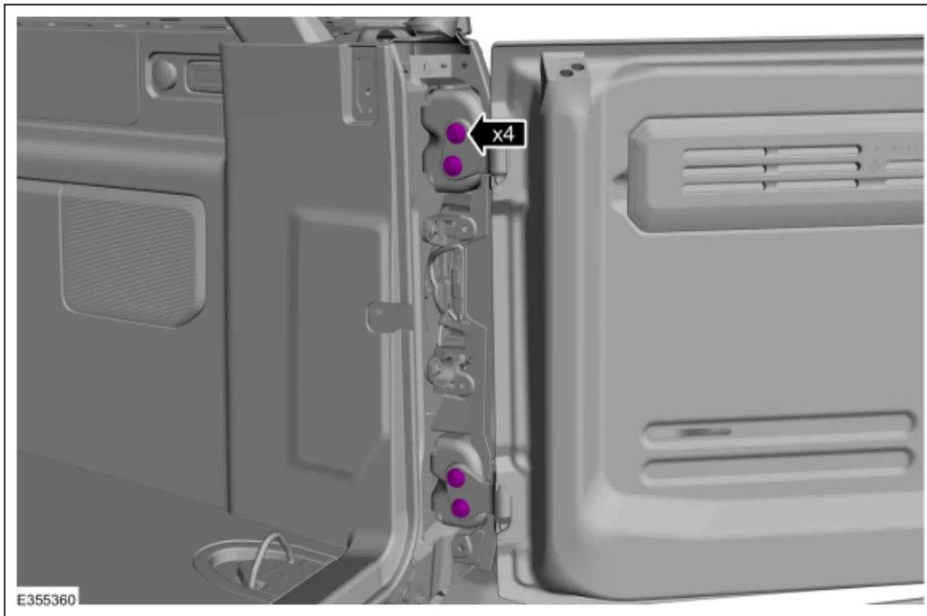

Anyone know the part numbers for the 4 hinge bolts and 6 body mount bolts?
I'm usually pretty good at looking through the diagrams, but failed this time.
4 hinge
Ford Bronco Tailgate Alignment Bolts: Part Number Request Screenshot 2026-04-05 at 5.20.09 AM
6 body
Ford Bronco Tailgate Alignment Bolts: Part Number Request Screenshot 2026-04-05 at 5.18.33 AM

W715684-S439
They’re all the same
Thanks!
And strangely looks like its marked "discontinued" at the typical oem part retailers.
Any chance there's a replacement / supersession number?
