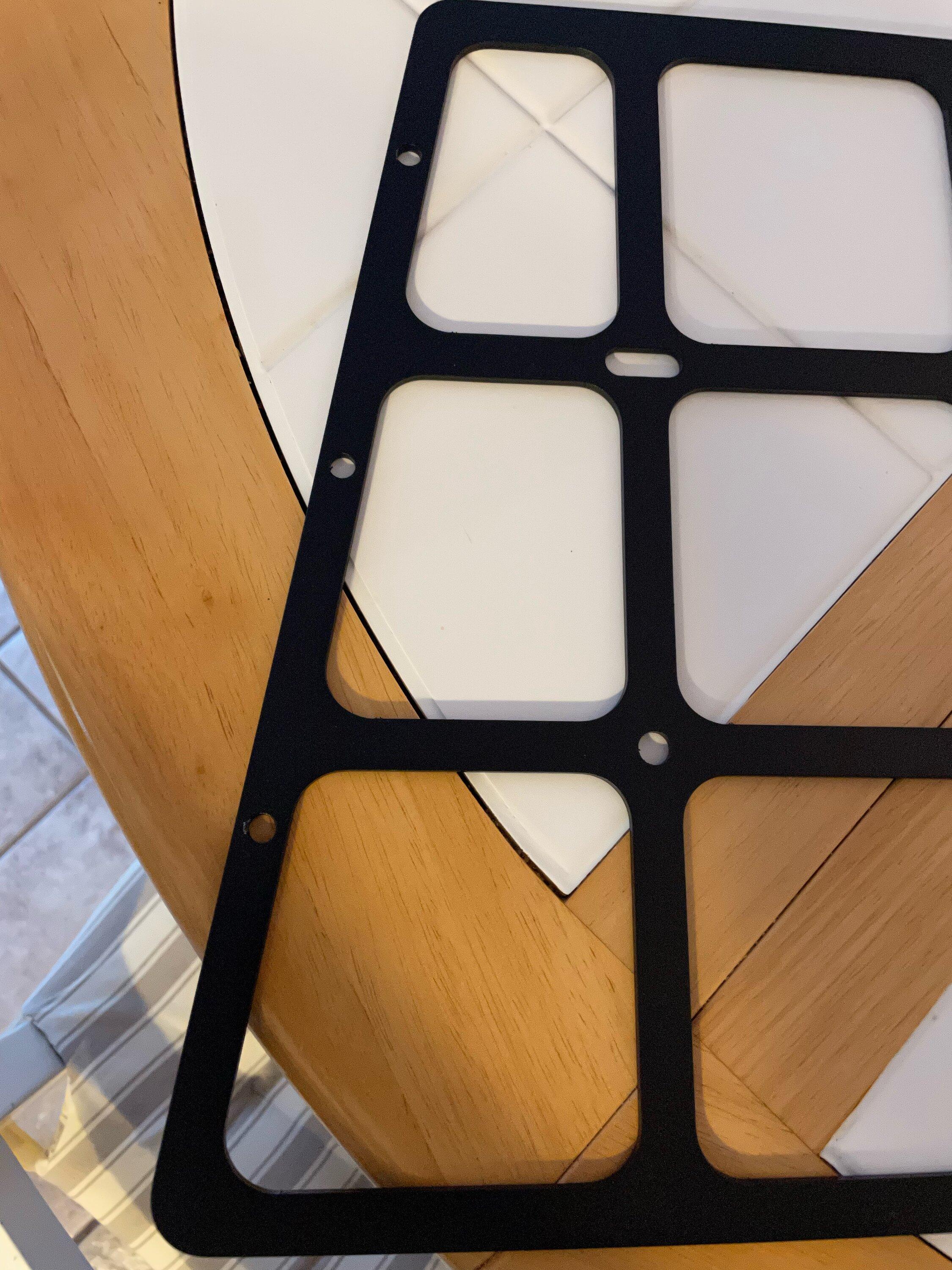

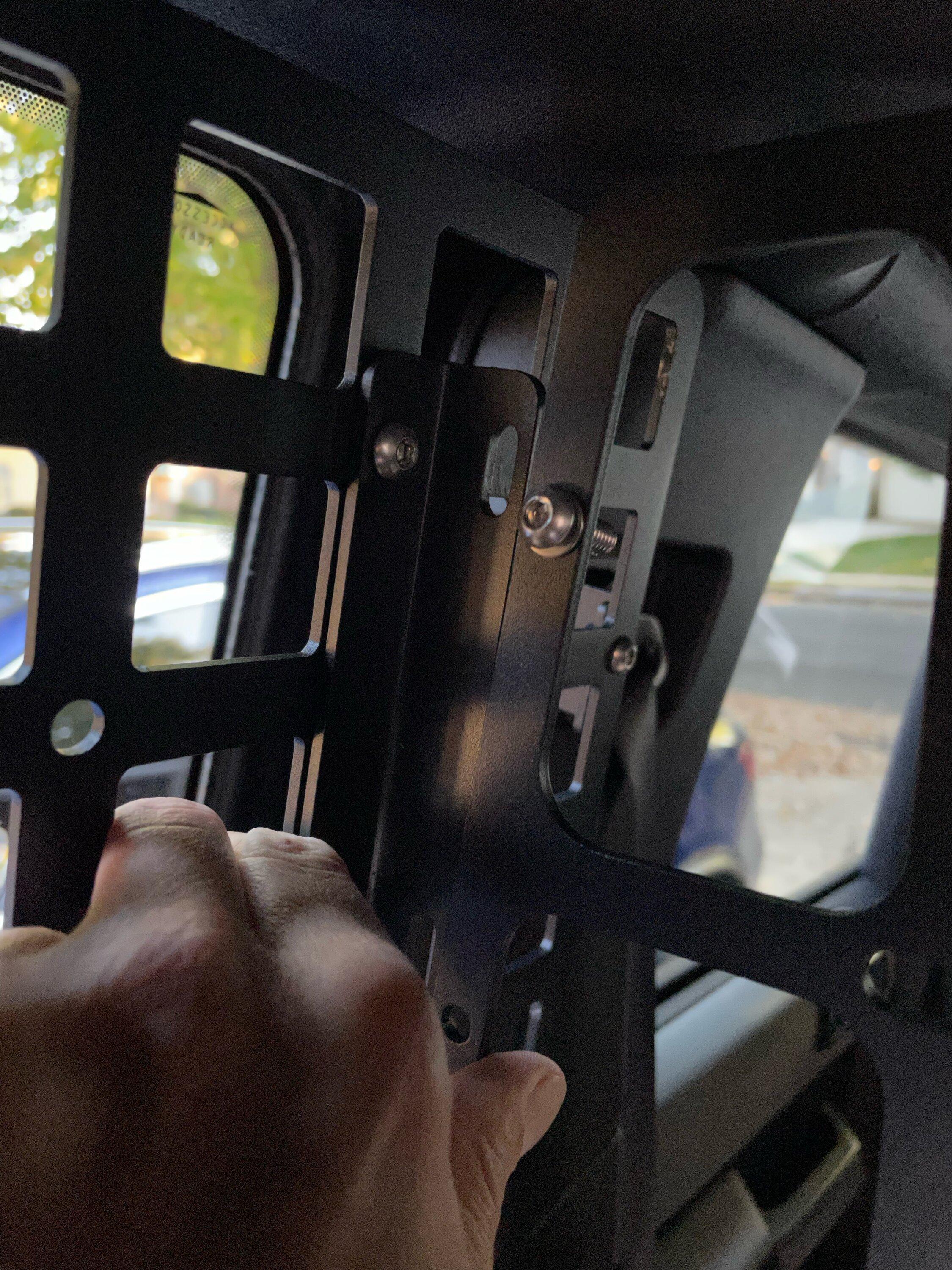

I went ahead and ordered the @JcrOffroad set up, beginning to regret it though. Did you have any issues? First it was shipped scratched up and missing brackets. A week later I received the brackets. Anyway, the barrier appears to be too small. See vid/pics below. Judging from the pics on the JCR site the barrier looks different but what did they send me?
Almost an inch too short.
Slot here is not on barrier shown on the JCR site.
Anyone install one of these recently? Thanks!

Geeze that sucks! Looks like JCR has changed their design as my barrier has much smaller MOLLE holes. As far as being too short. I know the side panels are adjustable. Maybe try to adjust those out further?

The side panels are pretty much fixed at the point of where the barrier is supposed to attach since the bracket attached to the seatbelt bolt is not adjustable.

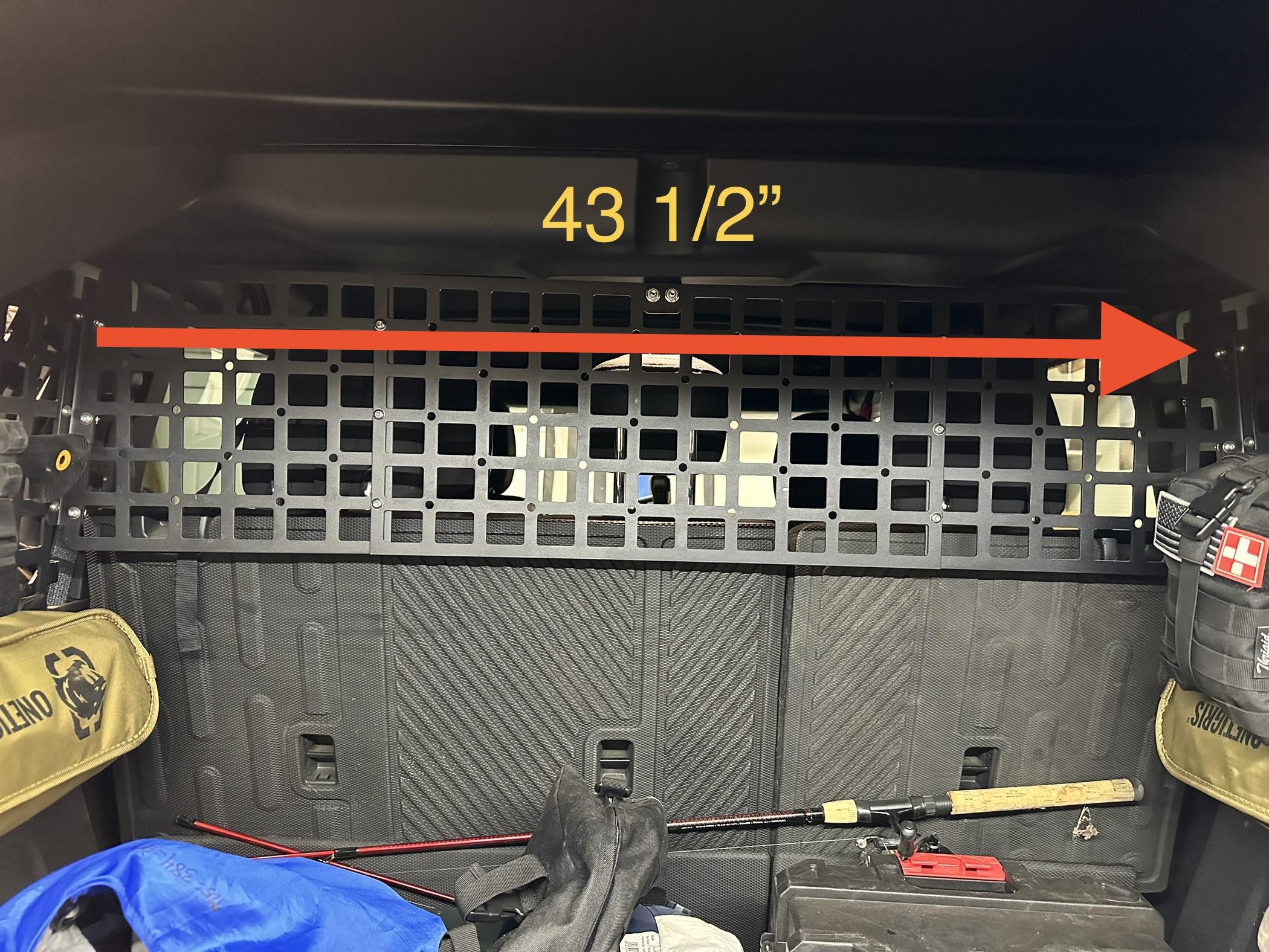

If you could measure the distance of the barrier from left top bolt center to the right, you might be able to help me track down what is going on with my setup. JCR claims I need to loosen the brackets, attach the barrier and try to tighten the brackets back. Can't imagine this not bending things. Did you need to go through this to get yours installed? Thanks!

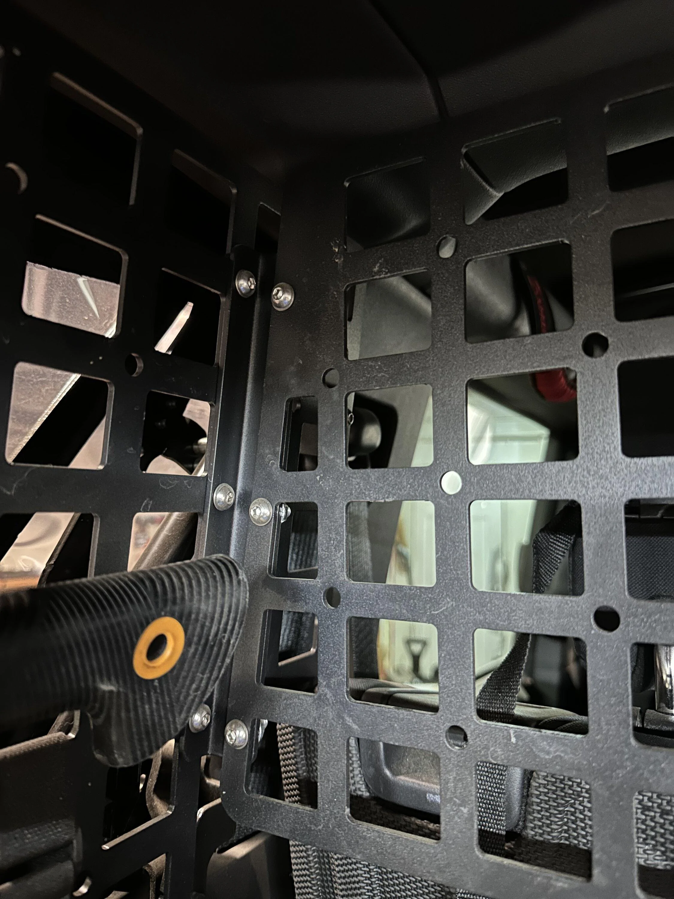

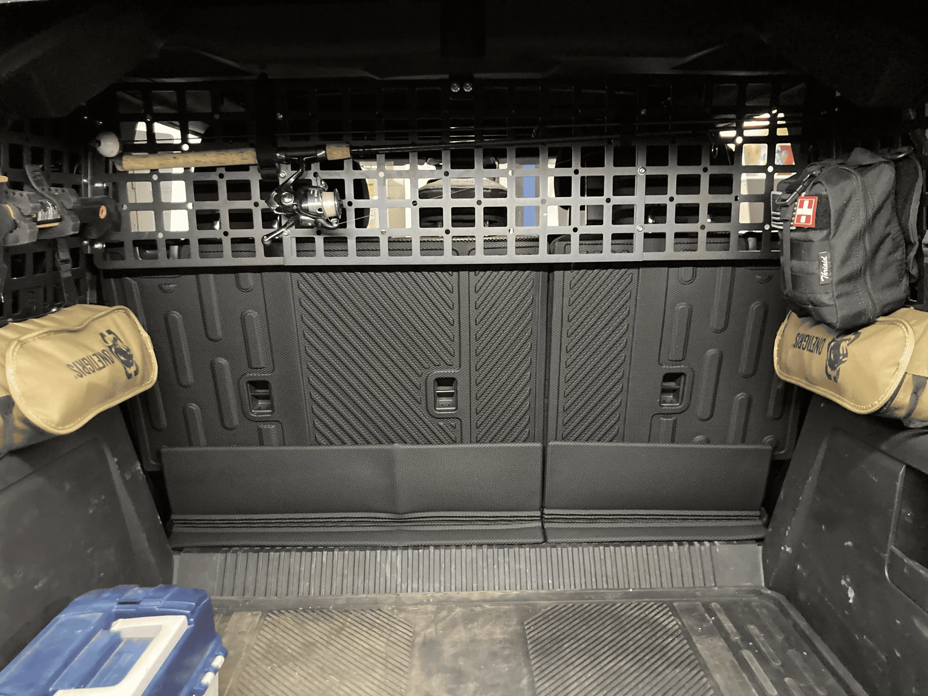

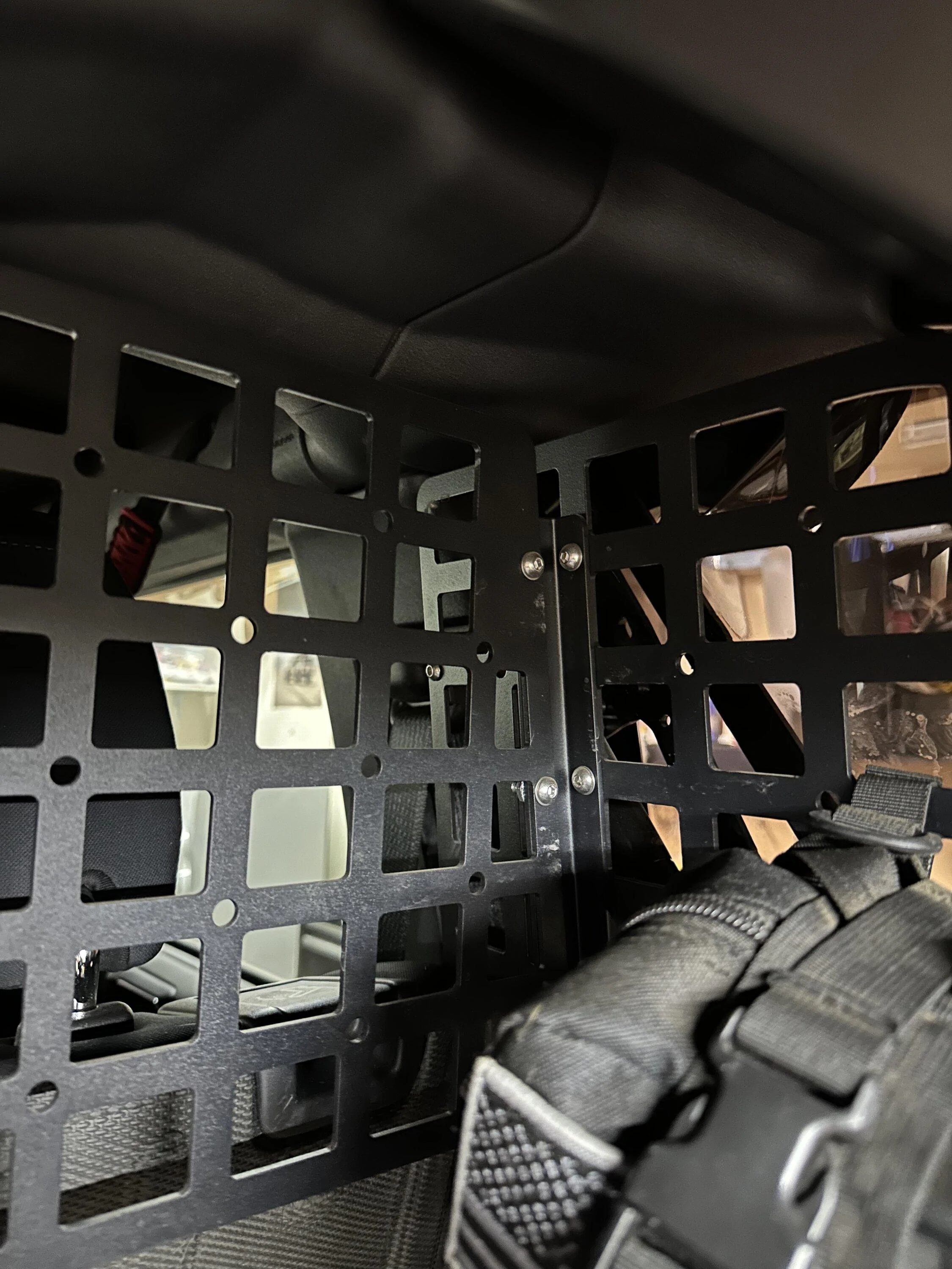

Mine was a painless install… measurements from top right to top left bolt is 43.5 inches

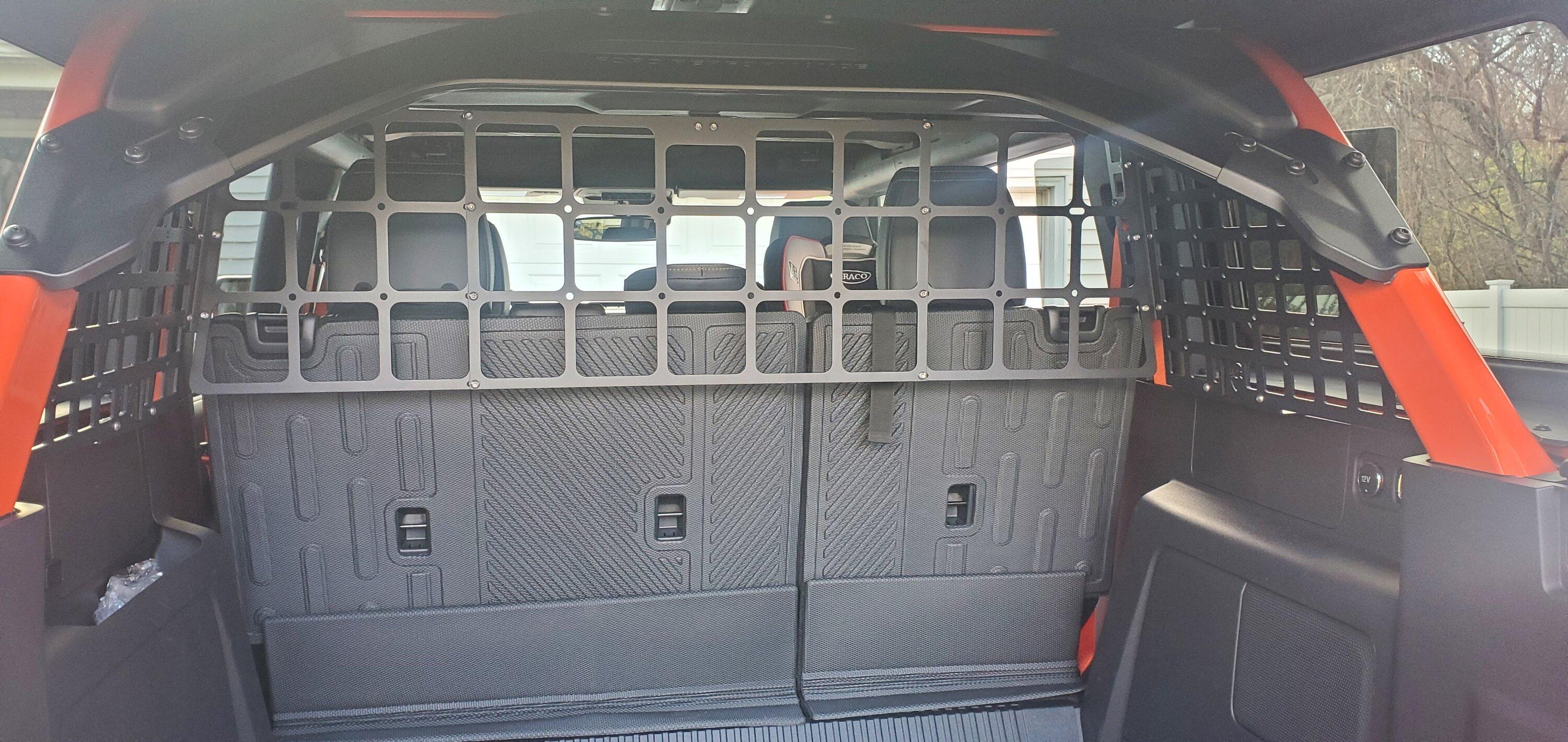

Just got my barrier installed. Wish I saw this topic first! I also called JCR because mine was a 1/2 inch short. They recommended loosening side panels which was frustrating but worked. I couldn't really loosen the top two bracket bolts for side panels . The bottom two bracket bolts and the panel bolts gave it enough flex and everything tightened down fine.

Your thoughts about rearward visibility after adding the passenger panel and barrier?
I have the drivers side panel only now and I'm thinking about adding their upper shelf which requires both panels, and the barrier seems like a good idea to keep stuff from flying into the passenger compartment.

I have the same setup but with the older, smaller gap style divider. I have no issues with visibility although I do rely on the camera a little more. These newer style with the larger gaps seems like visibility would be better. I’m also doing the upper shelf soon! Seems like a great idea to get my recovery gear and basic loose items stored up and out of the way

I'm not completely concerned with blocking visibility, but I like to keep an eye on other drivers so being able to recognize there is a car behind me is probably enough.
A digital display rear view mirror would have been a great addition to the Bronco. I tried one of the clip on dashcam video mirrors, but it was too big and interfered with the sun visors and hindered forward visibility.
For backing up, I rely a lot on the camera already.

The wider openings on the pet barrier definitely seem to aid in visibility and reduce the claustrophobic feeling. The back window is really useless in a Raptor with the giant spare and brake light.
