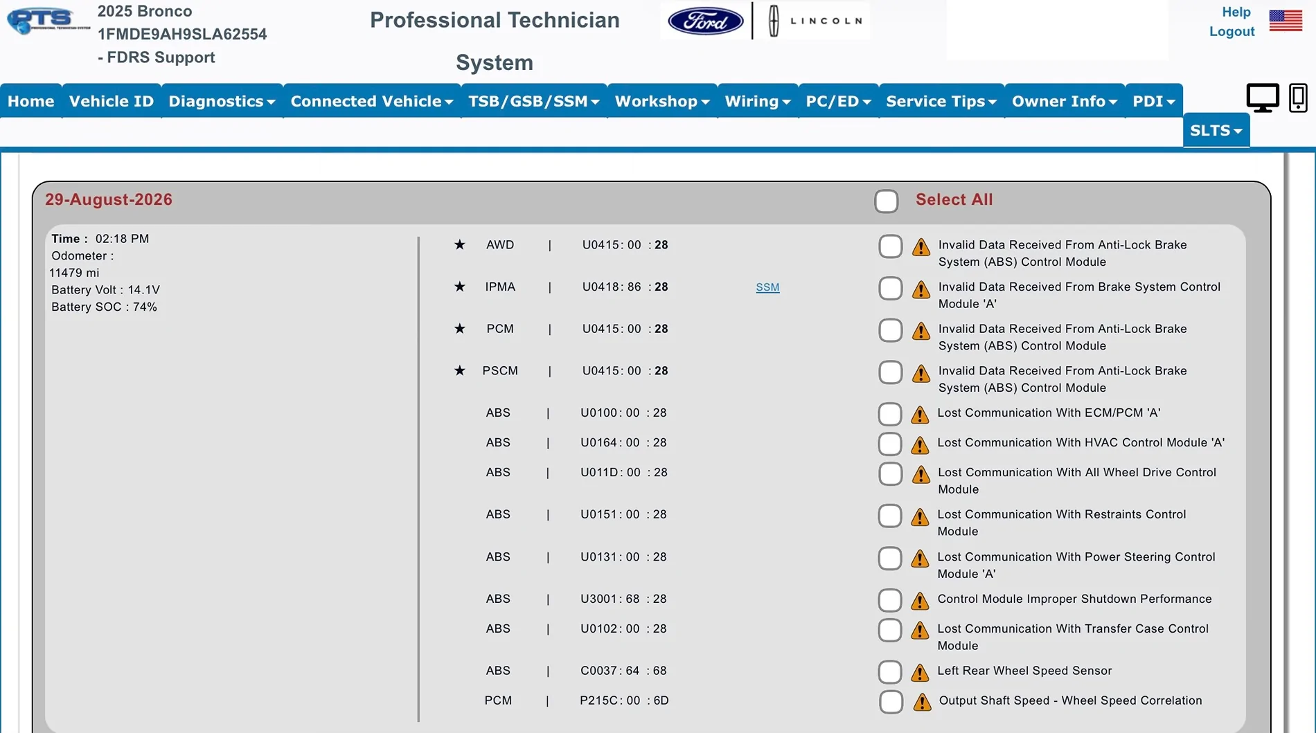

Thunderstorm Causing Dash Alerts?
Ducati1098
10,021
23,308
Midwest
Everyone here is a good source of laughs, as usual, but the situation leaves me wondering what could be the cause such a cascade of warnings to go away as mysteriously as they arrived. Likely no on the wheel sensors, seemed fine. Battery fine. Gremlins in the various sensor systems not so rare I guess. I’ll have Ford pull some codes when I go in for the harness recall (hopefully in Sept).
Likely just a temporary loss of communication. It happens sometimes in modern networks.
If you want, I can check your VHR for codes.
