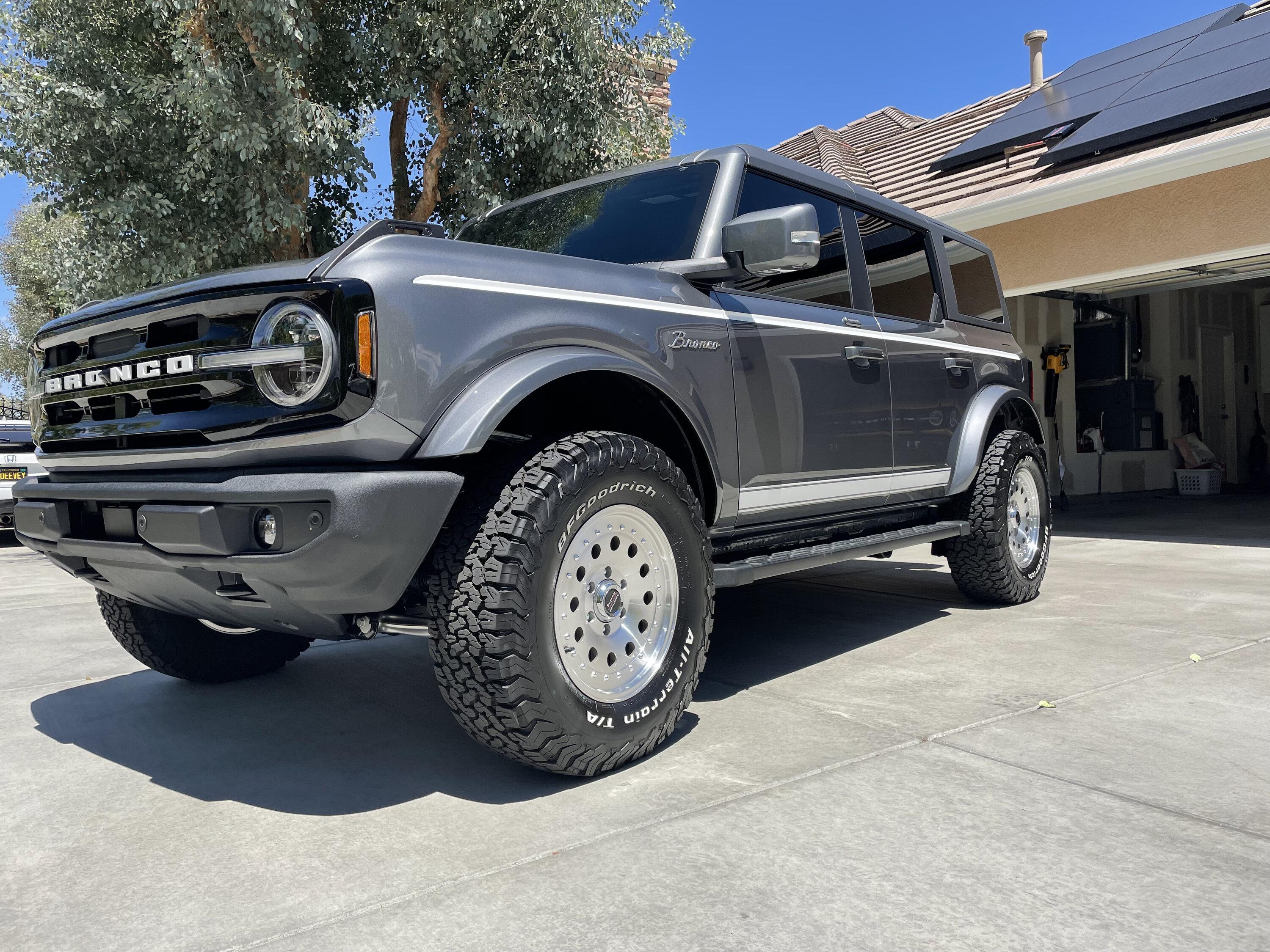

I went with 17x8 +18 and 285/70/17. No lift, Zero rubbing and crash bars in place. Here is a pic

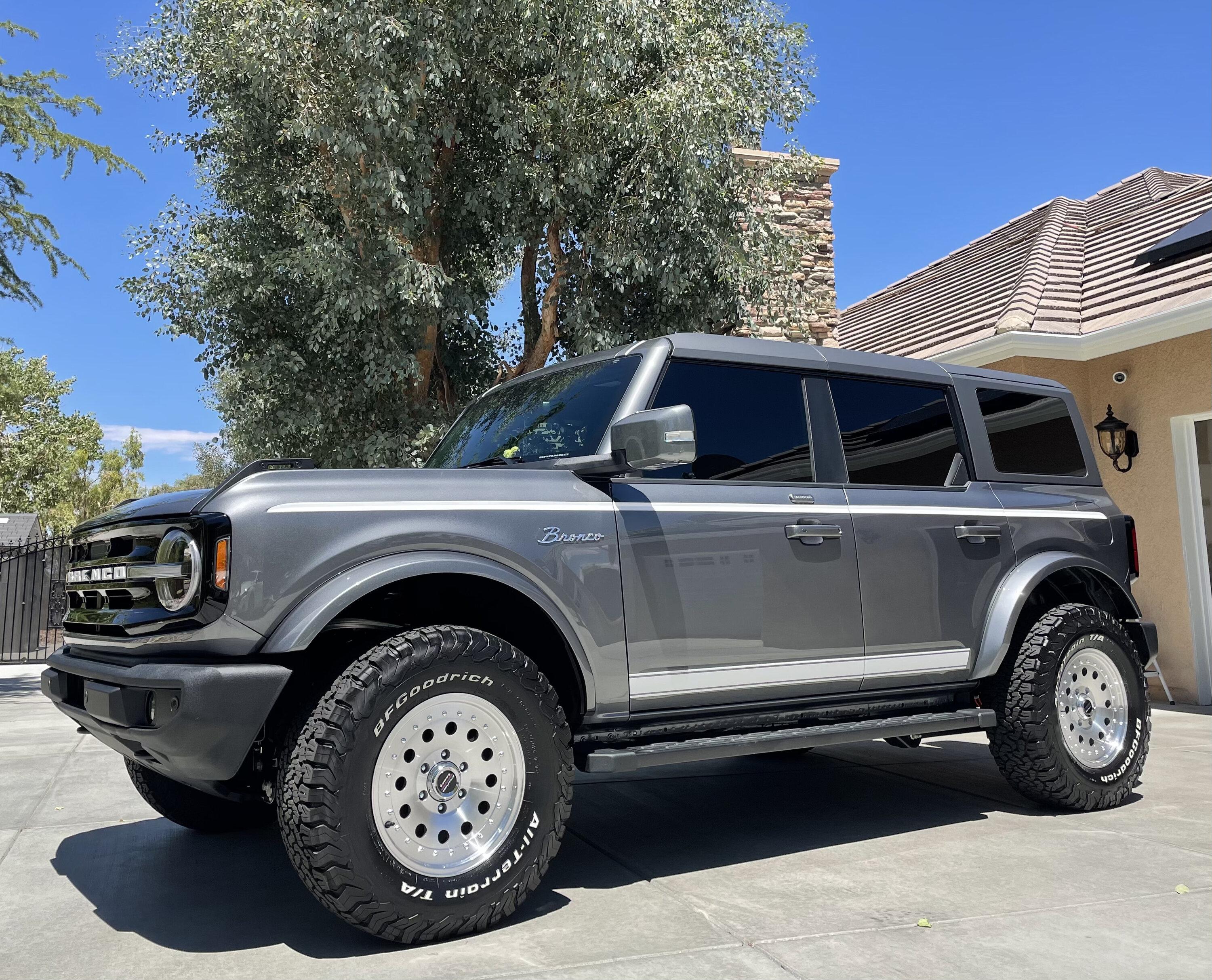

Oh cool, they should fit great. The poke will be 0.7mm more than what you see on my OBX I uploaded aka not bad but def a more aggressive stance
Ford Bronco Tire Recommendations - 285/70r17 IMG_5142
Yours looks great- if its too much I guess I can always order sas flares!
