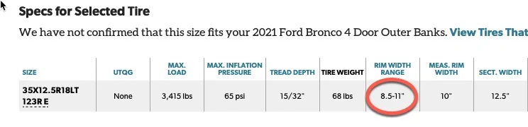

This is what confuses me, I looked up this tire and noting you have the stock OBX rim which is 18x7.5 with a +55mm offset. The specifications say the width should be 8.5"-11". How does this work within the realm of not being a legal lawsuit waiting to happen. Dont get me wrong, I love the look, but according to this found on tirerack.com……It shouldn't.

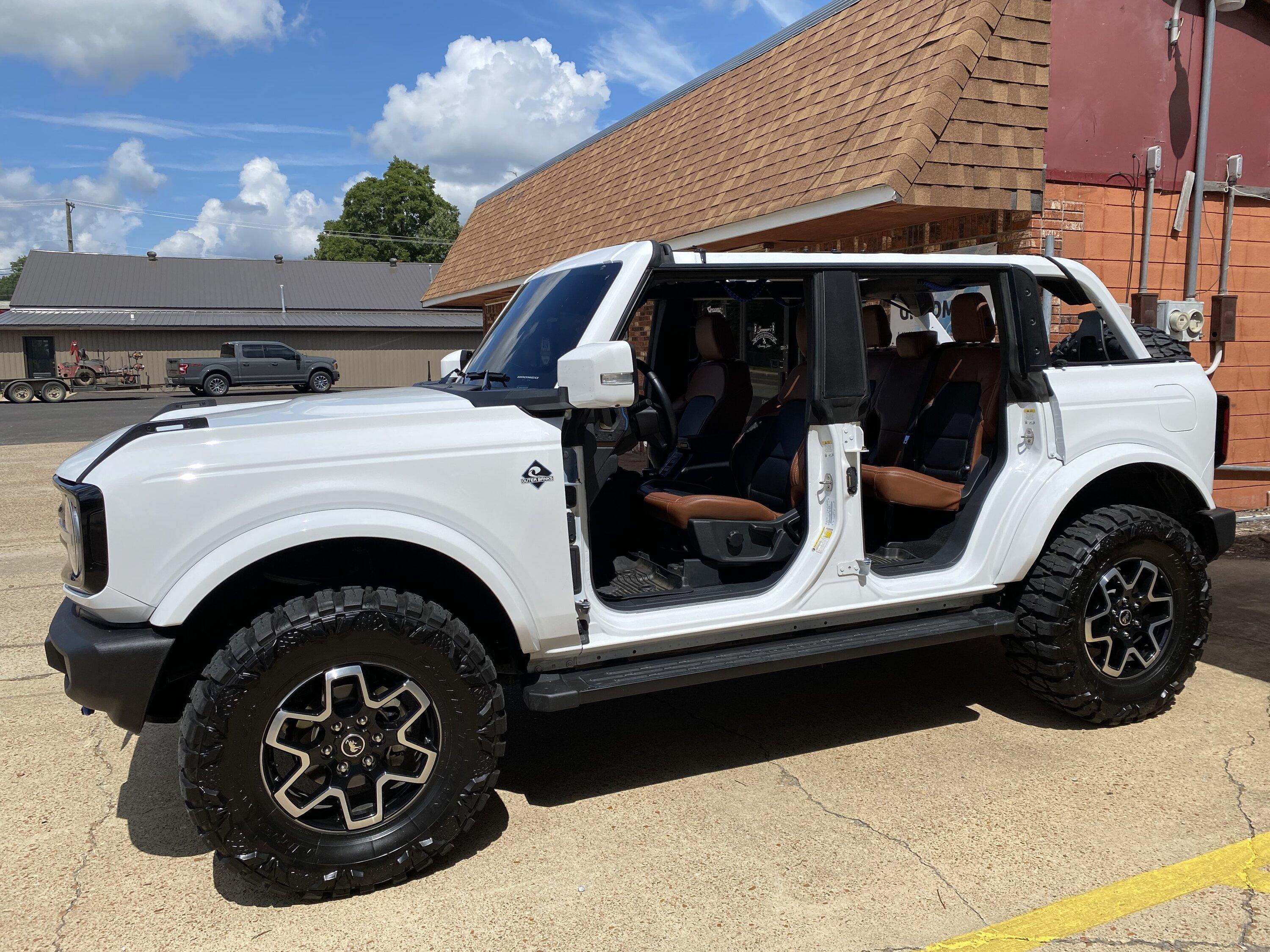

I know... I saw another guy in my town that had the same set up and he said it was working good for him... This rig will not be climbing rocks or going through rice fields or creeks. it probably could but won't. But it looks badass. I'll keep you informed on how they're doing. here's the one I based mine on...

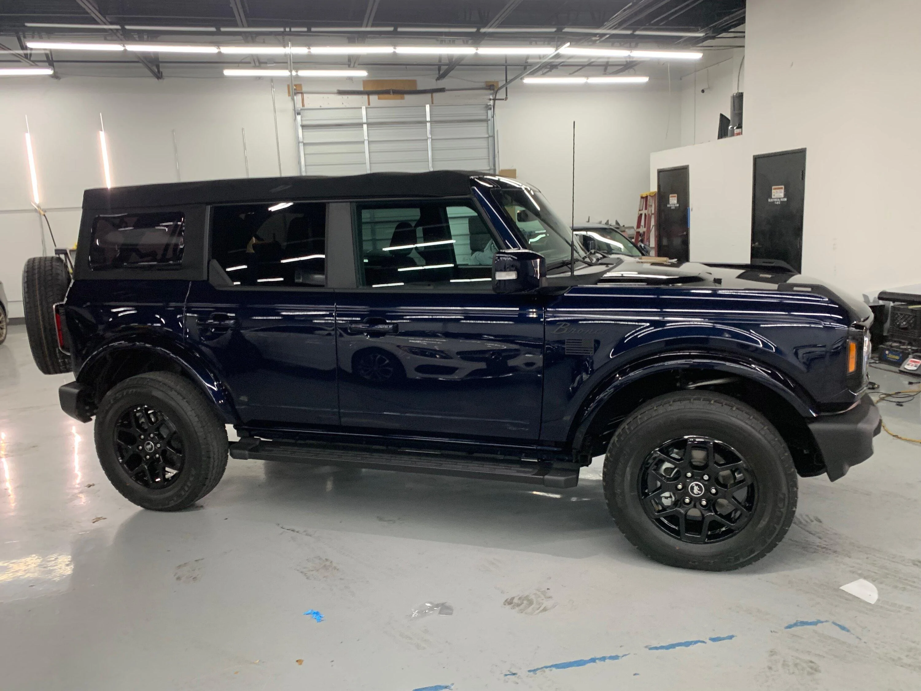

I powder coated my rims. I hated this machine face look.
This is something you need to decide for yourself. Lots of people put wider tires on rims that aren’t supposed to be suited for them, and I really don’t hear about too many problems with it - legally or mechanically. I know some tire shops won’t mount them, while other shops will, so that’s something to think about.
Personally, I tend to keep within suggested parameters, so nothing wider than 11.5” on a 7.5” wheel.
We’re putting new tires on our stock BD next month, and we’re going with 285/75-17, which are almost 34” and just over 11” wide. And for the OP and his OBX, you can run a 285/70-18, which is nearly identical to that size. I think it’s the ideal size for non-Sas rims with no lift kit…
I love black powder coated OBX rims! (and Badlands rims, which are very similar…) Looks so much better… 😎
