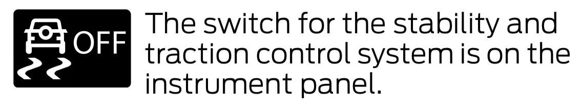

Ford Bronco Torque Management? IMG_0851
Actually if you hold down the Traction Control button for 5 seconds (as opposed to just hitting it once) should completely mostly turn it off. [page 202 of the 2021 manual]
I supose there might be some built-ins that you can’t ever turn off though.
[edit: nanny-mode never goes completely away apparently]

In a Ford you cannot completely disable the system without disabling a wheel sensor or pulling a fuse/relay. Pushing and holding the button will disable as far as the factory programing will allow. That does not completely disable it.
It might help the OP’s scenario though. Similar thing happens in my GTI. I have to partially disable stability systems to go WOT without being nannied prematurely

For sure. The push and hold is better than just the push.
