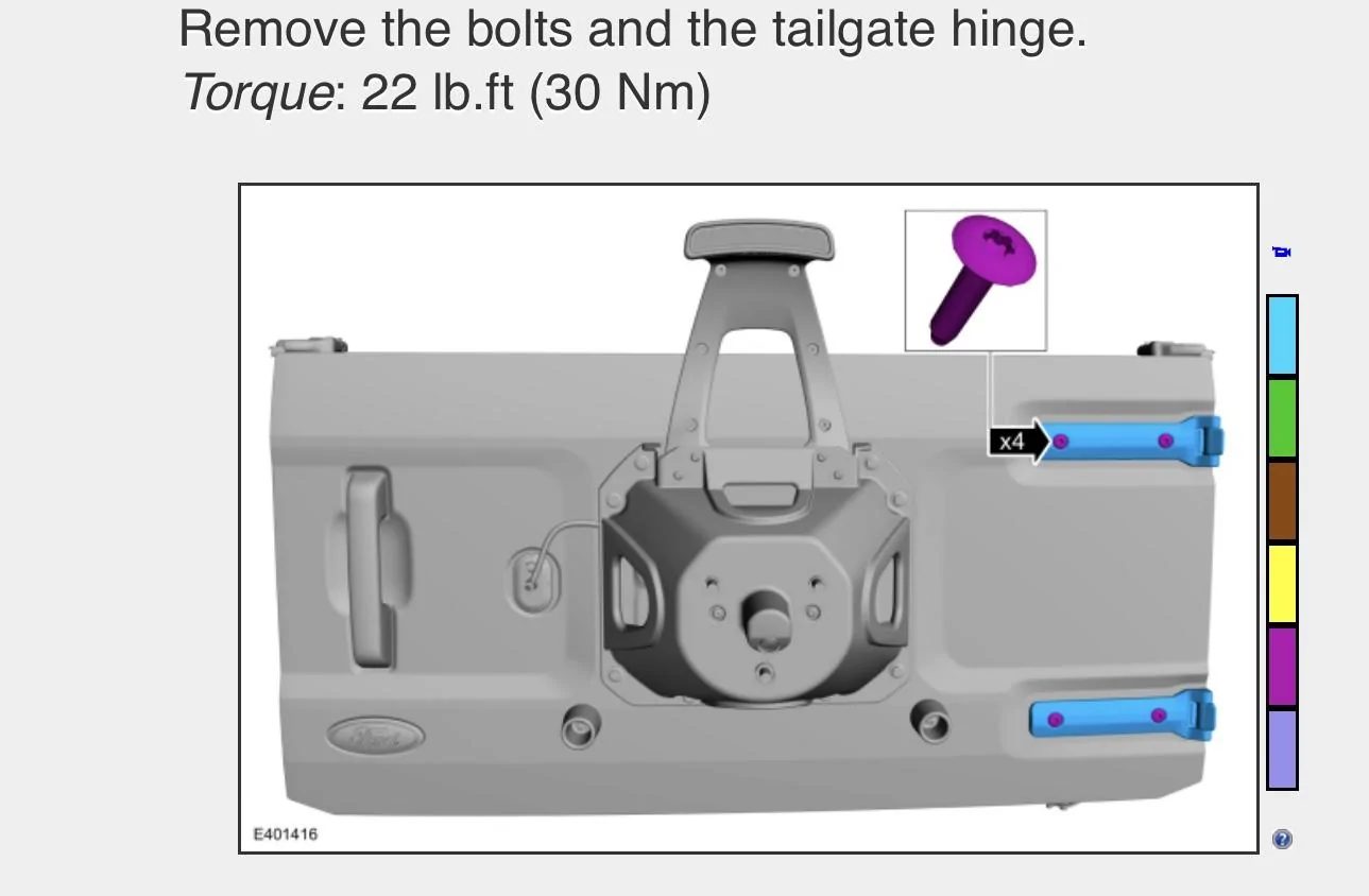

What is the tailgate hinge torque spec? I know that the carrier is 18 lbs, are the hinge bolts 18lbs as well?

Things I should have looked up yesterday before installing a reinforcement. Pretty sure I over torqued.
