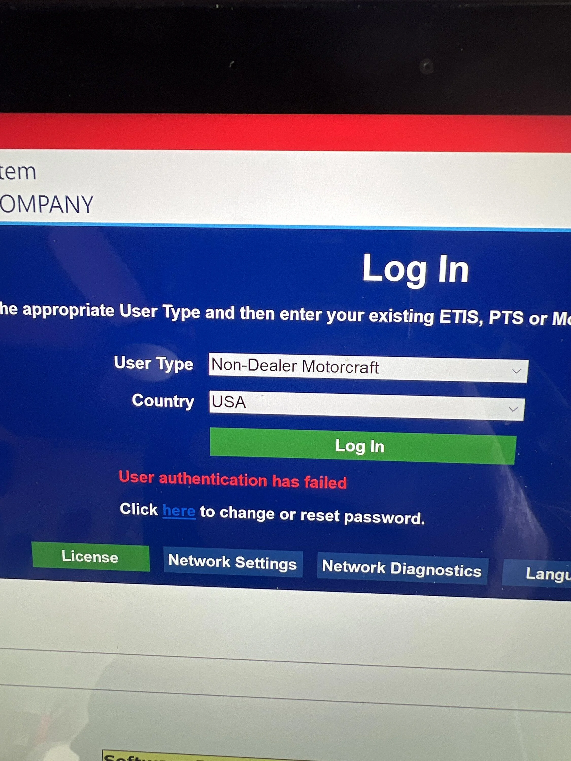

Won’t get past fords authentication.
Any ideas? May be the sight is down right now?

I don't remember exactly, but I think the non-dealer motorcraft is right and you use your motorcraftservice.com login/password (not the helminc license purchase login).

Finally got it. Was fords website. Portal was offline for a couple hours.
