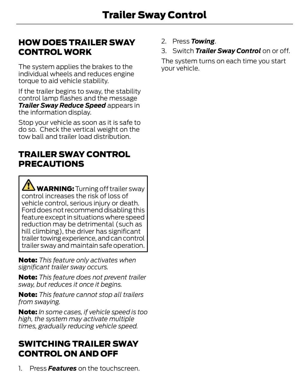

Ok, I’m not sure if this is right and I just realized it after having the Bronco since December. When I go into tow setting I always notice the car always has Trailer Sway Control in the “On” position every time I start the vehicle. Even if I turn it off, the next time I get in it’s on again. Is this correct or is there an issue?

It defaults to on after every ignition cycle. This is normal.
