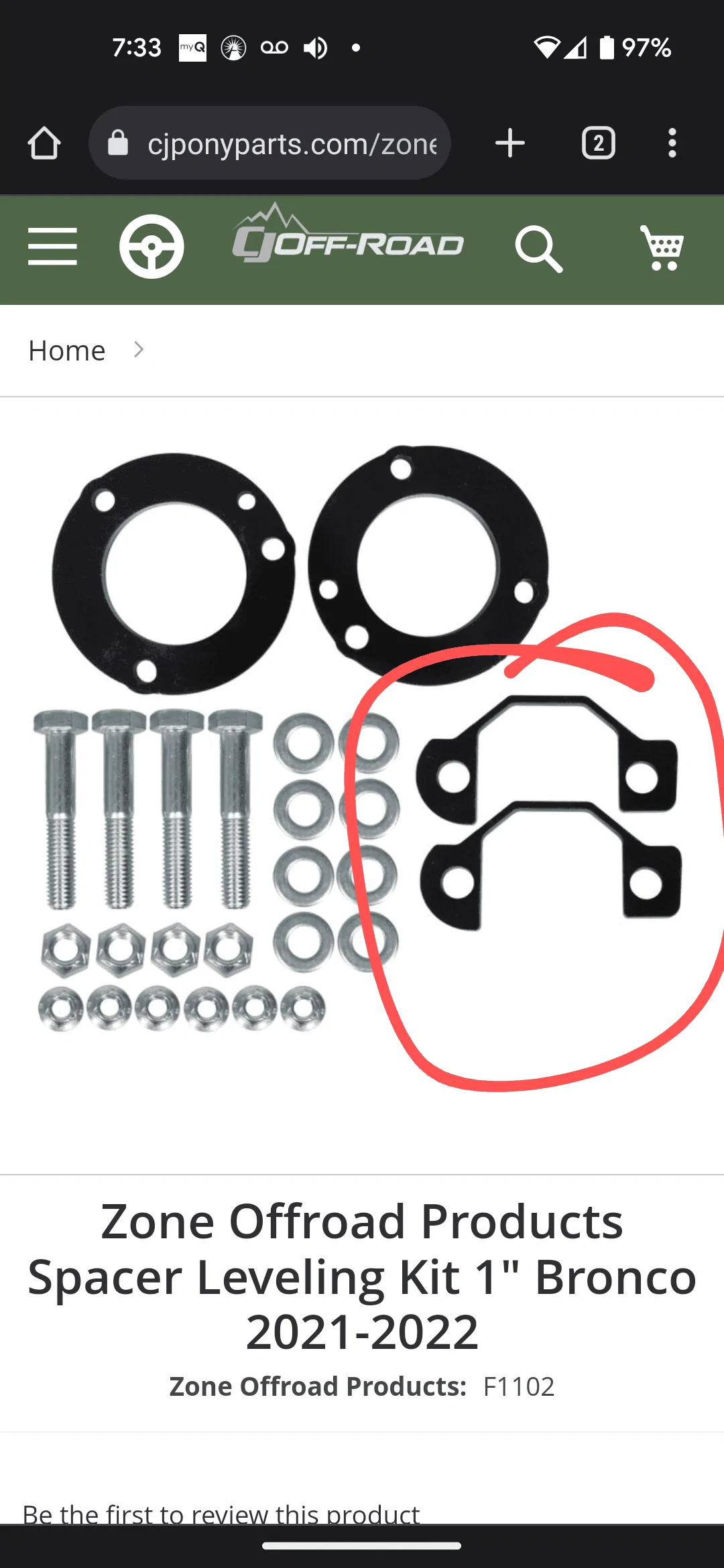

Why not stack washers under the lower a-arm bolts? I would say buy a $50 leveling kit but that cost money.
I actually have one of those kits that I was going to put on before I bought the Icons. In the end I wasn't a fan of the extra droop, my tie rods and CVs are already making me nervous at full droop with just the Icons.

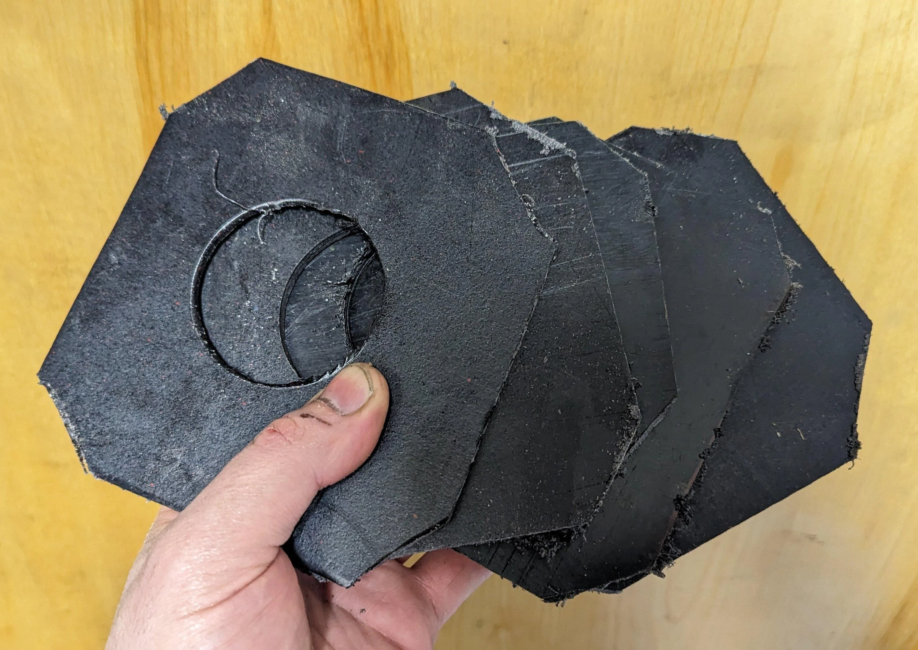

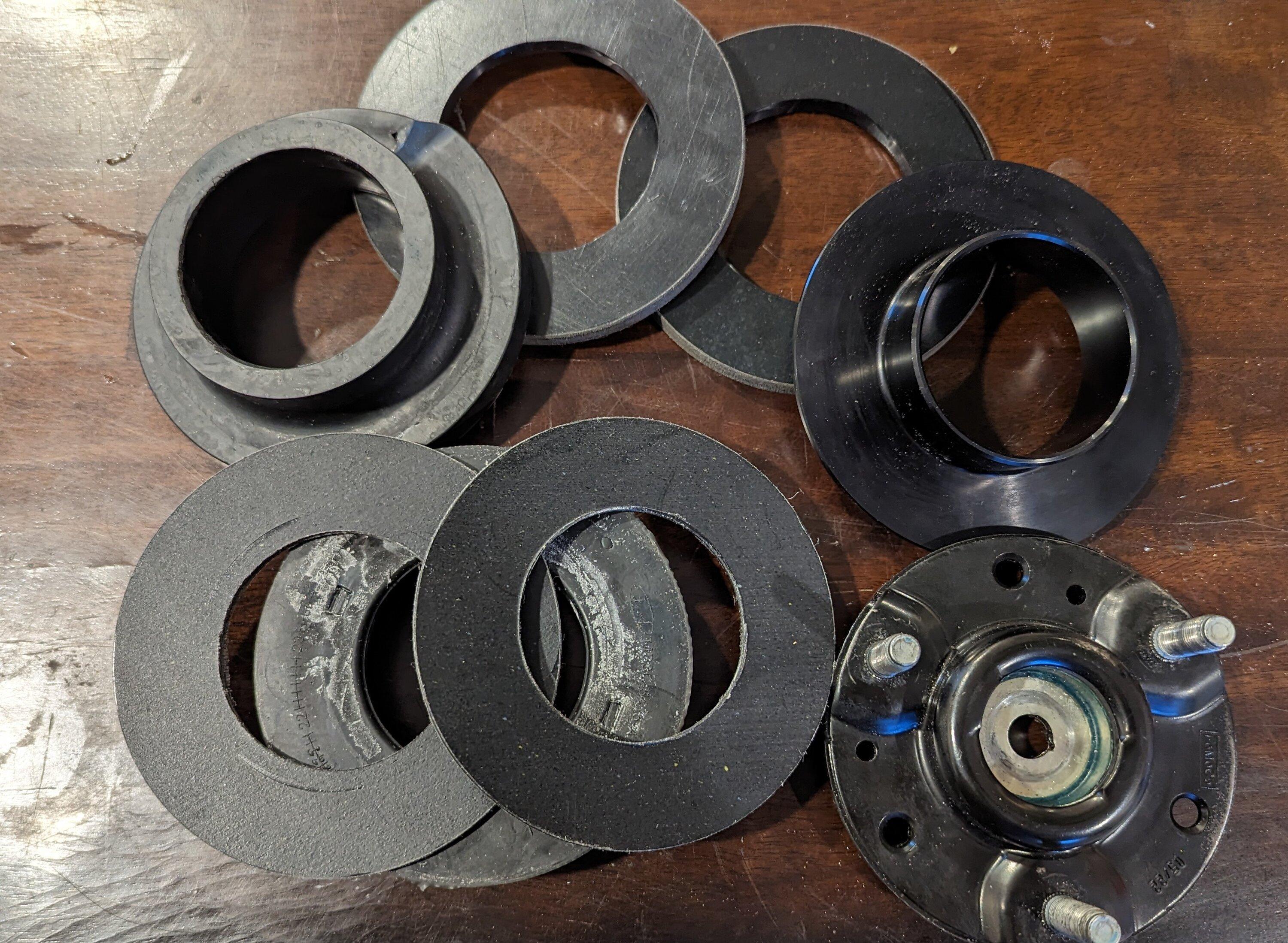

They look pretty horrible now, but a few minutes on the lathe ought to clean them up. Four 1/4" and two 3/8", some combo of that should work.

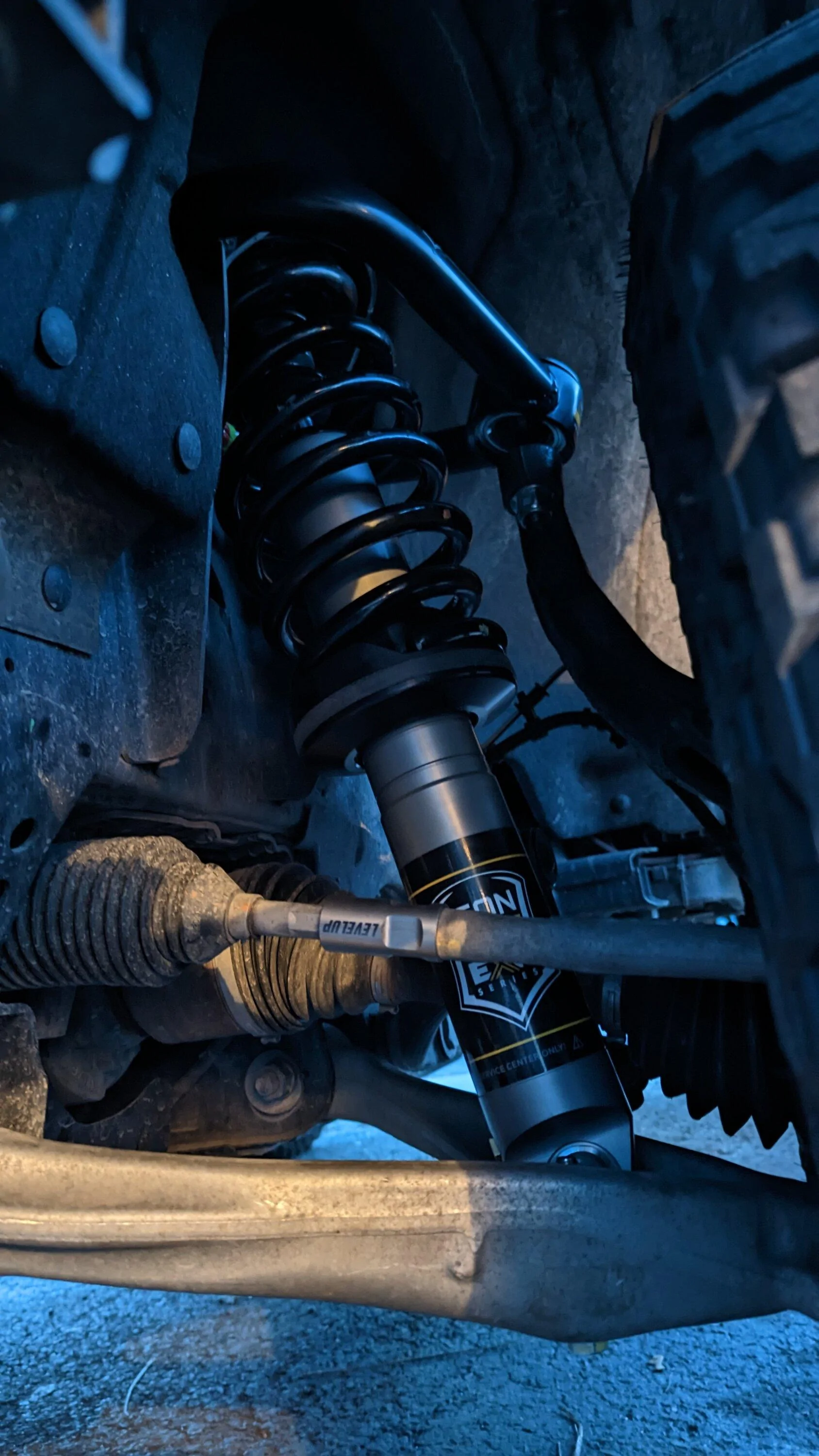

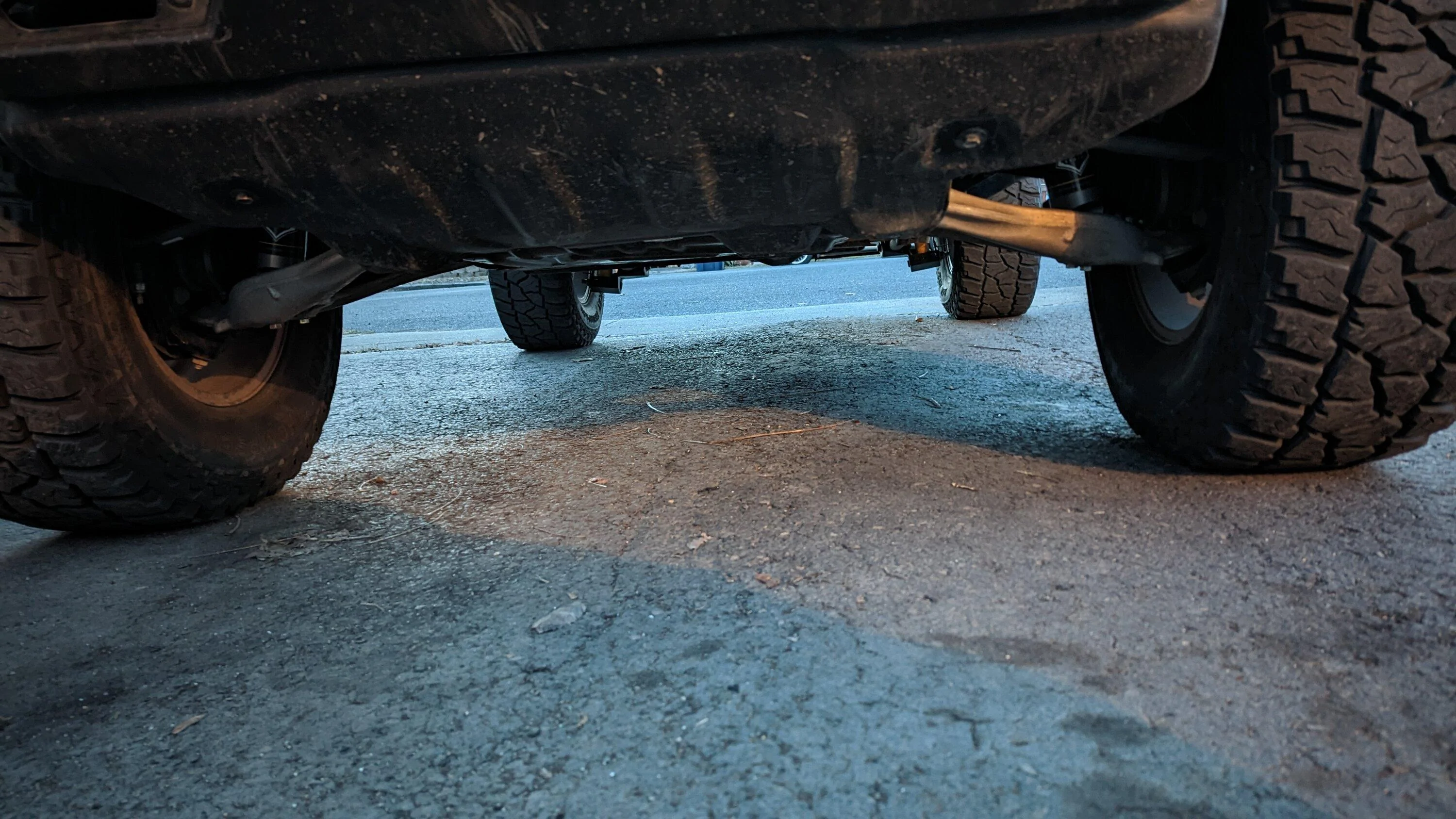

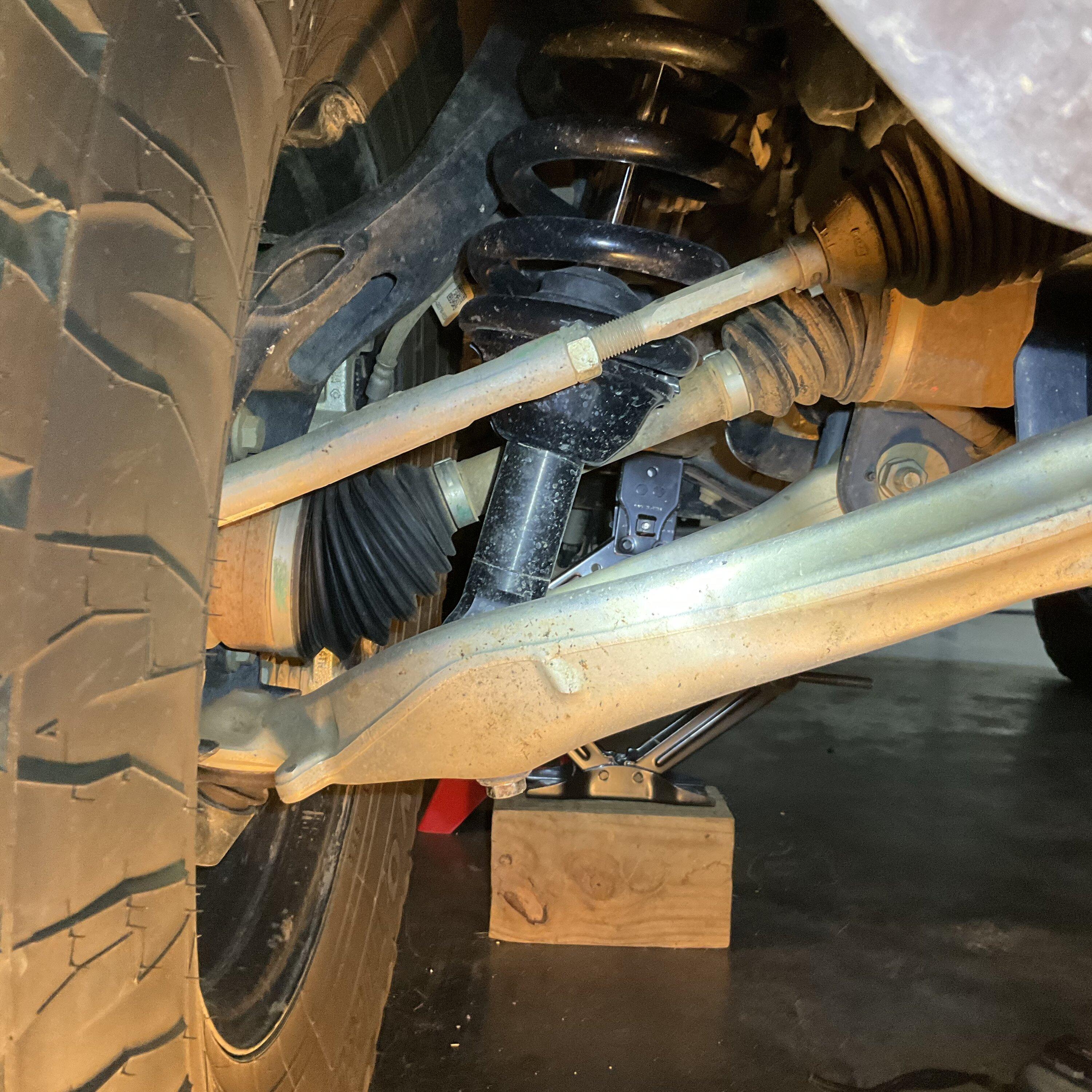

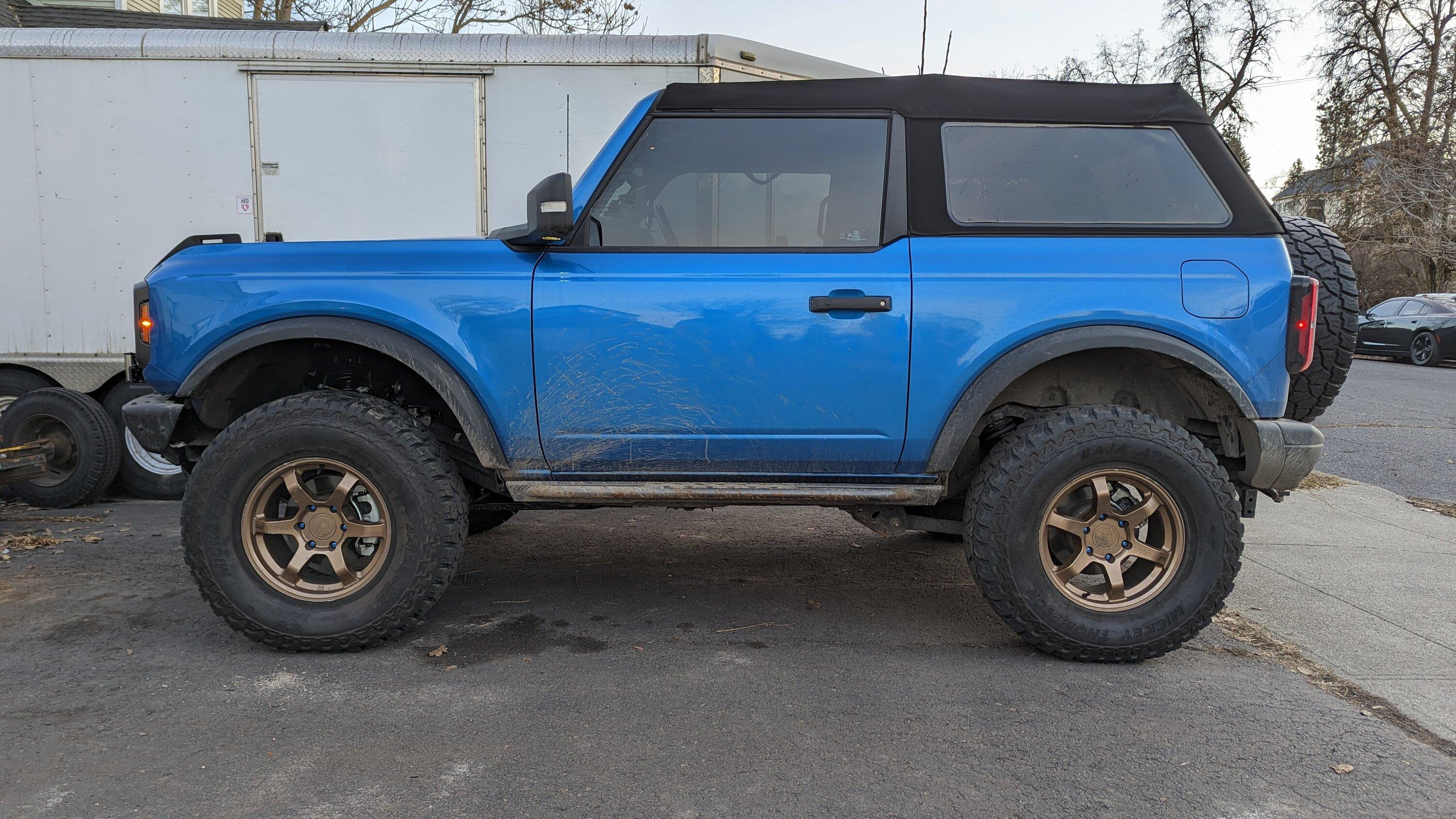

The 1/2" worth of coil perch spacers worked perfectly. They are the lighter black ring in the pic.
Sitting at 24.5ish hub to fender in front and 25.5ish in back, or about 39.5/40.5 fender to ground. I figure that's 2-2.5 over where I was. The angles are all much happier.
Still looks good with 35s but will clear the baby 37s without worry now.
Taking the Territories in tomorrow to get dismounted.

So how much clearance did you gain on the gas tank? I find that's the best part of my lift. I'm dragging that tank over far less stuff now.
