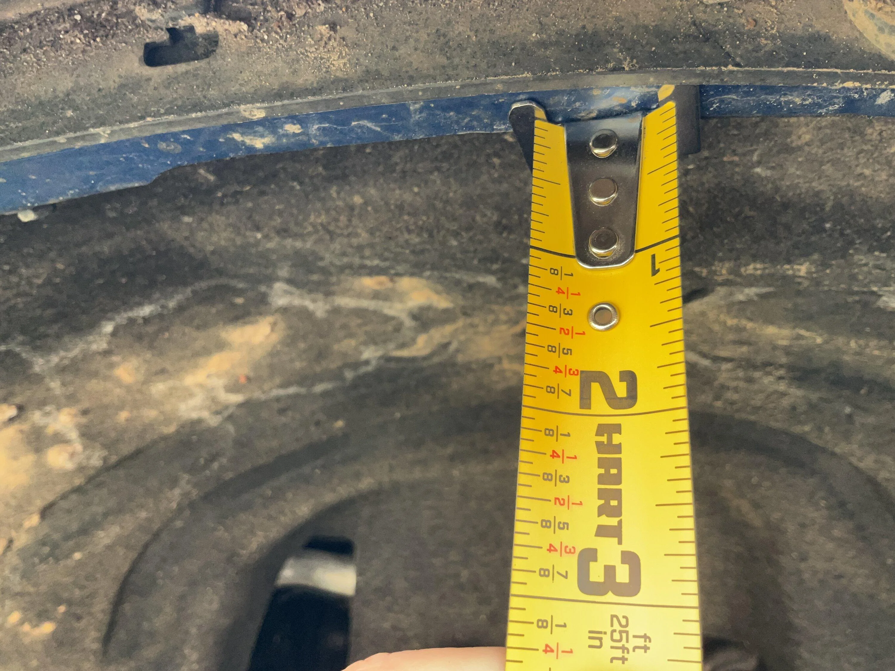

If I removed the plastic flare, I would be measuring to the bottom of the fender roll. I just figured that’s what was meant so I subtracted an inch. Otherwise I would be at 26.5” and 27”, and that can’t be right with non-Sas springs on non-Sas shocks. I’ve only got the perch collar lift in rear.
Just measure to the metal fender, like if the flare wasn’t attached.

Ok, I'm now at 26" to the plastic, 28" to the metal.
Need at least 1" more in the rear. Going to try the 4dr/V6 Sasquatch coils on my Bilsteins. I don't think I've seen anyone try that yet.

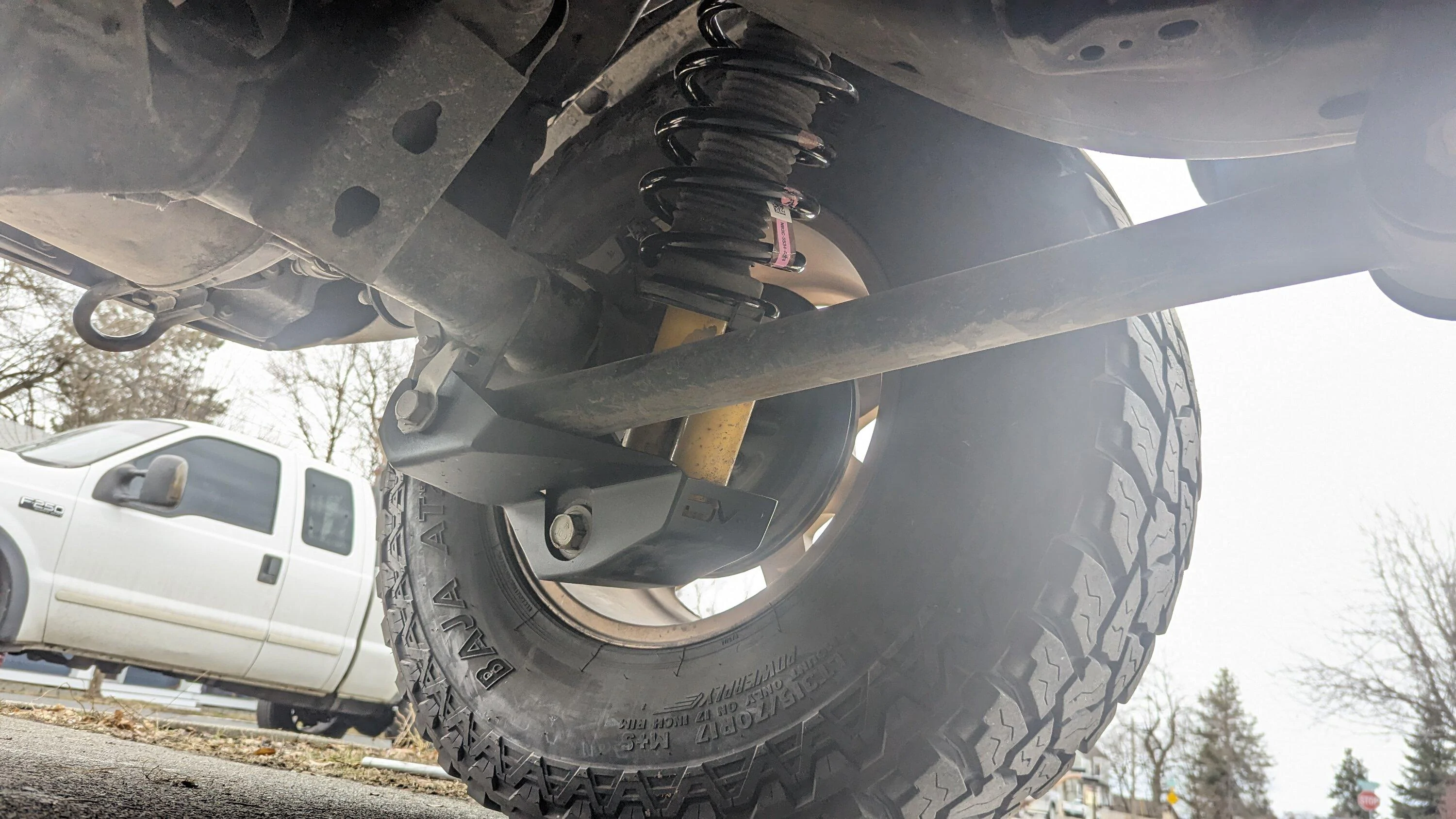

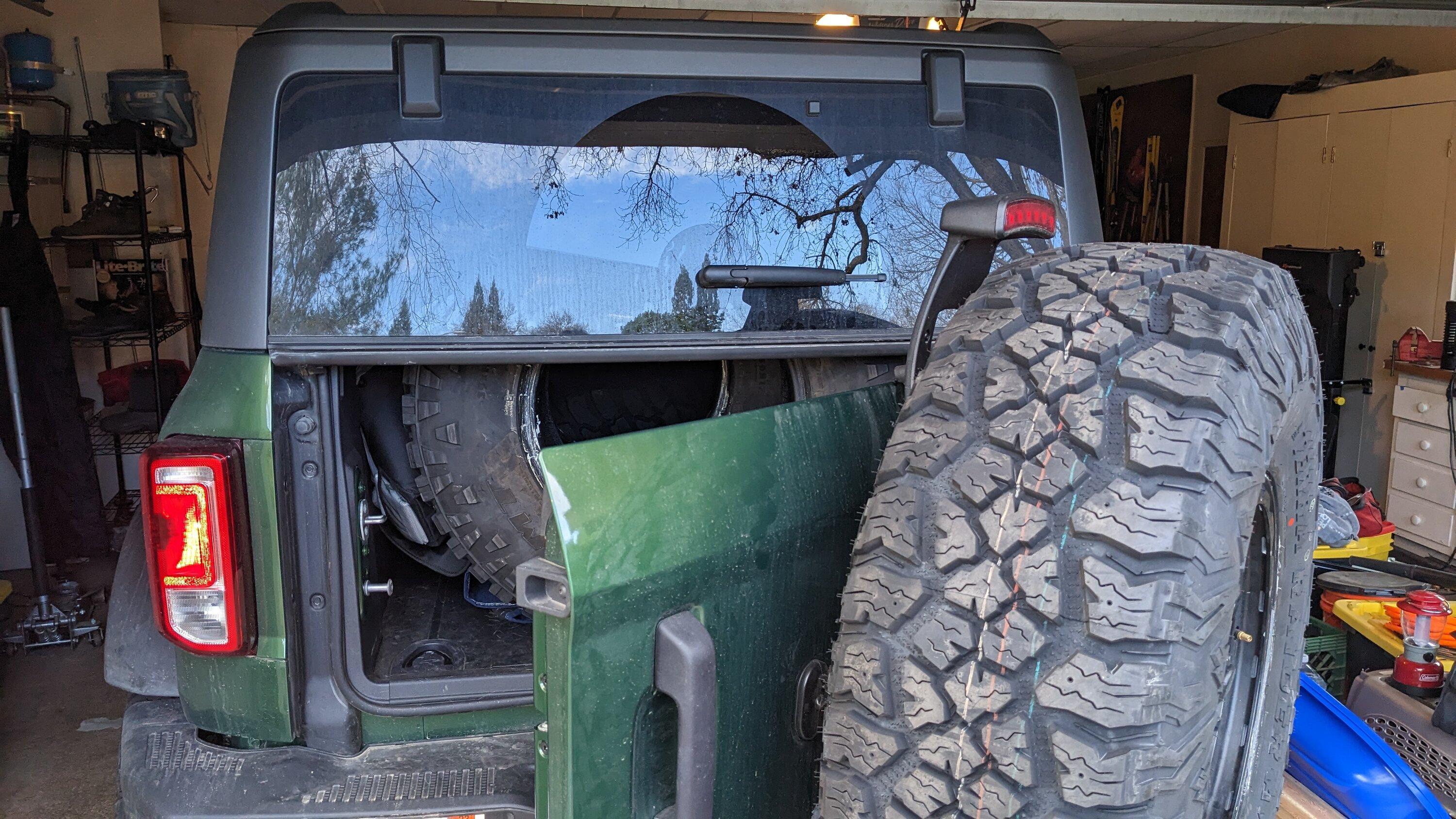

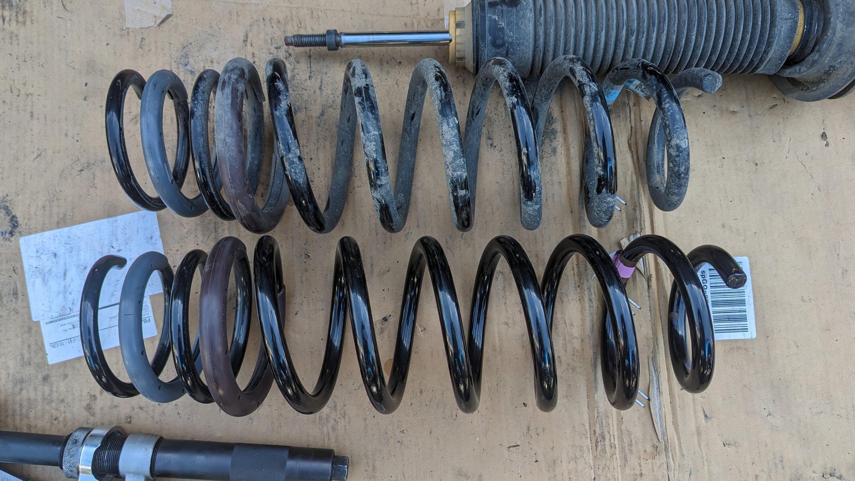

I just can't find the sweet spot. I'm at 26" all around now, but it still looks too high in front. The Sasquatch rear coils were about half inch longer unloaded and good for about an inch installed.
I'm thinking I'll get the winch on and see if the front settles out a bit more before deciding the next step.

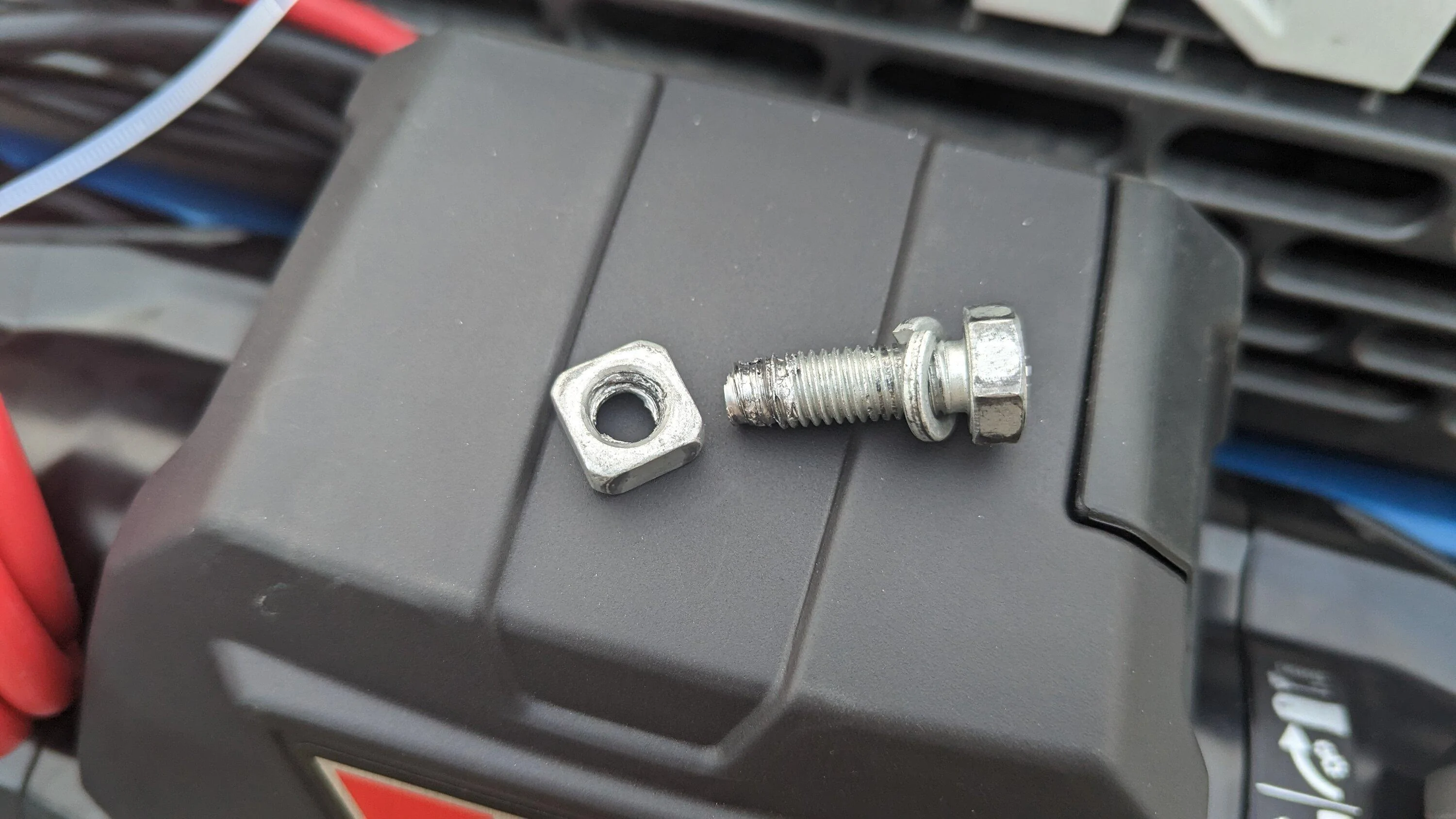

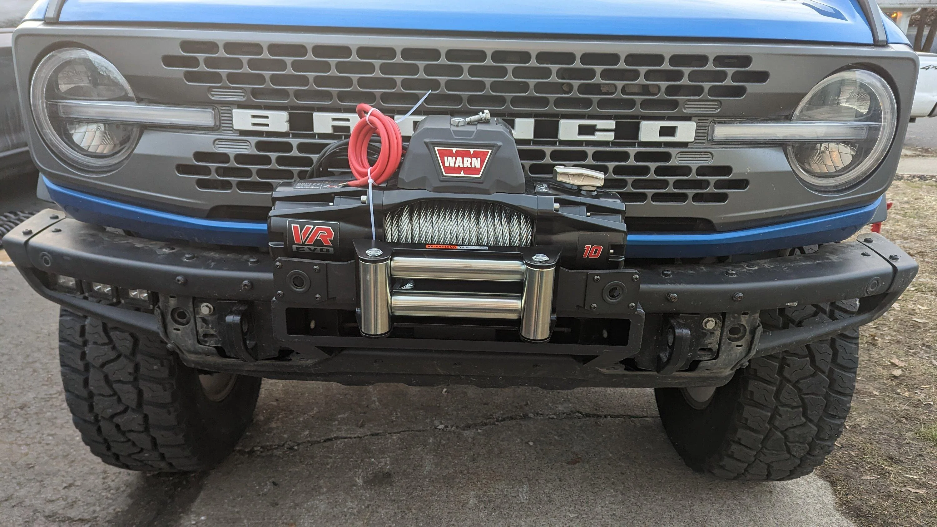

Got the winch mounted, except the last bolt crossthreaded. This is why we can't have nice things.
At least the DV8 skids installed easily.

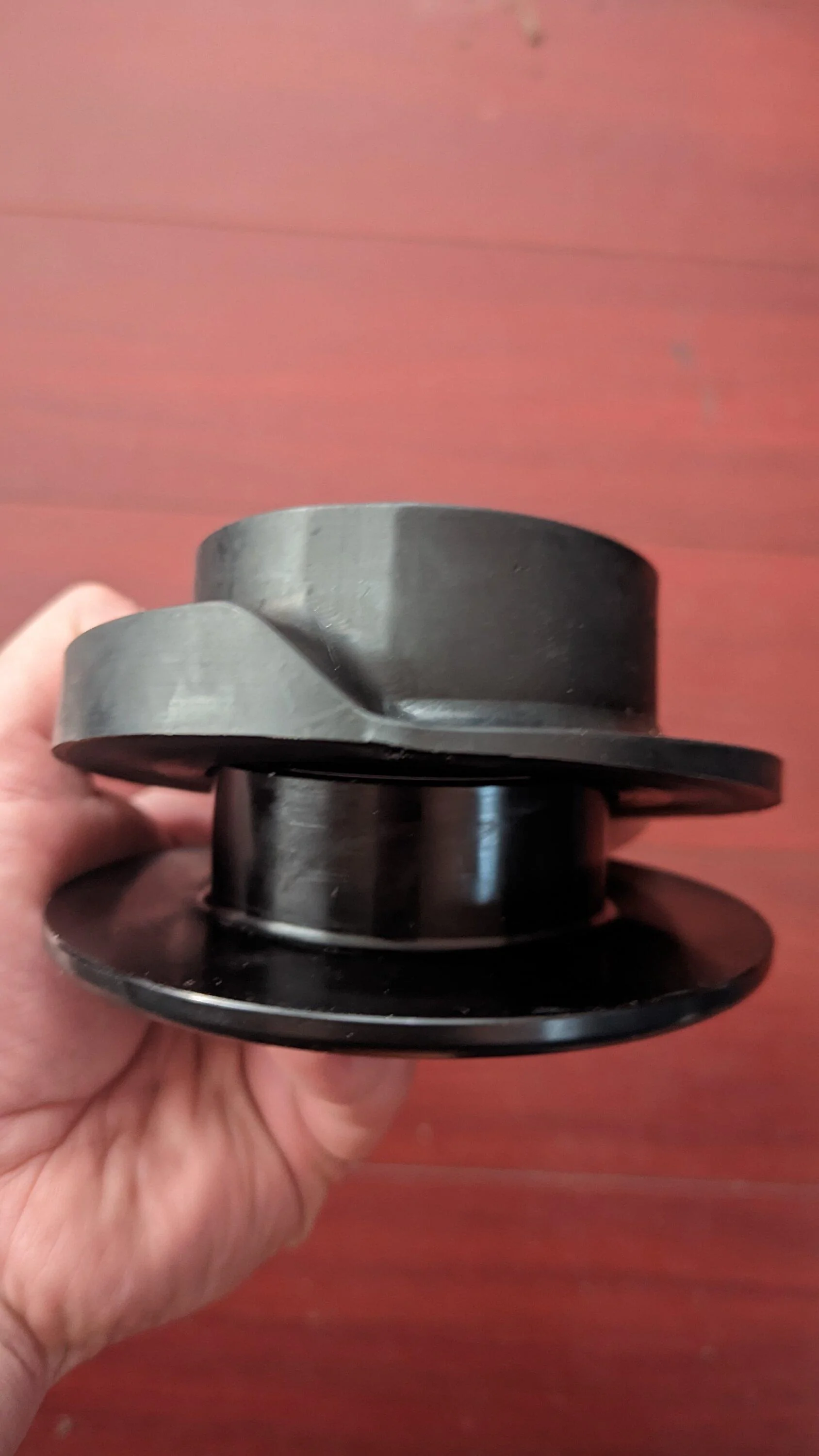

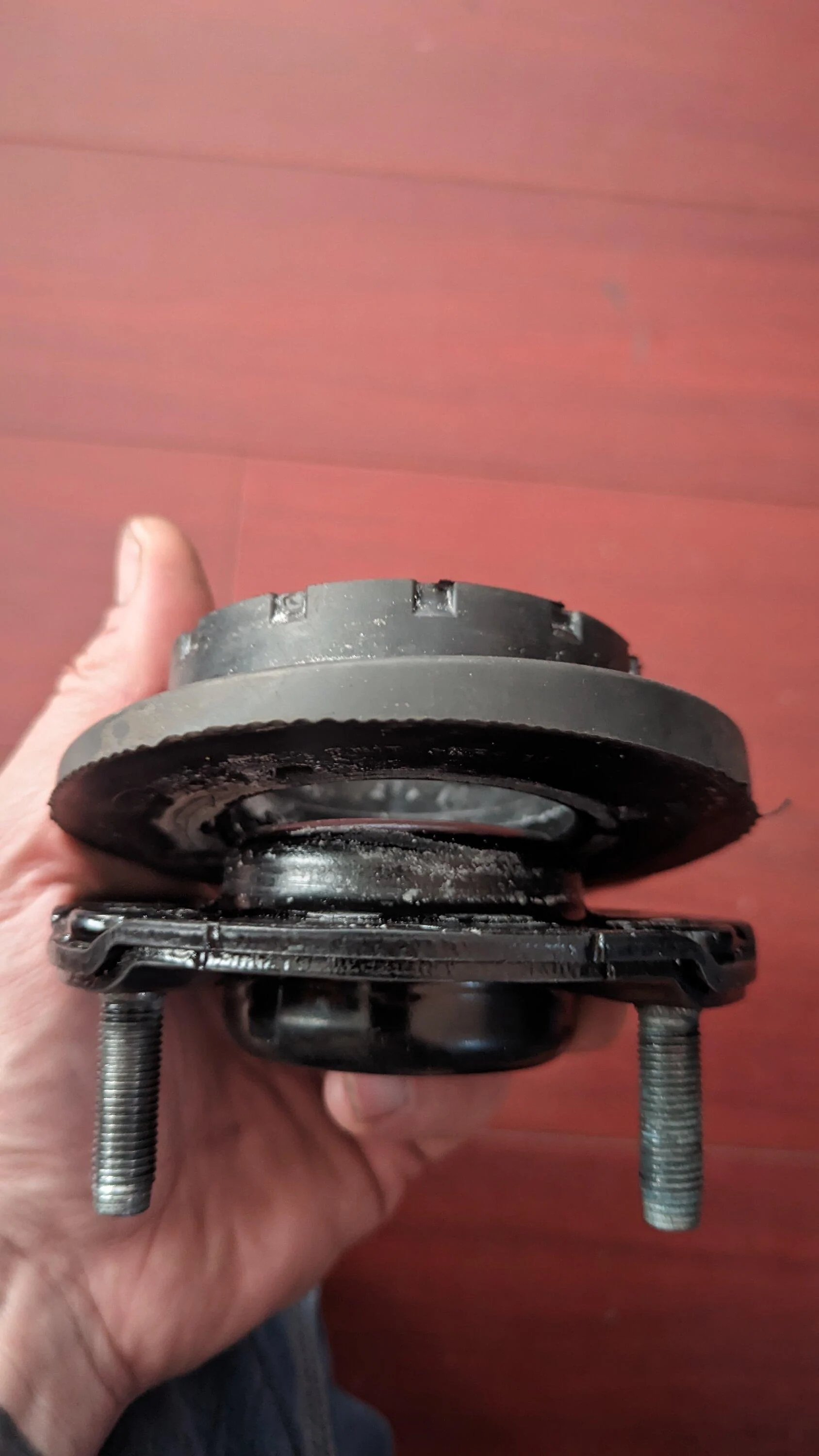

I got 5.25" tire to fender measurements from a stock Sasquatch and compared to mine, I'm at 9.5"! That's on the 1.3" lift groove.
So plowing forward with the UHMW spacer idea. The 1st and 2nd groove are exactly 1" apart. Since I want to split my lift roughly in half and hit the 2-2.5" range, I'm going to split that 1" with 1/2" worth of spacer and see how it looks.
There is a decent lip on both the perch and hat so it should support a thin spacer just fine. Probably go 1/4" each or 1/8" on top and 3/8" on the bottom. I'll cut a few so I can experiment.
