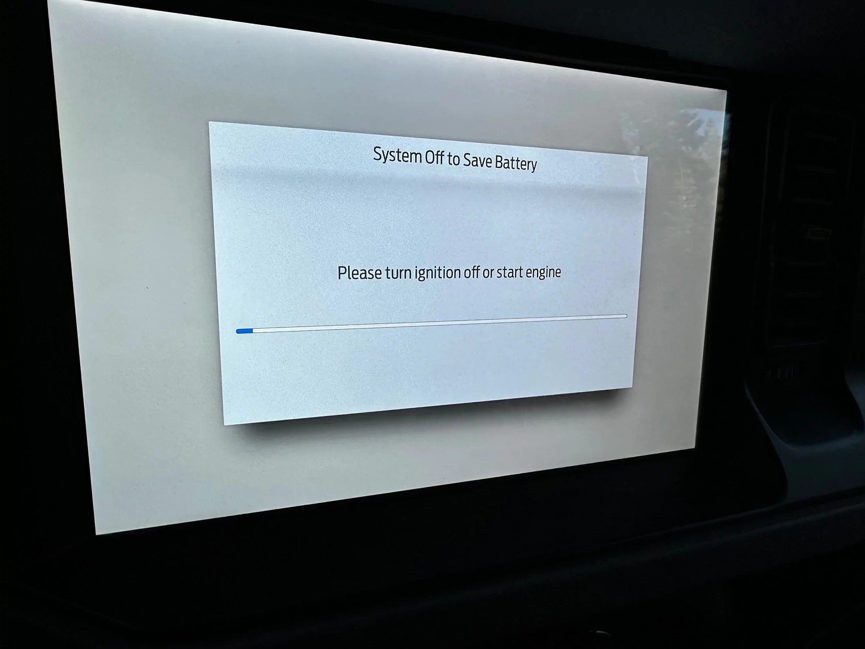

Follow up. My battery came back with reverse polarity and they gave me a new one. Put the new one in and Im still having problems. No new add ons. I had a dual air compressor installed 2 1/2 years ago and a hidden winch 4 years ago. Nothing else electrical upgrades. No 12v fridge, I have a 2.4 kw old bluetti for that.

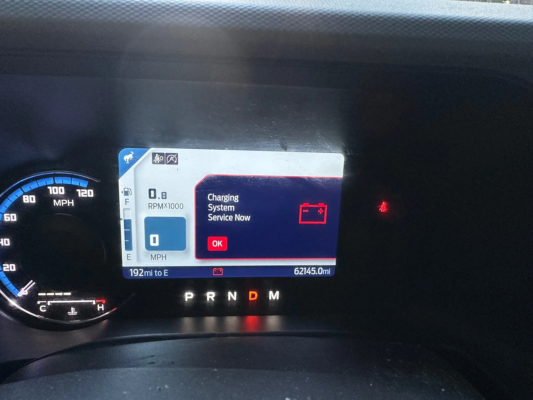

New battery giving me warning on my screen saying screen its shutting off screen to save power and to service soon. Other warnings to service electrical.
I drove it home from parents and parked it and disconnected new battery. I’ll make appointment with Ford and flat tow it there with truck and drop it off.

Pull your addons off.
Follow procedure to do a full bms charge and reset.
do an ammeter test to see how much power draw there is when powered off.
check your grounds.
Brian_B
Sep 14, 2023
64
8,832
15,765
Central CA
Sounds like an alternator issue
