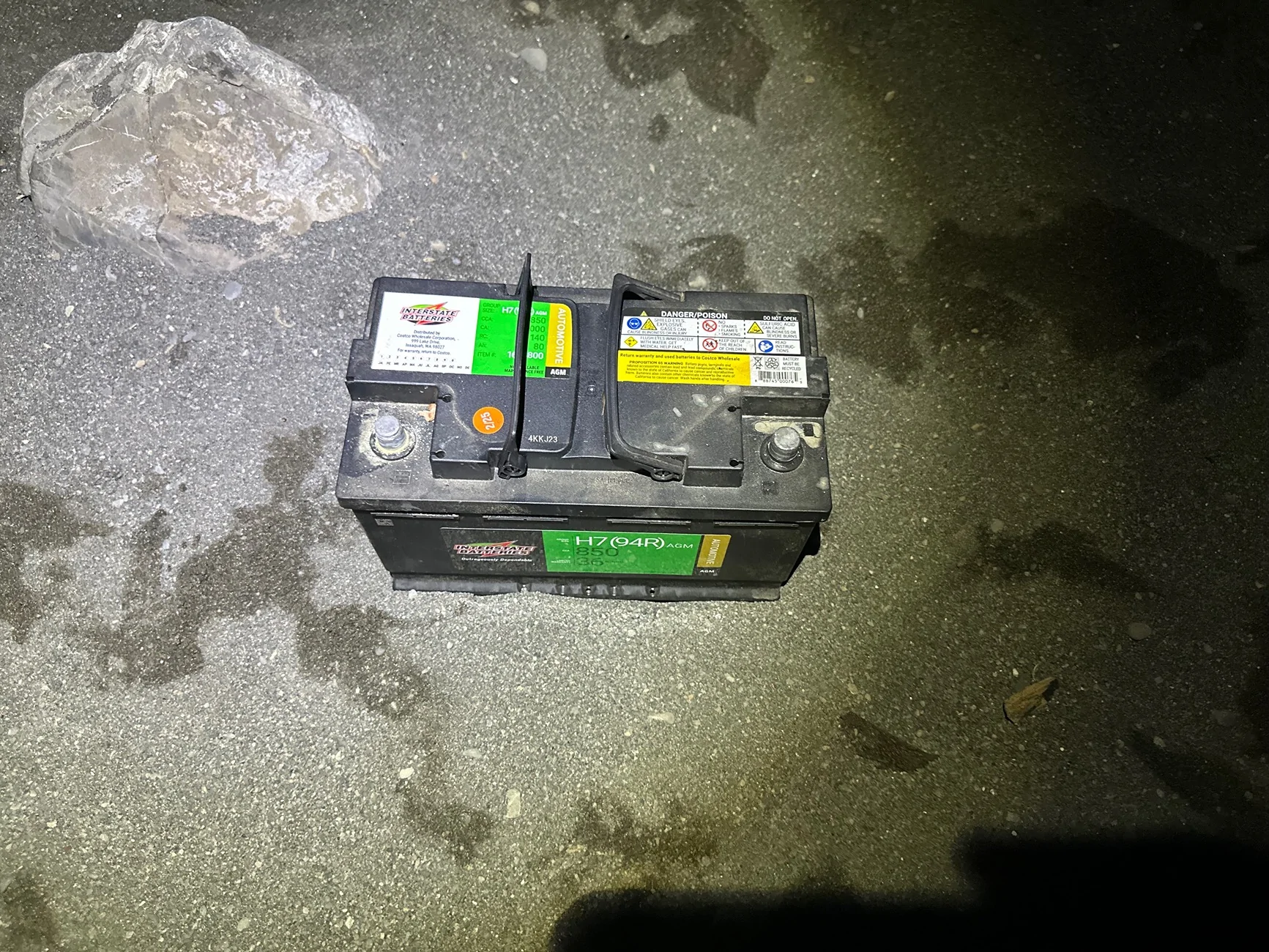

I went beach camping this weekend and had a 14 month old Costco battery (pictured)
drain completely. Had a new one brought to me on Sunday and it got me home fine with two stops on the way. Left Monday on business trip, to come back home just now on Thursday to find new battery also dead.
Any ideas on what to check on my own before taking it in. I’m not mechanical, so any ideas welcome. Thanks

If you installed anything electrical start with them.
Watch a couple videos on tracking down electrical drains and pickup a meter and start looking.

gotta be a drain....i'm 44k miles and just over 3 years old. stock battery. If you don't have any electrical mods might be dealer visit time...or at the very least a shop that you trust can chase down electrical gremlins
good luck

Having been thorough this, check the negative post on the battery, there is a shunt that is know to go bad. Was $24 part, that made all the problems go away.

did you reset the BMS after installing the new battery?
Lots of awesome ideas here. Thanks to all. No I did not. I will charge the battery back up and reset it.

Agree. What electrical devices did you add? Something is hot, battery, especially new won’t drain that fast.

Could be battery is fine but Bronco just thinks its low - the classic “Did you reset the BMS”
Not a certainty mind you, but a good check to make before jumping into a deep troubleshooting rabbit hole.

Tried to reattach the battery after charging all day and over night and all it does is blast the horn. Nothing else happens no attempt to give power to anything. Just like someone is laying on the horn. Trying to find where the horn is so I can troubleshoot.
