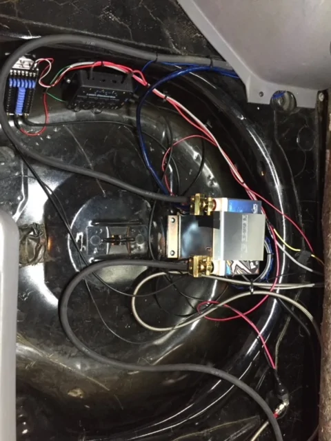

BATTERY ISOLATOR. (This is a must if you have 2 batteries)
What is it, Connects two or more batteries to a single charging source—like an alternator—while keeping the batteries separated when the engine is off.
Run your main battery just to crank you bronco, Use the second battery for everything else. That way you can run the second battery to 0 and the Bronco will still crank.

Well who needs the second battery, The person who has something running all night on a camping trip. like a Fridge. This way in the morning the Bronco will still crank after using the Isolator.

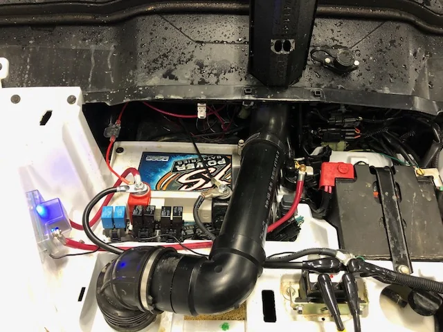

I actually did all this research years ago for my second battery for my SXS. I came across XS battery company. Everything told me they are the best.
The one in my SXS is about 8 years old still works great. XS D925 (28AH CA550) As posted above my winch calls for 650CCA minimum.

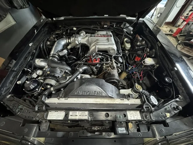

But the one in my Race car is XS D925 also (28AH CA550) This is on a 10 to 1 compression supercharged car, I've had this little battery all the way down to 40% and it still crank my car.

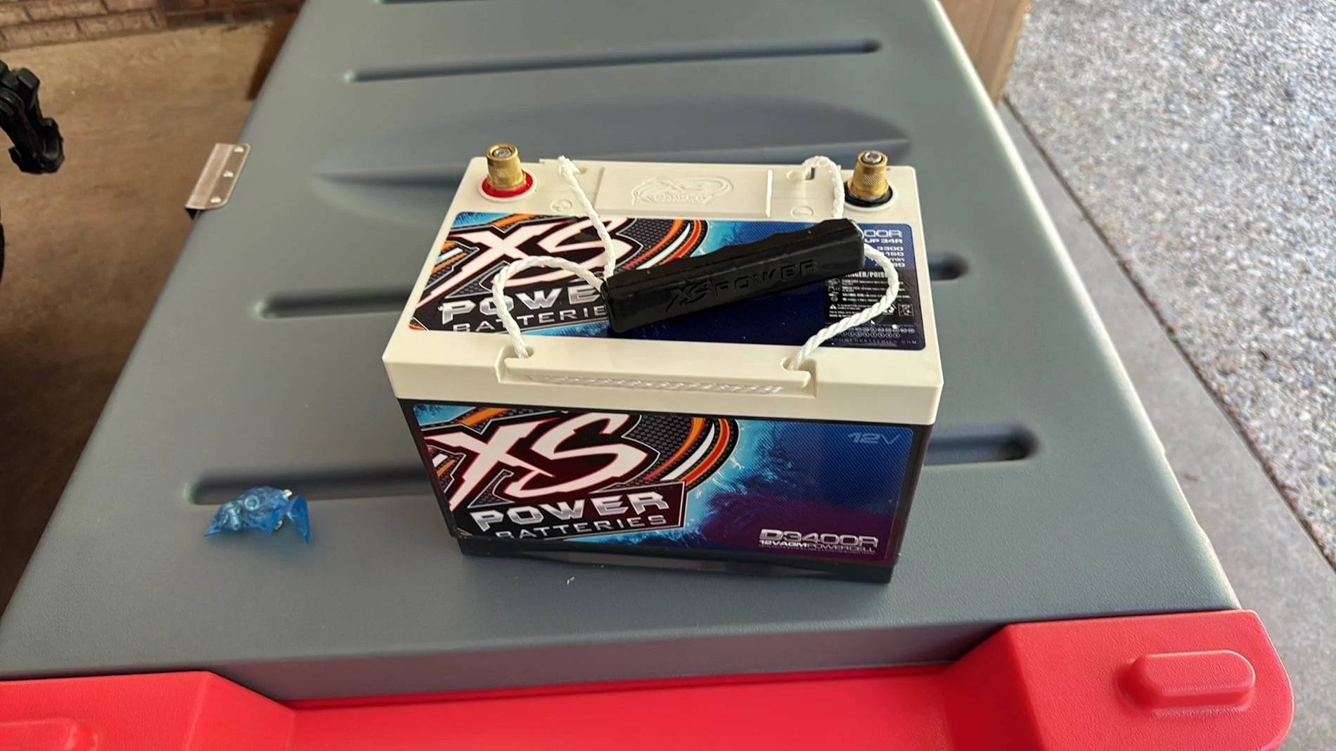

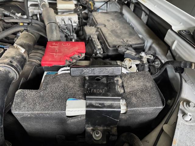

Added an XS Battery ((((D3400R))) It has to be the ((R)) to my Bronco it fit great nice and tight, Its not a perfect fit by size but it fits and it got tight with the factory bracket no movement.
