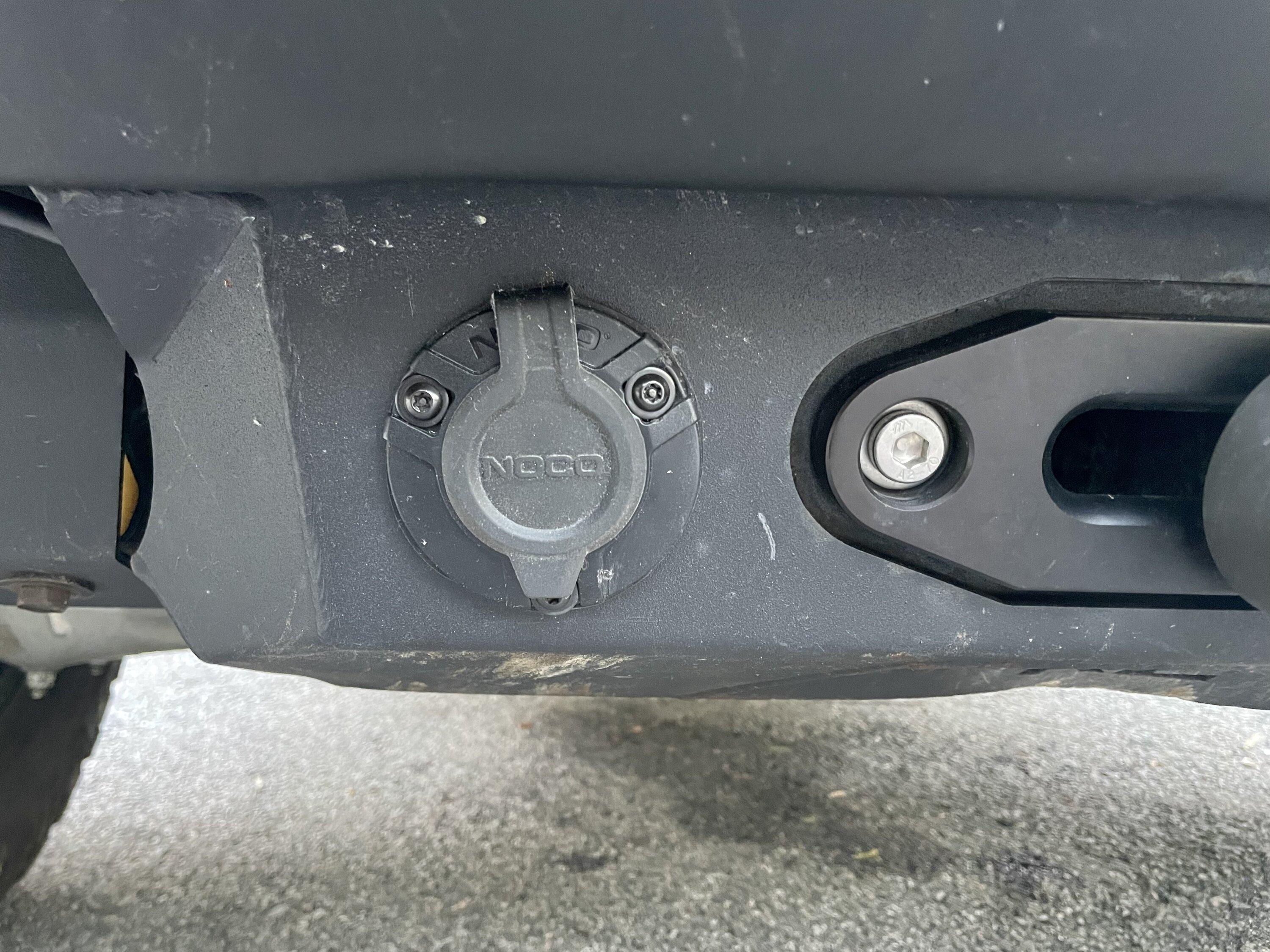

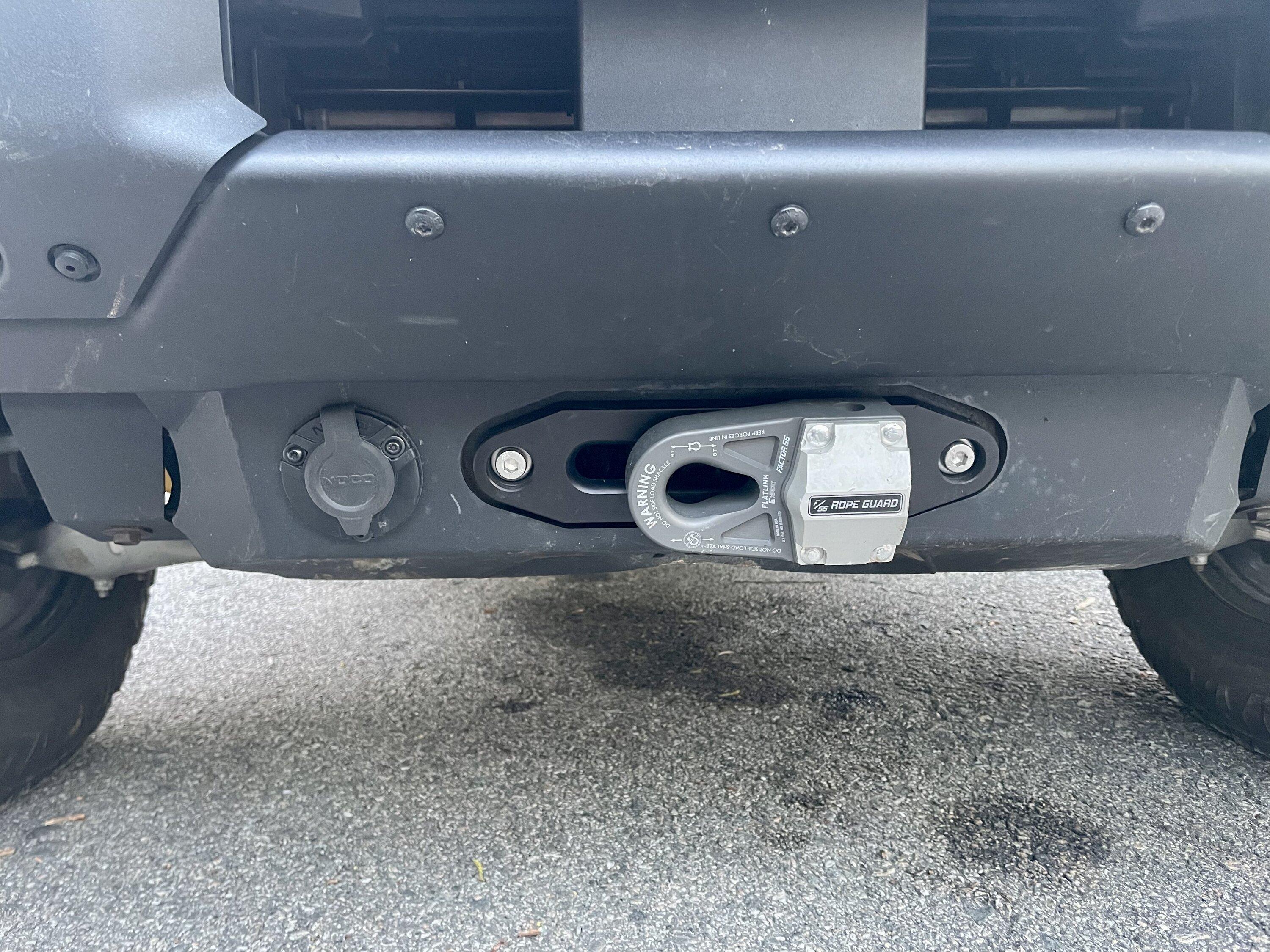

Finally got around to this. Noticed there is JUST the right amount of space to mount the Noco Power Plug next to the fairlead on my RC Hidden Winch Skid Plate.
The screws that come with the Noco are trash. So, I got some high quality black oxide torx screws and washers from Grainger. They’re a bit long - but, they did the trick.
Now I just need to clean up the wiring and install the block heater at one point.

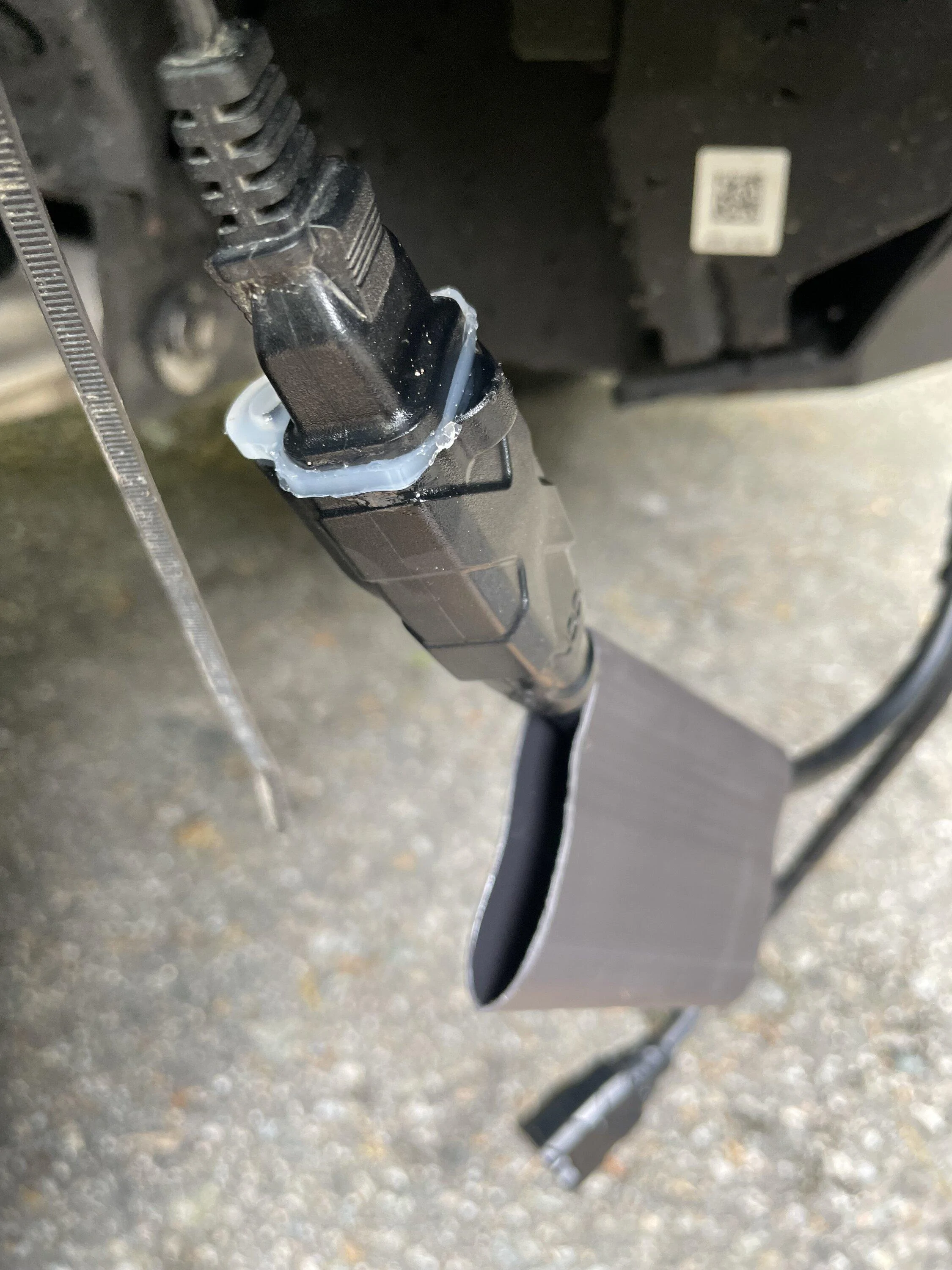

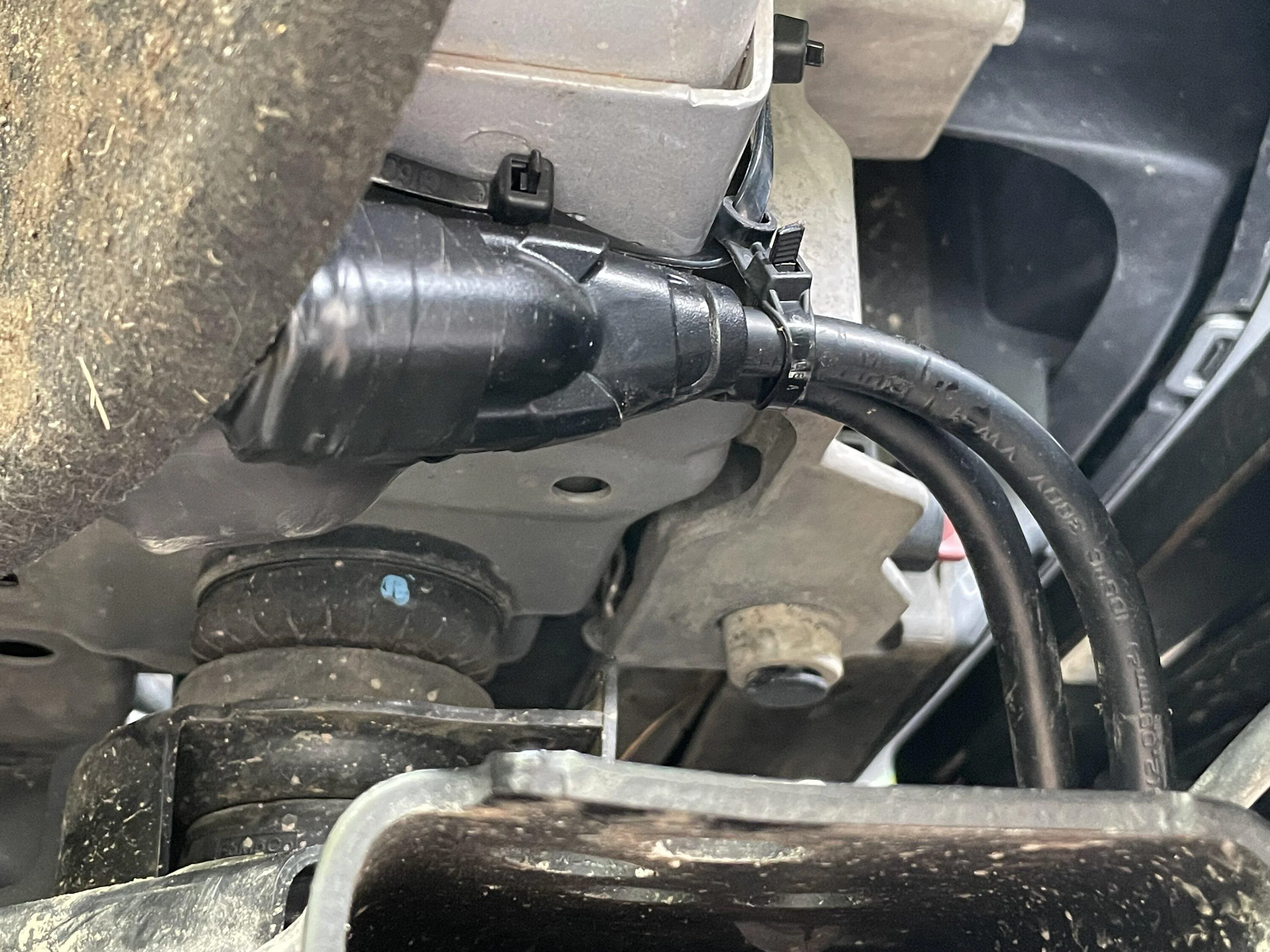

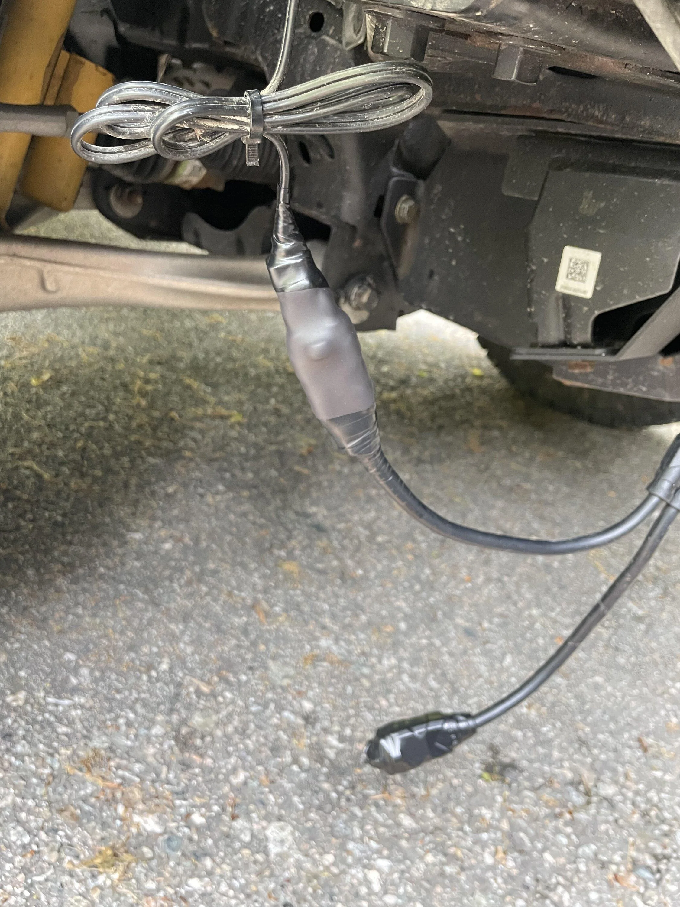

Tight and tucked! Water/dust proofed with some A Plug Pro gaskets, dielectric grease, heat shrink wrapped and zip tied to the crossmember with the extraneous cord stored behind the wheel liner. Second plug is for the block heater when I finally get around to that install. Super happy with how this turned out.
Now I just need to research smart plugs so that I can remotely turn on or off power to the block heater if I just want to run the maintainer/charger.
