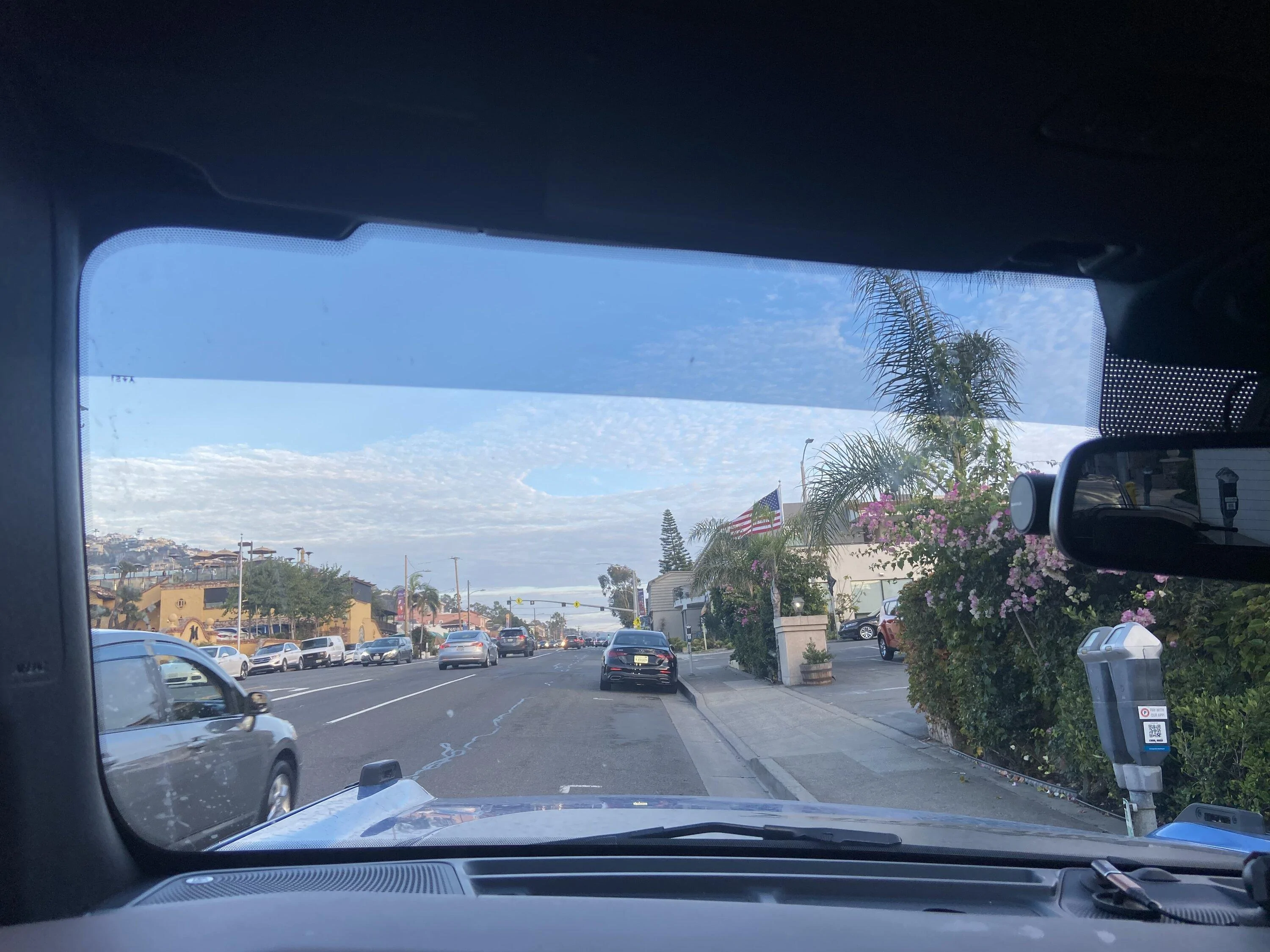

I bought a roll of (35%), so I guess it blocks 65%, and I’m wondering if it should be darker. I didn’t want to be too dark, specially at night. I guess I’ll know tomorrow when I drive into the sun. I bought the role for about $13 at AutoZone and I have tons left. I cut pieces that were 21.5 (Left) and 19.5 (Right), sprayed on a ton of soapy water and the pieces slide around just enough for the edges to tuck just inside the gap between the plastic and the window.
Ford Bronco Visor Tint 603F0A77-9263-4F92-B63D-C62974D47125
