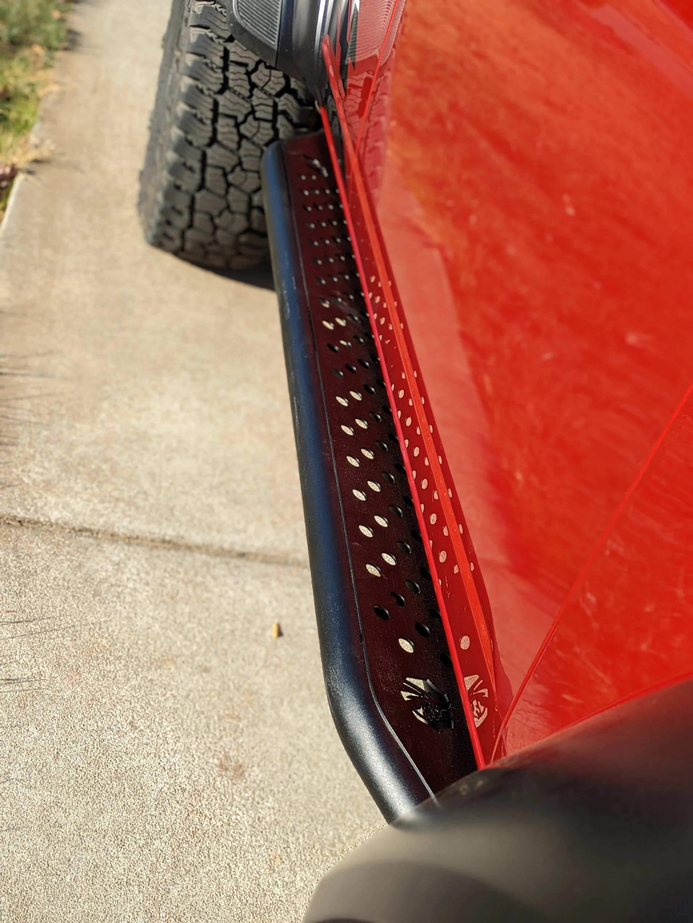

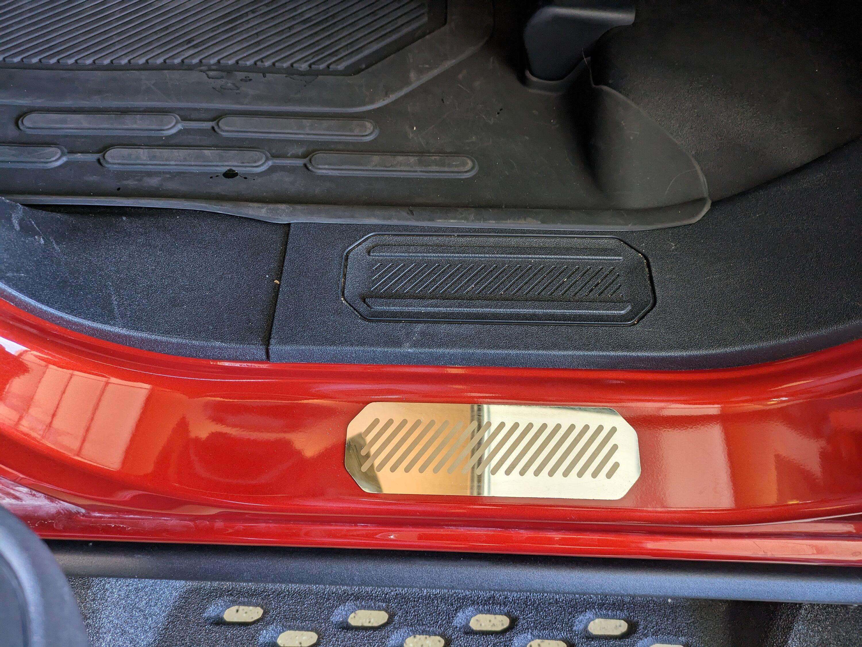

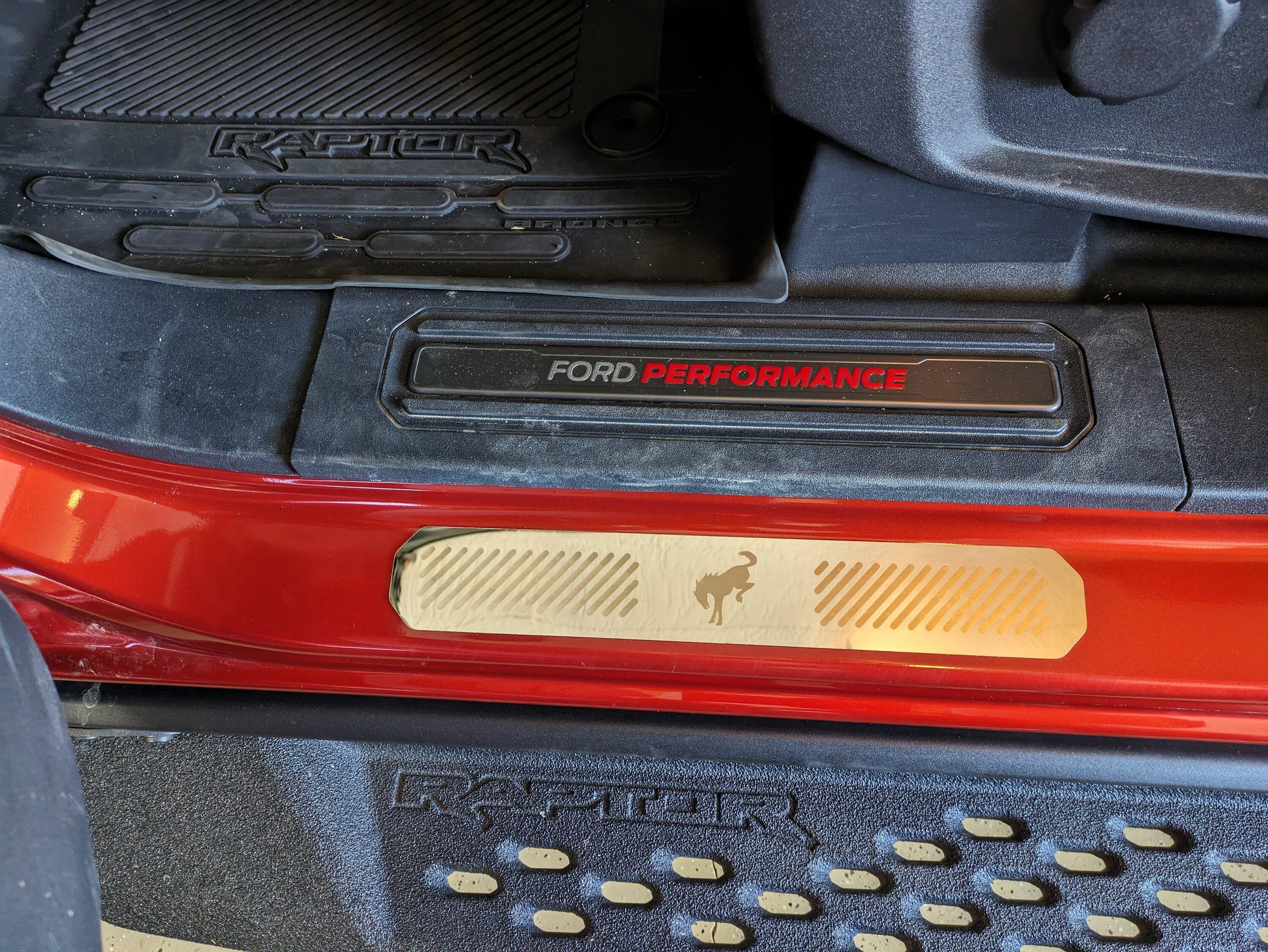

Ford accessories door sill plates bought on points.
Ford Bronco vrtical's Bronco Raptor Mod Journal PXL_20230813_135939293
Ford Bronco vrtical's Bronco Raptor Mod Journal PXL_20230813_135950725.MP

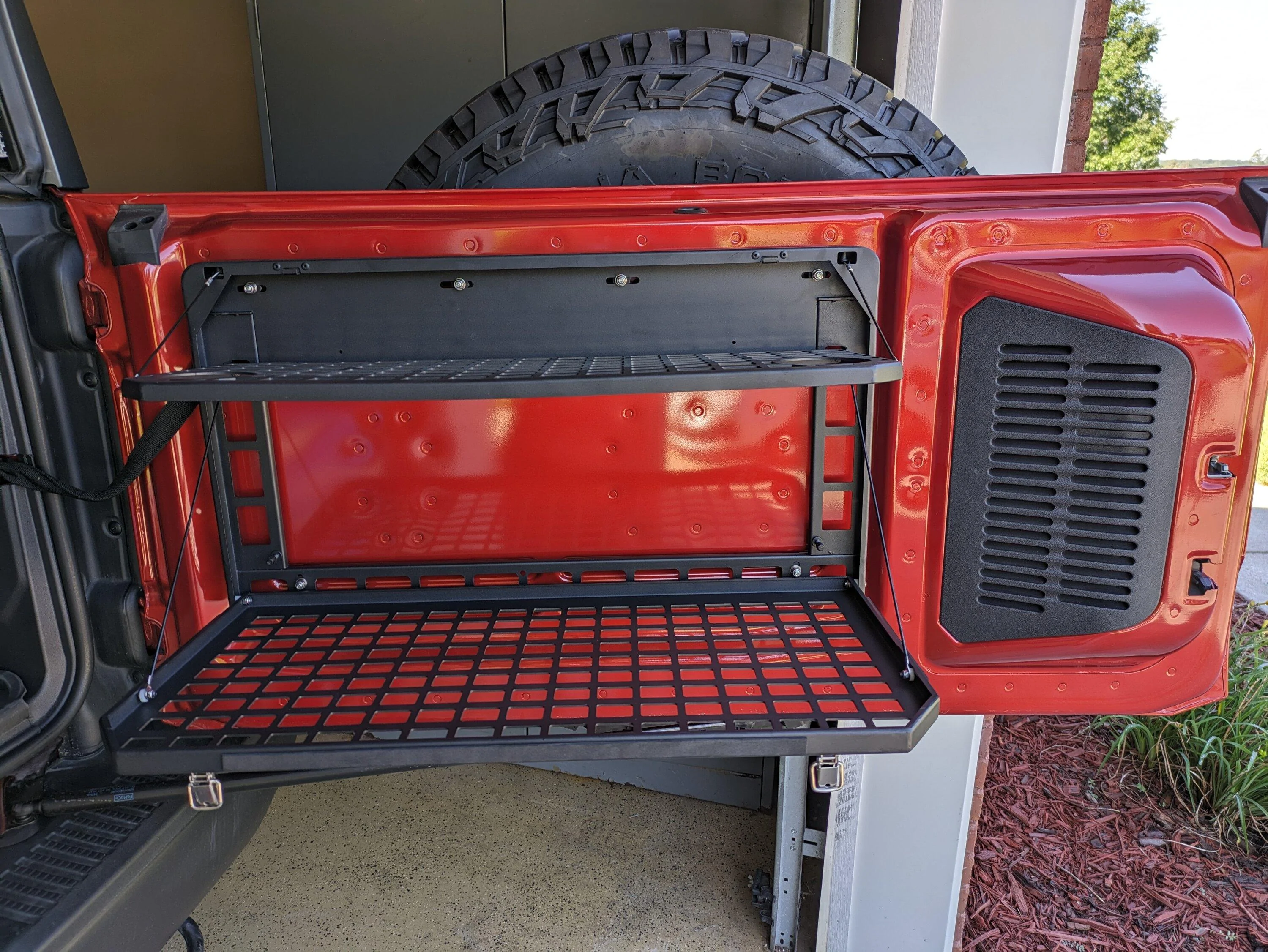

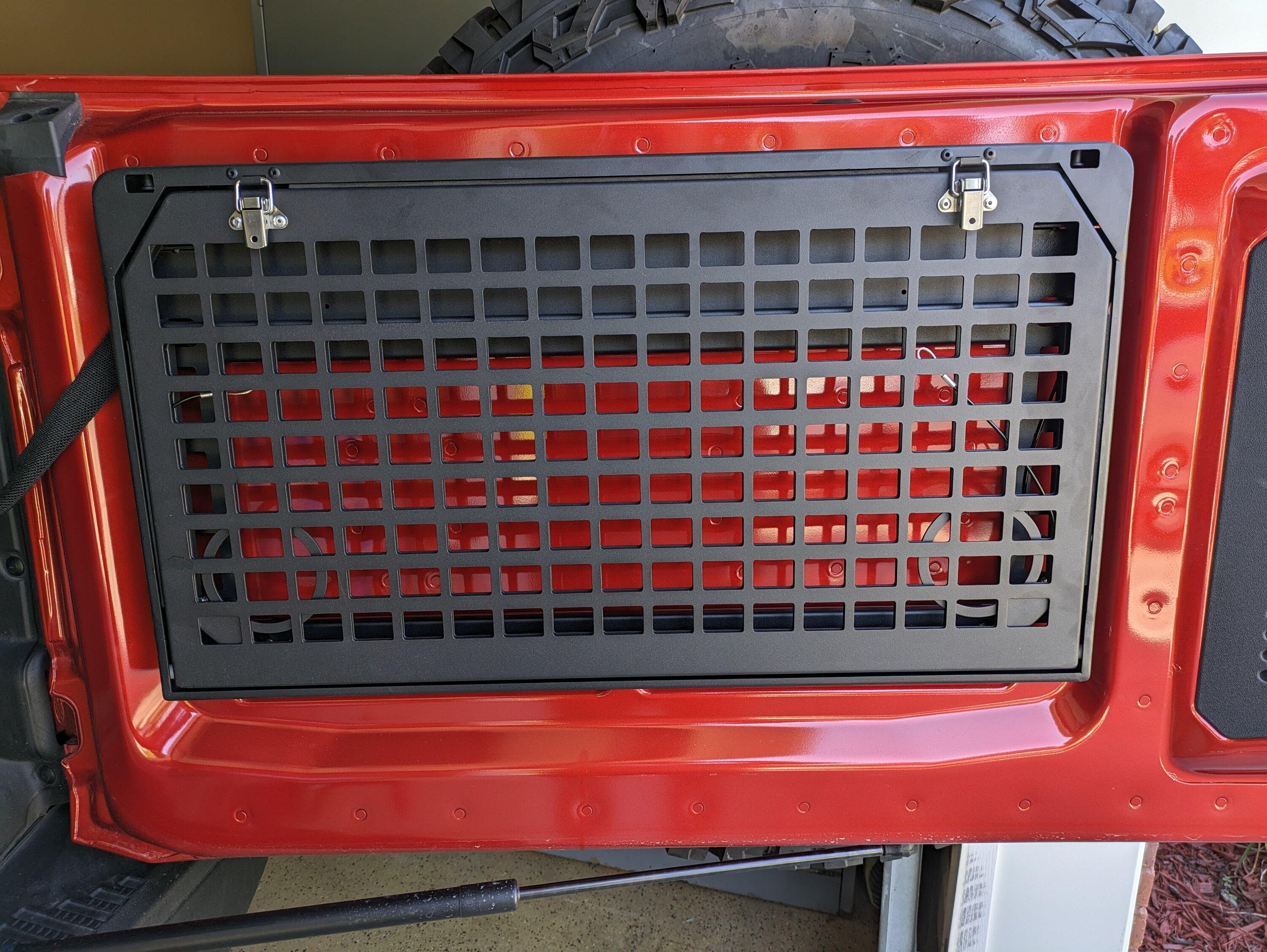

Maiker Tailgate table installed with Ford accessories molle bag kit.

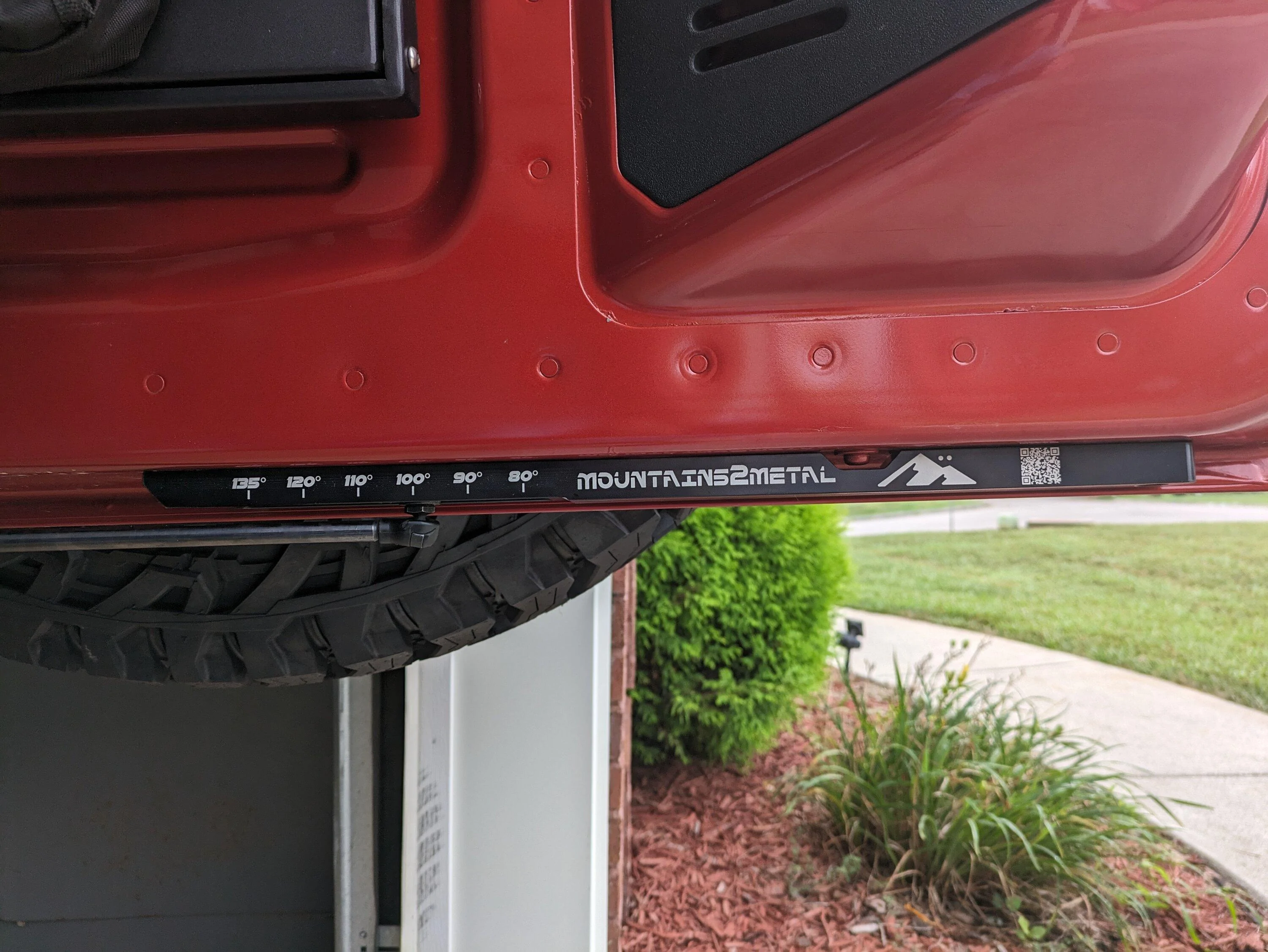

Installed tailgate limiter by @Mountains2Metal. Mostly protecting these expensive taillights specially if you open the door on a passenger side slope.
Do you need one of these to protect taillights in a stock configuration (factory wheel/tire)?

no still chassis mounted but the brackets are very stout.
I’m ”looking at the RCI” with a similar design that are frame mounted, but they’re $1200, which is why I haven’t purchased yet either.
Once I have those, think I’m about done until time for new tires.

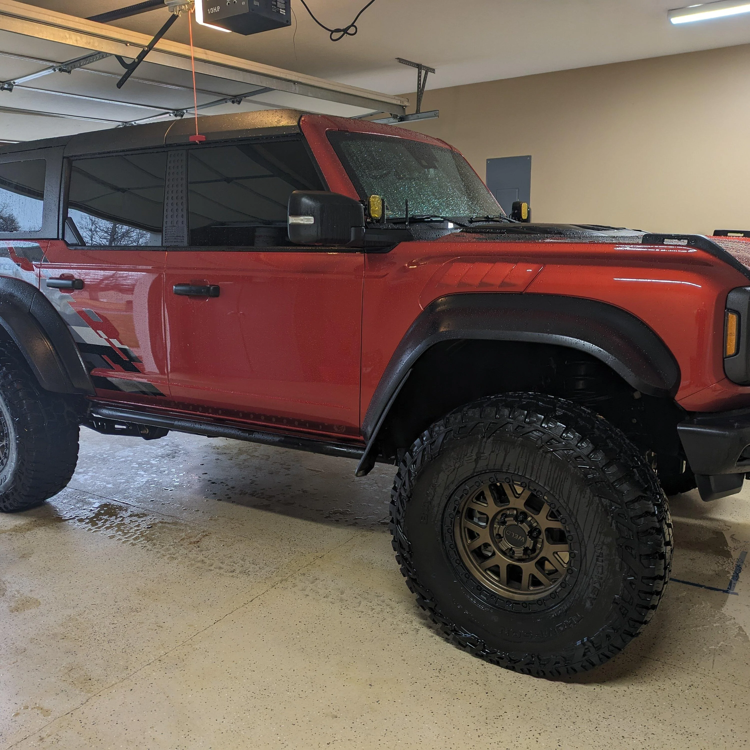

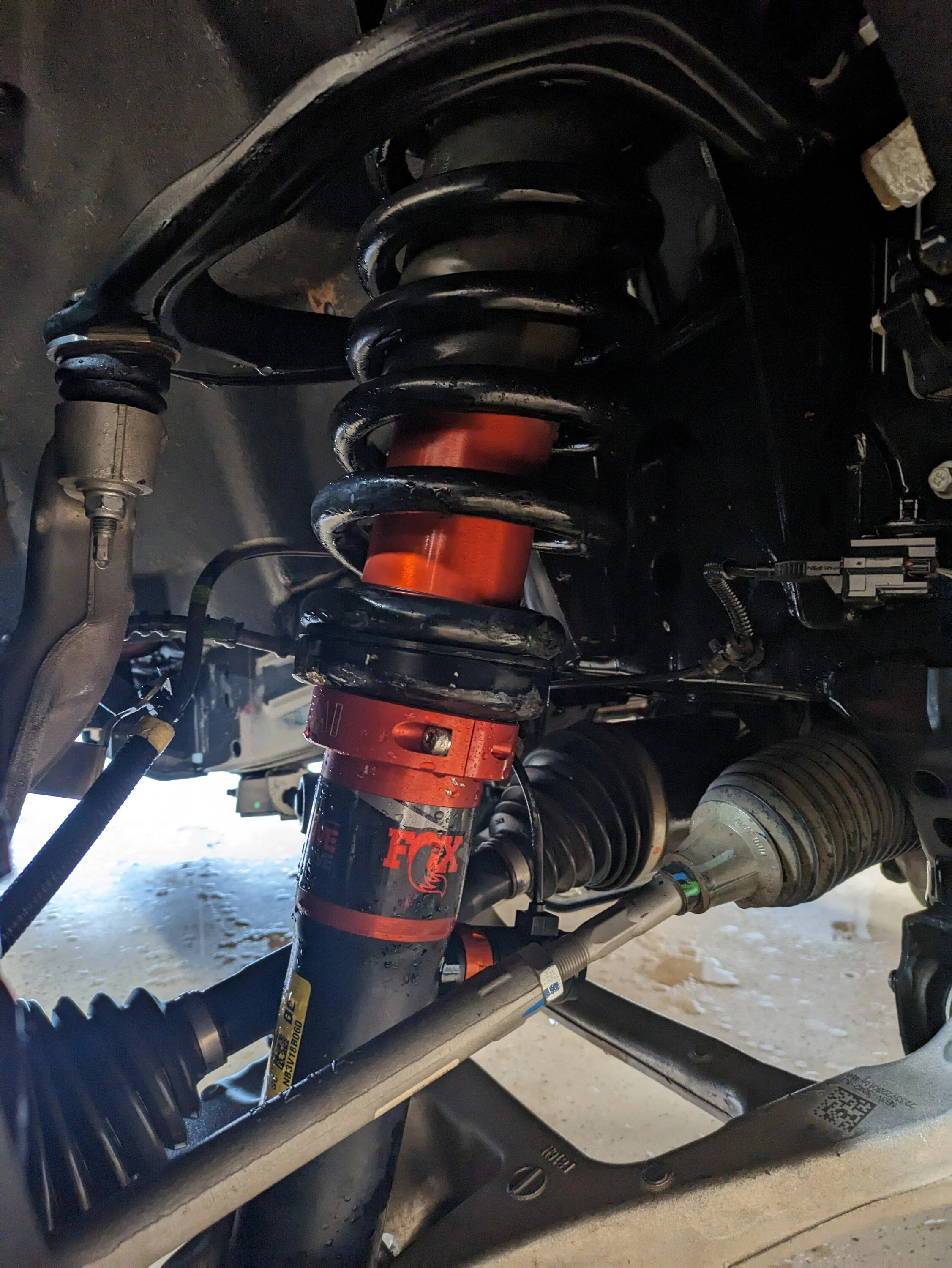

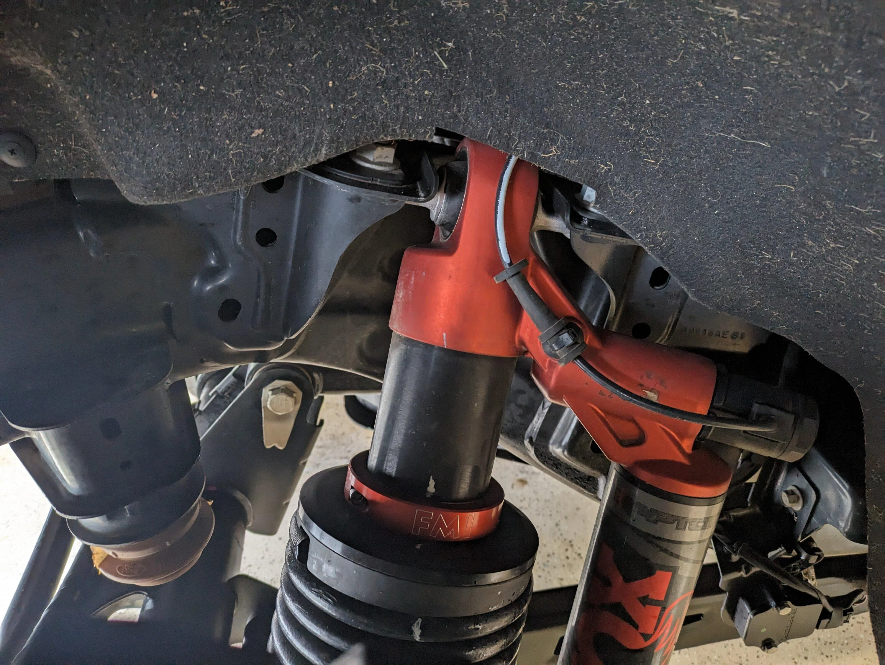

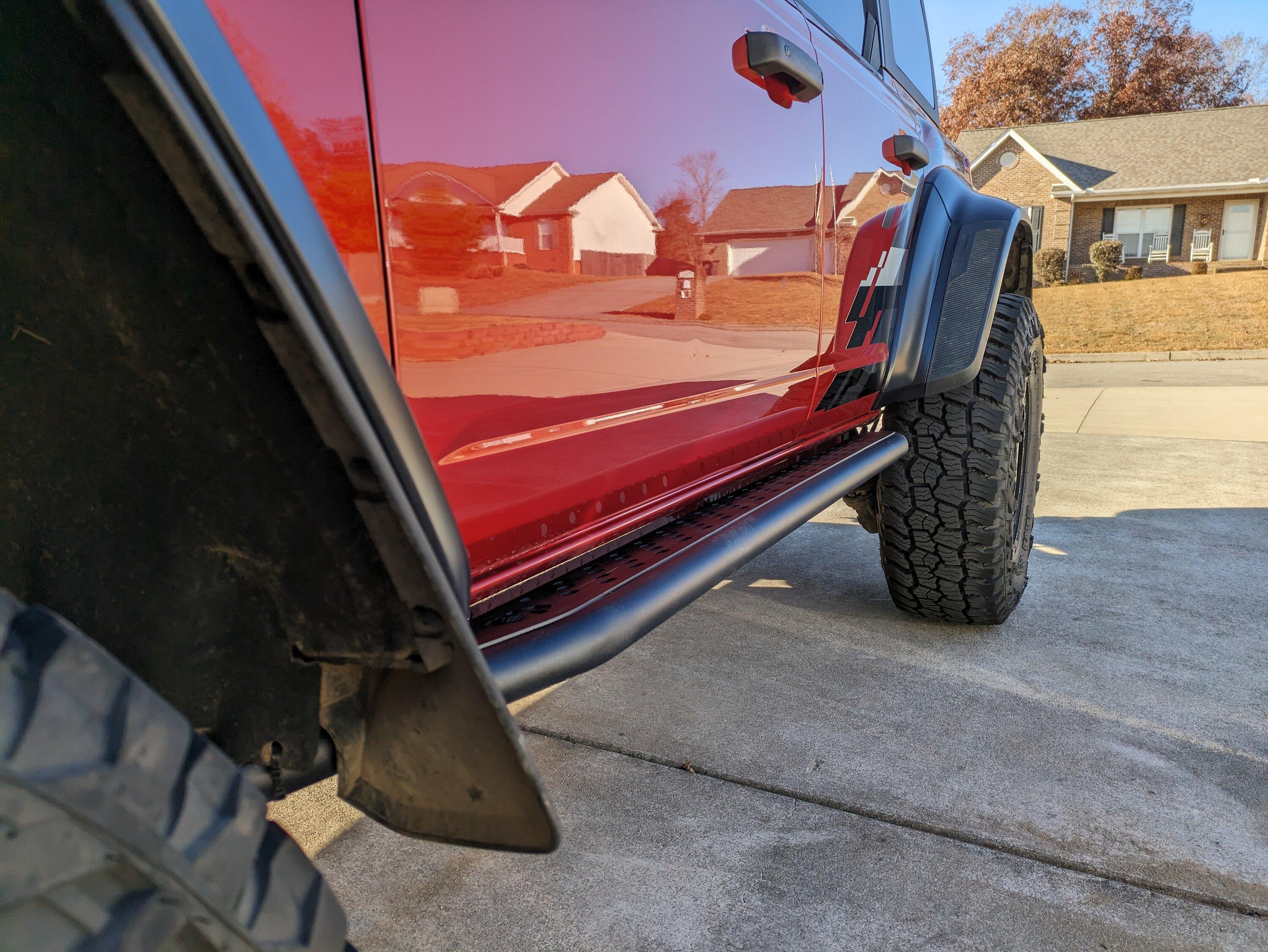

12.03.23
Added Foutz Motorsports (FMI) collars. Overall change is 3/4" rear lift and 2" front lift utilizing a 1" rear collar and 1.5" front collar soo effectively a small lift plus level change and removes the excessive front rake.

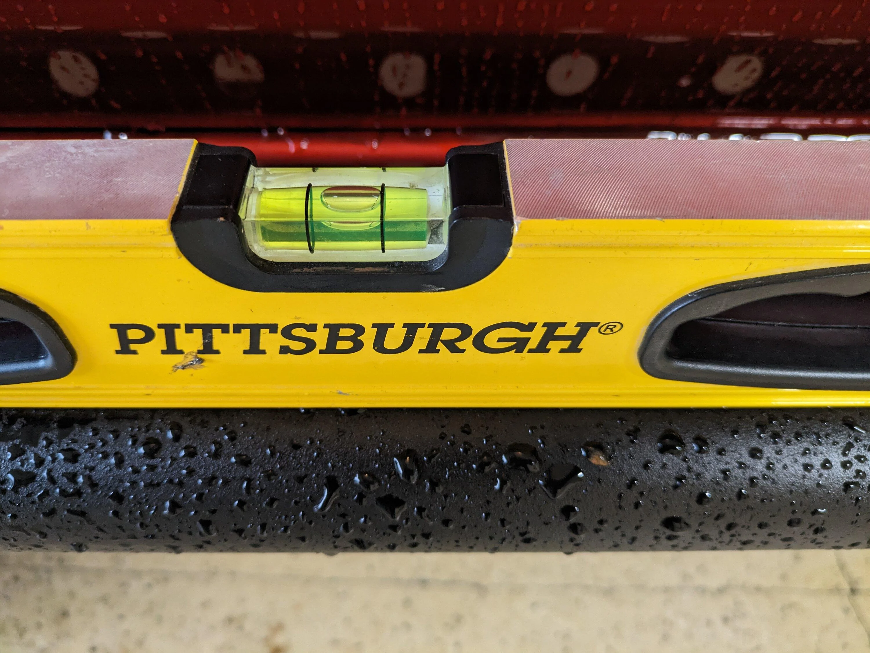

Look great. Do you happen to have the before and after shot of the bubble level?
vrtical
vrtical
Doug AI
49
7,613
15,468
GSMNP, TN
Fords
I don't but I did do measurements before all over the place, the most accurate was the bottom of the hitch to ground and top of front bumper. The front obliviously moved big time and wasn't expecting it that much but the math makes sense. With all the side pics I have you can see the flare gap change big time, went from 6.5 to about 8.5-8 5/8. Just started driving it today so I will recheck after some miles to make sure its all settled.

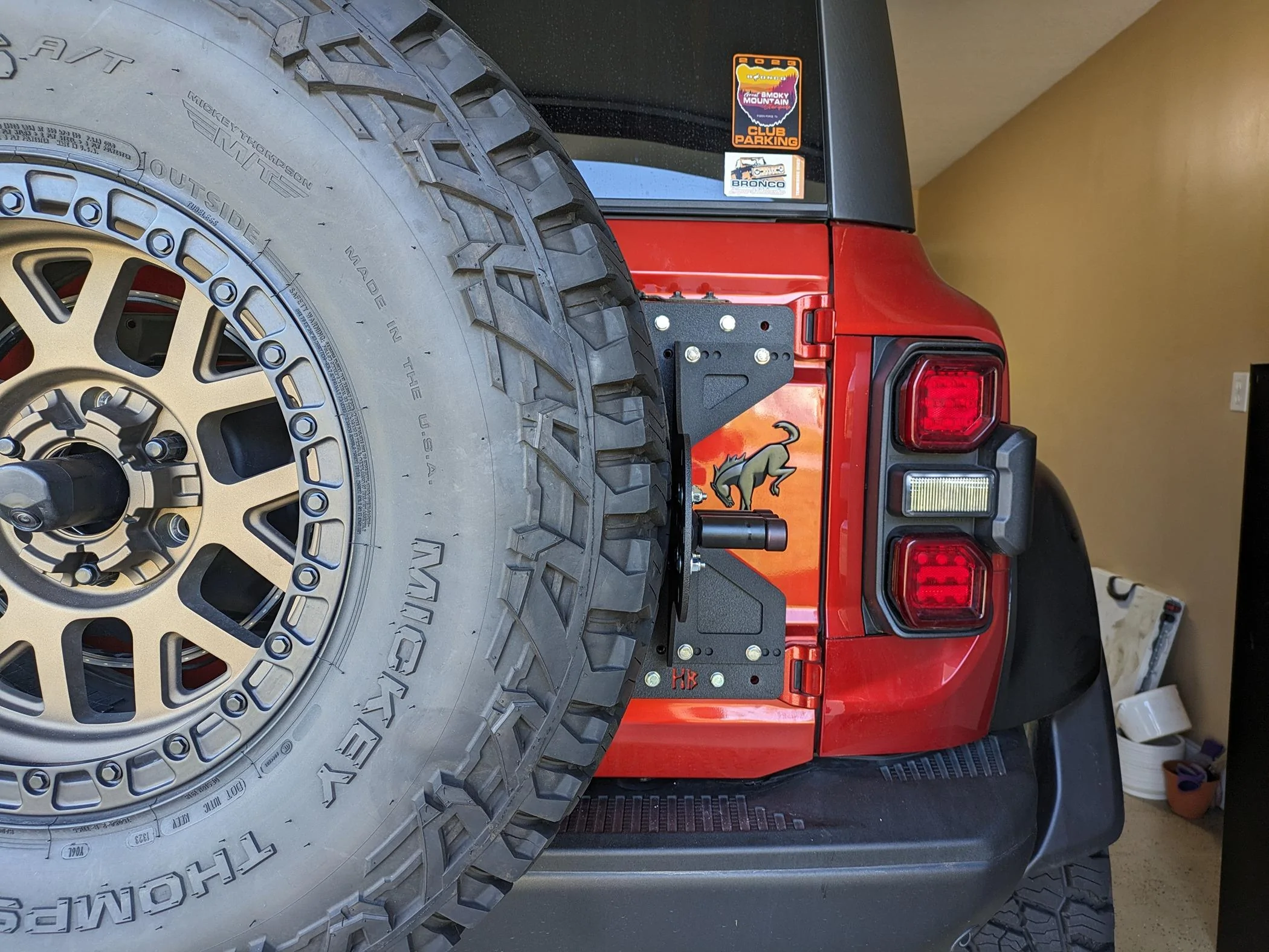

4/11/2024.
Installed new Hammer Built tailgate support and accessory's mount and added a Rotopax mount. Just clears with true 37s.
