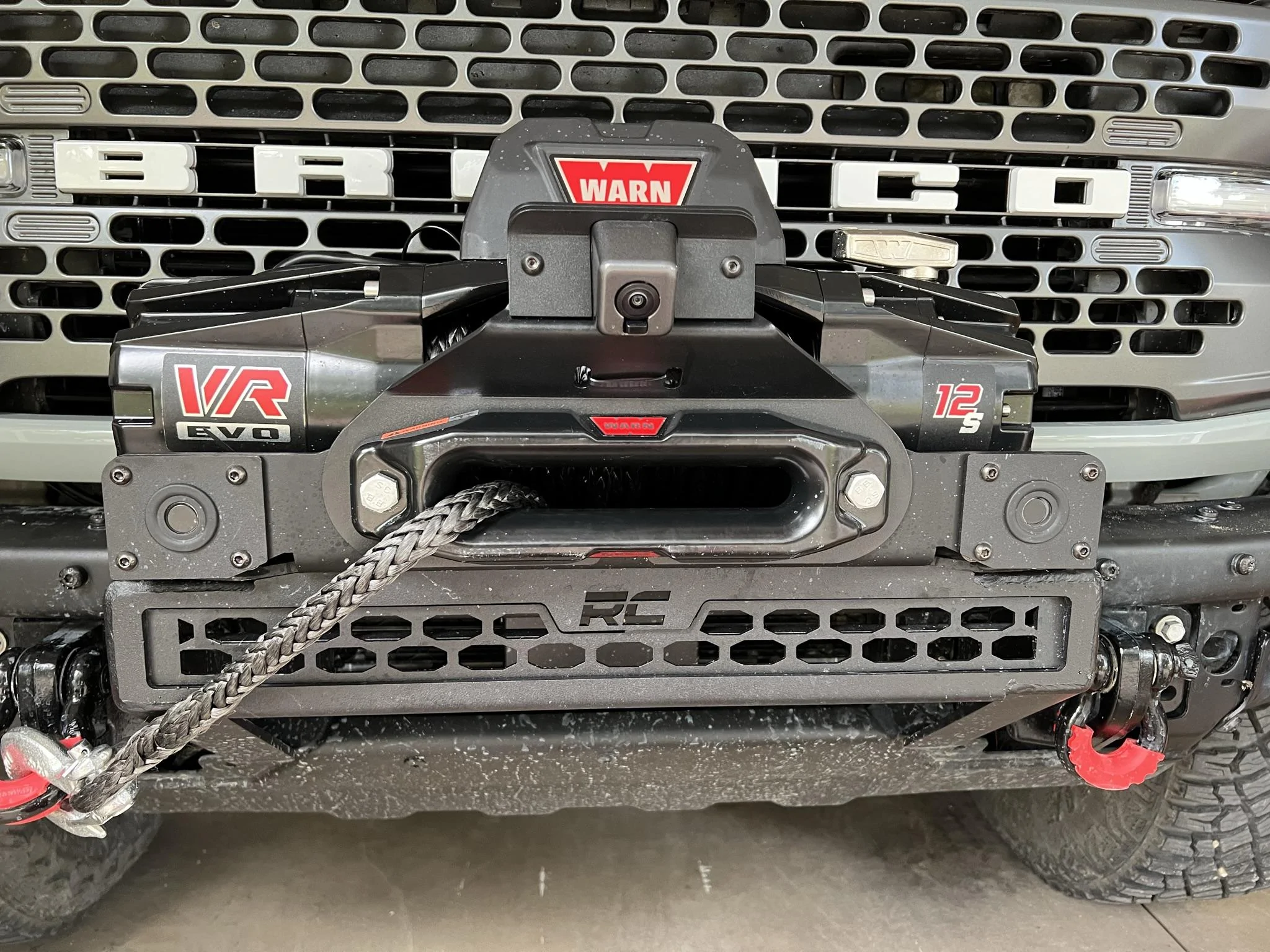

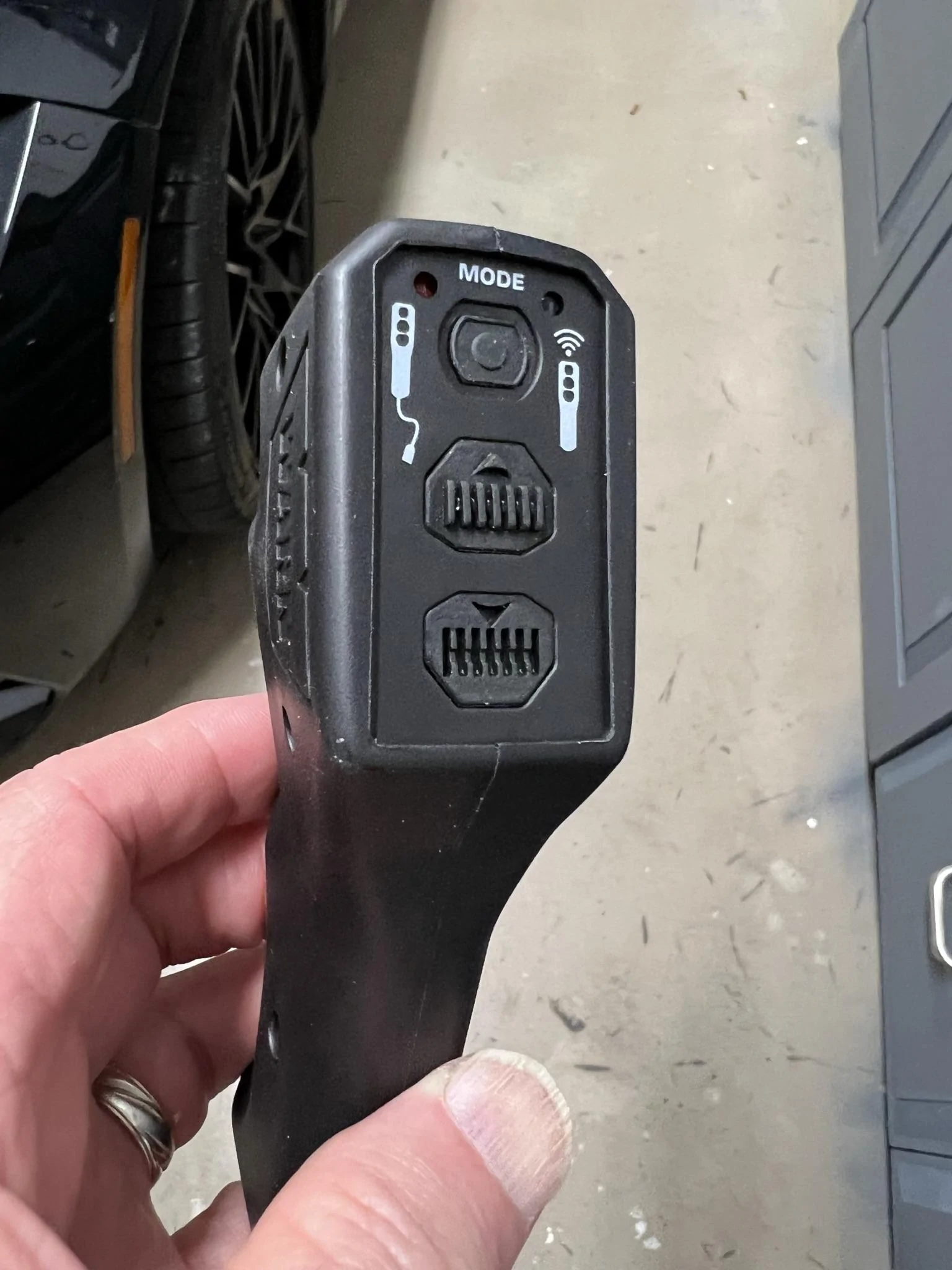

Recently installed the above brand new winch on the Rough Country mount. Winch is dead. After a bit of time with a multi meter, I have power at the winch, and at the end of the cord which plugs into the remote. The white indicator light, indicating wired operation, on remote will not come on at all and winch won’t work. When I disconnect the cord, then press and hold the start button for a few seconds, the blue (green?) light comes on. Yet when I press an in/out button the light flashes with no effect at winch. Have searched high and low for an answer w/o success.
Am I missing something or is remote defective? Any help would be appreciated.

I did. Called Warn and talked to a very knowledgeable tech. He said it sounded like a grounding issue. Sure enough it was. I had grounded the winch to the negative battery terminal. When I grounded it to the fender where the battery grounds to it worked like a charm.

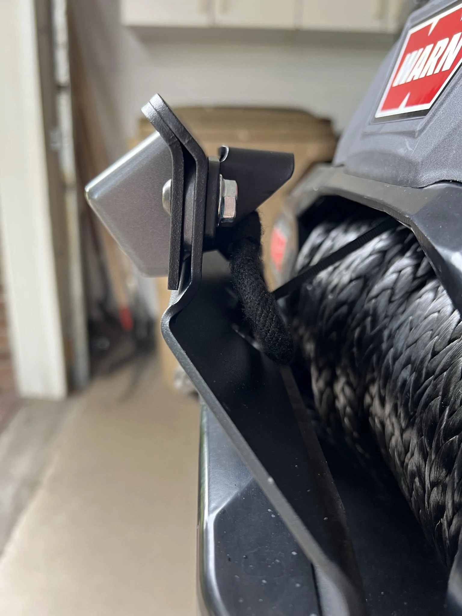

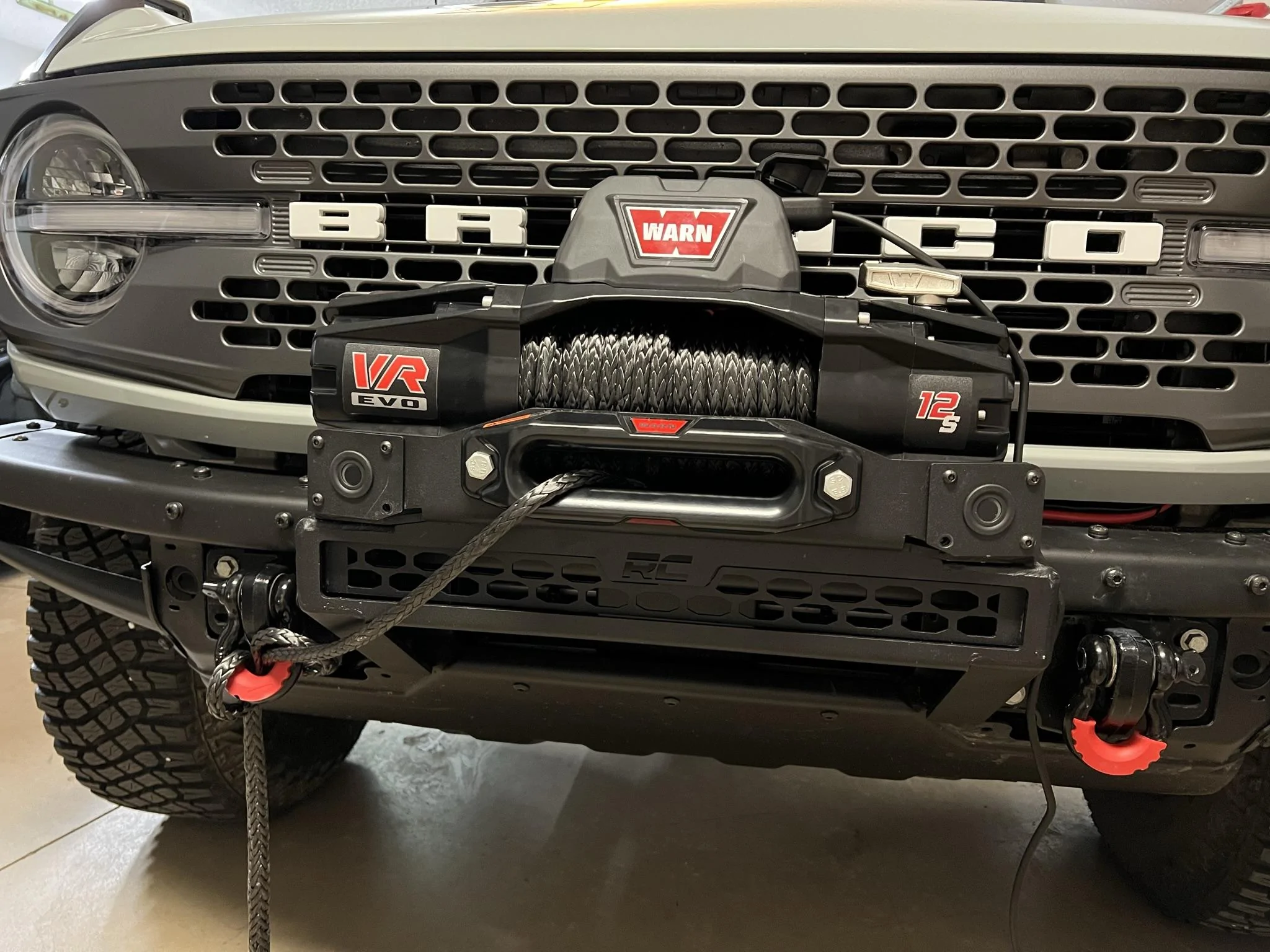

The 12s winch gave me fits mounting to the Rough Country plate. It's much larger in diameter than the one Rough Country used. Look closely at the pic below and you’ll see that I ended up cutting loose and straightening the area which holds the sensors. Even with that I had to notch both caps which hold relocated senors in place get the winch to fit. I look at this as a temporary measure until aftermarket bumper selections and price stabilize. The other issue I ran into was the factory sensor wiring harness was not long enough to stick through the bumper as per Rough Country instructions. All told, I stayed patient, completed the install and am happy with it. But as I said, at some point a new bumper will replace it.
One more thing, even though JCR say one doesn’t need to recalibrate the camera after relocation, don’t believe it if you want 100% functionality. It works fine looking ahead, but if you use it for precisely parallel parking or backing into tight spaces it has parallax issues. Not a deal breaker, but I hope the dealer can recalibrate.
