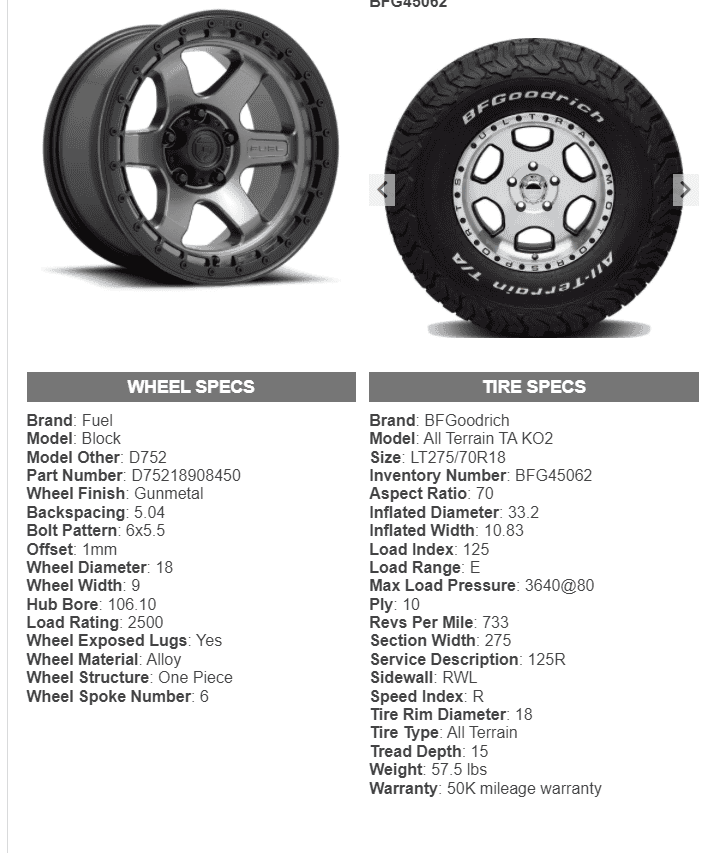

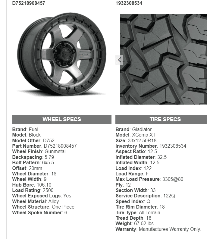

The wheels i intend to purchase are Fuel D752 block (18" x 9") +20 Offset, 6x139.7
The tires are: LT285/65R18 125R KO2s
Unfortunately i know nothing about offset so am worried they will poke way to much.

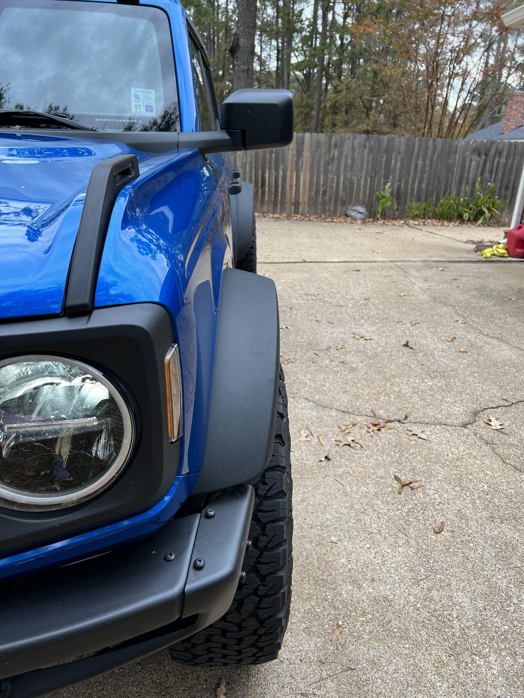

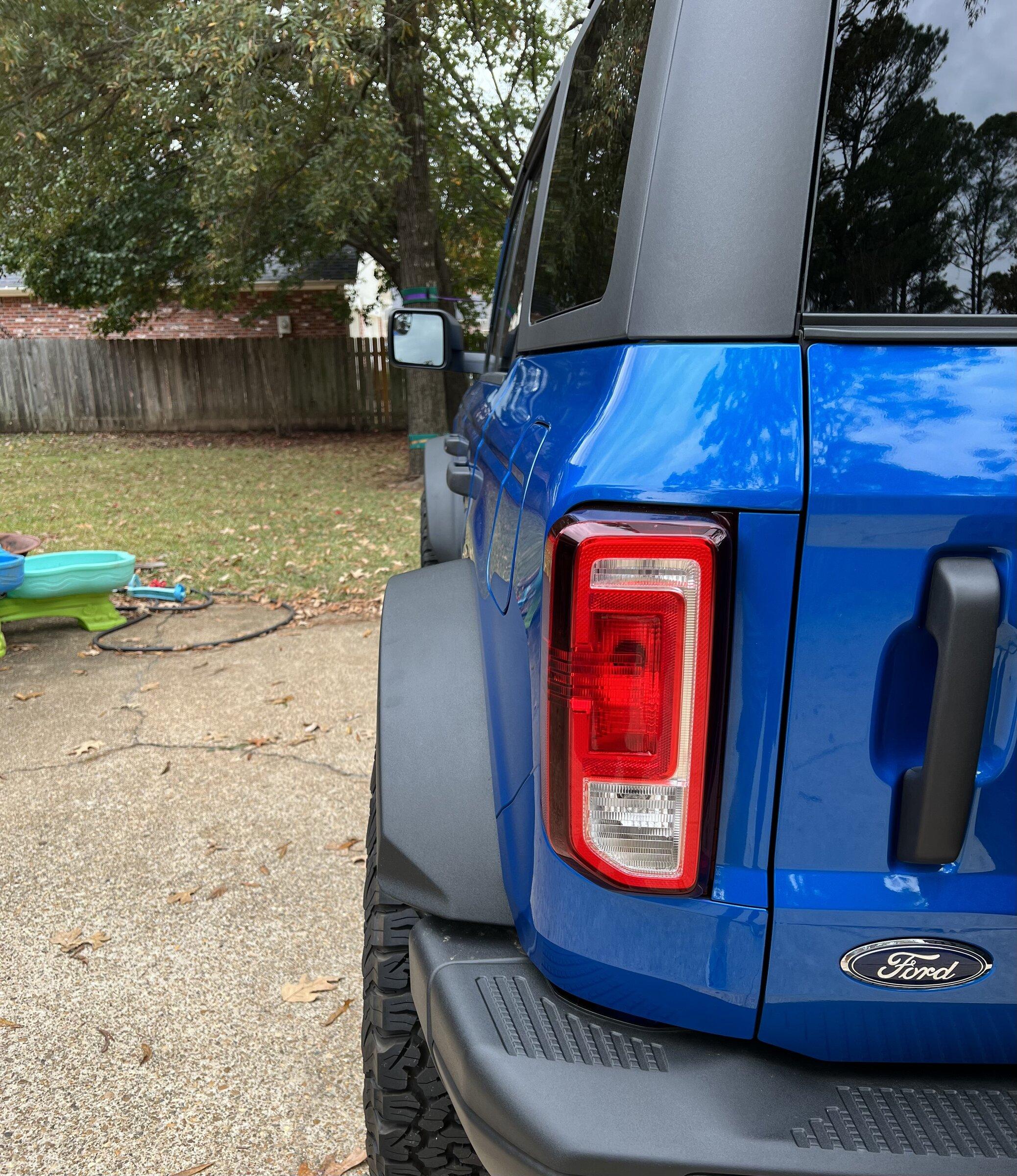

The stock wheels on a Badlands have a +55 offset, so your new ones will poke slightly more but it won’t look bad. Attached are my 0 offset wheels for reference. Just the right amount of poke for me, but that’s my preference. I have Sasquatch flares on mine too, so +20 would tuck inside these flares and be just outside of flush with your stock flares

For reference, more positive offsets will tuck the wheels in further and more negative offsets push the wheels out and give you the poke.

Stock BL wheels have a +55 offset. Assuming the wheel widths are the same, your new wheels would stick out the difference, 35mm which is about 1-3/8"

139.7mm is, of course, 5.5 in. which is the most common 6 lug pattern, what you have to watch for is the hub diameter and the offset...

thank you everyone! This is all super helpful! also for reference the hub is 106.1mm

If your going with these tires - LT285/65R18 125R KO2s - I would go with +0 offset.
What this guy said.
But if you are going with 315's or 12.5's those +20's will be just about perfect.
I have spent too much time thinking this through, and similar to you am planning on 12.5's (35 x 12.5) on a +25 Icon wheel with the non-sas flairs. To me, this is the sweet spot, but not super aggressive. I would call this "tasteful non-paint stripping poke". About a half inch of tread plus an inch of sidewall (give or take).

I have a SAS that is suppose to be built the week of Jan 3 and I'm going with -12 offset on 315s. I thought about going +0 and just trying to find regular flares as well. But after a good amount of time on FB/IG and the internet I think this is the look I'm going for.

Was able to narrow down to these 2 options, hoping im somewhere in the right direction.

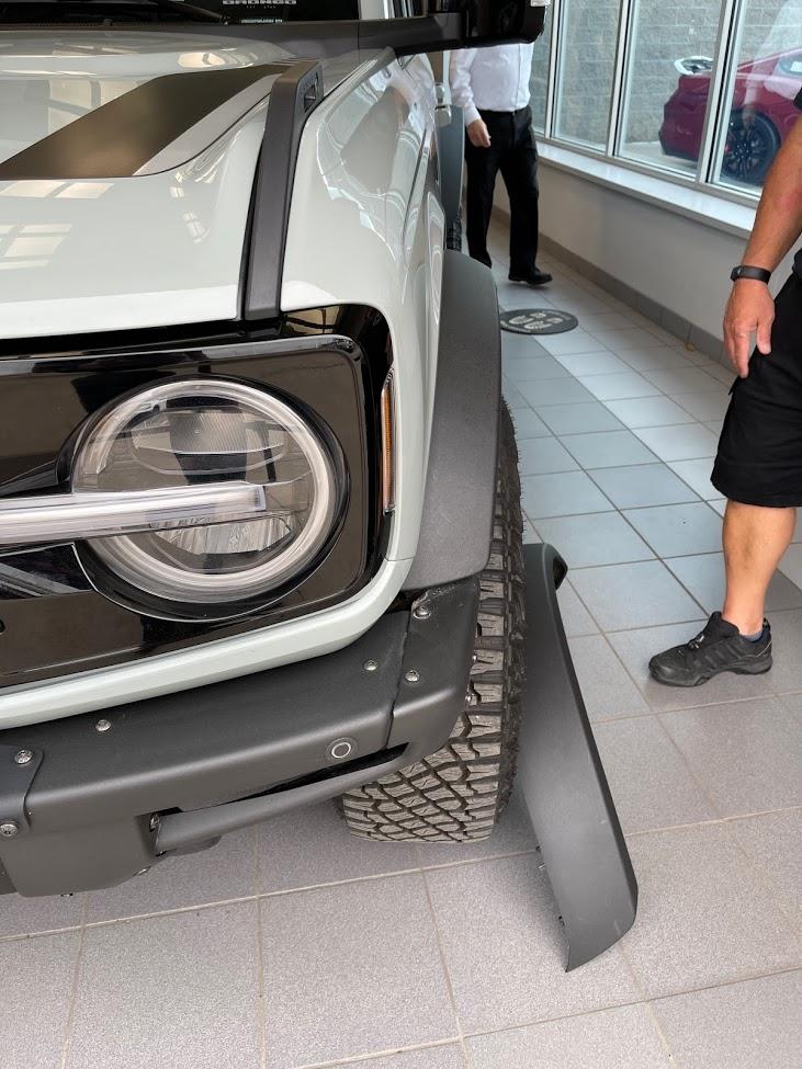

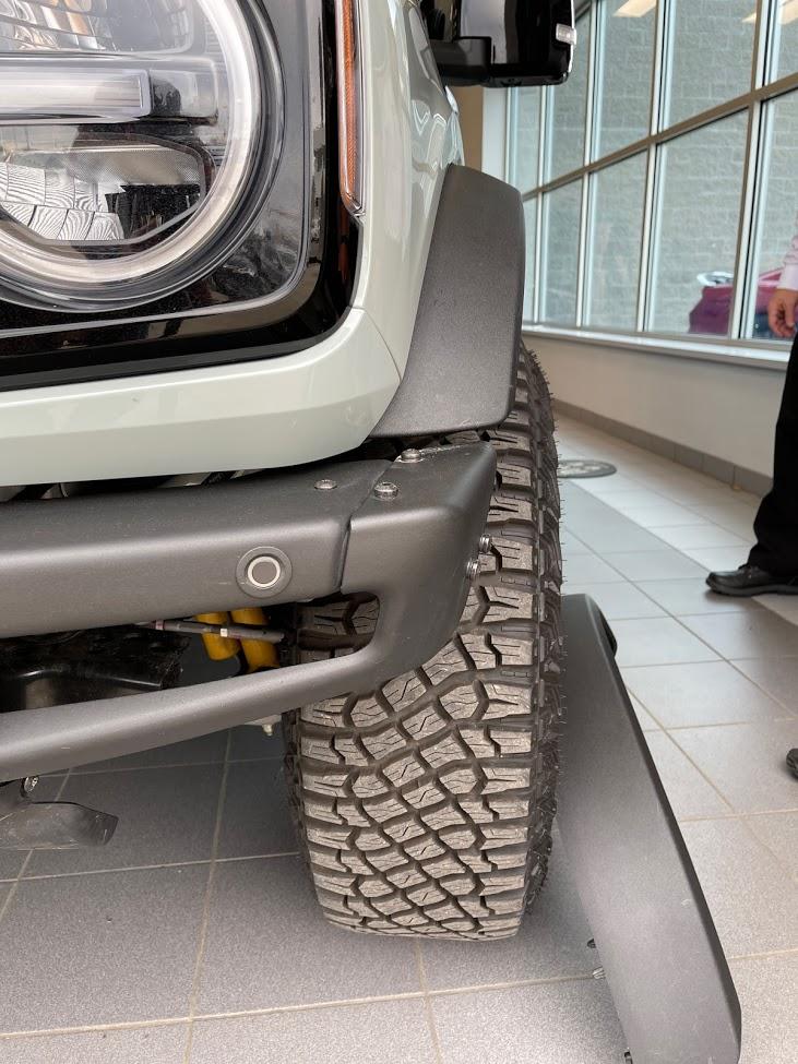

Sasquatch wheels with non Sasquatch fenders. I made a dealer do this for me and we my ideal setup until I saw all the damage done to paint and plastic from running a tire/wheel past the fenders.
