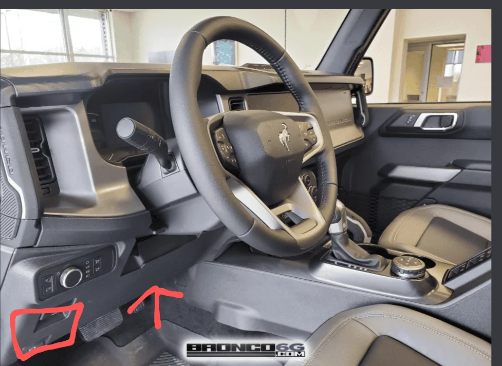

Maybe I'm retarded but I cannot find it for the life of me. Can someone please post a picture of this "kick panel" that is supposed to come off? I don't see anything under the steering wheel like that.

Behind this red box is the fuse panel. Start from right under the steering wheel and pull out this panel (it's one piece). The kick panel is on a hinge so it kind of flips down so to speak.

Holy shit! You are my hero!! Thank you!!!

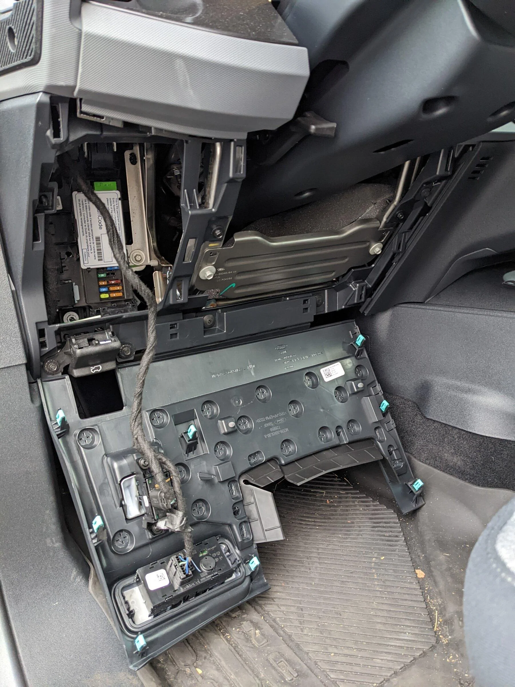

Here's a picture with it opened. It feels like you're tearing apart the dash but the visibility is great once it's folded down. This would be a real head scratcher if you were out of cell phone range and you had to rely on the owner's manual :LOL:

Thought I was loosing my mind! It is not where they say it is! 🤣🤬 Thank you!!
