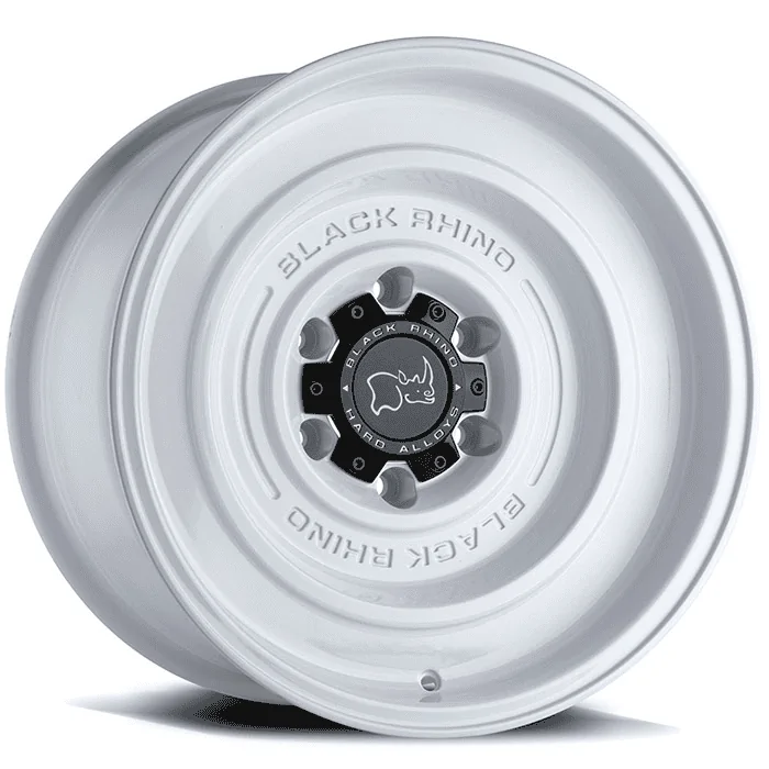

But Black Rhino has the Solid wheel.
Ford Bronco White Wheels???? 1632585118048
https://www.blackrhinowheels.com/off-road-wheels-rims-solid.php
I like these for a lot of reasons. They are totally retro looking. The lack of vents/spokes might help with the white color vs. brake dust. And they come in the right sizes. 17", right bolt pattern and 9.5" wide. That width will accommodate the 35" Baja Pro XS (I know, I'm an idiot).
But the problem? They have -12mm offset. That means that these will be 42mm further out than the non sas wheel. 21mm further out than the stock sas wheels. That's 0.827". A little extra poke. Maybe with bigger tires, you need a little more. I'm not sure, but I hear a lot of people on this site complaining that they don't want the zero offset because it is too much poke.
Oh, yeah. And these are not really available either. They don't have the long story that Fifteen52 has with the shipping. They just say expected in a rolling 3 weeks.
So that's what I have found so far. Nothing. I'm waiting. If both of these were available, I would probably go with the Black Rhinos for the bigger width. I am realizing that white is not in right now, and that combined with the supply chain shit show means we wait.

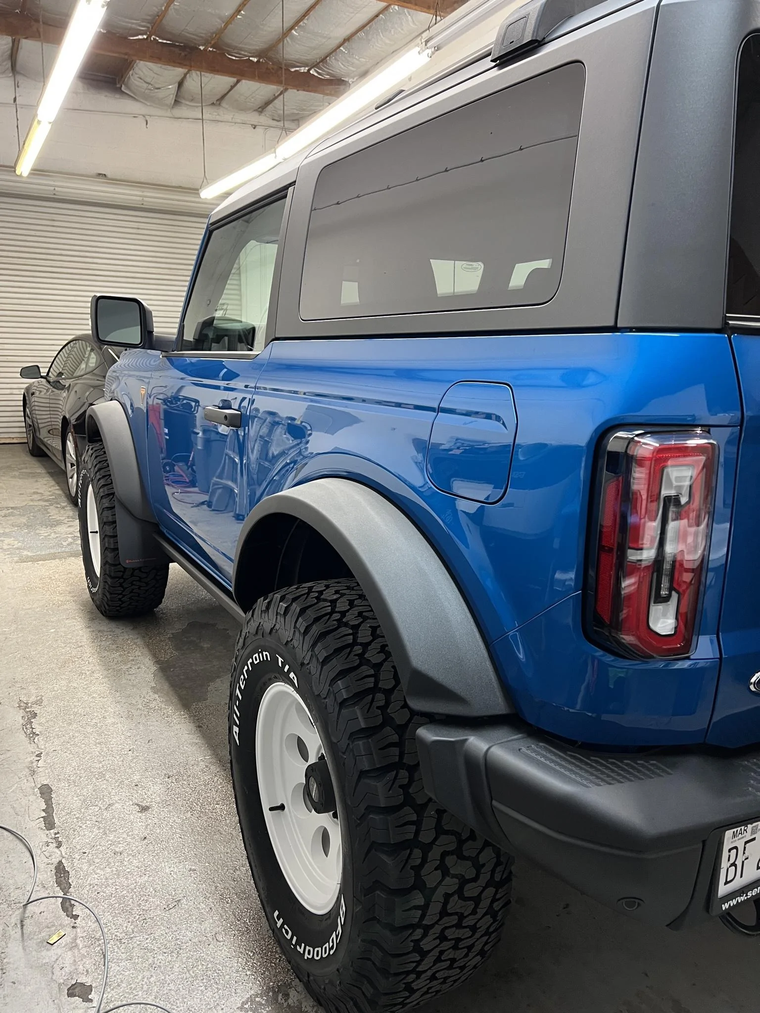

These look good. Any pics from better angle? Details on the wheels?
Ya sorry, here’s a better photo. Will be taking some photos after Christmas in Tahoe and will post to my build thread but if you want to know any details they are in my rig journal.
Ford Bronco White Wheels???? C0A1E297-FC24-4A6C-BB83-4C89842AFAC7

they look great! minimal poke it seems correct?

The tread is covered by the sas flares but the width of the side wall goes past so appears to have poke
