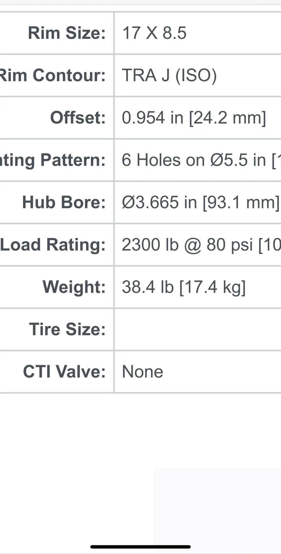

I see this wheel offset as being 5mm different than stock, they will stick out only 5mm more, stock wheels are 30mm correct?

Correct as far as I can tell.
Next is to put the bare wheel on the vehicle to make sure it clears the calipers etc etc.

Probably not going to get the chance if I go with these. I am being offered to buy some first/porotype wheels from a respected wheel maker. I trust them that they would make it right if they don't fit. Just double checking as I get confused constantly with positive/negative offset.
I like they are hub centric

I think the hub bore on the Bronco is the same size as these wheels.... the only thing is they seem a little heavy dont you think?
They have a special feature that I can't share yet.

I went on the assumption the offset was positive as there was not a minus sign.
You should probably verify that just to be safe.

38lbs/ea? I hope that they are real beadlocks. However with a 2300lb weight rating and weighing 38lbs I seriously question the quality of the manufacturing.

As mentioned, this aftermarket wheel will sit 5mm (~1/4") further out over the factory wheel and they look to be hub centric as well (93.1mm hub bore) .
