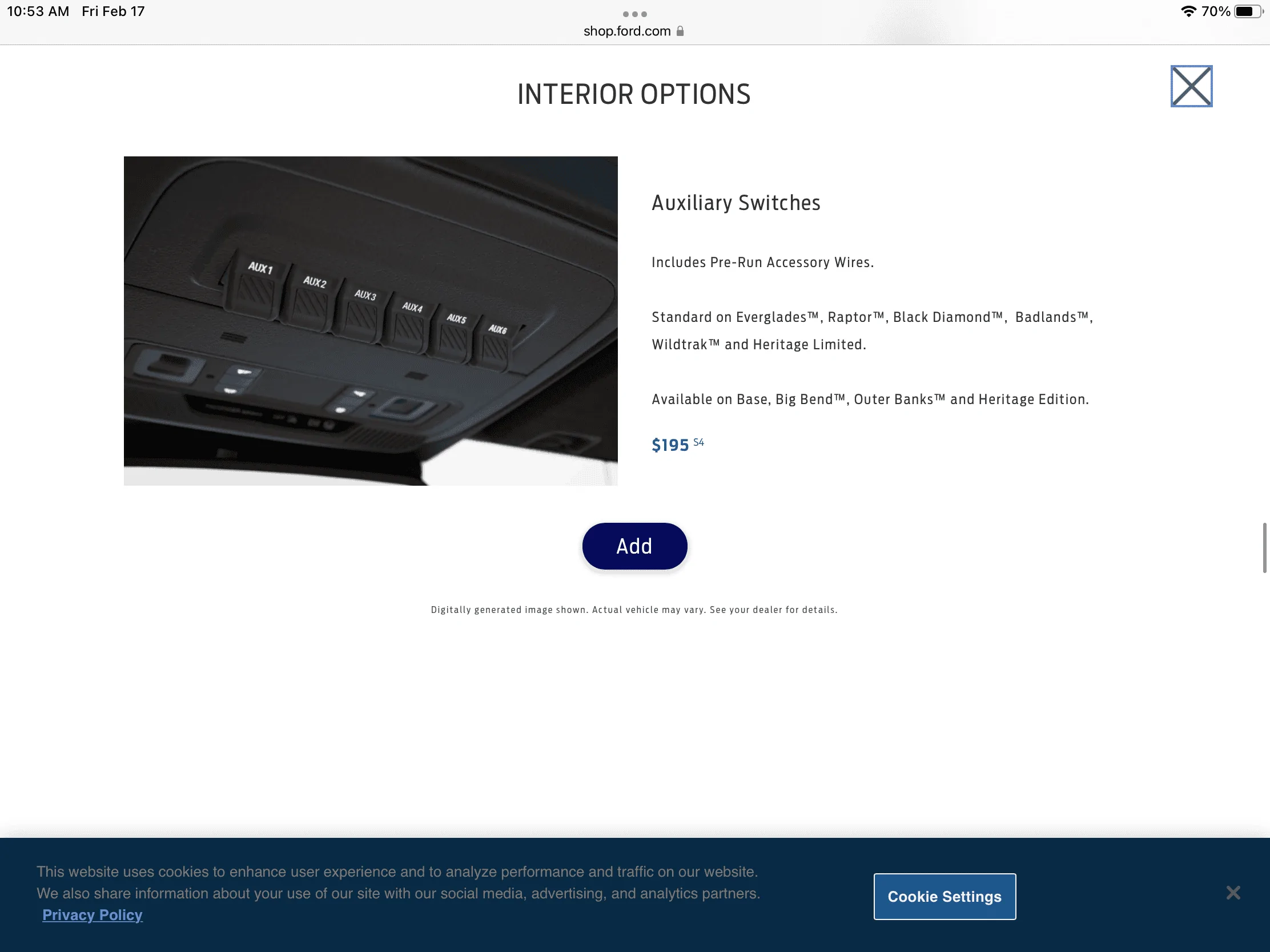

Does that include the fuse box replacement and the harness that attaches to the upfitter and runs down the pillar to the fuse box? Probably not....
$195 is the cost of including upfitter switches in your build, certainly more exspensive to retrofit.

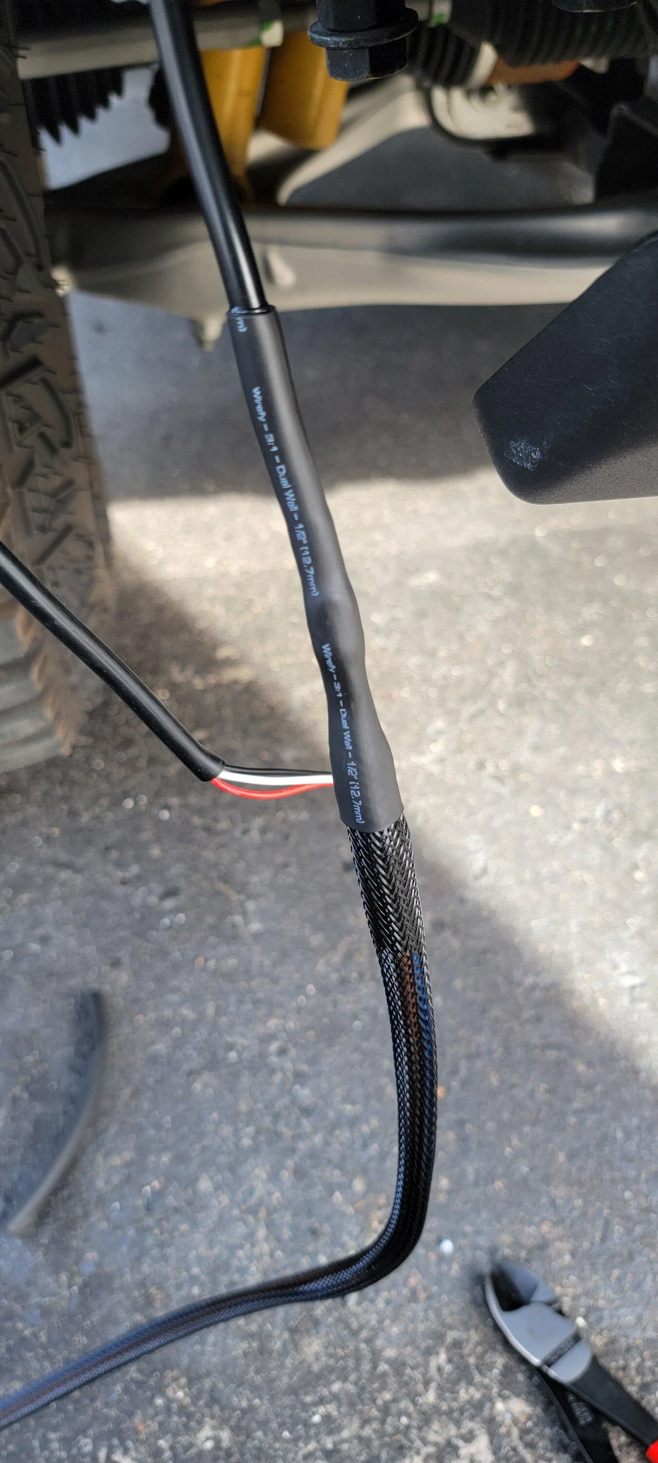

Yeah true , I did think of doing that but considering where they were running , not visible. I said eh , good enough as long as it's sealed.
Not only do the look cleaner that way if the ever chafe its harder to short circut
Yep, but as he pointed out “he can control his switches via Bluetooth”. Guess it’s difficult to activate switches while sitting in the driver’s seat. Comes in handy I suppose at the mall. 🤷‍♂️

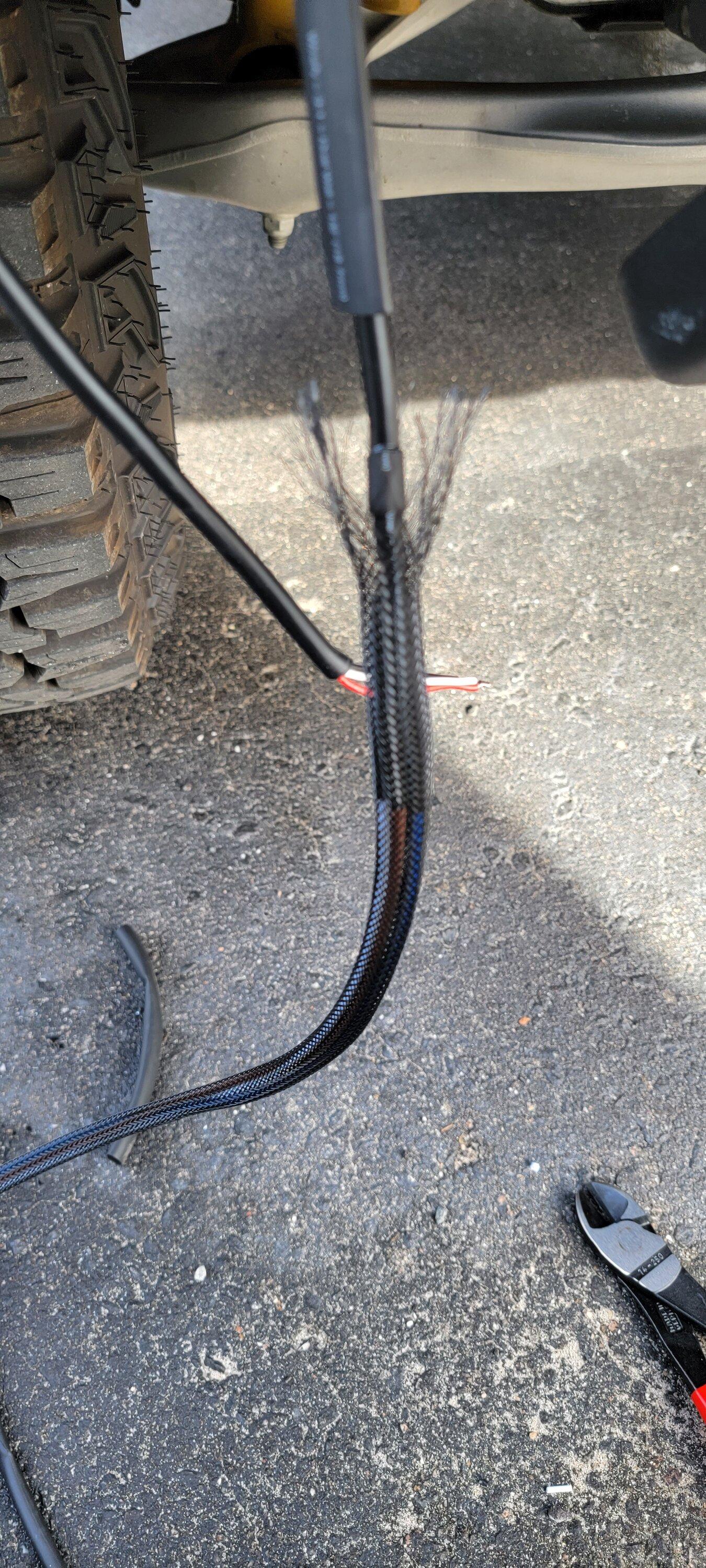

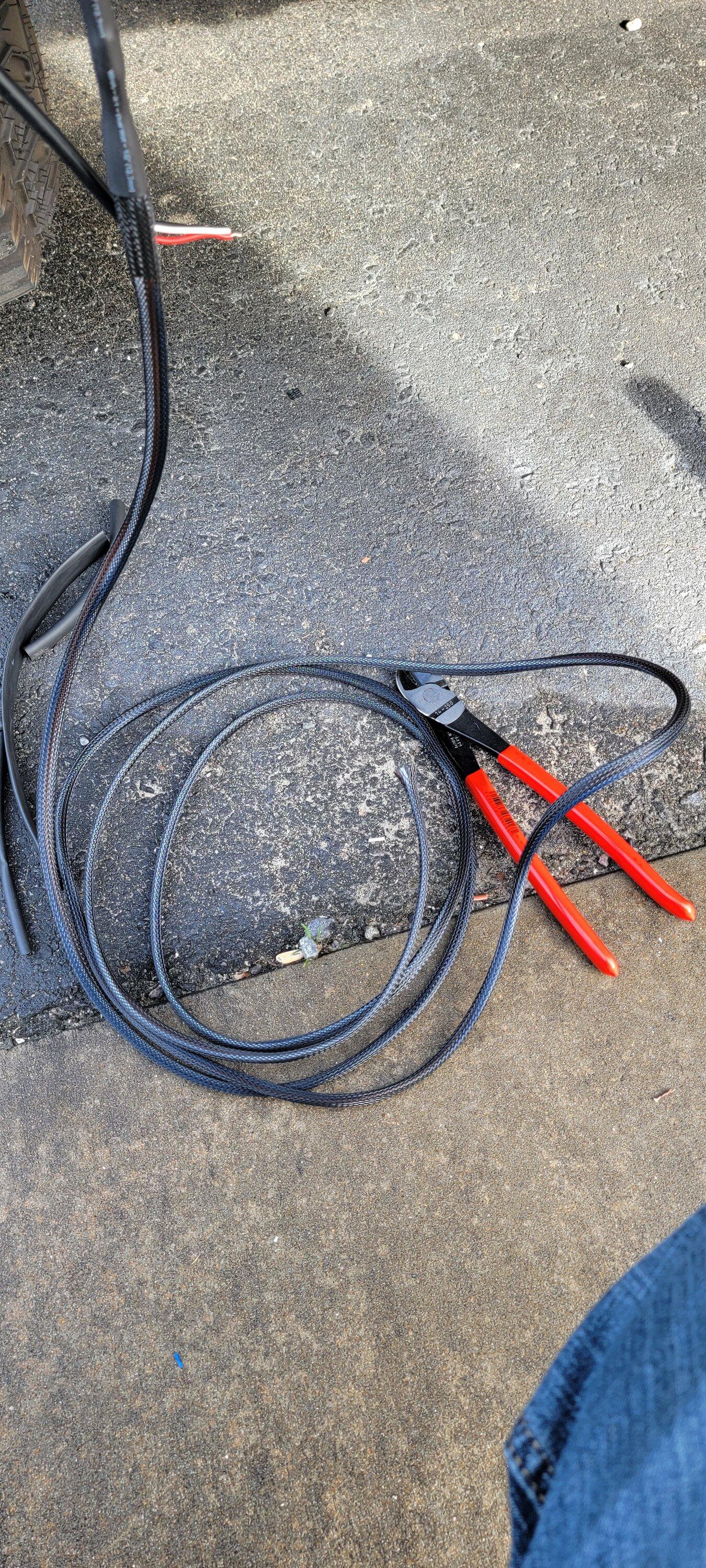

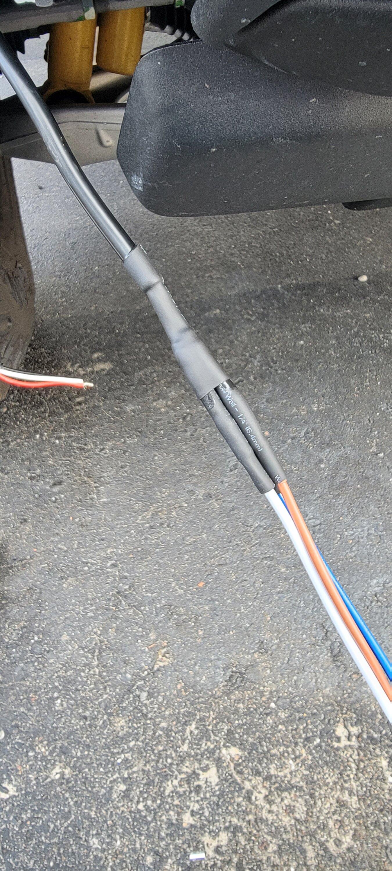

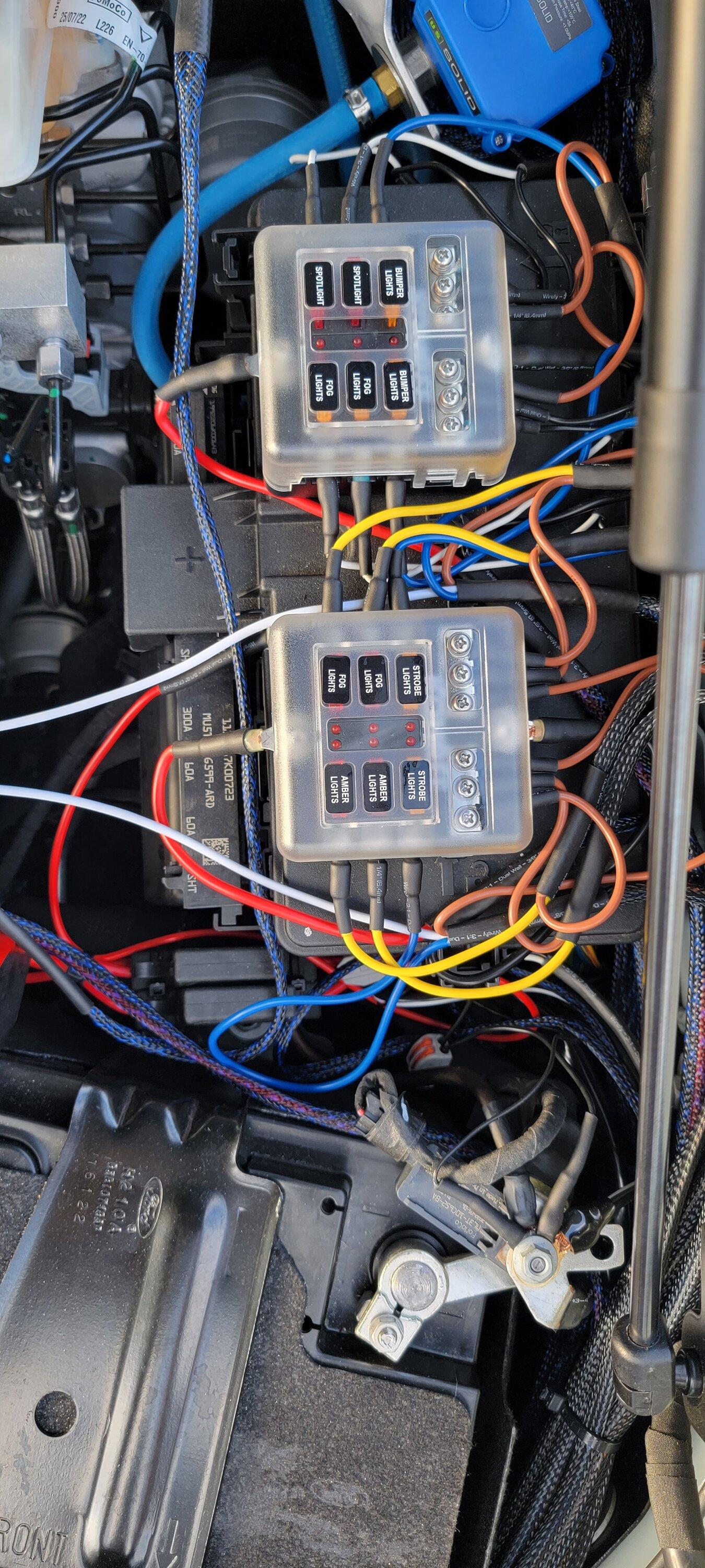

Besides paragraphs- there is a lot to improve here.
I would go watch some YouTube on wiring. Look at Chad Fab, or search race car wiring.
I watched a few videos , yeah that dude is good but he is also ripping apart the entire firewall , using printed circuit boards , very class A specific custom builds. While yeah I could afford to do that , not willing to go that far. Not on a new car. I could see that though on classic rebuilds. Good stuff. Thanks

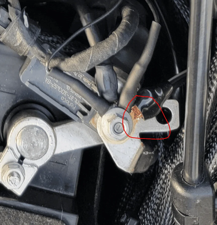

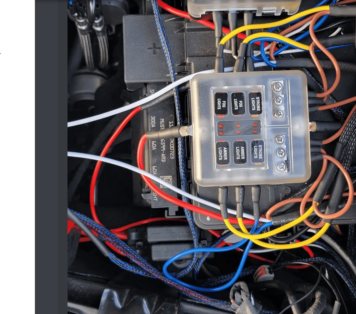

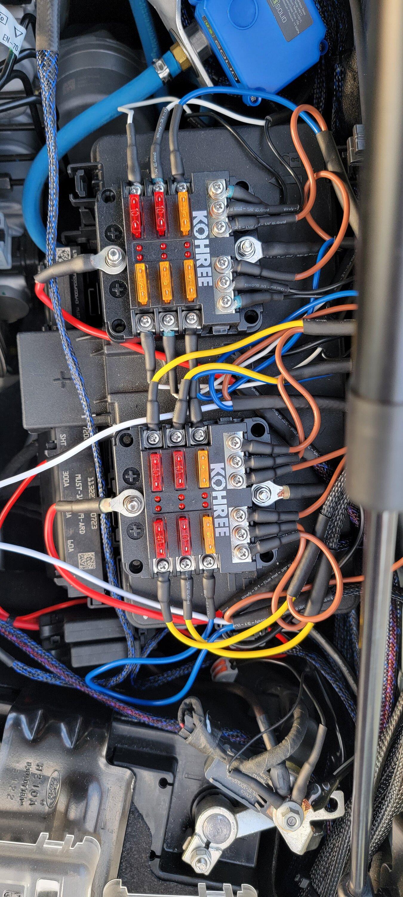

Not saying what you did was "wrong" or you have to do it the race car way, but you left a lot of room for improvement and since you were writing about how you did things, I felt that you might use some feedback for the future.

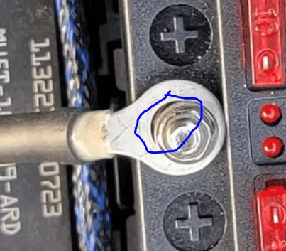

It looks like your ring terminal diameter is not correct size for your fuse block terminal. There should be no visible space around the stud. It should be a tighter fit. (circled in blue)

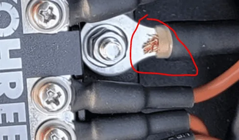

No compromises on wire color, no soldering of connectors. This is a rats nest that should be cleaned up. Wires should not be wrapped around others, wire lengths should be appropriate to their terminal location, your ground on your battery connection is not proper (circled in red). When you have exposed terminals/wire it should be tinned. Your copper sticking out of your ground terminal invites corrosion.

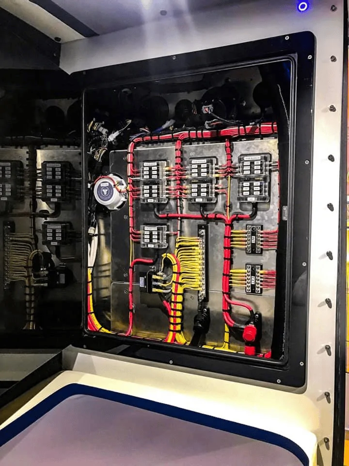

I have been involved with vehicle wiring with fleets of up to 3000 vehicles.. we don't do it the race car way, nor are we always as neat as the boat below. But we do make things close to that.
Below is an example of "non" race car start wiring that is something to aspire to.. Its from a boat.
Ford Bronco Wiring and how I do it. 1676665097460
Ford Bronco Wiring and how I do it. 1676664577090
Ford Bronco Wiring and how I do it. 1676664441627
Ford Bronco Wiring and how I do it. 1676664309530
Ford Bronco Wiring and how I do it. 1676665236689

This is definitely neat for sure.

Its funny too how I used to think soldered connections were the best, but they shy away from them in aircraft because the soldered connection is stiff and vibration can cause it to fail.
Sometimes the crappy looking crimp is king.

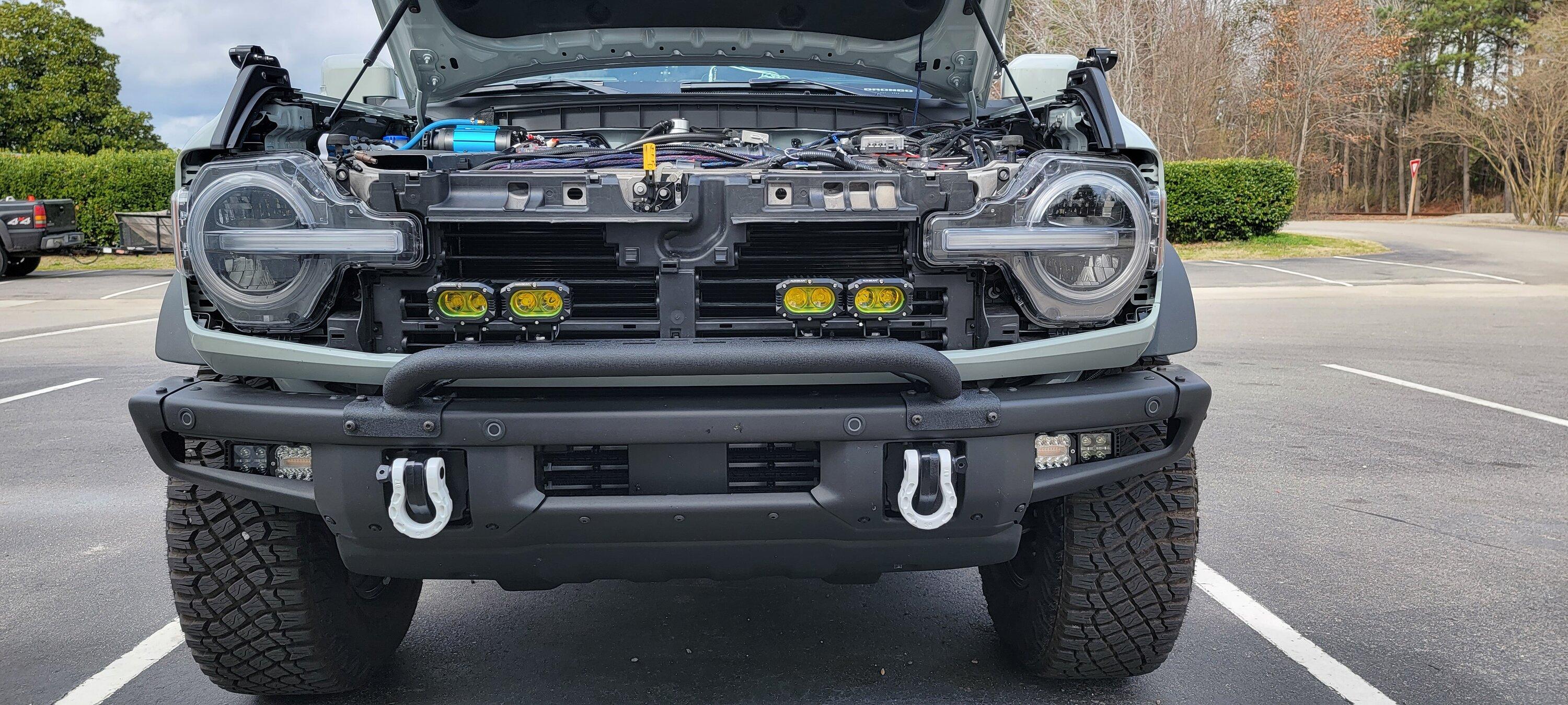

Not to mention , you lose 2 switches and 10 amps , and I can control my switches via Bluetooth.
Upfitter switches are the tits.
I just ran my Baja Squadron Pods, then a Baja Designs Fog Array of Squadrons and S2s to my upfitter switches and it was so much easier.
Snaking wires sucks and I think my runs are fine; time will tell, but everything works and other than the pain of running the wires, crimping was the only headache, but it’s doable for a novice which I certainly am.
Tucking all of the extra wire was interesting, but zip ties and good folds should hold well. I’ll check everything in 30 days to ensure I’m not falling apart or melting.
If your wiring works for you and it’s safe, then great, but the wiring harness from 4x4TruckLEDs.com was a lifesaver as were the upfitter switches. The harness comes with heat shrinks attaches and the runs Are lettered for the fogs as A, B, C which also helped a ton.
Think most member of the forum who don’t do this often would want an easier task for a DIY on lights. The gauge of the wire is good and they also included sleeves for the entire run of the harness and the perfect fit connectors for Baja and Dioid Dynamics, so you can use either one.
