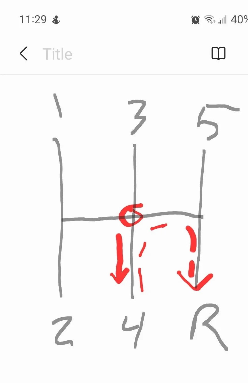

Pardon my shitty artwork, all my previous 5MTs have had an issue where at a dead stop they didnt like going into reverse. I would move the shifter into 4th, and then hop over to Reverse. Worked every time.
Perhaps putting it into Crawl or 1st before hopping to Reverse. I know this isnt an ideal practoce for a brand new vehicle, but perhaps a quicker motion to fix this on the way to your dealership.
