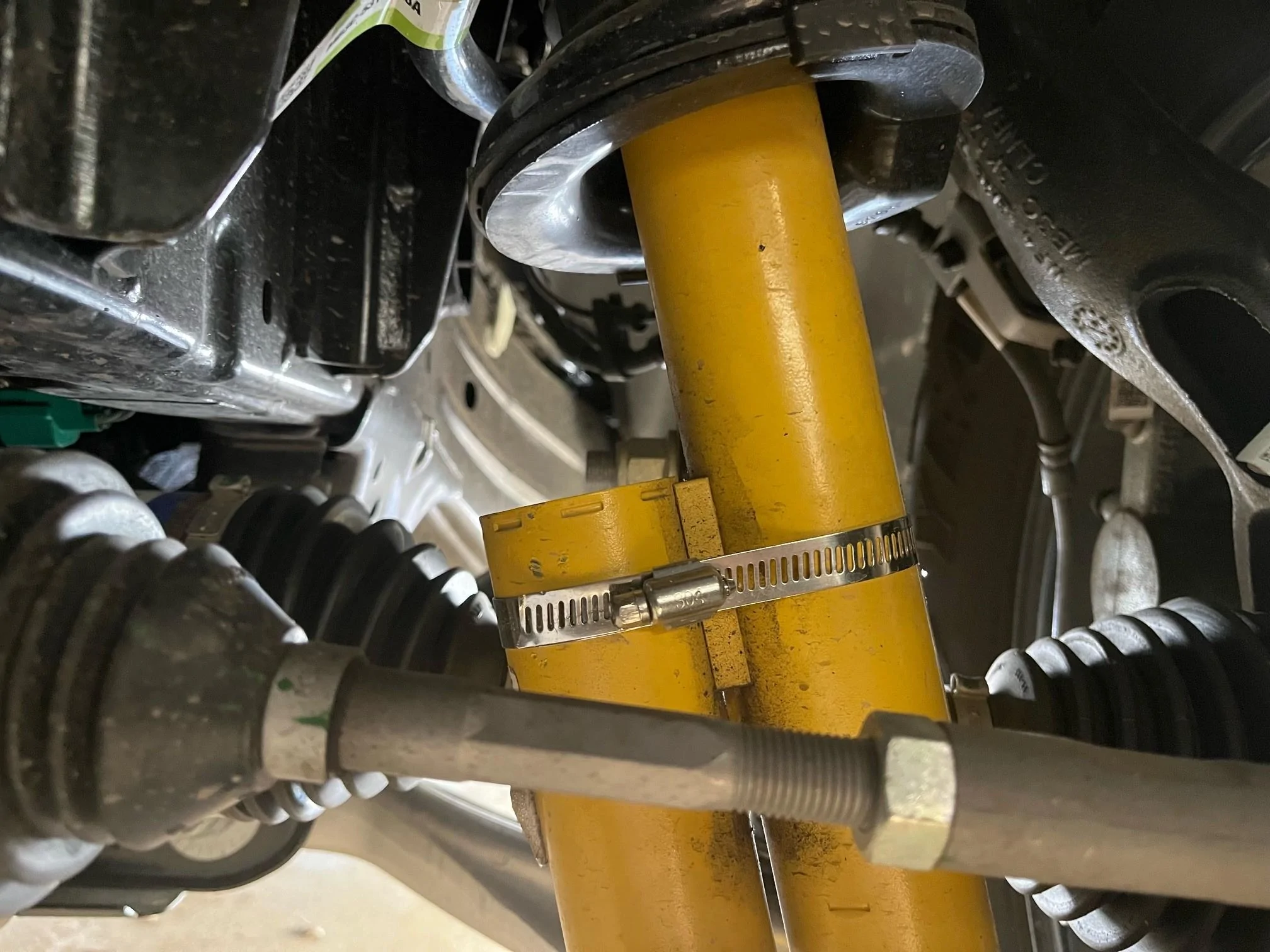

Yes, the OEM Bilsteins are junk. Even their entry level 5100 is a vastly better built shock.
It was suggested on here nearly 2 years ago to consider using a hose clamp to reinforce the "attachment". Will it help/fix the problem? Not sure, but it certainly adds stability to the reservior. It isn't going to be able to wiggle under load like it can without the clamp. I'm just hoping to get to 50k then I'll do 6100's or Fox or maybe even Kings....
Front picture was easier to get, but you get the idea.
That is an excellent idea and should be more widely known here.

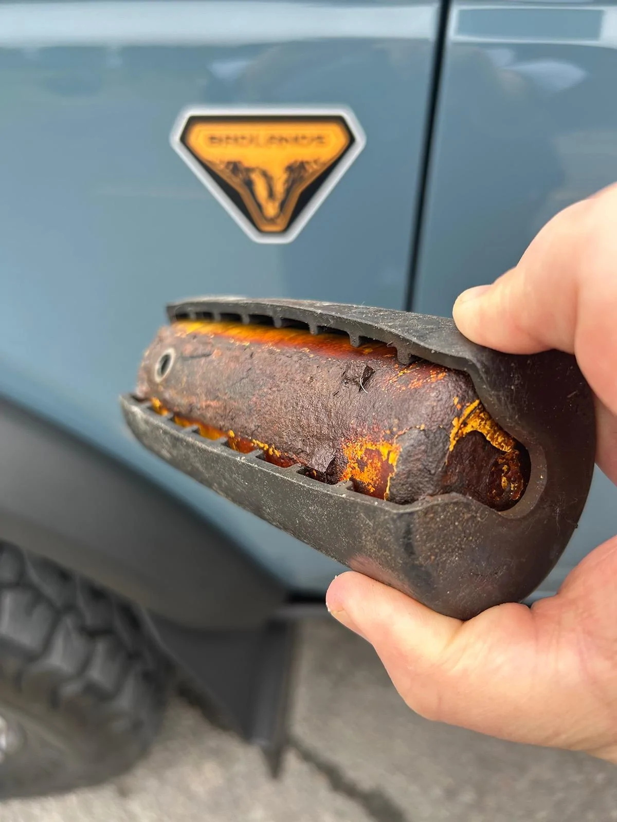

Any one else have the shock reservoir fall off ???
Where did you find the reservoir? I doubt it was just sitting there on the ground where you parked. Did it ā€œfall offā€ or did you pull it off?
I was driving (top down of course)in my work parking lot hit a dip in the road (aggressively) šŸ˜‡ and heard that sound of something is broke. Looked back and saw the Bilstien beer can spitting and spinning behind my mall crawler 🤮
